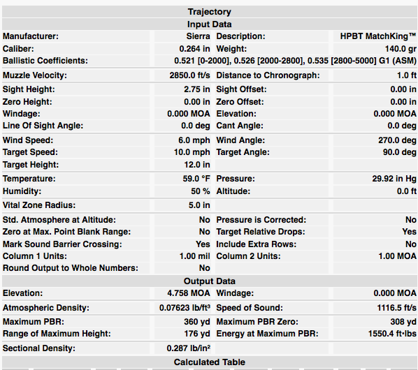

The first number is usually 2800fps up, the second is 2000 to 2800 and then it's 1800 and below for most I have seen with Sierra

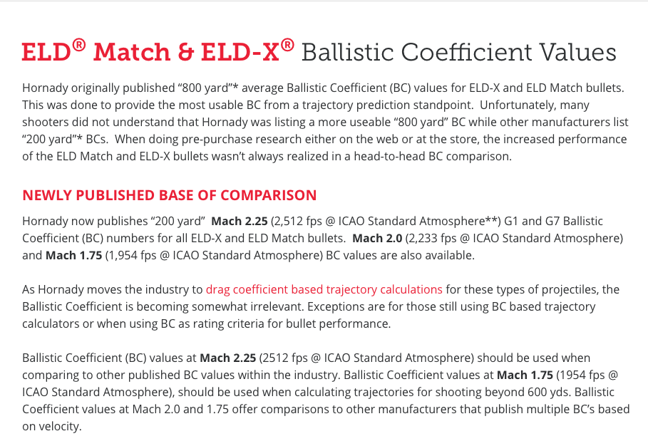

I think 800 is the right balance to true most of what we shoot, I have not seen it negatively affect the solutions and the MV adjustment is much, much smaller when doing the BC here. Averaging the BC at 800 and then truing the MV using my Kestrel resulted in a 28fps change vs what is normally well over 50fps in some cases even 100fps.
Hornady is using around 800 yards for their average since getting Doppler vs most people use 300 yards which is industry standard. Although they now offer it in bands as well in various machs
The 300 yard average is safe, but I think for most of us, 800 is better.
