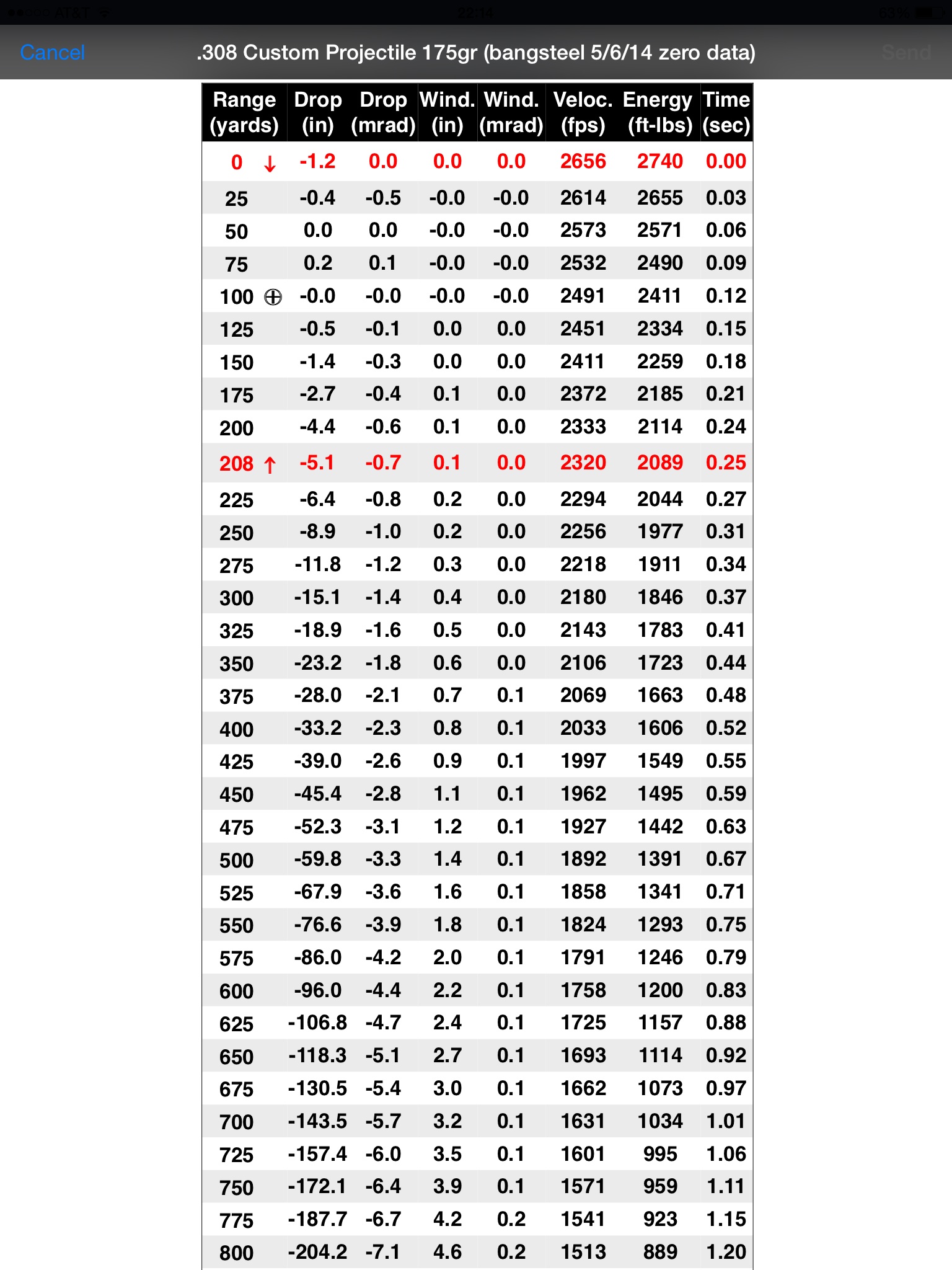

Using your MV and some general assumes (swags) this is what I got using your MV and a 175grain HPBT MK
Posted via Tapatalk HD for iPad
