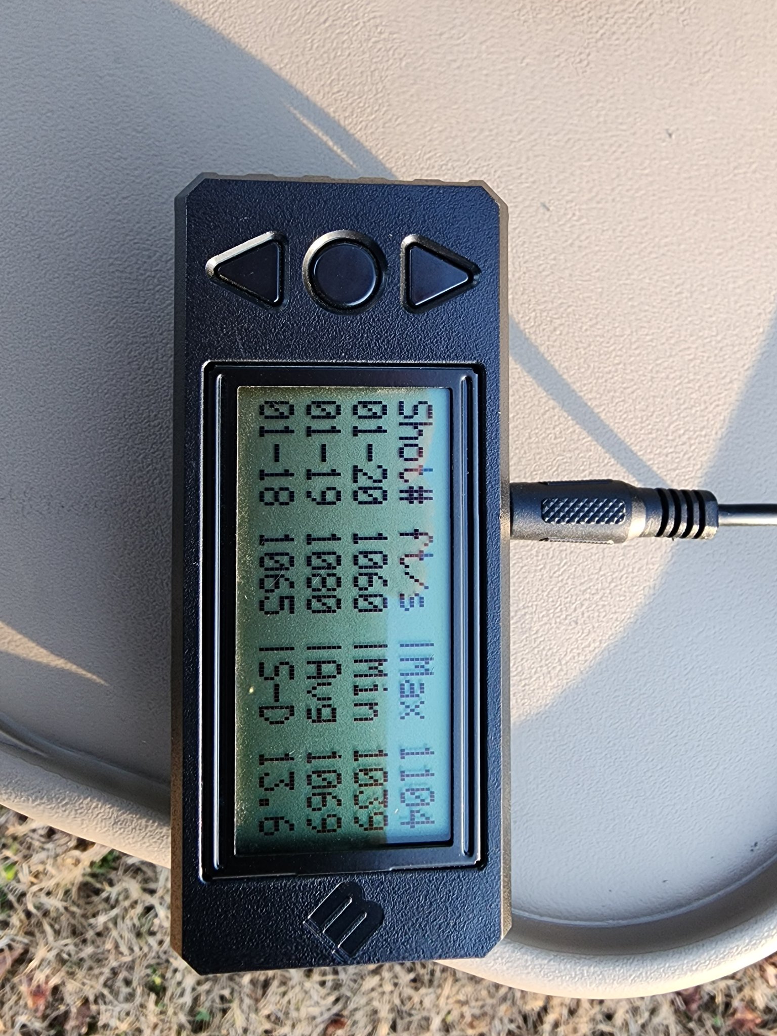

Your gun sucks those SD are terrible. I just cracked a brand new case of sk rifle match yesterday and first 20 shots.
