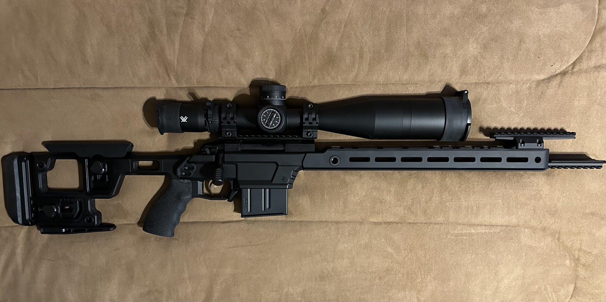

Well I decided to go with the Vortex Razer 3. So now just need a gun to go under it haha. Any recommendations on rings?

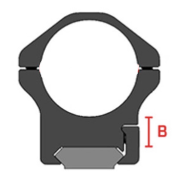

ARC M-Brace 34mm, and depending on your gun setup, will depend on your height. Most rifle setups Low rings will clear just fine. But if you go with something like the Christensen Arms MPR that has a full handguard that goes on top of the barrel, you'll need High rings.
So, traditional rifle setup with a 20MOA base, i'd go with these...
If you're going with a chassis style gun that has a covered barrel handguard...
Here’s a little cheat sheet for ARC rings. Instead of the measuring from top of the pic rail to optical center (hard to mock up), I measure from the top of the pic rail to the bottom of the scope.
Using the “Height B” numbers below, stack some biz cards, nickels, condoms, whatever until your scope is Xmm high and see how that feels.
Helps if you have a tripod so you can gingerly get behind the scope as it sits on biz cards etc.
Arc M10 / Mbrace SEPARATE 34mm rings​
SIZEHEIGHT B*
36mm [1.42 in] X-High19 mm
32mm [1.26 in] High15 mm
28mm [1.10 in] Med11 mm
24mm [0.94 in] Low7 mm (6.9 mm)
Arc Mbrace ONE-PIECE 34mm rings​
SIZEHEIGHT B*
38mm [1.50 in] High21 mm
32mm [1.26 in] Med15 mm
* see B measurement, below.
Measured from the top of the pic rail to bottom of scope (which is obv the same as the bottom of the scope ring’s “circle”)
Reactions: Natetron
If you are brand new to this, you might reasonably ask how I got my B height.
Take the manufacturer’s rail top to optical center number and subtract half the diameter of the scope tube.
Example:
ARC Xtra high manuf # = 36mm
Half of 34mm scope tube = 17mm
36 -17 = 19mm for rail top to bottom of scope
I sorta suck at math so hopeful this’ll help a future “me”-type that stumbles upon this post.
Reactions: Natetron
