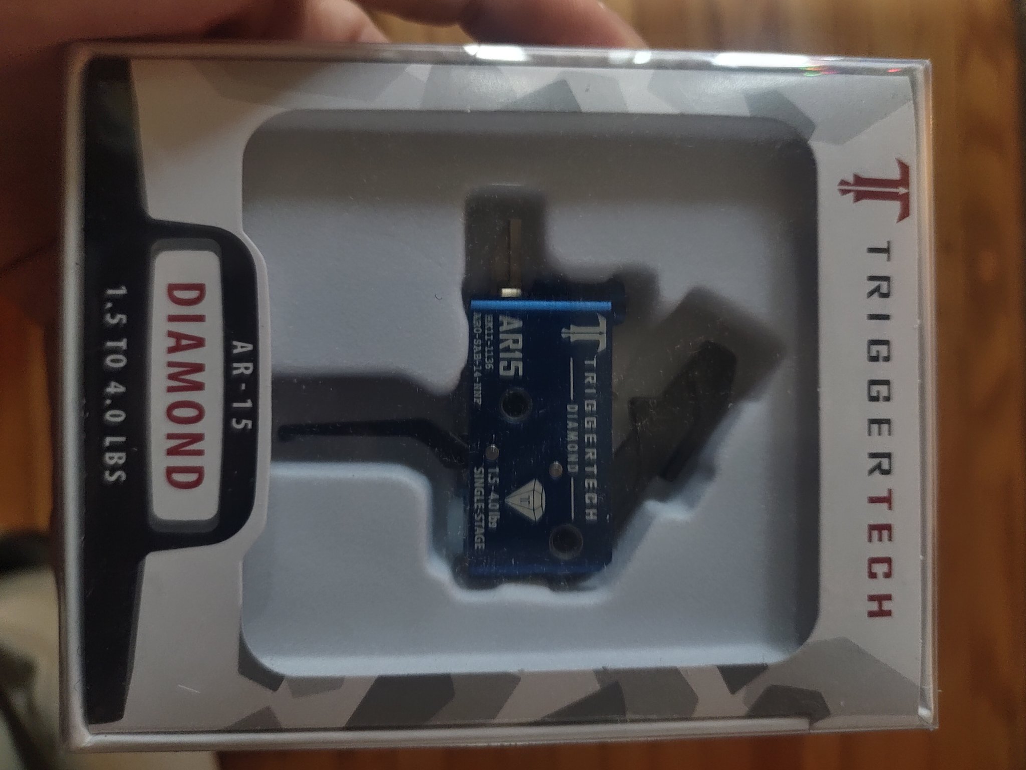

    Got the trigger tech diamond single stage installed. Was very easy, and the adjustments are nice. Trigger reset is almost non existent compared to anything else I've had. Just like the trigger tech special I have in my bolt gun, the break is incredibly crisp. Have not had the opportunity to go to the range to test it, but I have dry fired it a few hundred times. Seems really nice and worth the money. Looking forward to using it next week. Thanks for all the help everyone.
