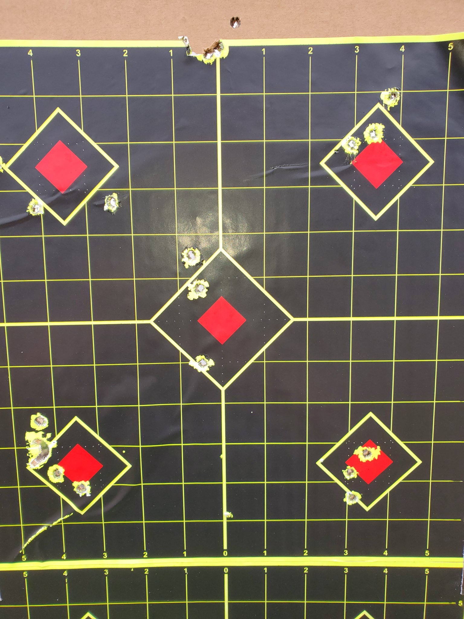

I have a 6.5 PRC built on a Nucleus action with a Proof Research 8 twist barrel at 26 inches. I bought the action used off of here. The gun had 101 shots thru it when I got it. Now it is doing something that I haven't seen before. This gun shoots under 1/2" groups with the Hornady Match 147 gr. loads. That is all I have shot thru it and all I have on hand now. Yesterday when I was shooting it was going great at 100 yards. So I went out to 400 and was getting good groups. Then one of the shots missed the steel all together, this is a 24x24 steel so I thought something was wrong. I shot again and missed again. So I went back to paper at 100 and noticed a L shape hole. 20200404_144111.jpg
It is the bottom left target. I was amming at the bottom right one. Those groups on that target were from some load work I was doing with another gun, they were not from this one. After that shot I got 2 shots touching where they were right along. Then another 2 that missed the target. So I cleaned the gun, checked the muzzle brake. Nothing seemed wrong running a patch down the barrel and no marks on the brake. I contacted the seller and he wasnt sure either.
So today I took it out. Shooting the same lot of ammo. The first 21 shots where great. All within 1/2 MOA. Then shot 22 keyholes. Here is the shot.
After that shot I switched Lot # and the next shot was the same L shape way off target.
Then I shot 2 more and they were right back to normal. Then the next shot missed the backer all together. So I pulled the muzzle brake off and that shot also was L shape.

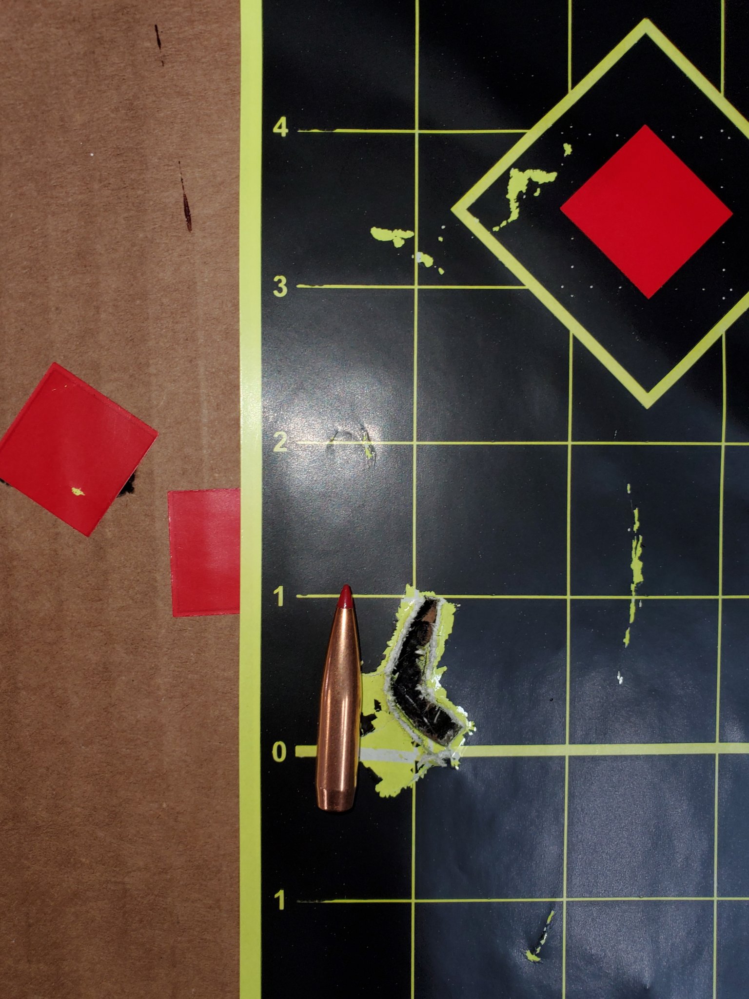

So now I am stumped. Does anyone have any ideas? Do you get the L shape when bullets tumble? I have never seen that. I only have seen them in a straight line. Also it is weird how it shoots so well then those come out. Just looking for ideas here.

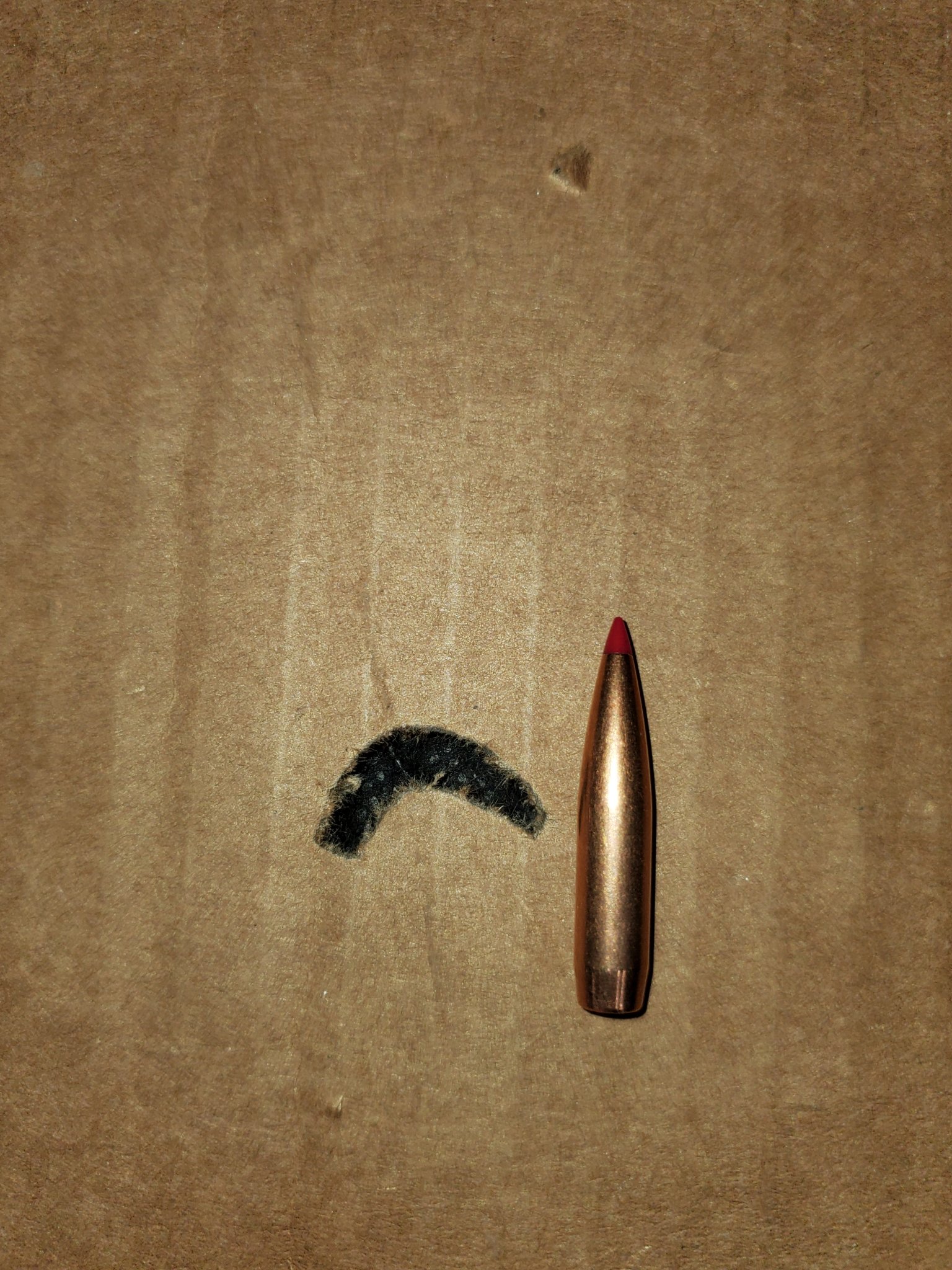

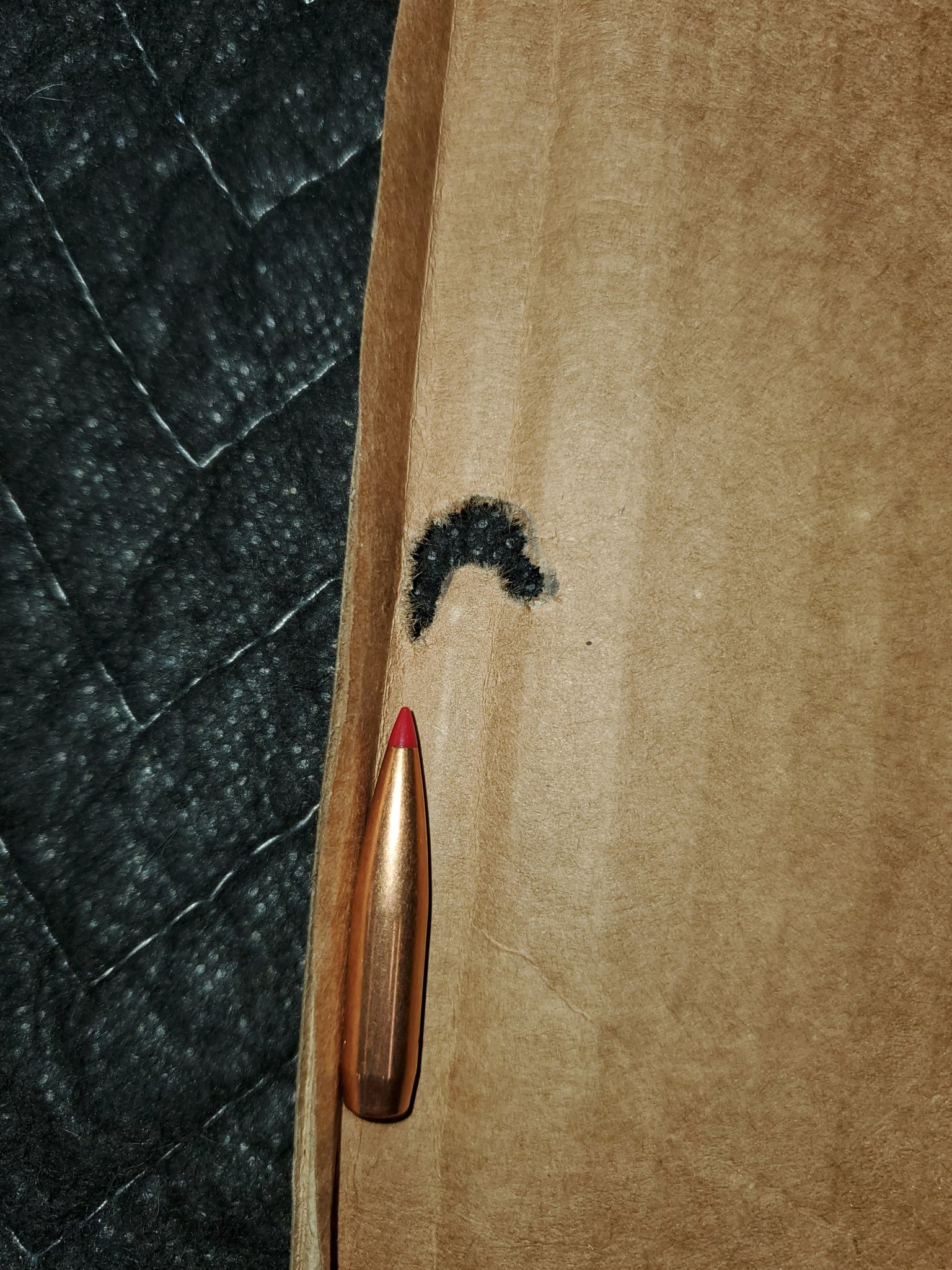

Has anyone ever seen a bullet leave a L shape in the target paper before? Is it from how the bullet tumbles or is it that the bullet is bending in flight?

I have seen them blow up and I have seen them hit paper or steel sideways, but I have never seen them leave a L shape in the paper. And almost all of the ones that have been off target with this PRC with me have left a L or even a J shape.
What's hitting paper is what's left of the nose/bearing surface of the jacket after the lead flies away.

My thought is the bullet isnt fully tumbling.
It is off balance, and when it hits nose first, that L shape is due to the rest of the bullet rotating. Not bent , but rotating off balance. So the tip isnt rotating on a . but o

@Krazy_jim What's hitting the paper is what's left of the ogive and bearing surface after the bullet splits and lets go of the lead. It's not a complete bullet. If the OP were to shoot paper at 25 yards he'd probably get a bunch of comet tail lead sprays coming out of the bullets.
Proof barrels are 4-groove cut-rifled and are among the ones that I've seen do this before. Slugging one barrel showed a tight spot about 8" from the muzzle. Slugging from the muzzle to the breech after it cleared that point the slug just fell through the rest of the barrel. Slugging breech to muzzle it got stuck and stretched the lead weight out 2-3" long. I don't know exactly what causes all of the blow-ups. I bore scoped one particular 6.5 PRC barrel that looked perfect, slugged perfect, had no visible or measurable issues, but it was blowing up 140 Hybrids, 150smks, 140 & 147 ELD's. 143's were the only bullet tested that wouldn't blow (I'm sure any other hunting bullet would've been fine, too).
Heavy-for-caliber bullets, overbore cases, lots of spin (sometimes... 6.5cm will do it occasionally, too), thin jackets, and whatever is going on in the bore that imparts extra heat or distortion to the jacket. For whatever reason 5R rifling makes it happen much less often. I know of maybe 1 or 2, 5R barrels that would do it (just from online forums, FB groups, etc.) but have seen tens of 4 and 6 groove barrels that did-- about 5 in person. 147's and 180s are popular for the problem, but not the only ones. 150 SMK is IMHO nearly just as susceptible, just less often used. For whatever reason the 140's seem to hold up better, and obviously the thicker jacket on hunting bullets is pretty much impervious.

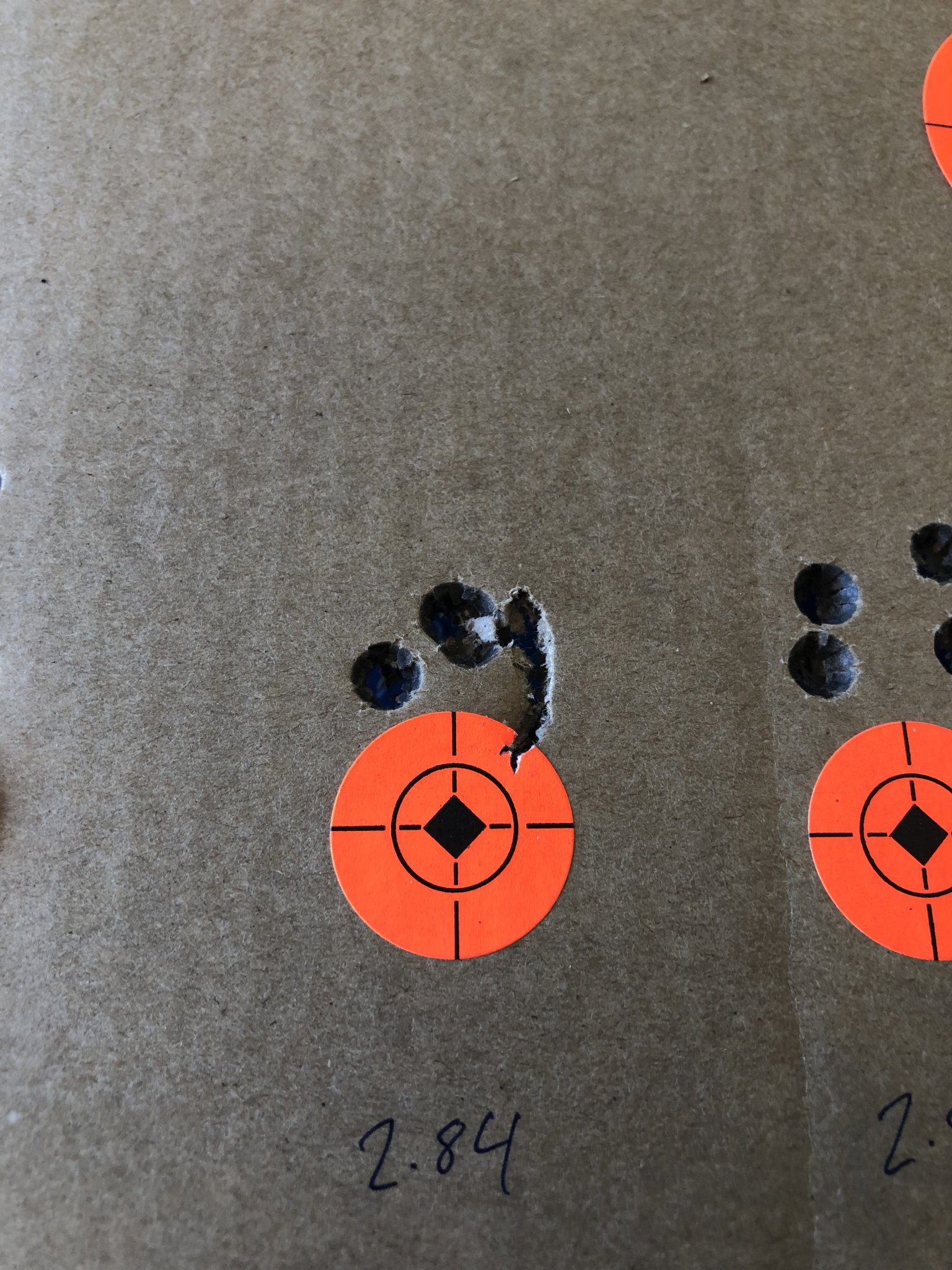

Here is a pic of a keyhole from a .223. The guy next to me had a target frame setup at 50 yards and I was shooting at 100 yards. His AR, which he built, went full auto for the last 5 rounds in his mag. One hit the side of his target frame and ruined my great group.
Pic can’t be uploaded right now, so I will try to add it later.
I got the new barrel on my Nucleus Action. It is a 5R so I thought it would help with this issue. Nope. I had around 60 rounds thru this barrel and shooting at 400 yards today I could see the bullets coming apart in the air. I put a paper target up at 100 and the same thing. Getting the L shap holes occasionally.
I also built a 6.5 PRC off of a Tikka action with a Proof prefit carbon fiber barrel. This barrel is doing the same thing as the other 2. Hornady really must have a issue with the 147gr. I guess I will have to reload for this caliber. Hey Prime Ammo, when will you be loading for 6.5 PRC????
Here is the pic.
