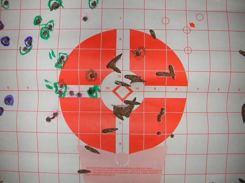

    He's referring to tumbling after impact, not while in flight. Bullets definitely can tumble after they impact.
    Also they can tumble in flight if they aren't properly stable but you'll see this on target at 100 yards.

    I see tumbling bullets on target when bore is gone or twist is inadequate. Please show evidence that well stabilized bullets tumble after impact.
    In tens of thousands of impacts I have never seen it nor has any reliable hunter I know among thousands seen it. I maintain it's an internet myth perpetuated by people who have shot 5 or ten animals. Just saying it happens is not evidence.

    What? There is literally thousands of videos of bullets tumbling in ballistic gel.
    literally the first one I pulled up shows the bullet tumble

    @RTH1800 There is plenty enough evidence to show they can/ do tumble.

    I ask for evidence that bullets tumble in game. You showed me a target. I ask again. You showed a video of a gelatin. I ask again, you stated that there is plenty of evidence.
    I am sure that on a rifle with a poor twist rate to bullet length ratio a bullet can tumble in flesh. I do not use such rifles. On a well set up barrel twist/bullet combination tumbling is a non issue.
