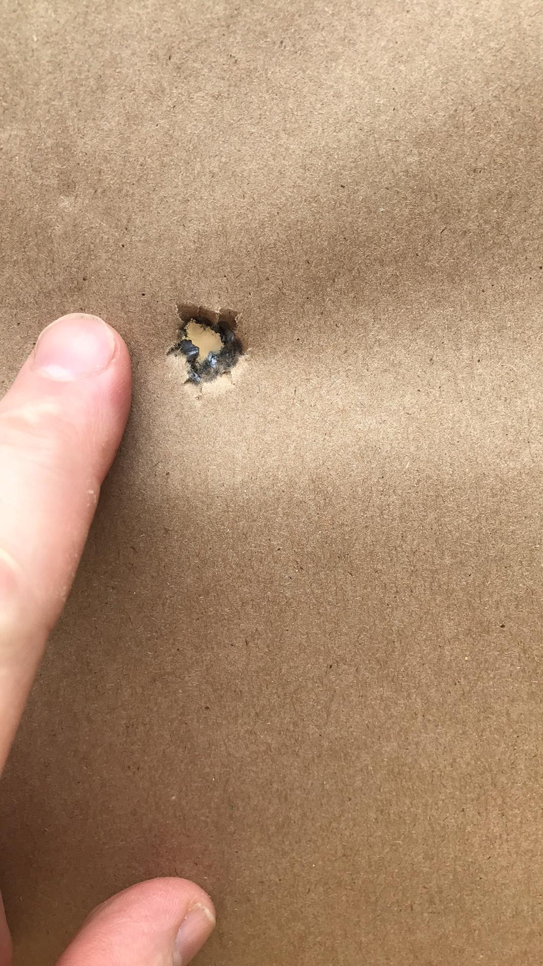

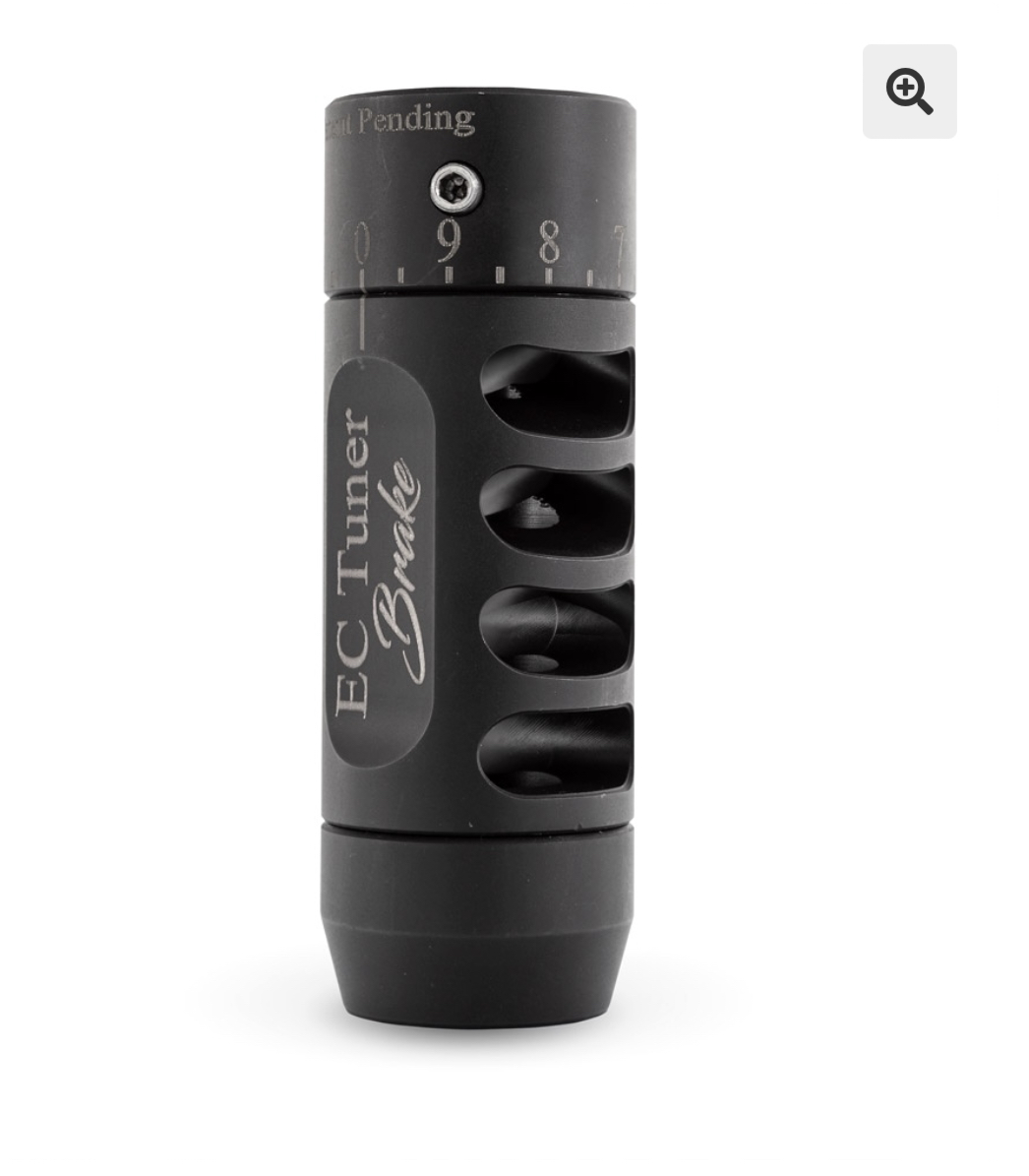

Anyone have experience with tuner brakes? I have a LR hunting rifle that I’m looking to put one on. The thing is with the $250 it costs would afford me 200 or so more rounds to play with. Gun is right on the edge of shooting awesome for a hunting rifle and honestly acceptable as it is for what I need. I already have a APA Little Bastard on the gun so the added function of the brake part is a moot point.

I have a prototype tuner brake from a popular self timing brake company.
In my experience, a tuner doesn't make a rifle that has appropriate/tuned ammo to it more precise.
I haven't tested a tuner with a rifle and non-optimized factory ammo, but I have my sincere doubts on how well a tuner actually works for this purpose, and the general practicality of tuners for hunting/practical rifle disciplines.

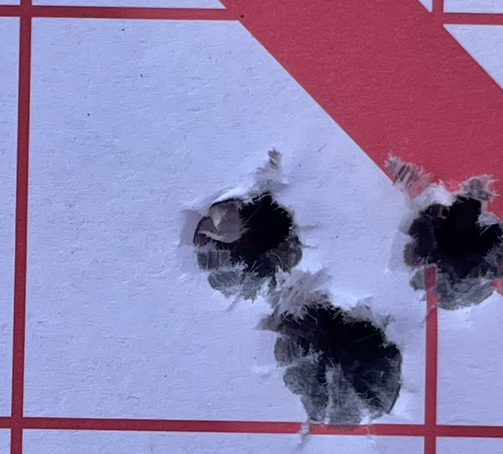

I found my OCW and have a little more room to play with seating depth. I just don’t have a lot. Using a 153.5 Berger in a long case. Loaded to max magazine length. I was lucky enough to source some new powder and the switch shrank my groups some also. My biggest thing is working on me also. It’s a light weight rifle (great for carrying, but super critical on form)

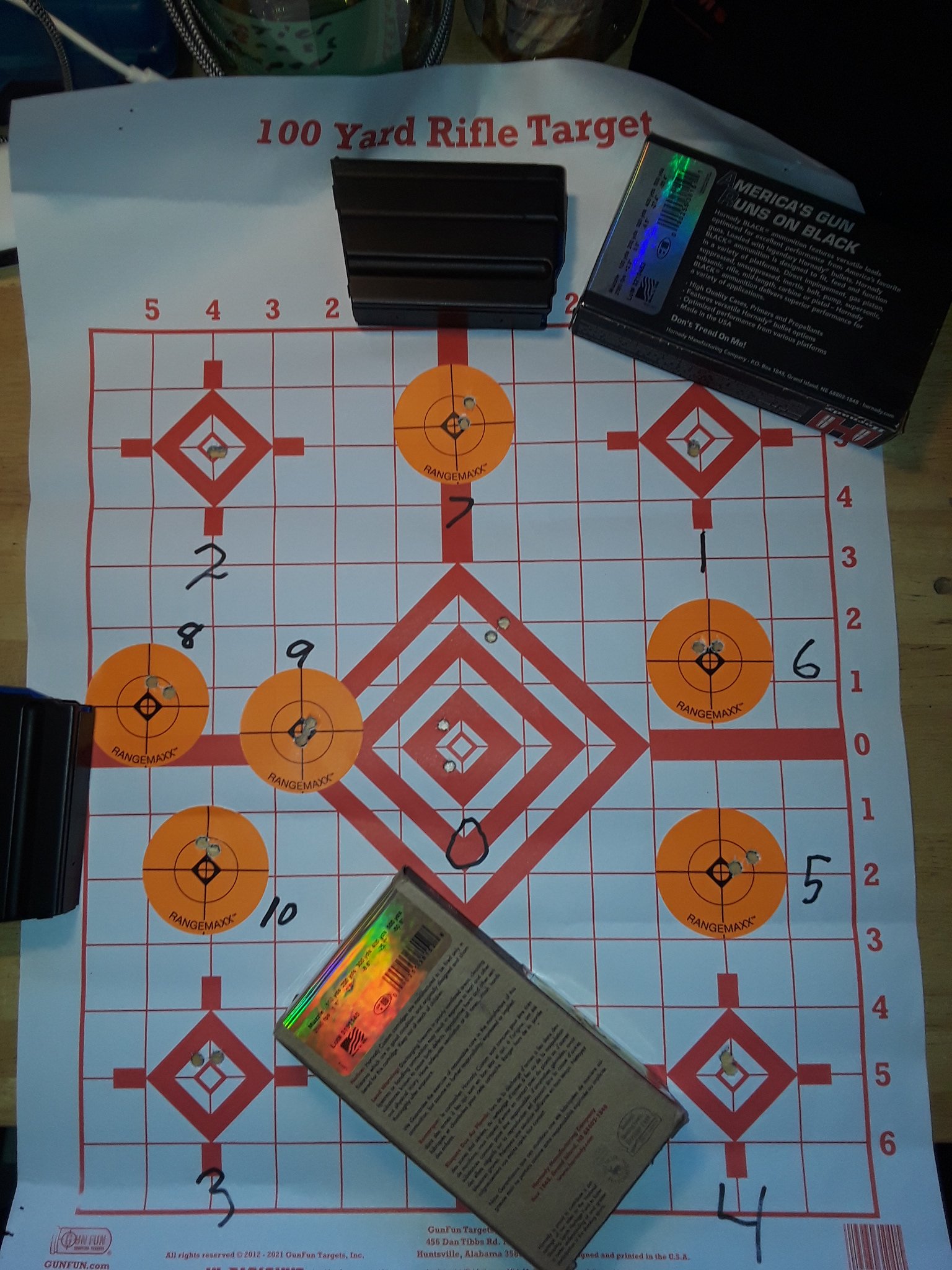

The EC tuner brake works and if you can shoot decent two shot groups will work just fine.
With the price of ammo or components you can't afford not to have one.
This was from a 223 ar.

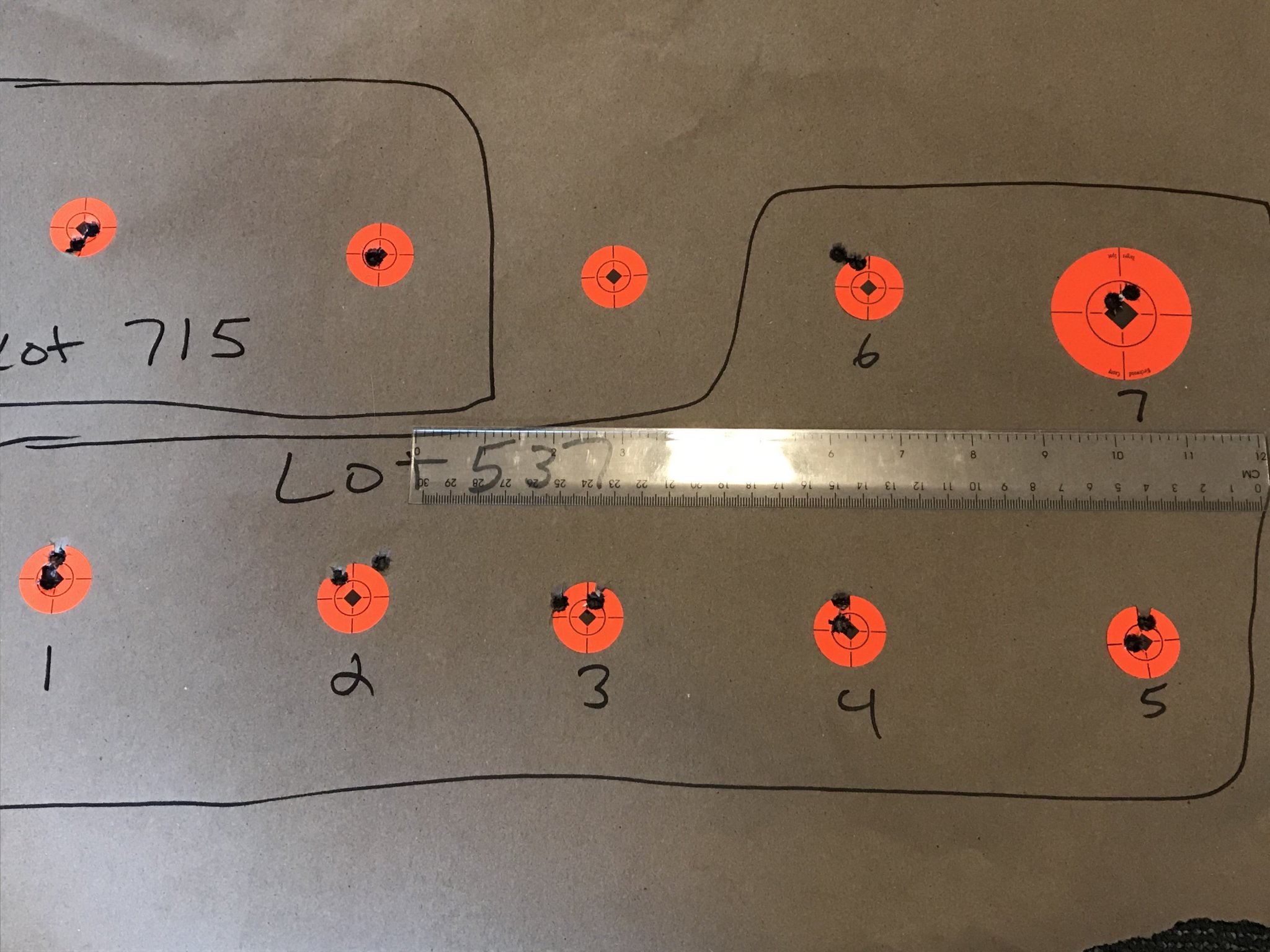

I think people are mistaking the two shot tuning process as "shooting groups". It's not. It's shooting two shots to see thier spread and tune and watch to see if they come together or apart as you tune. You always check after tuning with actual 5 or 10 shot groups.
Here is a pic of one of my tuning targets for two lots of factory 6.5 Creedmoor ammo. First took only one adjustment and the second took more as you can see. Target 1 was not part of the actual test and I had used it for a couple foulers. As you can see you can see them come together as I adjust the tuner. Lot 715 only the one adjustment to a one hole two shot group which continued to a 5 shot and the 537 lot could only be tuned to the touching rounds but still well under 1/2 MOA and that lot of ammo never shot well in that rifle. If you want to use a tuner or not that is the end user's choice but they do work. Not saying they will work great on every rifle with every load but if someone is wanting to try and get a group tighter they are worth a try. Not like in this sport people don't spend a ton more money on all sorts of stuff to try and make rifles shoot better. LOL

Hey Rob!
Take your finger and thumb off the fliers!!😂

@Rob01 thanks for sharing your experience. In my experience using 2 data points to make a judgement call has not worked out for me.
For me personally, I'm getting more and more of the opinion that we are able to shoot tight groups despite all the hand waving we do, whether it's with tuners or load development, simply because of quality rifles and ammunition loaded with quality components and equipment.
I would love to see more instances of us going back and comparing our worst loads/settings to our best with large sample sizes. I think the differences we would see would be rather minute.

But it's not just two data points. Each target is two points and then the next is two etc and then you verify with more groups of 5 or 10. That's what people are missing when seeing just two shots on target. If you feel betetr shooting 3 or 5 shots per target while tuning you can. I think it's a waste of ammo but if it makes someone else feel better then do it.
The better ammo and rifles definitely help in the shooting of tighter groups now. Definitely a better time than 20 years ago.

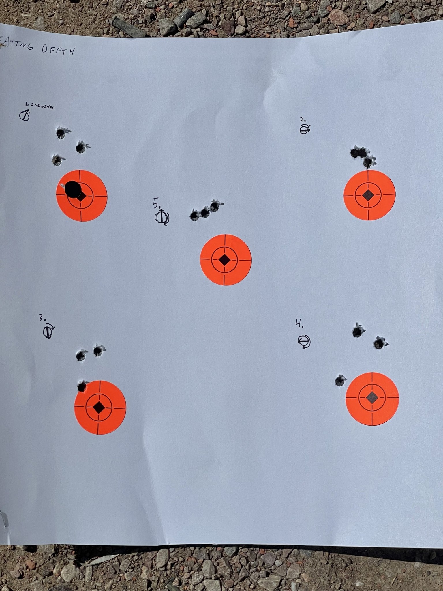

Played with seating depth today and might not need a tuner. Top left was my original load. I played with large windows on my die. I’ll play around the top right area and figure out where the longest part of that window is.

I test rounds at .003 incraments for seating depth on some loads.
I have still had my best tighten up with tuning. That may not be the case with all barrels and loads since I can only test what's in my hands.
I have also only tested one brand of tuner, EC .
I purchased it on the manufacturer's credibility and design it looked clean as well.

Did i say i was done? No I didn't. More testing planned at 1,500 yards and in. You go have a nice day. I bet people just love being around somebody with a winning personality like yours...
I then shot 3 groups of 5-shots each in the optimum setting. I am super happy with the EC Tuner Brake and am glad I spent the money on it.
