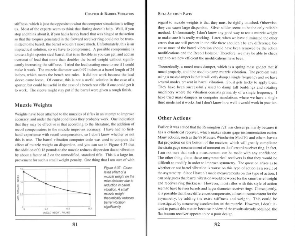

Not in the book you listed as a source. I quoted it, anyone is free to check my work. Drop me a page number. I've got it open right now.
Page 45 talks about the 3rd mode which is what a tuner does.
Page 62 tells us why
Page 81 says weight works.

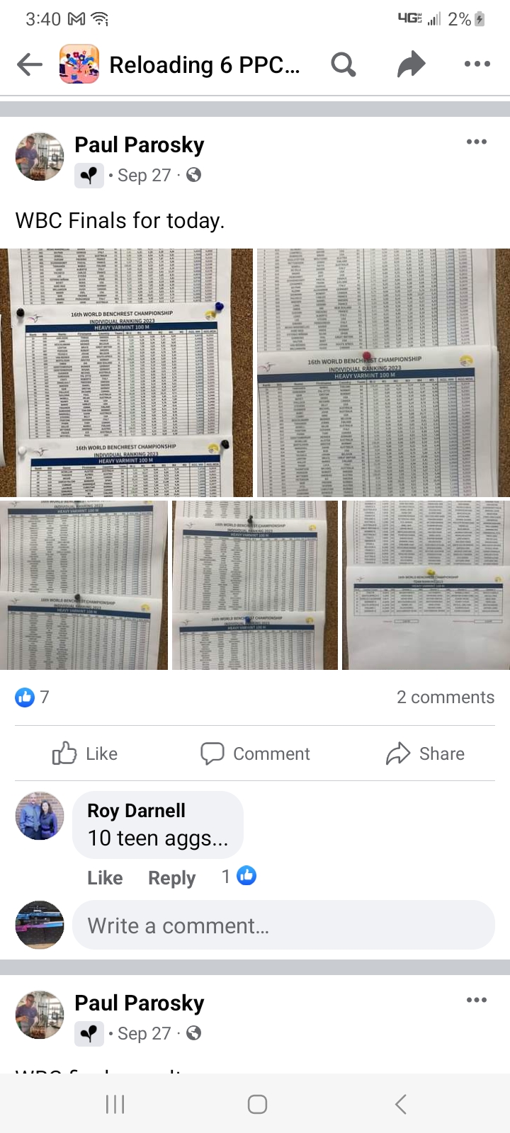

The short range 100,200,300 yard guys never set the tuner and forget it. The 600 and 1000 yard guys do.
The short range guys use volume to set the load and the longrange guys use weight. See my comment about the video posted above and why his grouping doubled or tripled day to day.
I will post a match result showing top ten shooters all in the ones for you.
A 0.25 agg no longer wins anything..
Do you have a signed copy?
Try again. Nowhere on this page does it say a weight increases accuracy, nor does it make any weight claim without the caveat "theoretically." Theory != Data
Actually, don't try again. You've lost all credibility and there's close to zero you or your signed copy of the book can do to regain it with me.
Actually it does and the fact you can't read is troublesome.
Your own quote says the addition of 0.18 pounds to the muzzle reduces dispersion by a factor of 2.
The fact that you don't know what dispersion is means the American education system has let you down.
According to a *computer model*
The author says that "under the right conditions they probably work" - not a very conclusive statement.
The computer model came from sandia national laboratories. And you mixed up what he said.

As promised.
Those bullets mentioned in the earlier video are jokers made by Paul who is Lester brunos daughters husband or prp bullets.
The comment from Roy Darnell says it all.
It also says "...they can cause large dispersion." See, I read at a 7th grade level and I can take things out of context just as well as you can.
The testing is all displayed in his book rifle accuracy facts.
He provides no testing. I don't care where the model comes from.
Vaughn states any weight added to the muzzle helps accuracy. A tuner has mass and helps accuracy
He doesn't make any such claim nor provide any level of certainty or proof.
