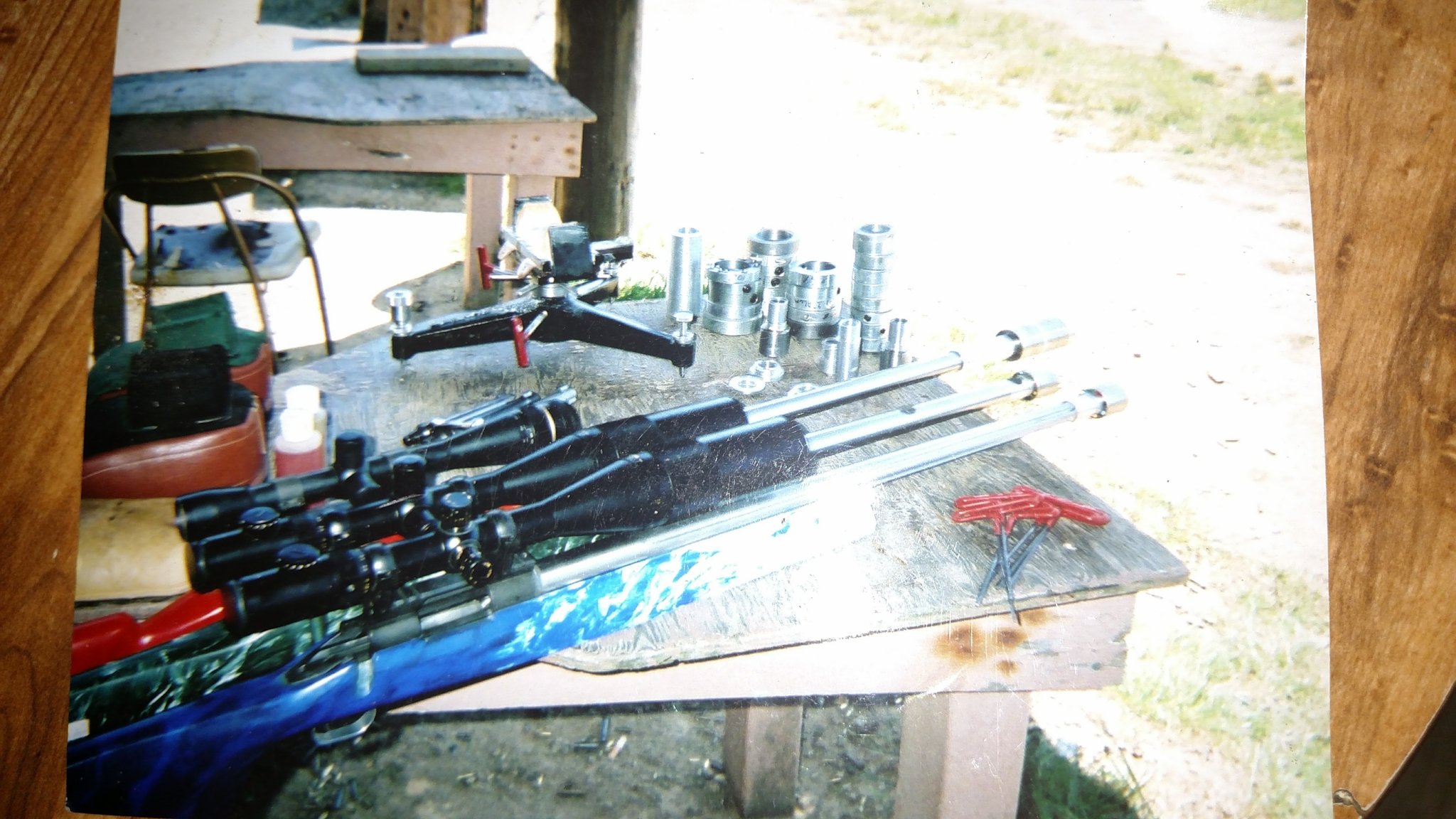

The picture shows three of my tuner rifles and a stack of shaft collars in half ounce increments.
