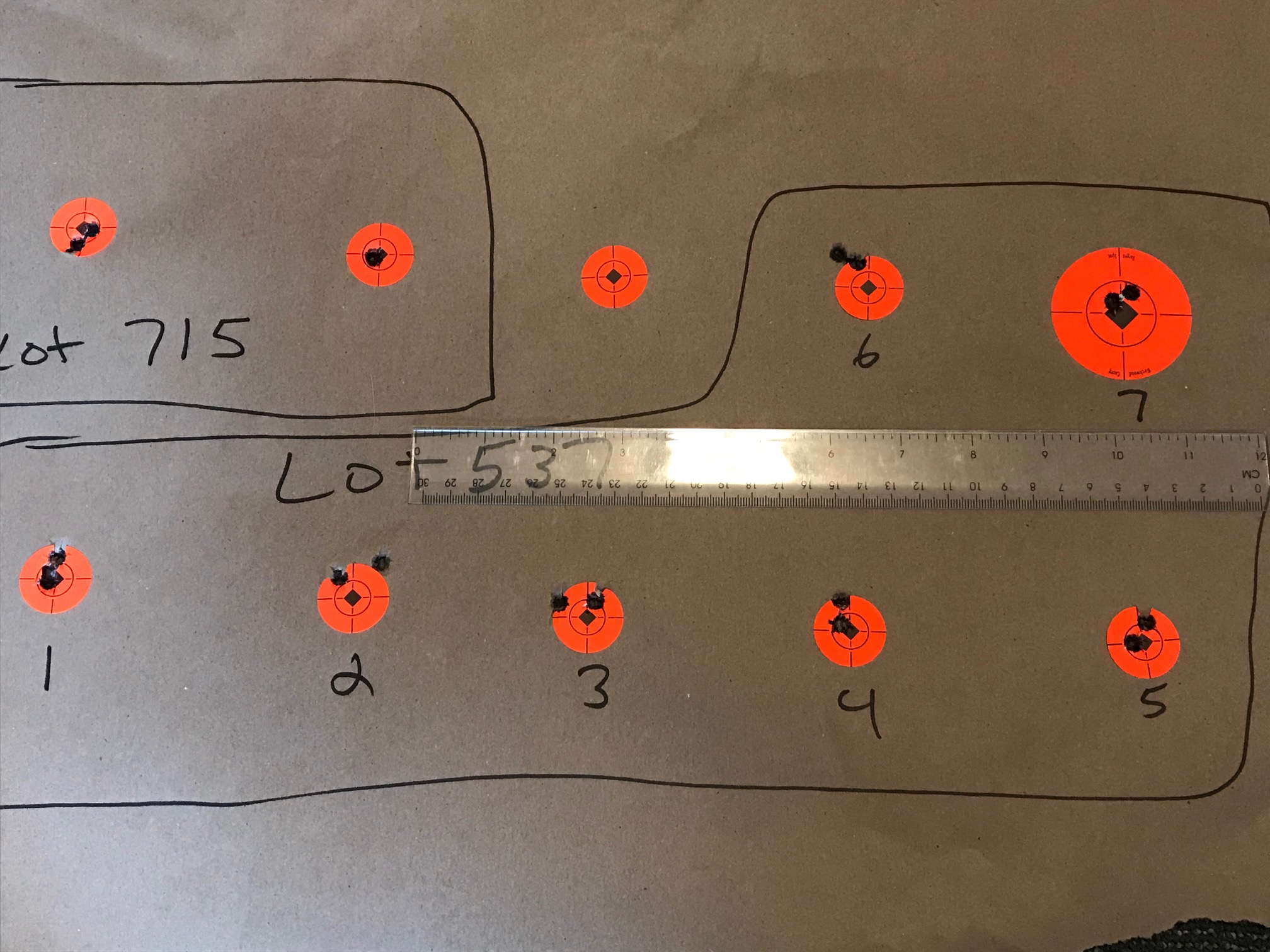

I have used the ATS tuner with 6.5 Creedmoor factory ammo and it worked very well. I used two shot groups to tune it in and you can see the shots come together between the adjustments. The number one orange dot in the 537 lot is not from that lot so disregard. You can see from dot 2 to 7 you can see them come together to the best that lot will do. Lot 715 only took one adjustment. I used this ammo that I tuned in NC at about sea level to go to a match in WV at Peacemaker and the day before the match we got to shoot out to 900 on their range and I shot out at 900 with the same tuner setting in a different temp and elevation and the spotter said my three shots at 900 were almost touching. Take with it what you want. I have tested them and they work for me.
Some people will never be satisfied until they get more data points than it took to get a man on the moon, which they probably don't believe either. LOL They will burn up barrels trying to prove or disprove and never be happy. Up to the shooter if they want to use one or not. Personally I don't care if they believe it or not as I use what works for me and don't have to prove anything to anyone. Prepare to get beat up by both sides if you do a test. LOL
5 shot group using a 6th bullet hole as an aiming point.

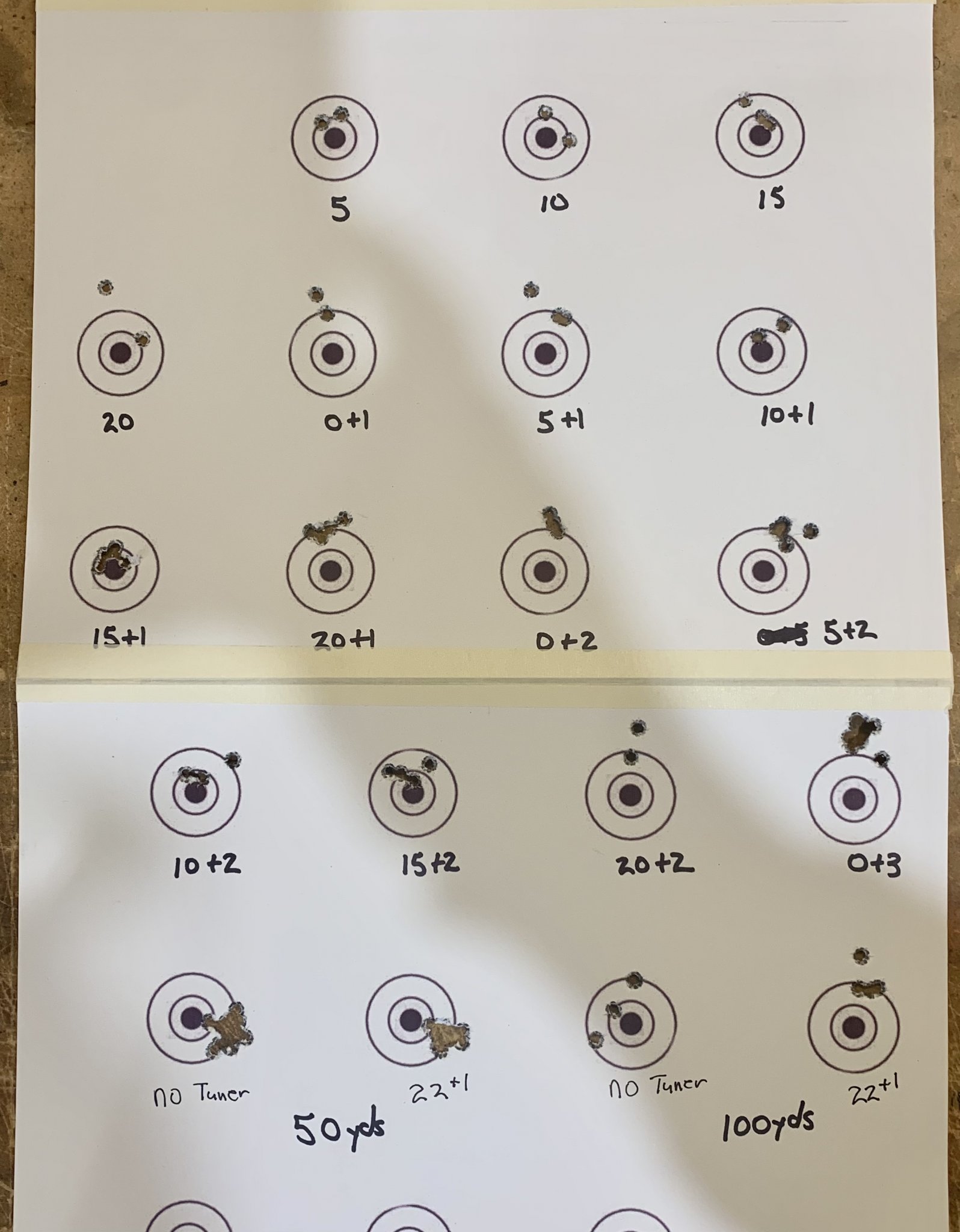

This was the results of my tuner test shot a few weeks ago. A tuner is not going to do anything for ES but it will help tighten up groups.
Could you explain the numbers at each group. I am trying to understand the ones such as 22+1 is this setting 22 + 1 increment?
