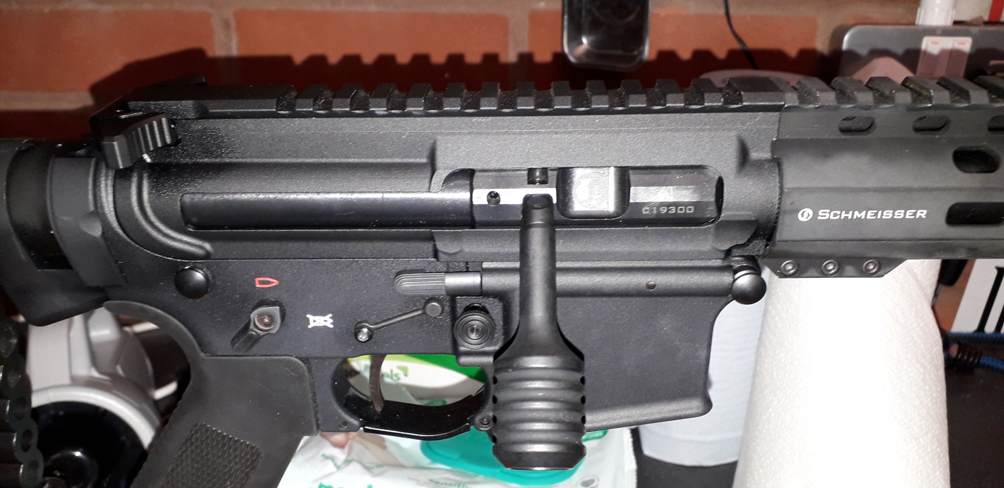

These guys in the UK have to turn their ARs into straight pull bolt actions due to their laws. Give them a shout. I bet they can tell you exactly how to do it. http://www.highpowerrifle.co.uk/

I have seen several manually operated AR type rifles - all done for specialized purposes.
In it's most simplistic form, nothing more than turning off or eliminating the gas tube. If you will be using a regular AR stock, use the action spring to feed rounds and keep the bolt closed. If not, I would recommend using a detent to be sure the carrier is held forward while firing.
If you install a side charging handle and cut a slot in the receiver, you won't need to move your head when cycling rounds as you would when using the charging handle (a heavy walled receiver works best).
You can get a good idea of what the modifications look like at 6mmar dot com.
Be sure to look at placing the handle on the left or right side of the receiver depending on which hand you want to operate the bolt carrier with.

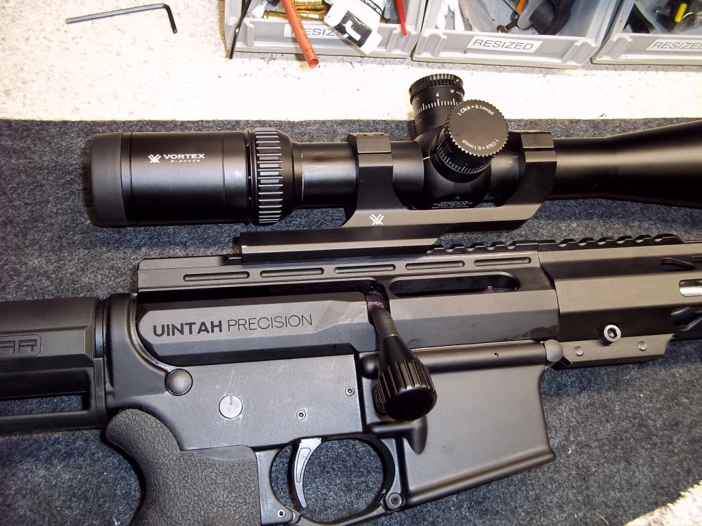

Here is the best option.
True two lug bolt, I have one in 6mm ARC. Shoots .5 MOA or better and you can use true bolt action loads in it.
https://uintahprecision.com/why-a-bolt-action/
https://uintahprecision.com/product/up-15-complete-rifle/
Here is a closeup picture of mine
They are somewhat local to me (within 2hrs) but the price for just an upper has kept me at bay.
Would love a 16” in 6.8 spc for my oldest to hunt with (cow elk) but at the price they want, the tikka works just fine or I could pick up a sig cross for about the same price.
Drop the prices to ~ $700-800 and you would see many more out there.
My buddy has a POF manual / straight pull rifle and while it shoots really well, it’s a bit clunky to operate from the prone.

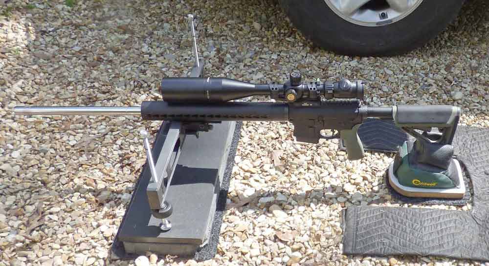

I know this is an OLD thread.
I have a couple straight pull No-Gas ARs in 22 Nosler I use @ 600.
With all the bad press on Nosler brass I figured No-gas would eliminate the trashed brass.
It did but with another issue. STICKAGE.
Shooting 60+ rounds and I have to swab the chamber after 40 or so, every 5.
Seems some carbon/residue is the cause. Manageable but annoying.

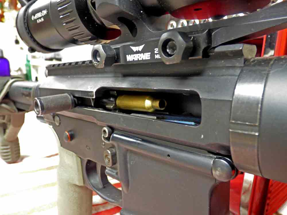

I use a right side upper from BCA and a modified lower for right side bolt release.
This year I put together one for the wife but this time with gas. Cut down the ejector spring, and adjusted gas so it locks back and ejects about a foot @ 2 o'clock. Using 6mm HAGAR brass reformed to 22 Nosler (22 NOSGAR) it seems to do OK. She's at about 1MOA @ 100yds.
Keeping the load to just under 3000fps with 88ELD and SB6.5
This winter I'll probably assemble another with gas to replace a long in the tooth one I have been shooting.
I have about 1700 Hagar cases left, about 300 Nosler/Dogtown.
Note that the No-gas is basically just an upper that I can swap with 5.56 and X39 using the same lower.
