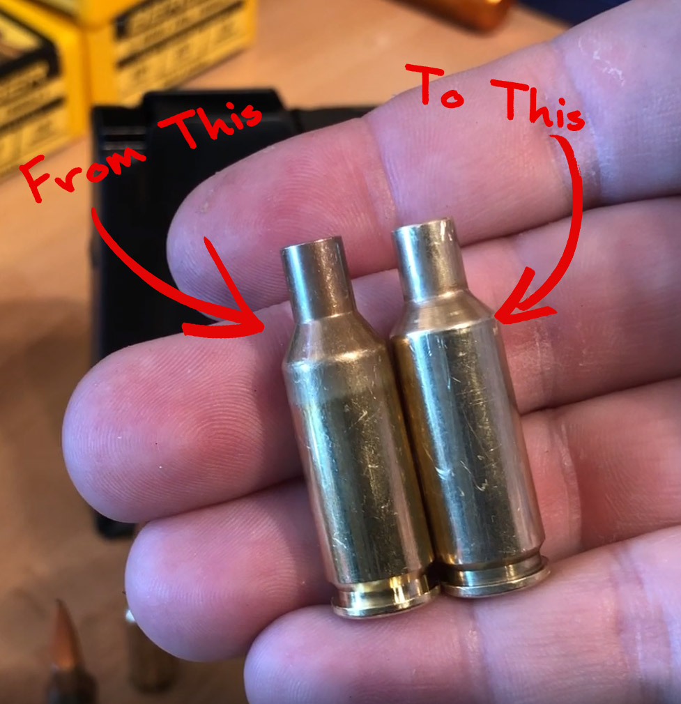

So to put things in perspective, I have to fire form for my 6mm BRA - here is a comparison of the brass:

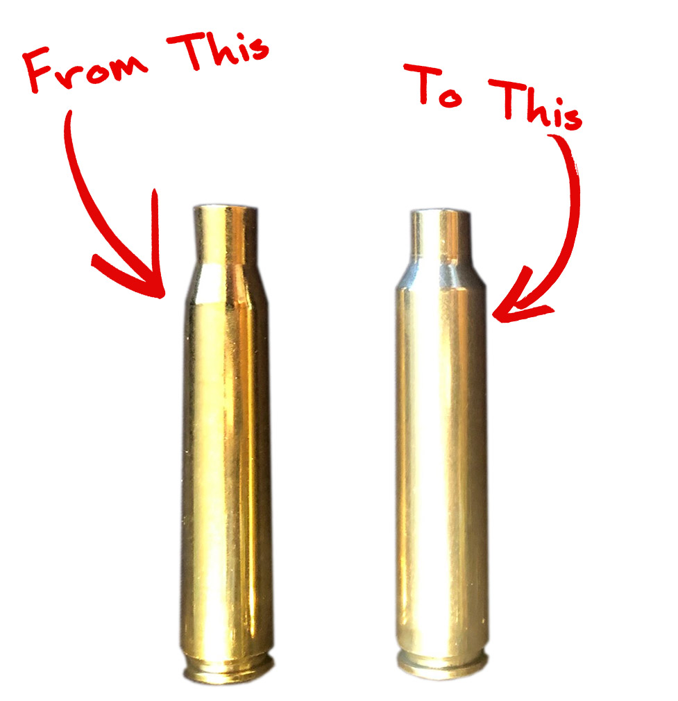

For my 300 PRC, since only Hornady brass is available off the shelf, I prep and fire form 8x68S. Here is the comparison before and after:

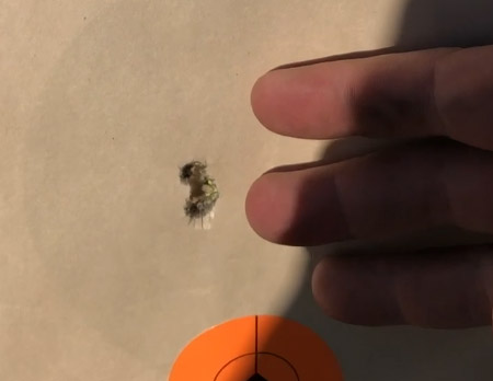

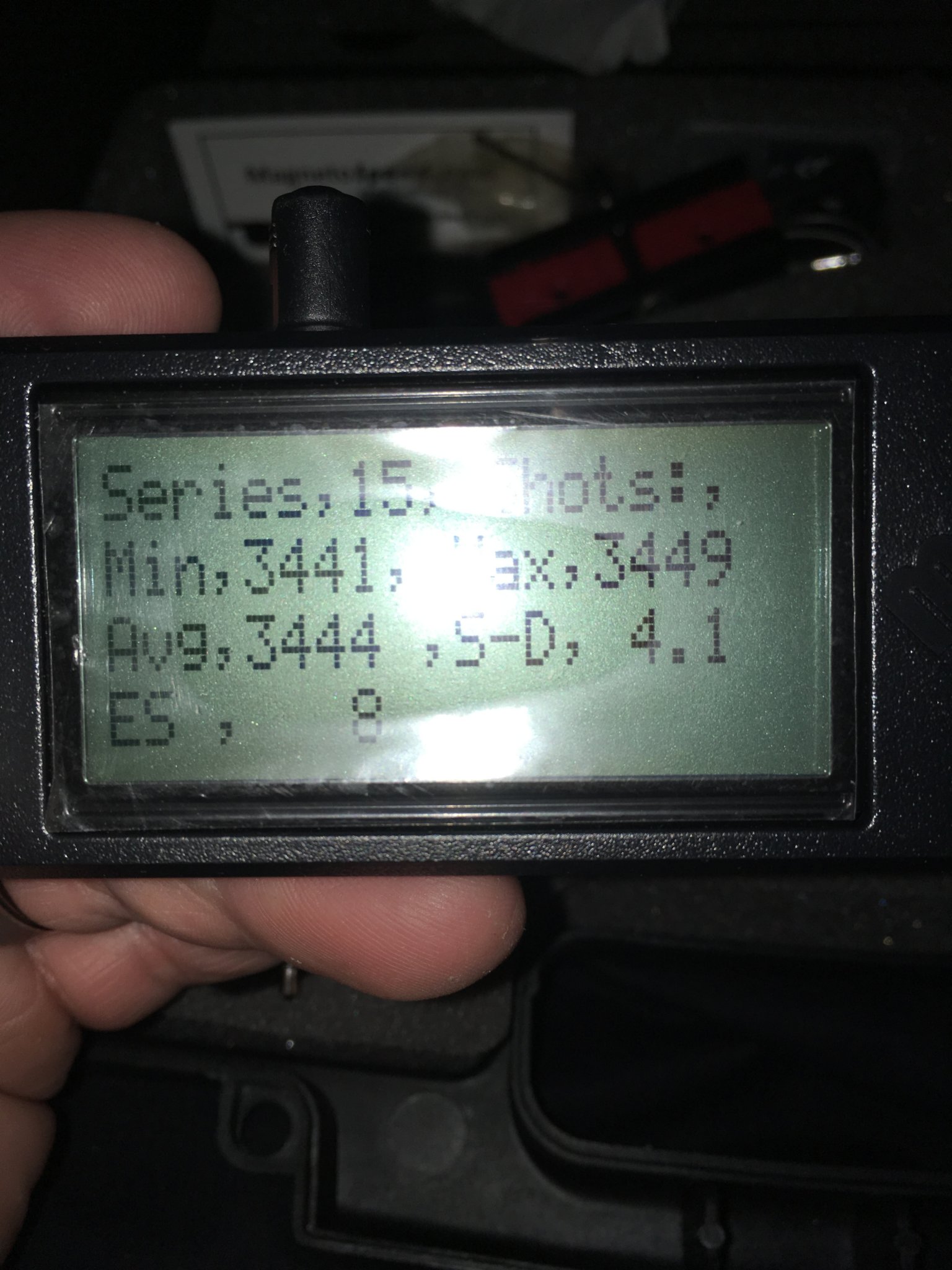

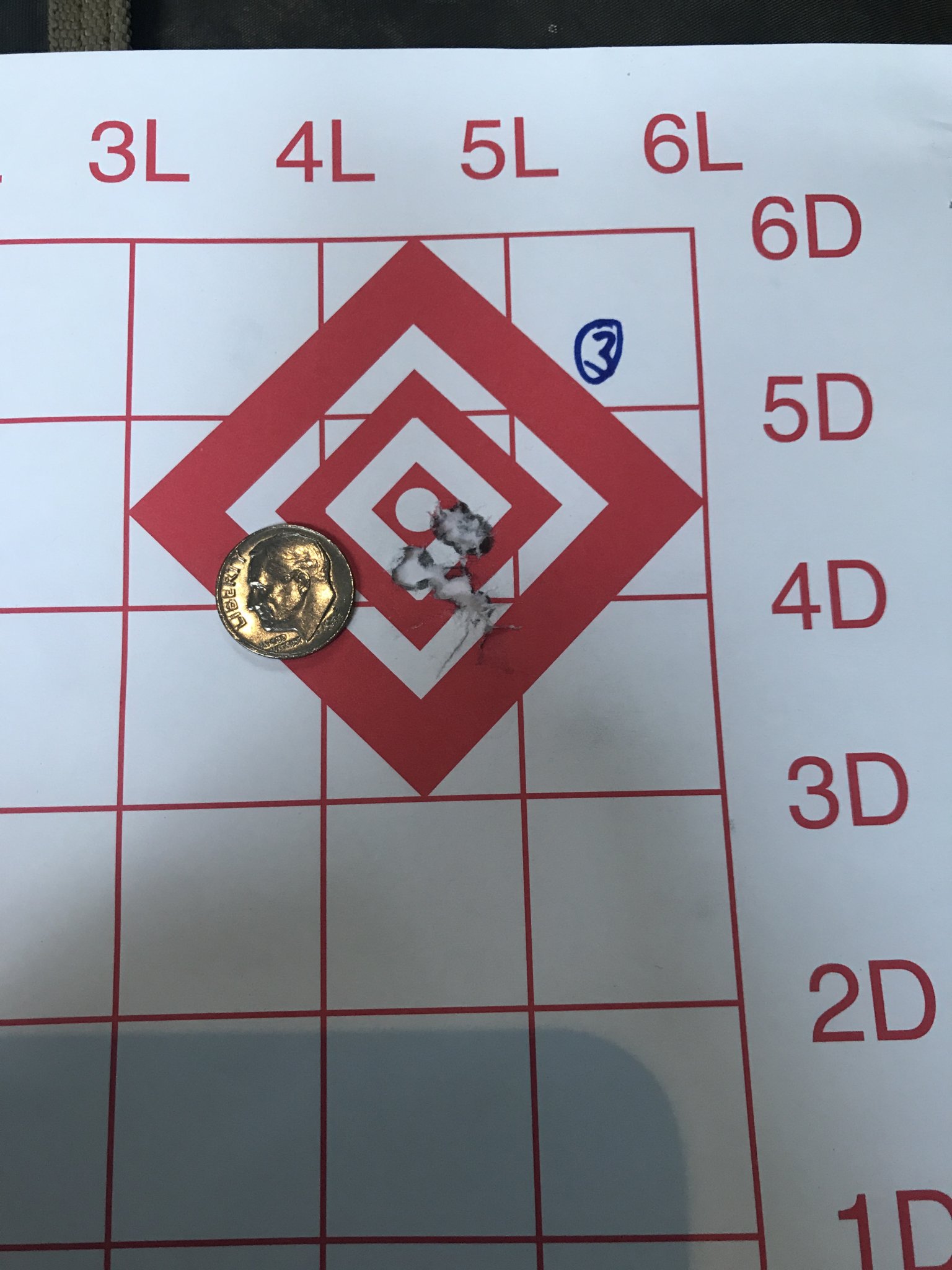

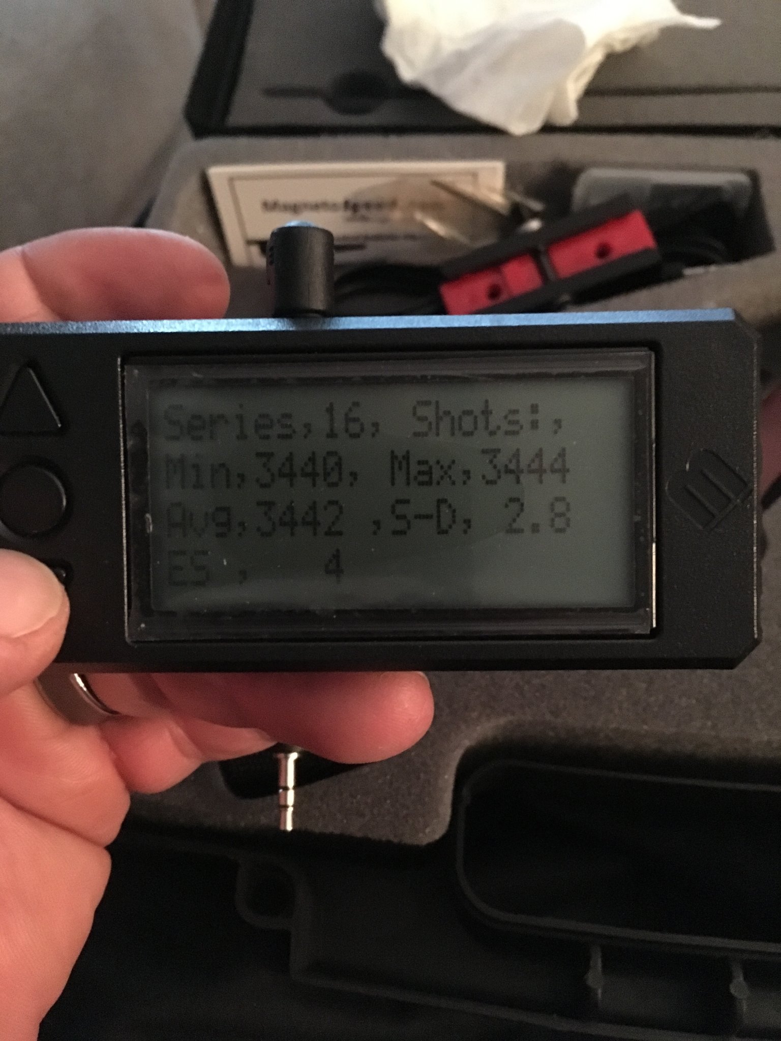

There's a lot of brass expansion going in both, but especially the 8x68S -> 300 PRC one. Both are certainly going through much more than what happens when you shoot virgin brass actually made for your chamber. Yet with the 6mm BRA, when I practice with the fire forming loads, concentrating on trigger management, position, etc., I still get < 0.4" groups at 100 yards. Is it as good as fire-formed brass? No, but it's good enough to practice with. Now with the 8x68S -> 300 PRC, you'd think the groups would be crap, but I can do this at 100 yards:
And this at 1200, though this is a friend shooting my 300 - not me. Oh, and it's his first time past 850.
The moral of the story? If you want to go from something like 1/2 MOA to 1/4 MOA, then certainly once-fired (or more) is necessary. For practice? Just shoot.
