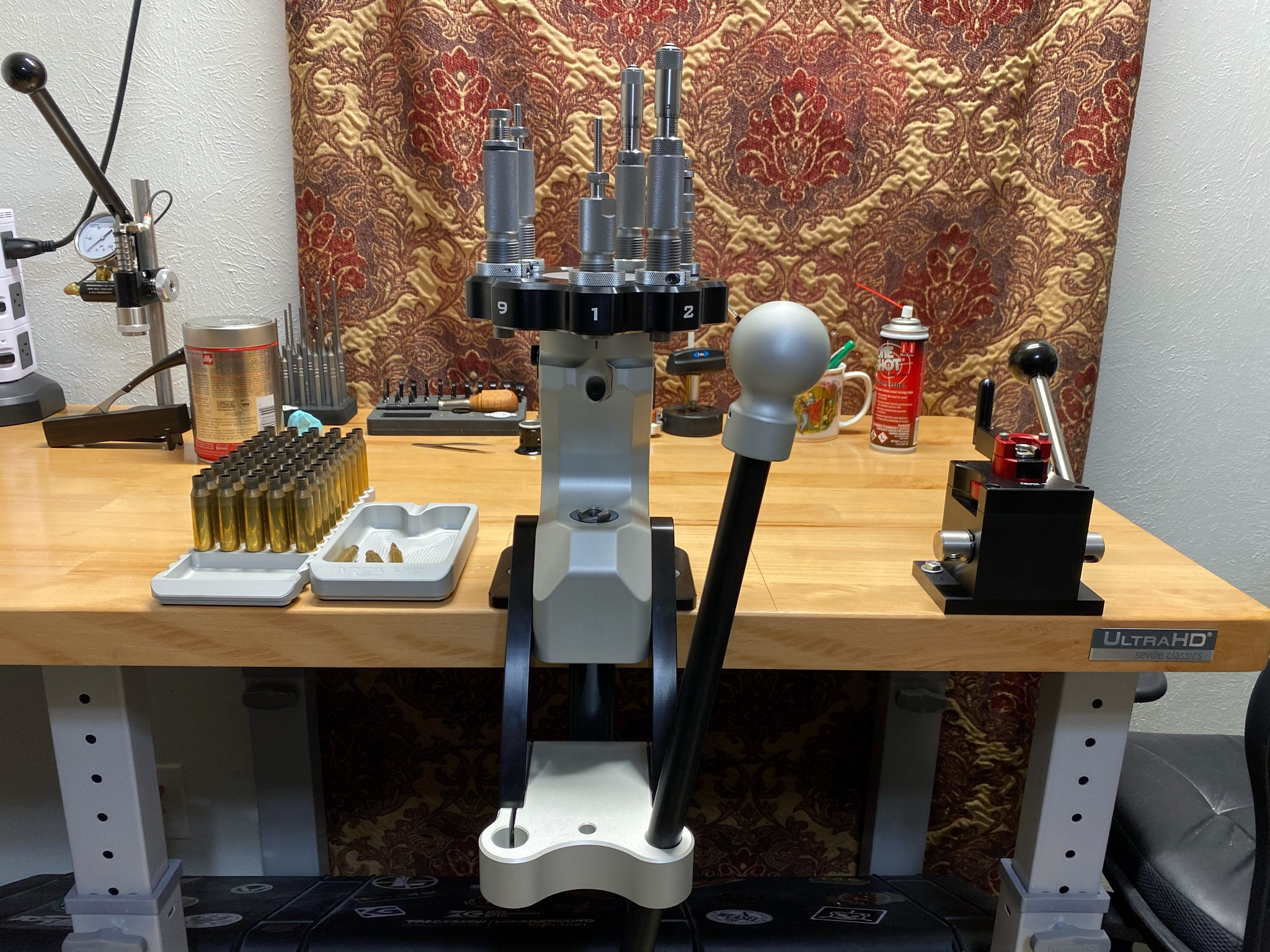

    Do it, I agonized over it as well, in the end very glad I went this route. While your at it get the Area 419 lock rings...

    I can swap dies in my Forster faster than I can move the turret and retorque my Zero press. The Zero is a work of art however I have not seen in difference in quality of ammunition between the two. You can buy lots of goodies with the price difference. That being said I will never turn loose of either one.
    Do you have to re torque every time you move the turret? I don't do anything on my turret press when I change?
