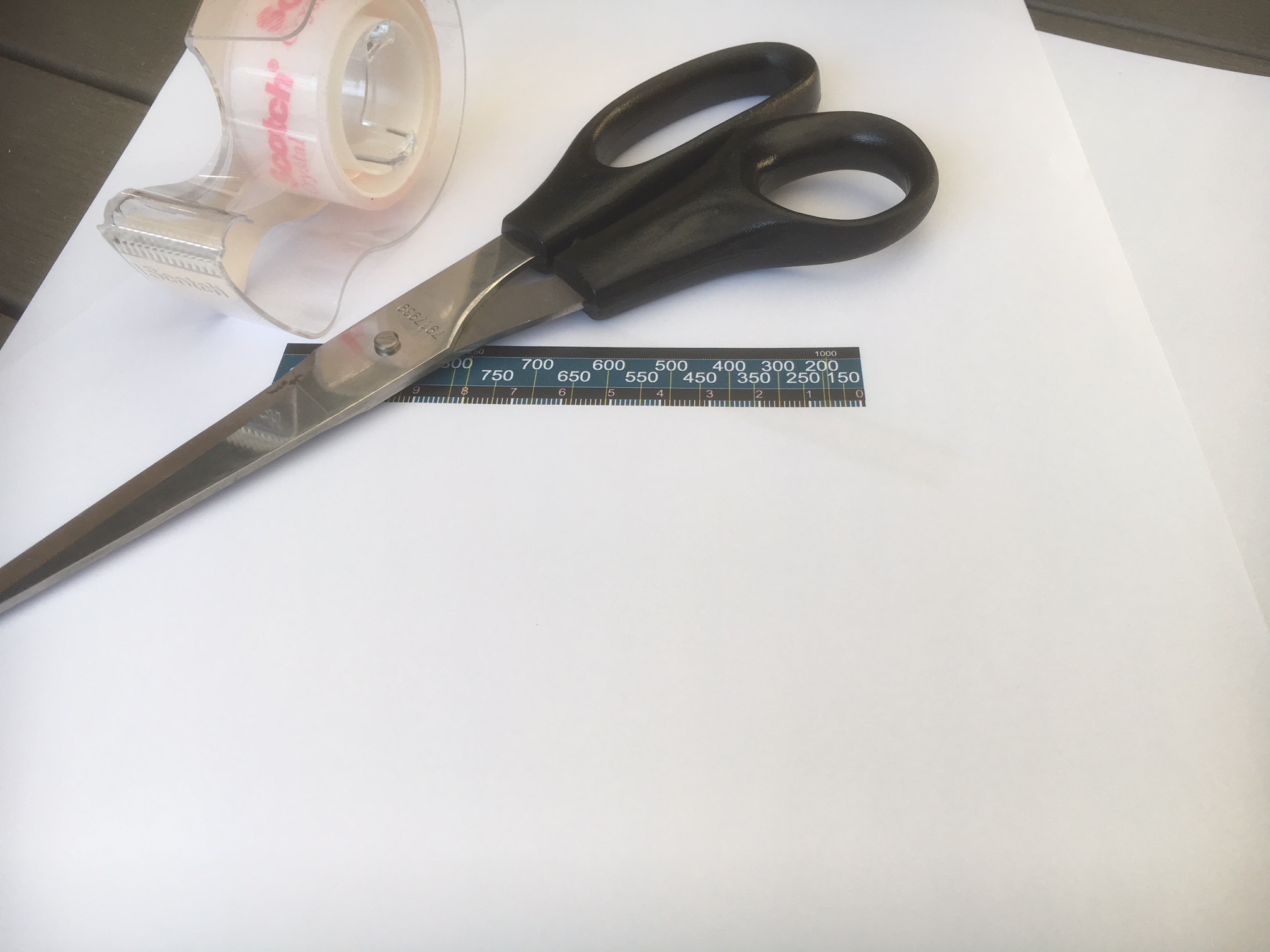

    Cut that bastard out, put tape at both ends, and carefully wrap it around and secure it. When I printed mine out, it ended up being 2.366" long (.003" short, boo hoo). Pretty damn accurate for a $50 printer boys. :)

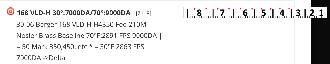

    I know this is an old thread - and hope nobody will feel I'm hijacking it. I've hacked together a small tool to easily create turret labels: http://turretlabels.com
    Feedback and ideas are welcomed

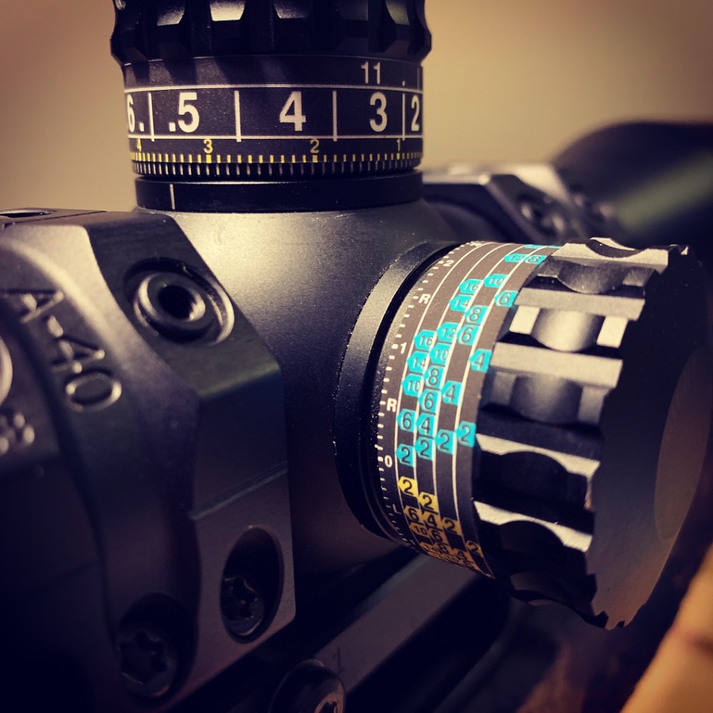

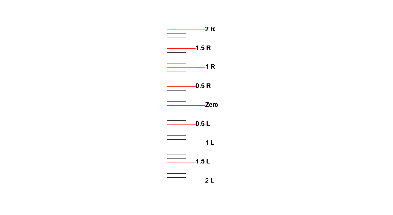

    Maybe the most common mistake regarding wind turret is to dial in opposite way, and something like this is useful in this case specially for scopes with no left/right clear indicators.
    If someone try to make something more complicated (depending also in the turret real estate) maybe something like this can help.

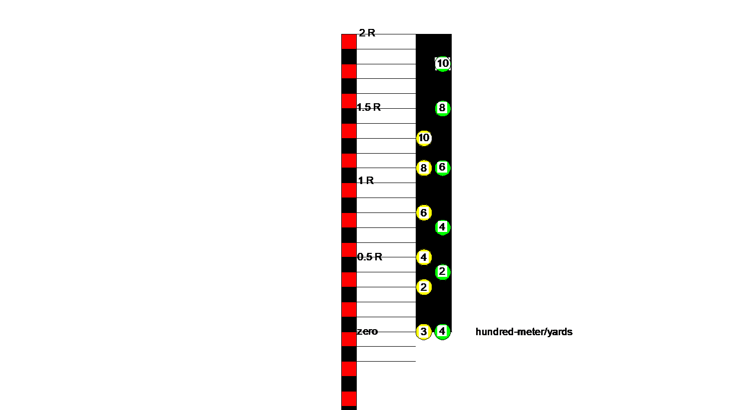

    On the zero line you have 3,4,5,6 etc this correspond to hundreds of meters or yards, on the scale you have normal units but with L,R for direction, also coded by colors connection for specific wind velocity (in m/s or mph) at specific distance.
    For example at 400 meters (on the zero line,green circle with 4 inside) for 2m/s I have 0.4 MIL correction (yes I know this is my BC method constant).
    I hope it helps.
    View attachment 6930515 On the zero line you have 3,4,5,6 etc this correspond to hundreds of meters or yards, on the scale you have normal units but with L,R for direction, also coded by colors connection for specific wind velocity (in m/s or mph) at specific distance.
    I hope it helps.
    I think I understand - I'm wondering if switching between wind speed and distances wouldn't be a better idea making room for more distances (have "columns" for different wind speeds, and various distances within those)?
    I've just implemented options for setting widths and colors for "partial unit lines", "half units" and "full units" - and think it's time to do some refactoring and UX work ;)

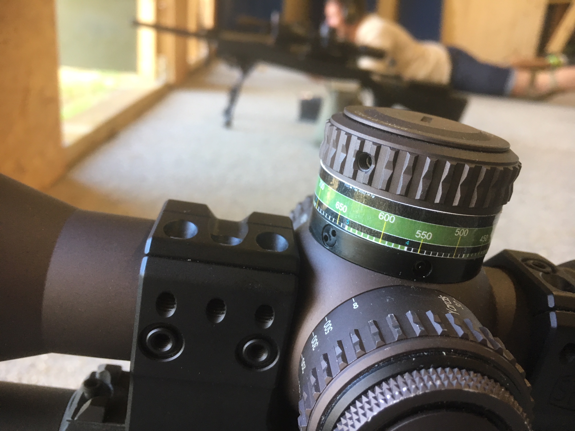

    Hi Guys,
    I have made some stickers with GIMP2 and printed them with a laser printer on sticking paper. Then I put one layer of cleas tape on top.
    It was a bit of a heck to scale it correctly on the printer.
    The uneven hight of the lines helps a lot in differenciating between them.

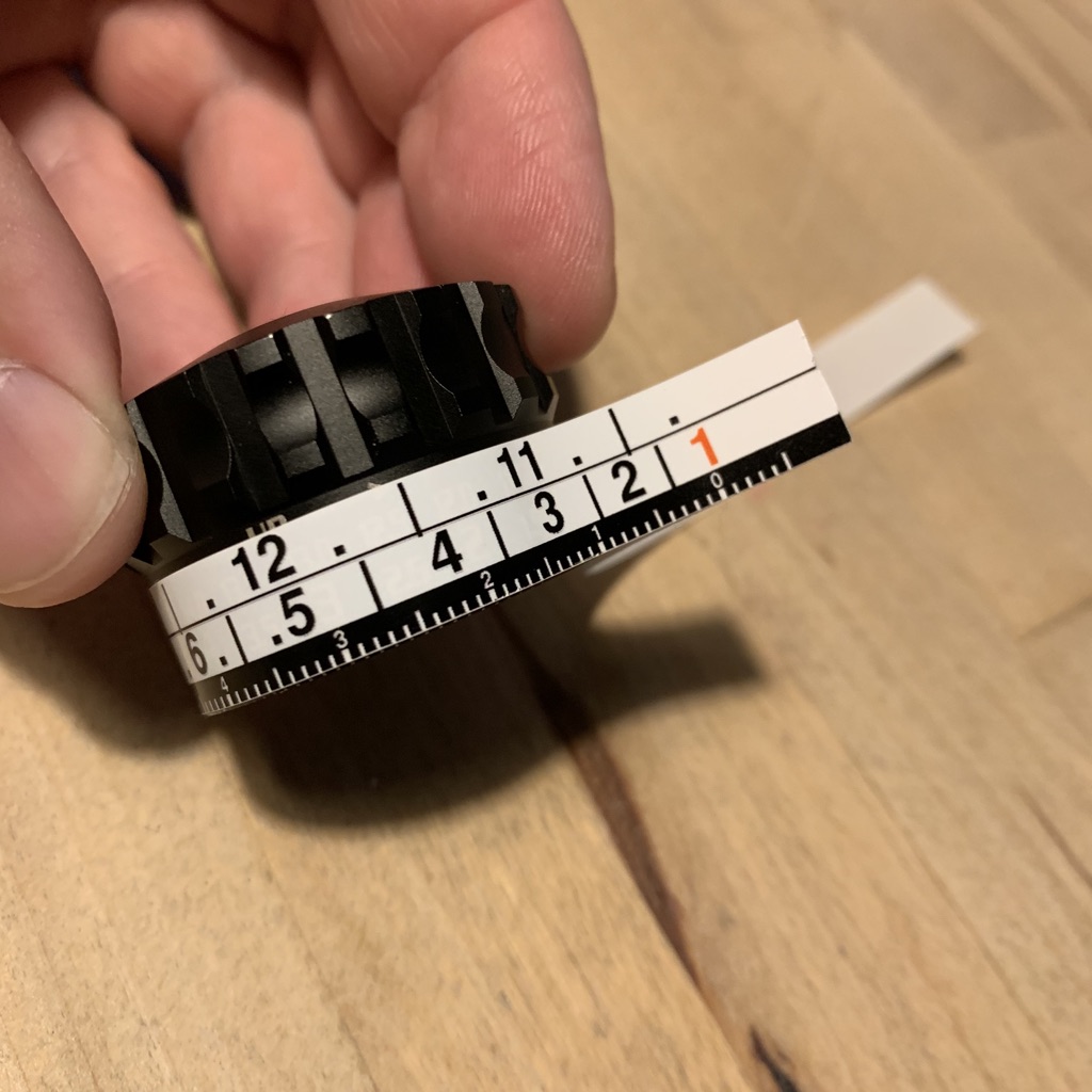

    Never mind! Got it figured out. Here is my first go attached to my Vortex AMG with my dope.

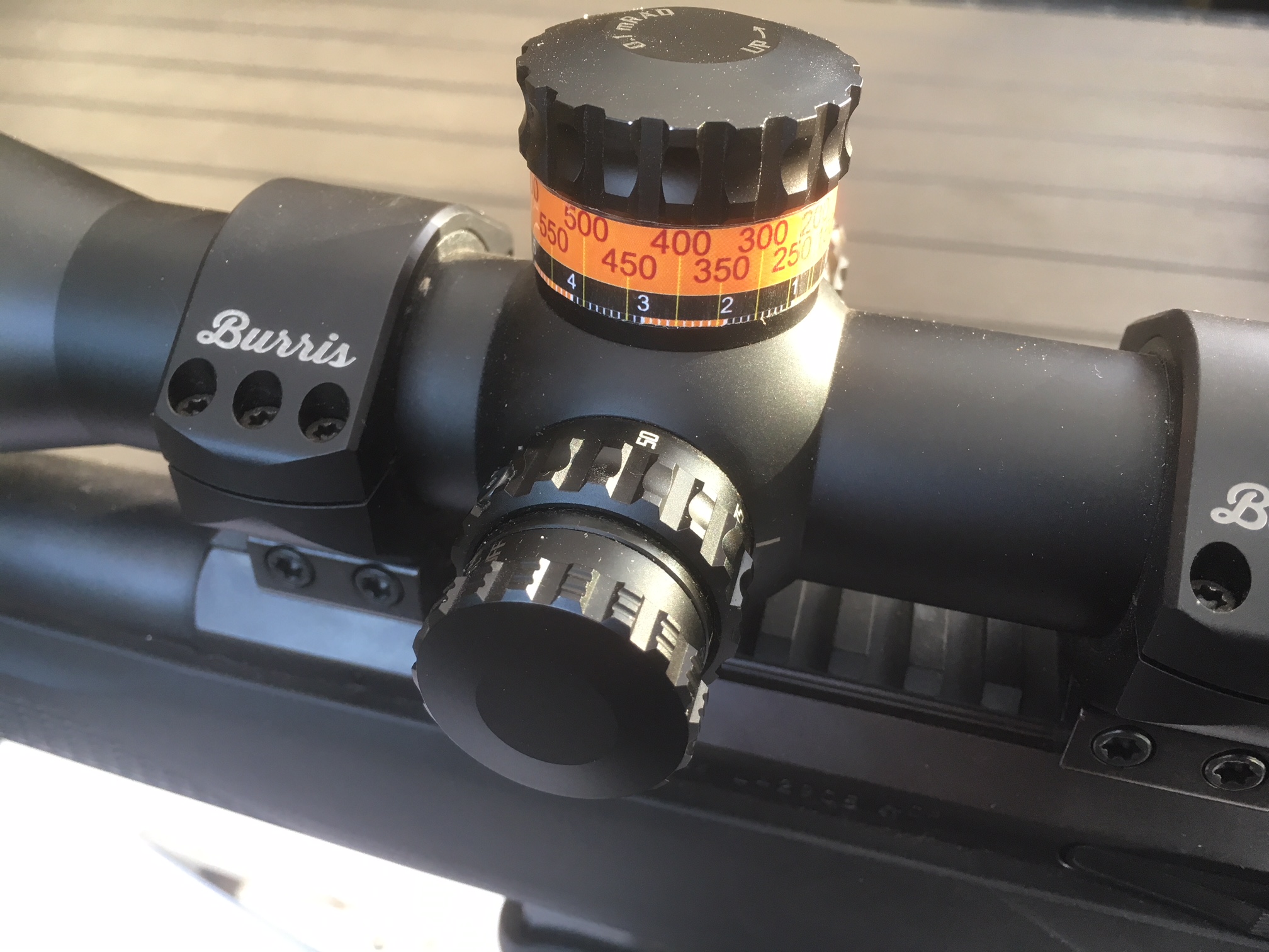

    I love seeing clever solutions like this! Outstanding job! Have you found that the adhesive stays put over time or do you have to replace them often?
    I've had a label on for a few months - normal paper with Scotch tape wrapped around it. I guess it depends on the weather, how often you adjust, how often you change loads, how often you play with some other color scheme you want to test ;)
