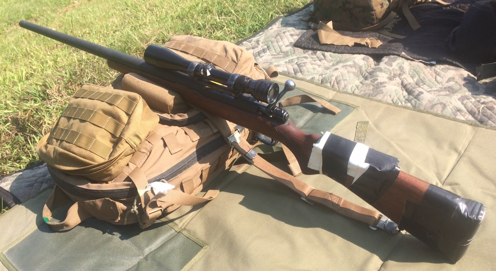

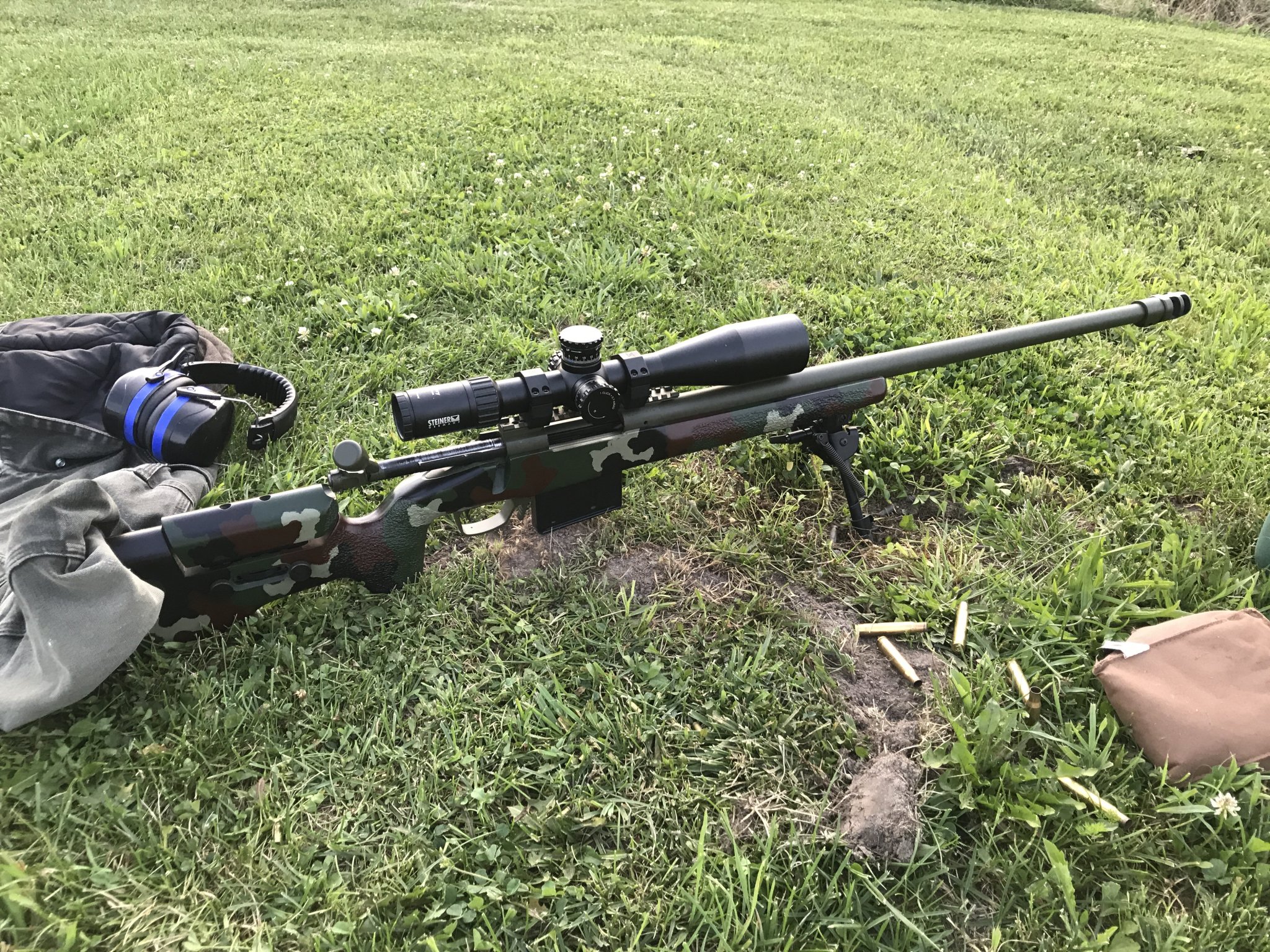

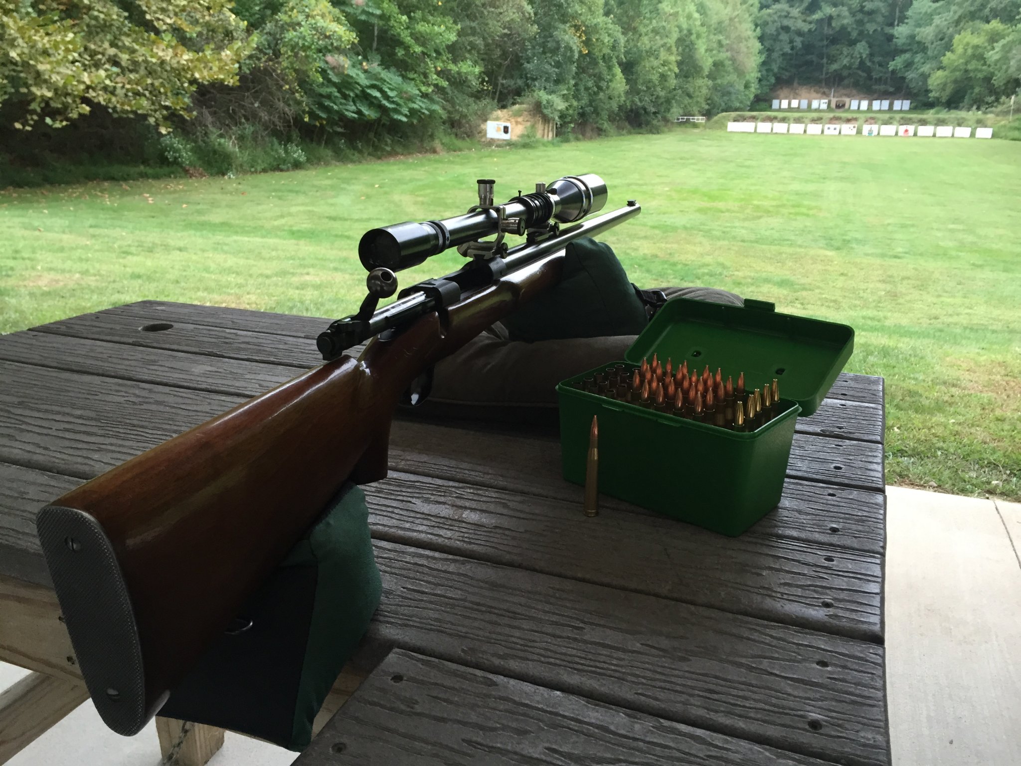

My Winchester M70 in 30-06, Bartlein barrel, pillar bedded, custom cerakote, limited edition anodized Redfield 3x-9x. Based on what Carlos Hathcock considered the ideal sniper rifle in the book "Carlos Hathcock, White Feather".
Very lovely. A similar setup or one like it in .300 Win-Mag is what I'm interested in doing.

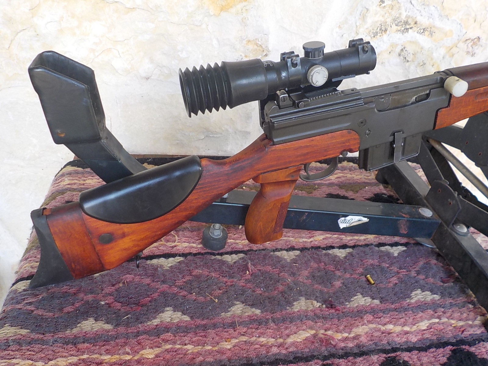

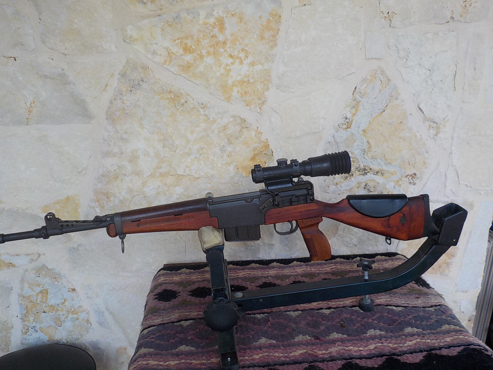

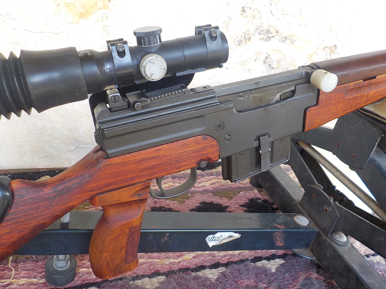

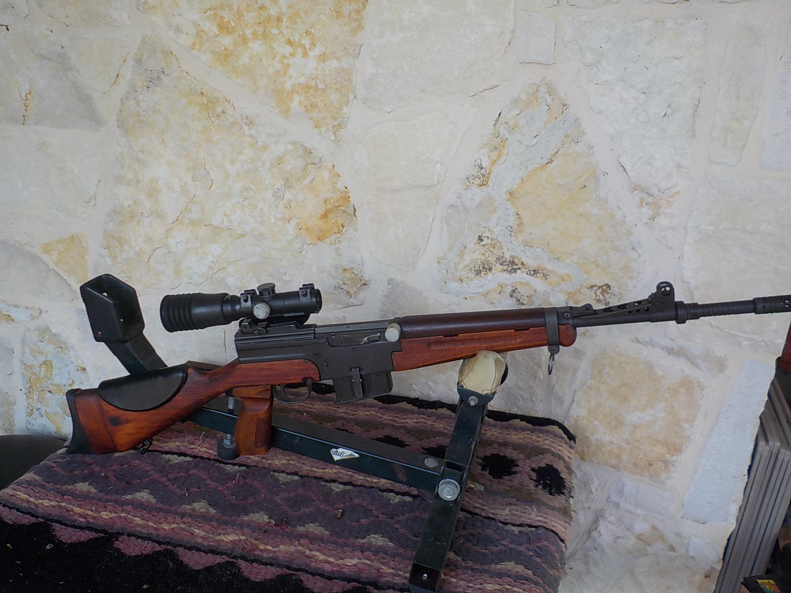

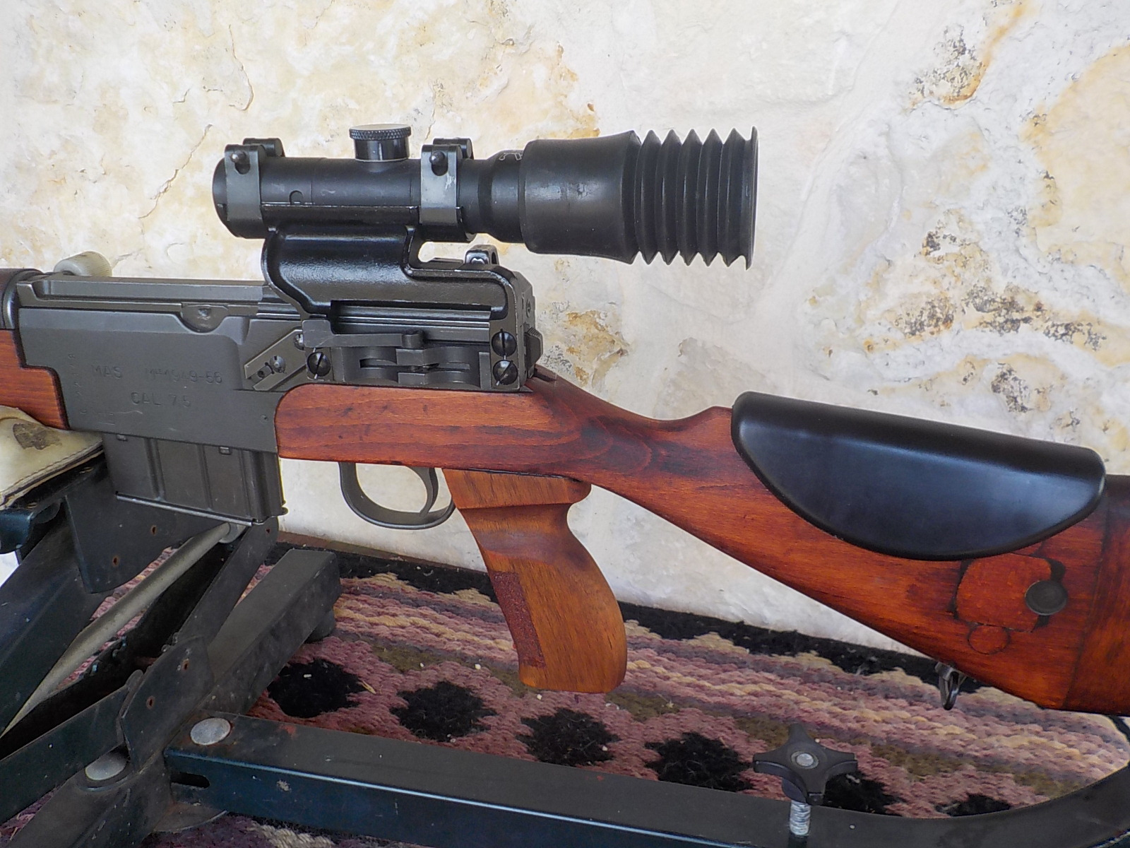

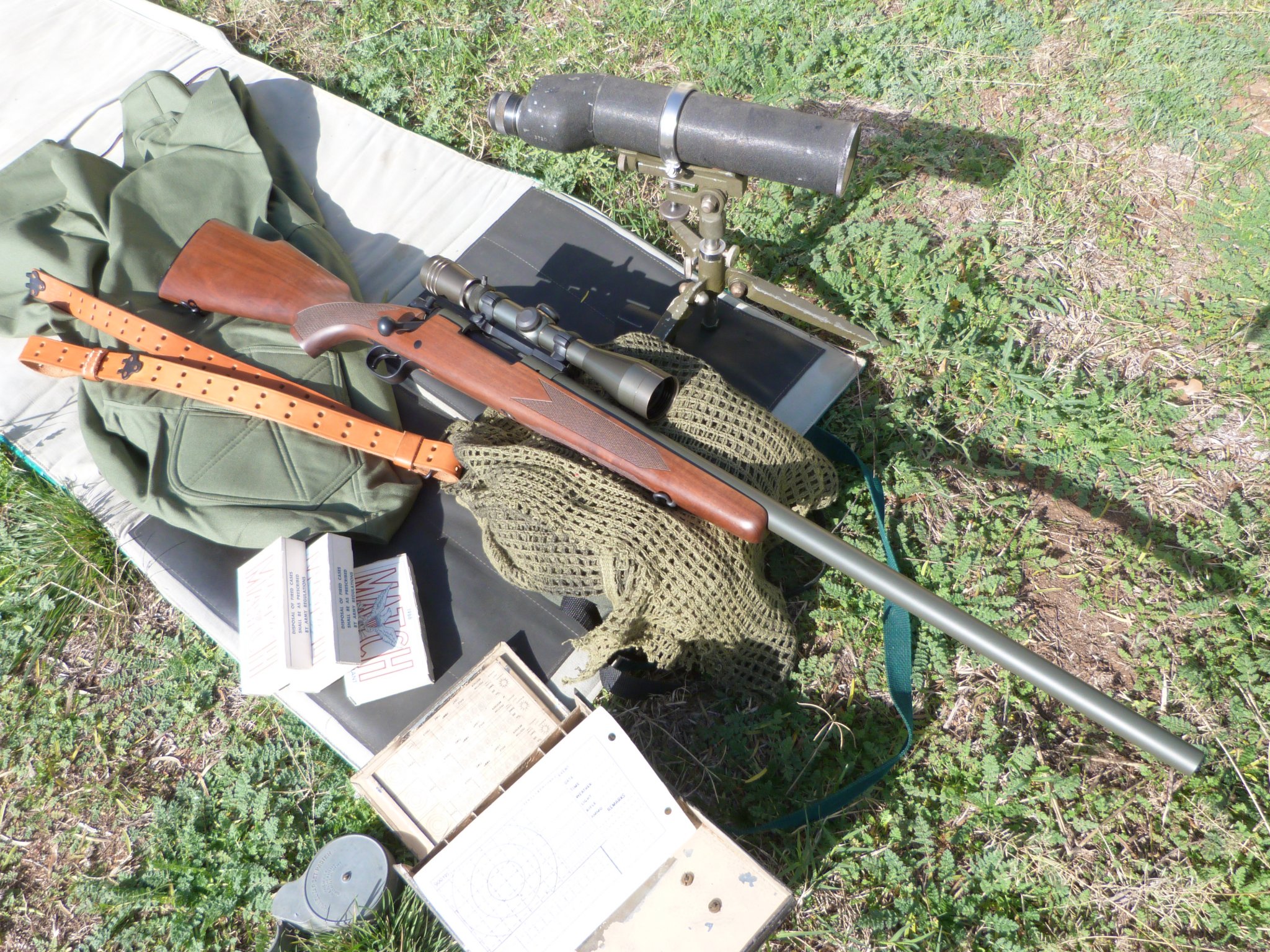

My MAS 49/56 MSE replica that I built. Original scope, butt extension and cheekpiece. Buttplate and stock are copies.
The MSE (Modified St Etienne) version of the MAS 49-56 was developed specifically for international competition shooting by French military teams. The standard MAS 49-56 service rifle was much more of a combat weapon than a target rifle, and the MSE improved several of its shortcomings in that arena. Most significantly, it added a longer stock and a proper pistol grip to improve handling. The MSE also has a substantially improved trigger and iron sights with much finer adjustments that the standard rifle. These elements were combined as a kit of upgrade parts to be dropped onto a regular 49-56; the MSE was not made as a complete new rifle. Only some 900 were originally made, and they are often faked today.
Oh I like that! Same reason I put an M14E2 stock on my own all-USGI-but-the-receiver rifle; full pistol grip just handled better.

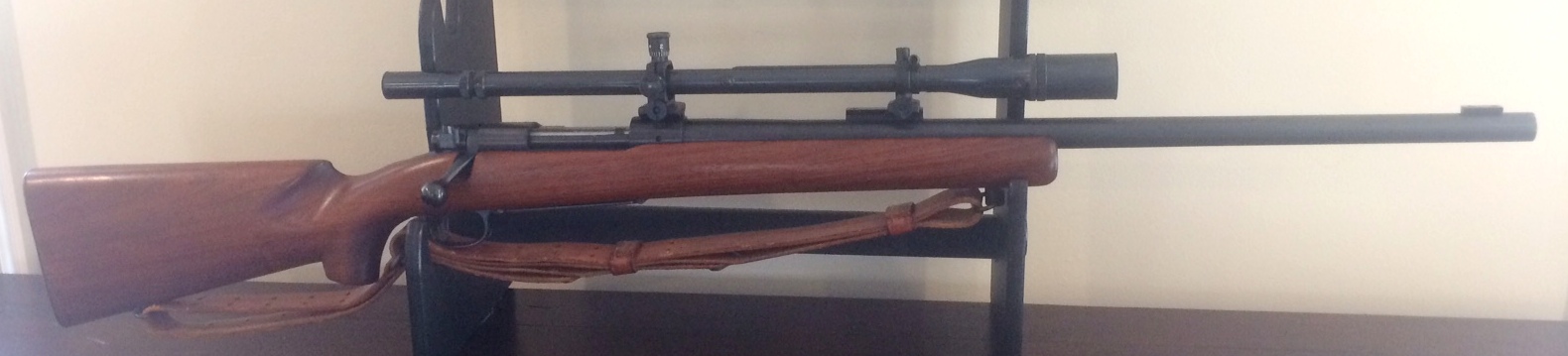

One of my shooting buddies had a pre-64 built with a heavy 26" Douglas barrel, routed Sporter stock, a vintage Redfield 3-9x scope, and an improvised cheek pad on the Sporter stock. It shot well at a Quantico vintage match a couple of years ago. Its a bit heavy, but a good USMC replica build...
7121130

My shooting buddy had pre-64 built with a heavy 26" Douglas barrel, routed Sporter stock, and a vintage 3-9x scope, and an improvised cheek pad on the Sporter stock. It shot well at a Quantico vintage match a couple of years ago. Its a bit heavy, but a good USMC replica build...

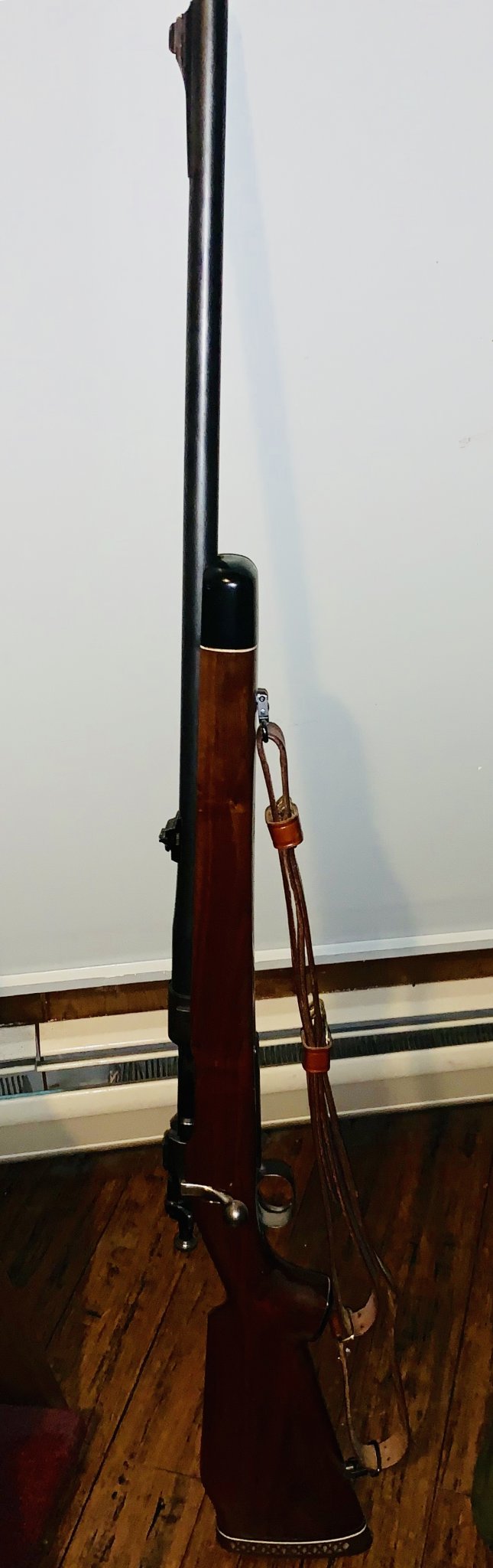

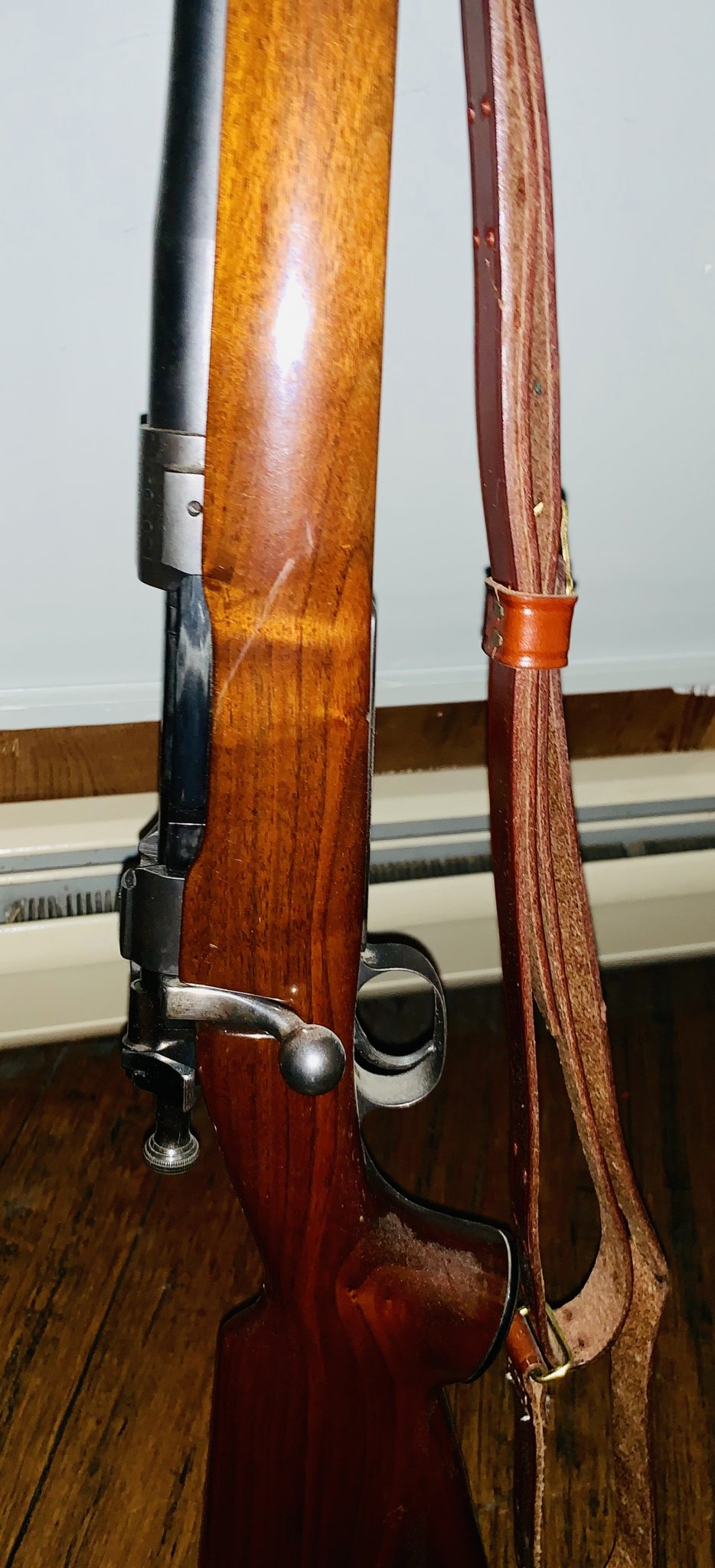

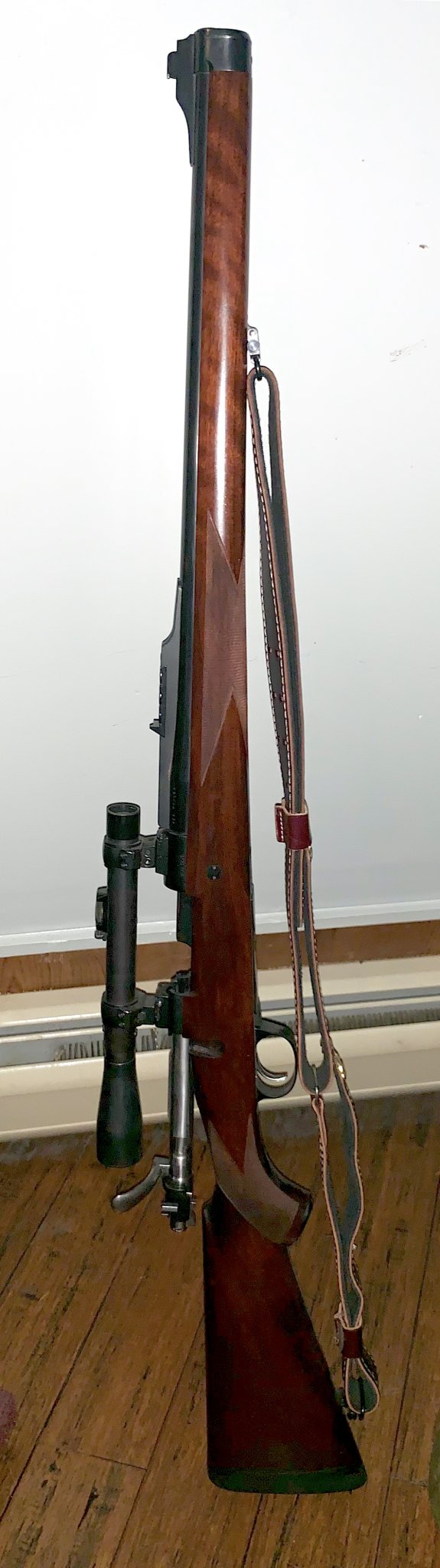

Well in seriousness... this rifle was built for the OP’s purpose. It has taken a Cape buffalo and a bison.

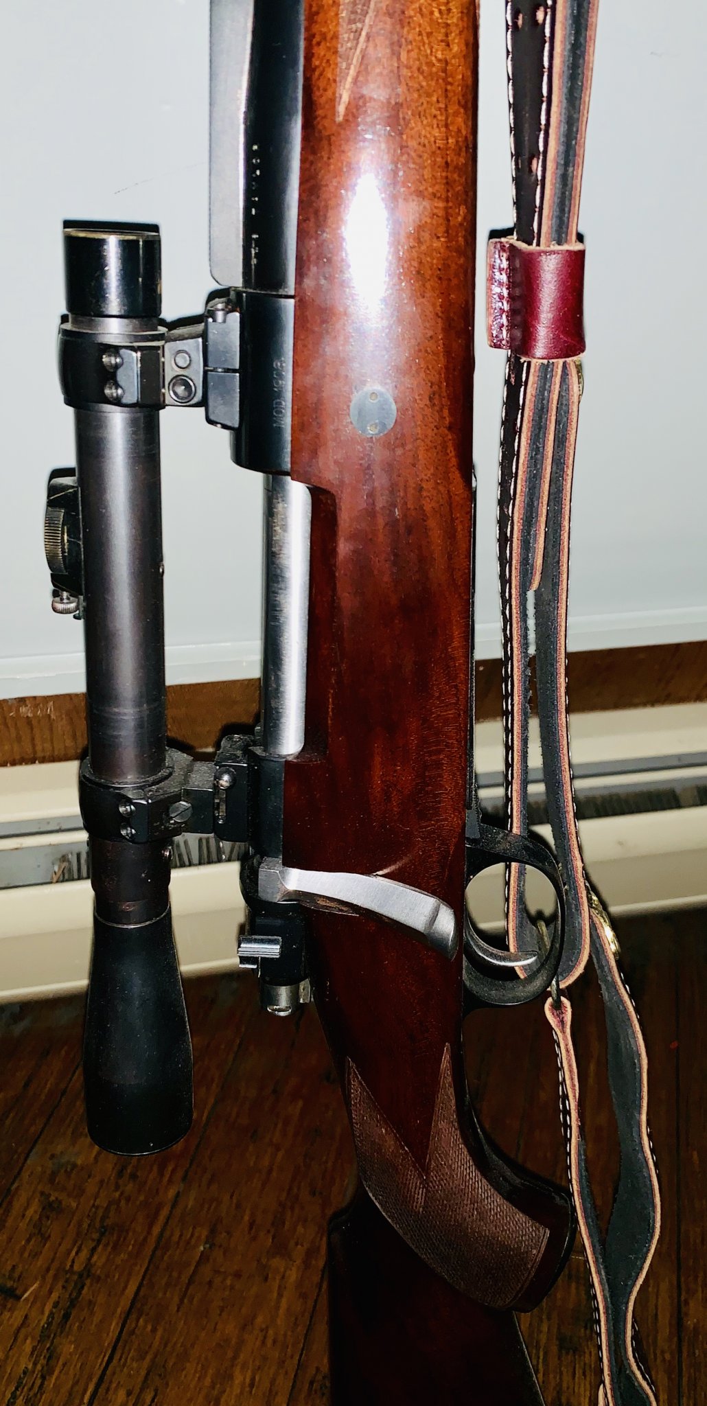

.416 Taylor on a Mauser action. Mannlicher stock, butter knife handle. Prewar German Kahles On QD mounts and express sights.
It is everything an old Africa hand would want. As it was built by one.
And, yes, this is the one I used on my Bison a couple of years ago. Wherever those
Pix went...

03 Springfield in .458 Magnum. Open sights. Fajen stock. Smooth as butter to cycle.
Punishing with 500 grain Barnes solids. But loaded down to a .45/70 charge, it is a big soft pussycat as all that weight absorbs the recoil very nicely.
This gun would be 100 Percent at home in Africa.
