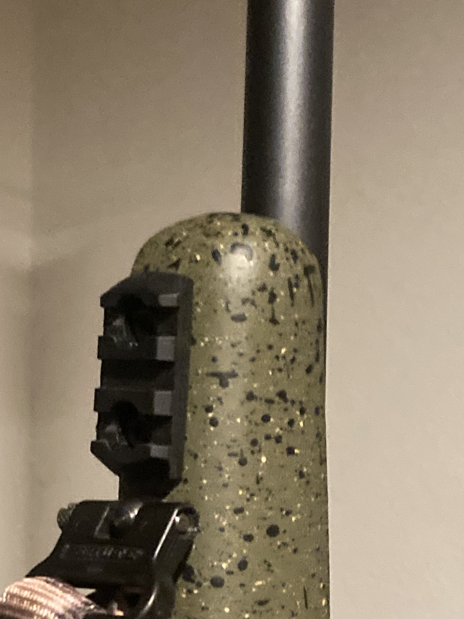

This works if you are willing to drill some holes.
Reactions: Balor

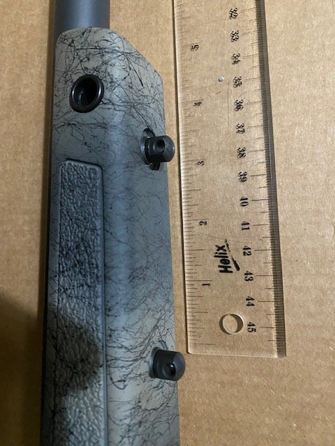

it seems that I'd need a rail (at least 4" long) that will center between both post that are 3" apart... but then, where would I attach my sling.
Use the front hole as your base, drill a second for rail and leave the second stud for a sling. You don’t need that much railestate for bipods

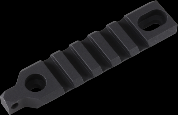

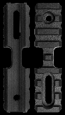

if going to a gunsmith, look at something like this from Seekins who make high qual stuff:
1. This is their Universal mount. Use the front sling stud location for the hole and have another drilled and fastener installed for the slot.
https://seekinsprecision.com/ubm.html
2. Their SRS rail
I put the SRS rail on a Rem 700 in an HS Precision stock. They make these to fit HS, Bell and Carlson, and McMillian fiberglass stocks. It will be too short to match up with your sling studs, but again...if going to a gunsmith then a new fastener/screw position is easily done. For me, this got rid of the rear sling stud but provides a sling mounting hole in the back. Worked wonderfully (and yes, I installed it myself and managed to not break anything! haha). If you went with this, you wouldn't need the rear sling stud and you can have it removed and plugged up by the smith.
Note, I'm not one of the gunsmithing experts here and others may correct any inaccuracy or bad advice I've provided.
Best of luck and welcome to the Hide...the rudest rifle forum on the net! hahaha
P.S. these Seekins items can be found from other retail sources other than Seekins if out of stock. Amazon, Midway, etc. Just make Google your friend....or, your gunsmith may have other brands/sources that they prefer.
Cheers
there are options to use the sling mount to attach a rail section, without losing the sling mount.
there are also rail sections that include a cup for a sling attachment.
The SRS Rail that Baron23 mentioned will fit without any stock modifications.
You remove the two sling swivel studs and use screws to mount the rail, the holes between the stock
and the rail match. I have used this setup.

@CValero - read below, its a VERY easy answer to your issue
Scheisse, I saw where she said she needed 4" but missed the part where she said it was 3" center to center of the studs. Yeah, ADD strikes again (and its really embarrassing when you are 71! haha).
So, yes...the McMillian version is indeed 3" center to center and would work perfectly for her and fageddaboud the gunsmith! haha The HS and B&C ones are shorter.

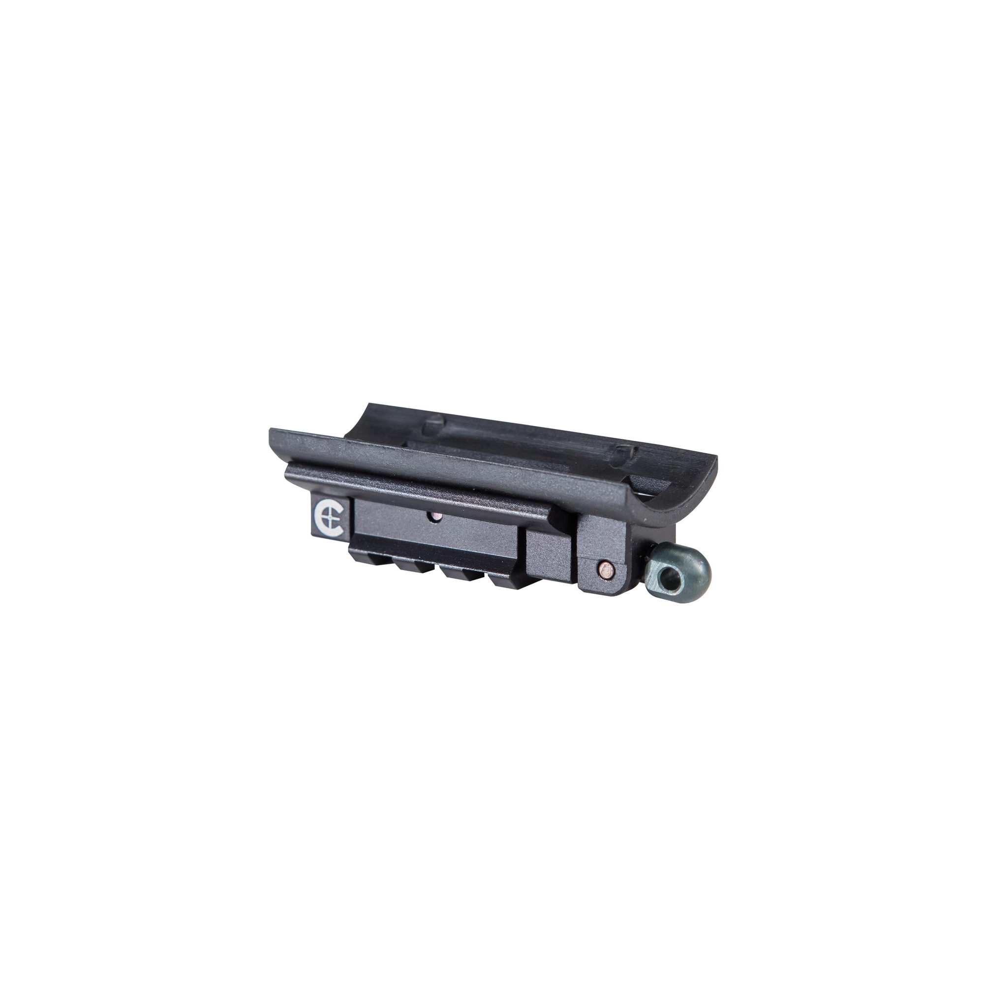

And a Harris on a pic adapter may well be exactly what this gal needs. Not too much money and I gather she's a beginner so $300 for a bipod plus another $35-40 for a piece of pic rail to mount to may be too much for her at this stage.

Yes, that seems perfect. The swivel studs are 3" apart, and the slotted hole should compensate for any variation in length of the rail. I noticed in the picture the also rail has a horizontal hole to accommodate a sling.

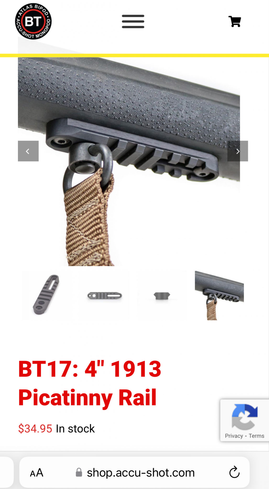

If I'm not running an ARCA rail, I like the B & T Pic Rails as they have a flush cup for sling attachment machined into the rail.

2. If Harris, then get a pic rail adapter for it: https://www.google.com/search?client=firefox-b-1-e&q=picatinny+rail+adapter+for+harris+bipod

4. Get a piece of pic rail with 3” holes on center. I absolutely like the Seekins SRS for McMillian as it’s made for 3” hole spacing and has a sling attachment point
5.i have zero idea why some are recommending a pic rail with a flush cup hole. You have a Bergara. It has a sling stud on the back, NOT a flush cup for QD sling attachment. The idea of getting a sling with QD on one end and a regular sling stud type hdwr on the other is, IMO, nonsensical.

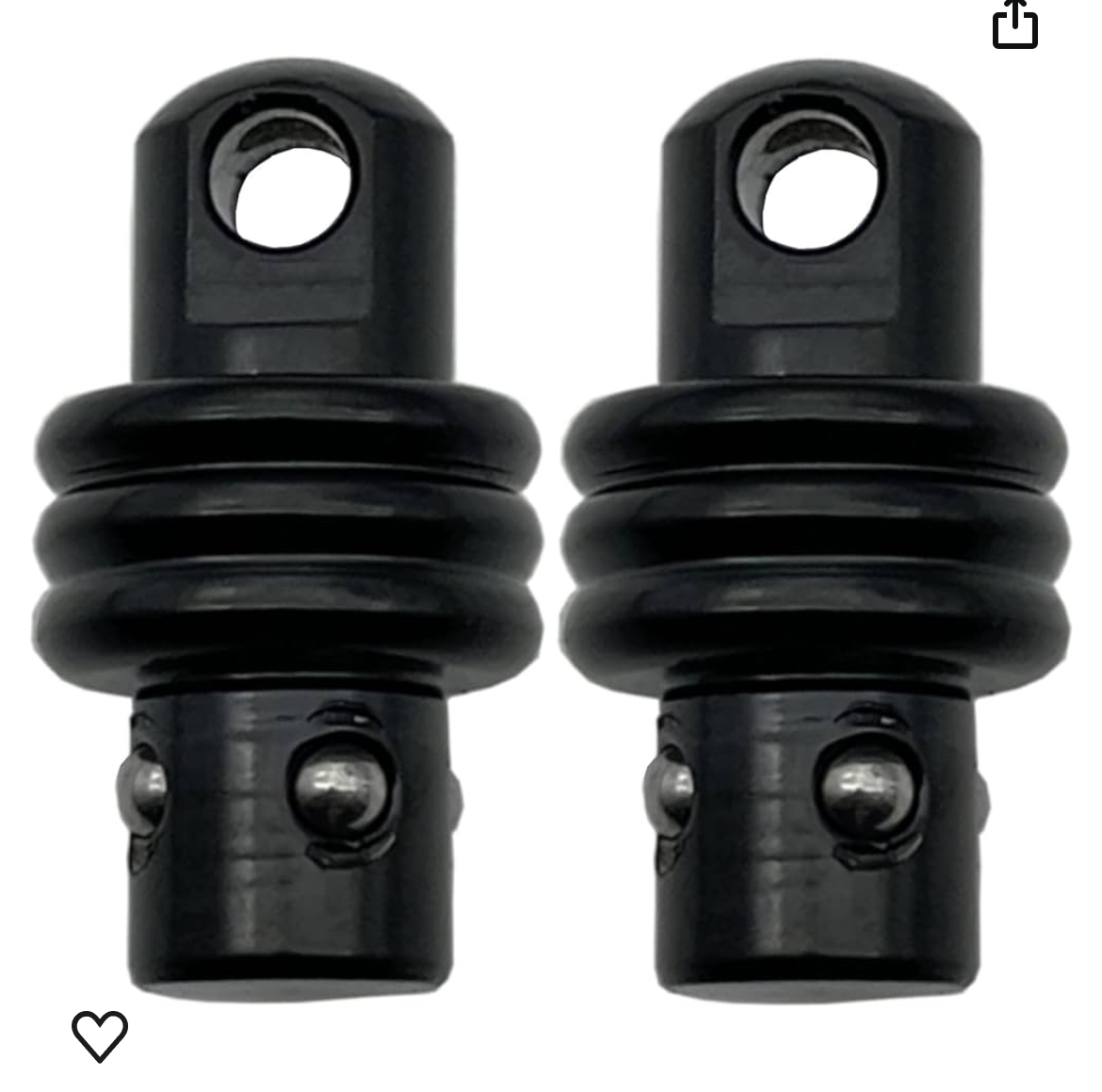

I think I like this the best, just not sure if the 'swivel' hardware for the sling comes with the rail. I'll find their number and give them a call. Thanks!
If you mean the swivel for your sling, then you would be correct, as was Baron23 to a point. You would need this in addition, for your current sling. I don’t want to mislead you.
Dang, Amazon has made it hard to copy their pictures.

So, am I off base about flush cups/QD hdwr not being optimal for Cheryl's gun? Her Bergara has sling studs forward and back. If she went with a pic rail with a cup for QD hdwr, then she would def have to go to a gunsmith to have a flush cup installed in the butt stock. Or, have a very weird sling with different type of hdwr at each end.
If she stays with a piece of pic rail like the Seekins SRS, then it fits her forearm hole pattern, has a bit of a slot to allow for some fuckupedness in hole placement by Bergara, and she can use a sling that has regular sling swivel hardware.
I was def not taking any shots at anyone's recommendations to Cheryl in the thread above, but I don't understand how a flush cup up front would work well for what she has.
Cheers
I saw your posts.
So, say she puts that BT pic rail you posted with the flush cup, what does she do in the butt stock that currently has a sling stud?
She uses her existing sling that attaches to two studs, front and back. That’s what the flush cup to sling stud adapter is for. It goes in the front on the rail. What are you missing? Pictures above say it all.
Here it is again:
Sling stud adapter goes into the flush cup instead of the sling with QC already on it. Now she has a sling stud that’s there all the time.
Here it is again:
What I’m missing is why the heck she would want to put an adapter in the middle just to use QD hdwr.
What’s the advantage to her of QD to justify putting an adapter inline vs just using a pic rail with attachment point for a regular sling swivel?
Cheers
Cheers
‘Cause options. But like I said above, each to their own.

Going to a gunsmith is a good idea. Many of us are not handy with tools. As for me, breaking stuff with hand tools is my super power lol). Just drilling a hole isn't all of it. Your sling studs have a captive fastener on the inside of the barrel channel...possibly (probably) covered by material. A new hole should also have a captive fastener inside and epoxied in place. Simple job for a gunsmith.
2. Their SRS rail
Cheers
Just FYI..., I did end up buying the 'Seekins' SRS Bipod Picatinney Rail w/the 3" spacing as well as the Atlas BT46-LW17 PSR Bipod at the Standard height with ADM-170-S Lever. Even got a military discount and free shipping. You guys are great!
Reactions: Baron23 and lash
