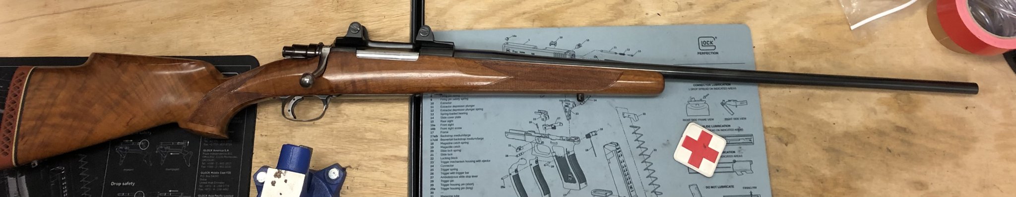

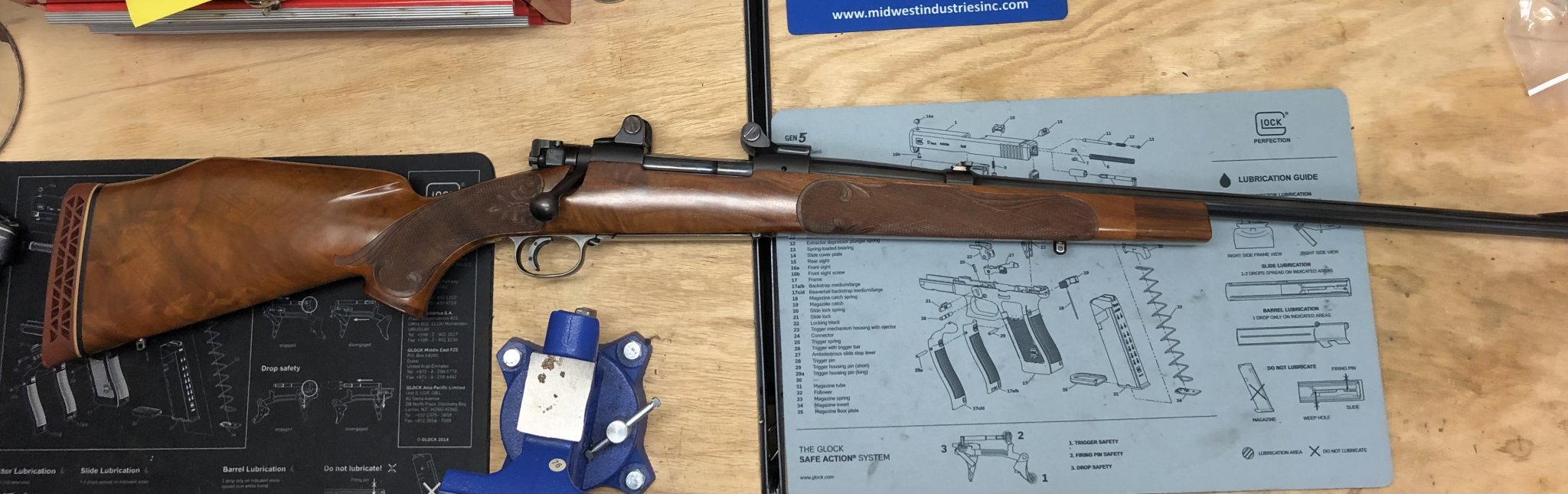

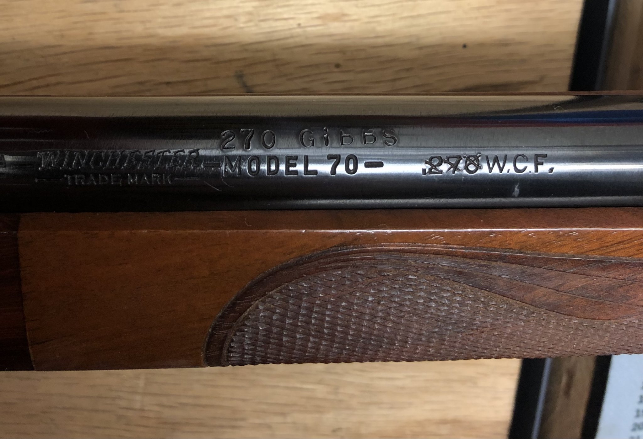

A pre-64 Winchester Model 70 originally chambered in .270 WCF, rechambered in .270 Gibbs.
and what I believe is a sporterized Mauser (I wish I was more knowledgeable with these rifles to be able to better ID the action) chambered in .240 Gibbs.

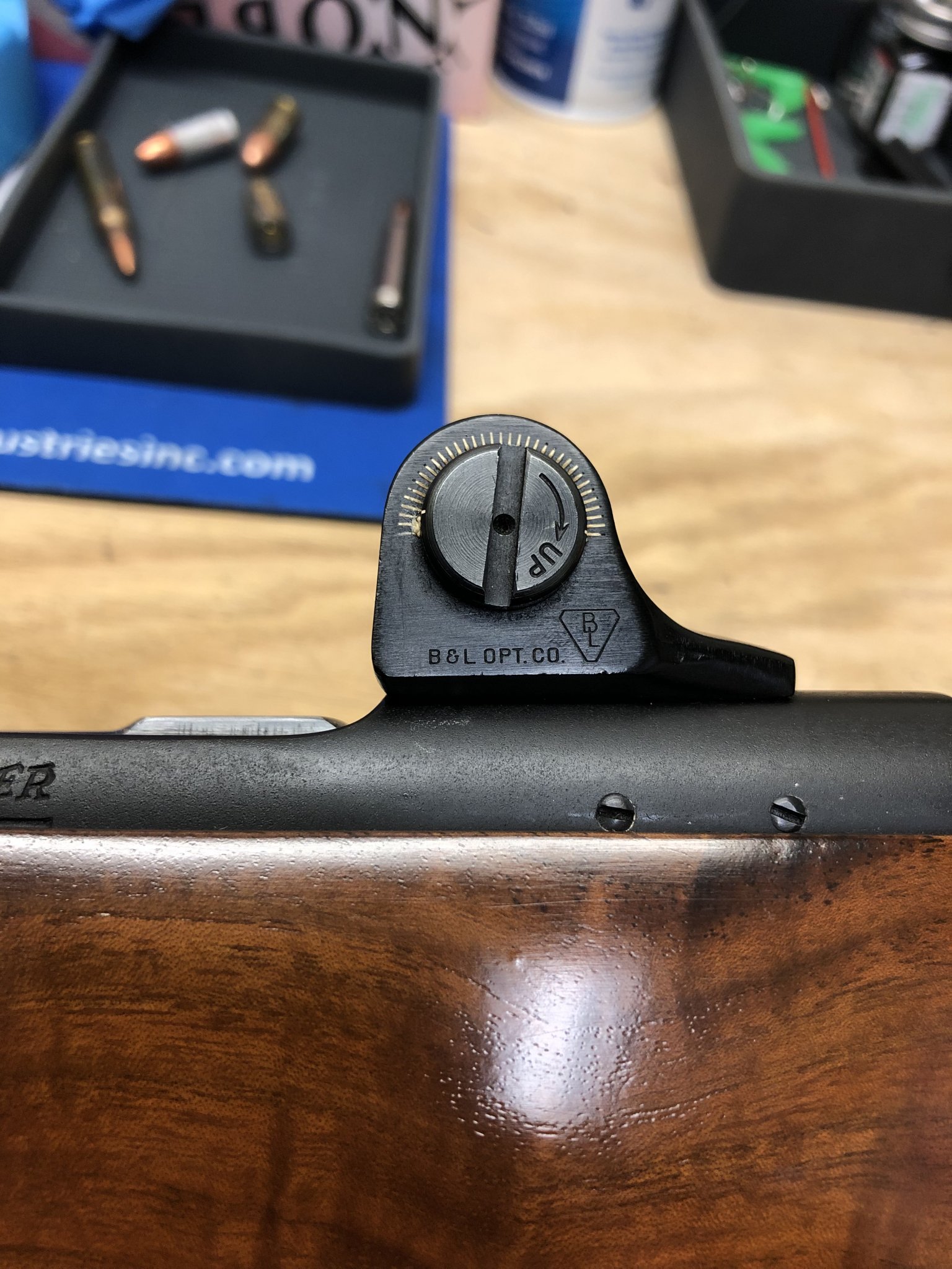

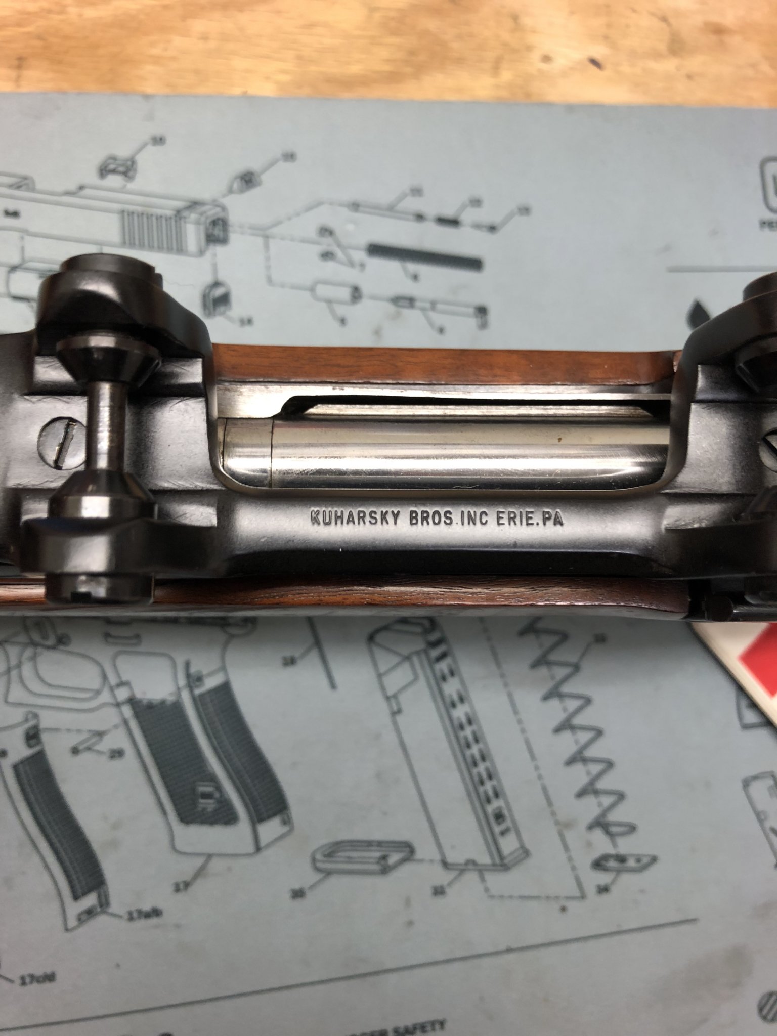

The .240G has a windage/elevation adjustable Kuharsky Bros scope mount.

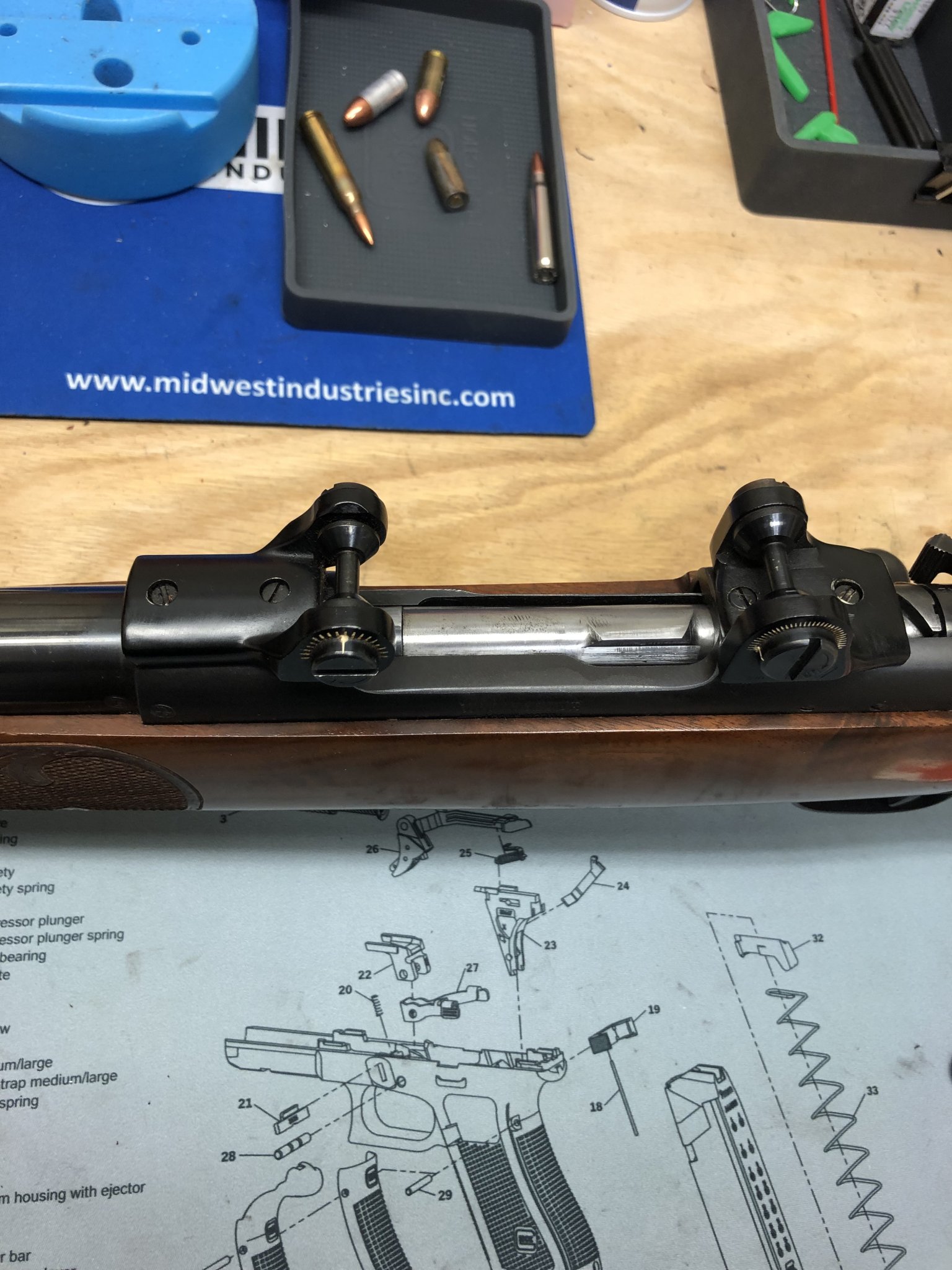

The .270G has a windage/elevation adjustable B&L Opt. Co. (early Bausch & Lomb) scope mount.
Neither included rings…

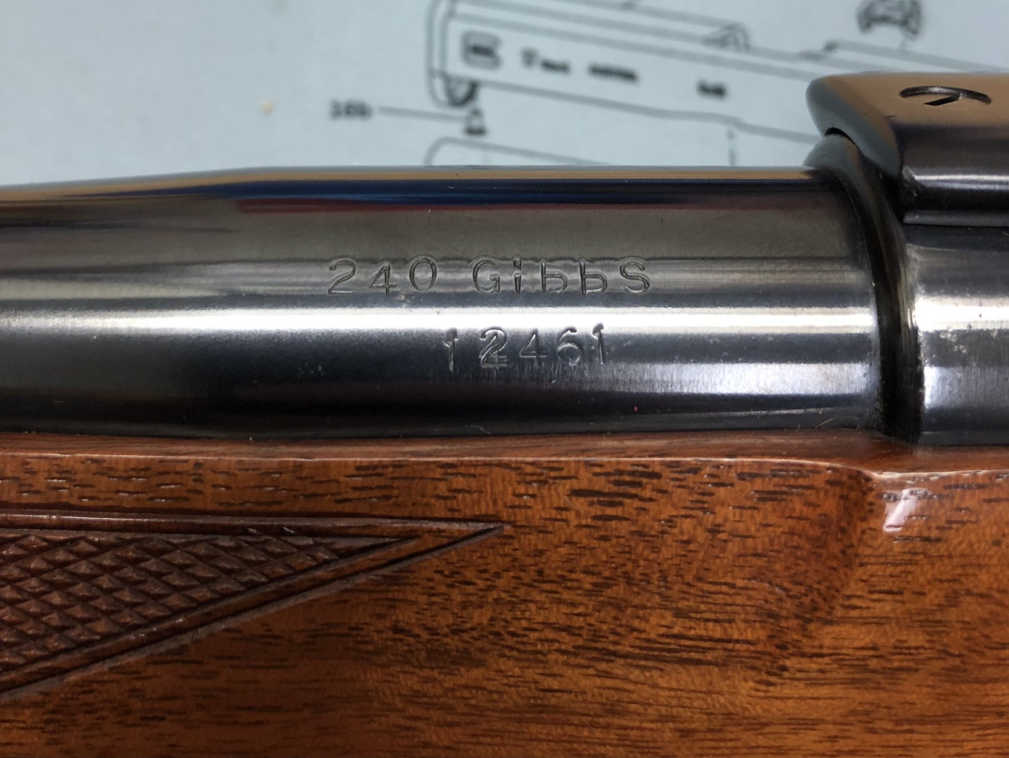

They both belonged to his grandfather, and he was told by family that they were both chambered by Rocky Gibbs himself (no documentation, but pretty neat). Geography alone makes me suspicious that’s probably not the case (Rocky lived in Idaho, and my FIL’s family is from Ohio) but anything’s possible and I have no idea where his grandfather lived throughout his life prior to settling in OH.

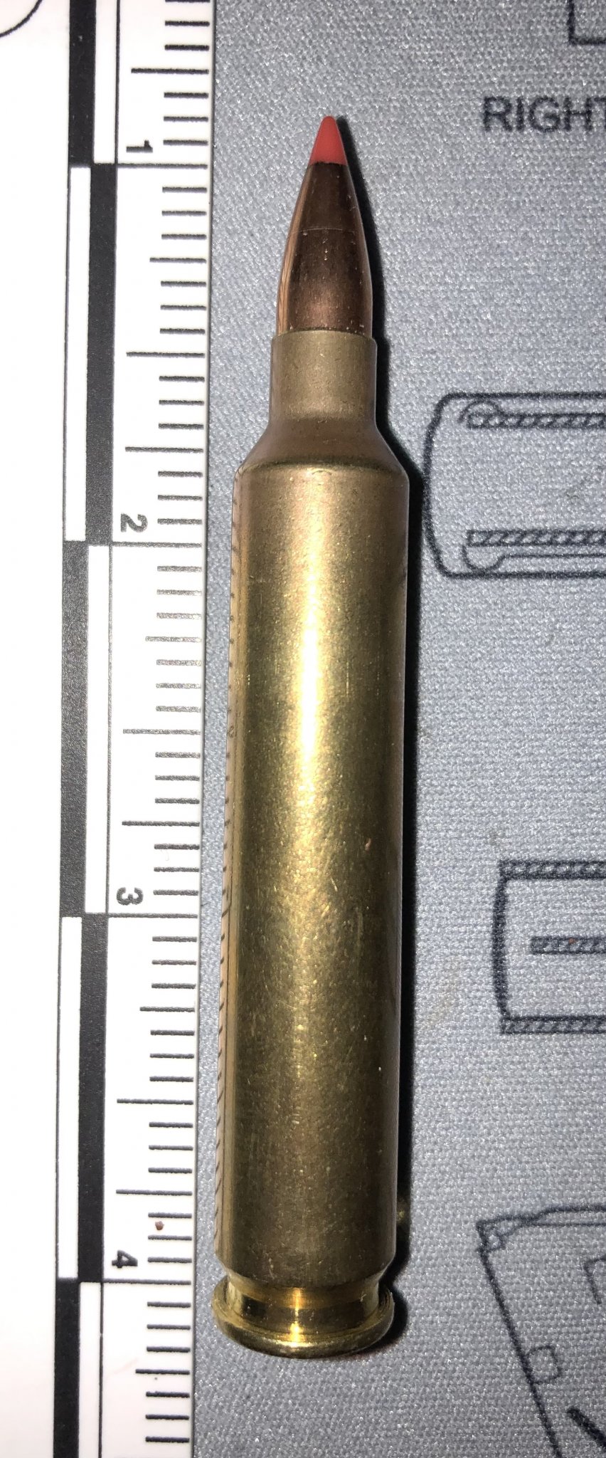

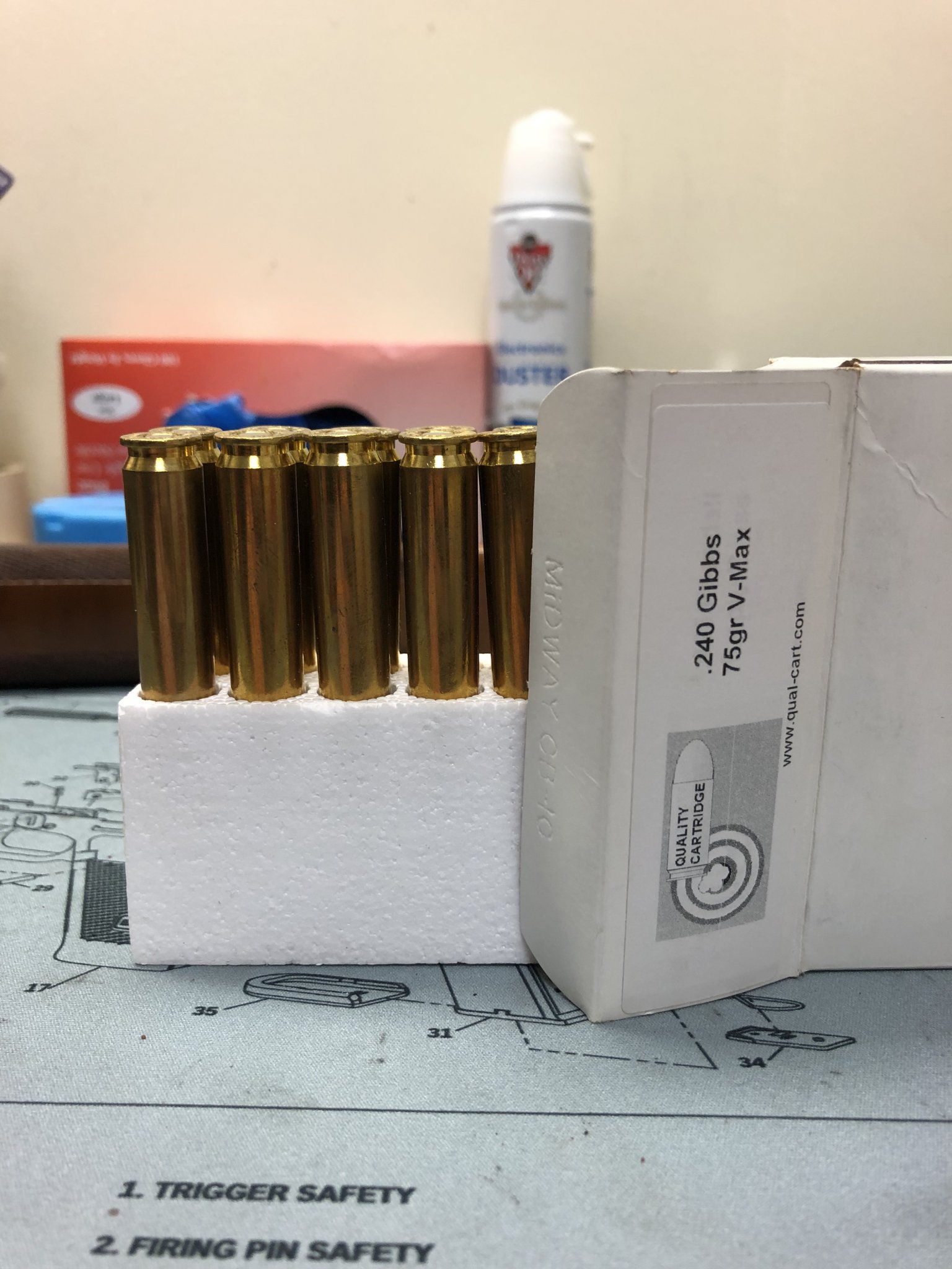

Luckily, he also gave me 40 rounds of Quality Cartridge produced .240 Gibbs factory ammo (75gr VMax) so at least I have 40 shots, plus the remaining factory new brass to play with. Apparently they did a short run of factory ammo for this caliber, and my FIL’s brother had the forethought to buy a small amount while it was available.

  • I need to find scope rings for the corresponding mounts the rifles already have. I think they’re neat, and I’d like to keep them if possible.

I dunno... he's talking about wildcats but showing boxes of loaded factory ammo. ;)

Those look like a small reloading outfit producing ammo to me. There are/were some commercial custom reloaders out there.

I don't know if Qual Cart makes loaded rounds. But they still make some of the best small lot wildcat brass out there.

The 270 Gibbs is another cool one. Basically Rocky Gibbs saying "Let's take a really fast 270 and make it go even faster by stuffing more powder in a case!

I didn’t / don’t know either, but it’s got a bullet weight on the box so I figured they must. Good to know.
Apparently Quality Cartridge used to offer custom loaded wildcat ammunition, but not anymore.

Does anyone have any idea if the Kuharsky Bros and B&L mounts were all (respectively, per company) the same optic ring setup across all their models? In other words, are the windage/elevation adjustable crossbeams on the mounts all in the same location/spacing, and any ring insert from each respective manufacturer would fit any mount from the same manufacturer? For example, could I buy a Kuharsky mount/rings originally produced for a Sako rifle’s spacing, toss the mount into a drawer or resell it, and use just the ring insert on my Kuharsky Mauser mount? Same idea for the B&L? It seems it would make sense from a production logistics/manufacturing cost standpoint.

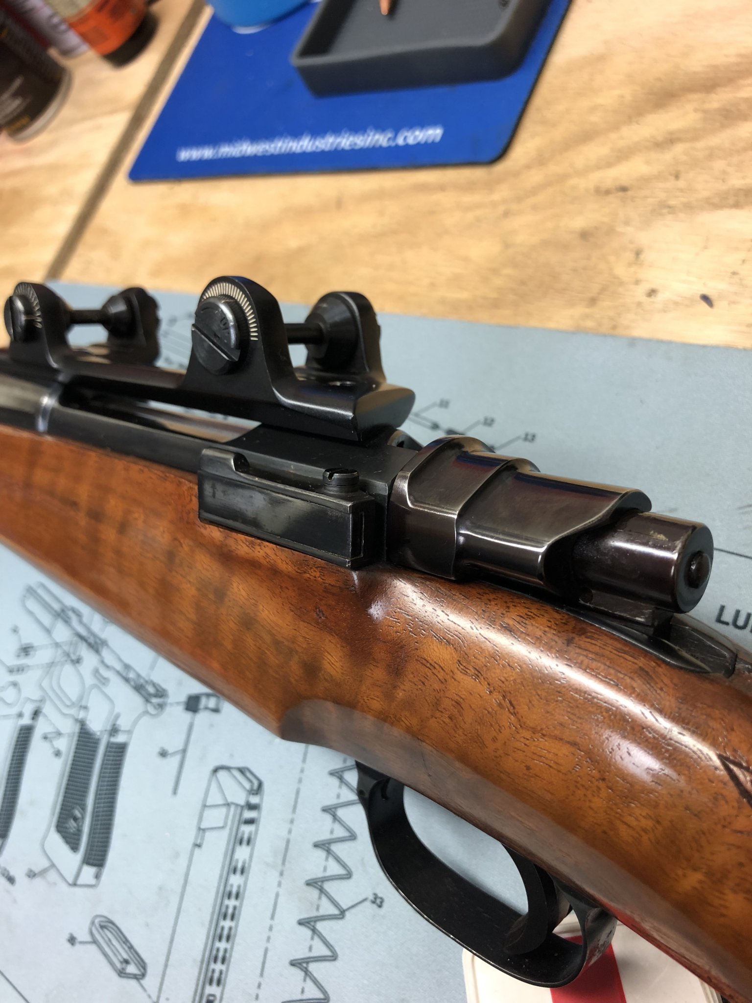

The Mauser looks to me to be a commercial action, not a military action.
Could be. As I said, I have very little knowledge on these actions. I was able to verify it’s a Mauser/clone based on a guess and a few subsequent Google image searches. If you can provide more specifics, don’t be shy!
On the left side of military actions there is an area that is cut down where the shooters thumb could go down farther when reloading using a stripper clip. That cutout is absent in commercial actions but present on military actions. Also German military rifles had every piece numbered with the whole serial number on the larger parts such as the action and barrel and the last 2 numbers of the rifles number on all smaller pieces down to and including the action screws. The Germans were anal about it and a matched number rifle is worth much more than a mis-match but I digress.
There should be some stamped info on it somewhere that might tell you something.
I am no expert but would guess the action to be made by FN in Belgium. Fine actions and many rifles built in that era by many smiths used them on their better builds. Many rifles were built using military actions also as at that time they were very plentiful and didn't cost as much.
I would not call that rifle sporterized, to me it is a custom build and a fine one at that. Sporterized is a military rifle that is restocked with a regular stock and sometimes rebarreled to a different round and was very popular and common to do back in those days as Mil.Surp rifles were available everywhere and cheap.
Sporterized rifles are worth very little as compared to if they had been left original but it was the thing to do back then.

100 percent a commercial action.
So I found the answer to my question about mount/ring compatibility. It appears there are two styles of ring assemblies (plunger style and thumbscrew style), both produced by B&L, and they’re both a universal fit for all B&L and Kuharsky mounts. I also found this graphic on an eBay listing which was helpful.

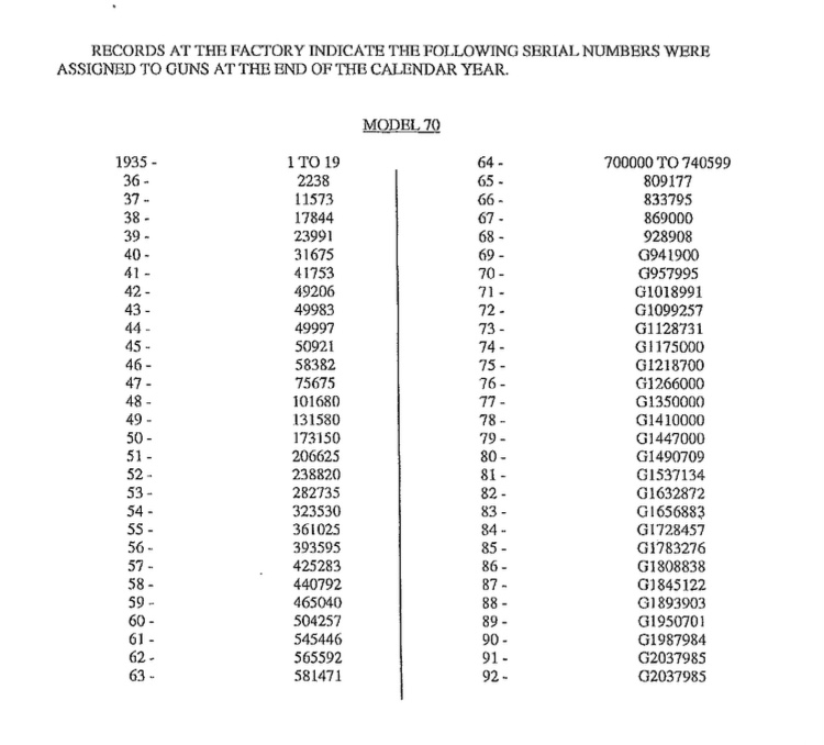

Winchester’s website has a .pdf reference for manufacturing S/N date codes and, with a S/N between 101680 and 131580, I determined that my Model 70 would have been manufactured in 1949.

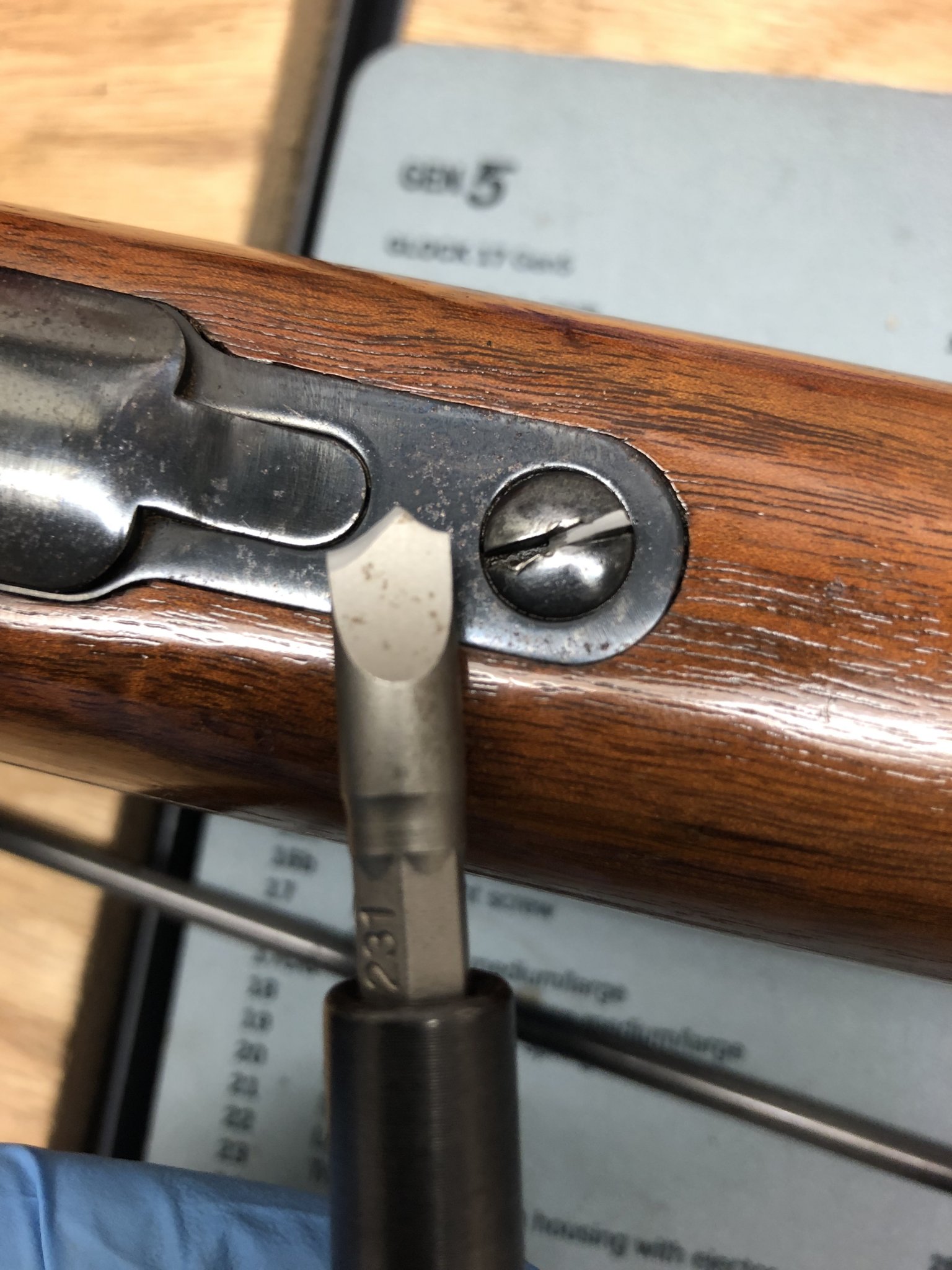

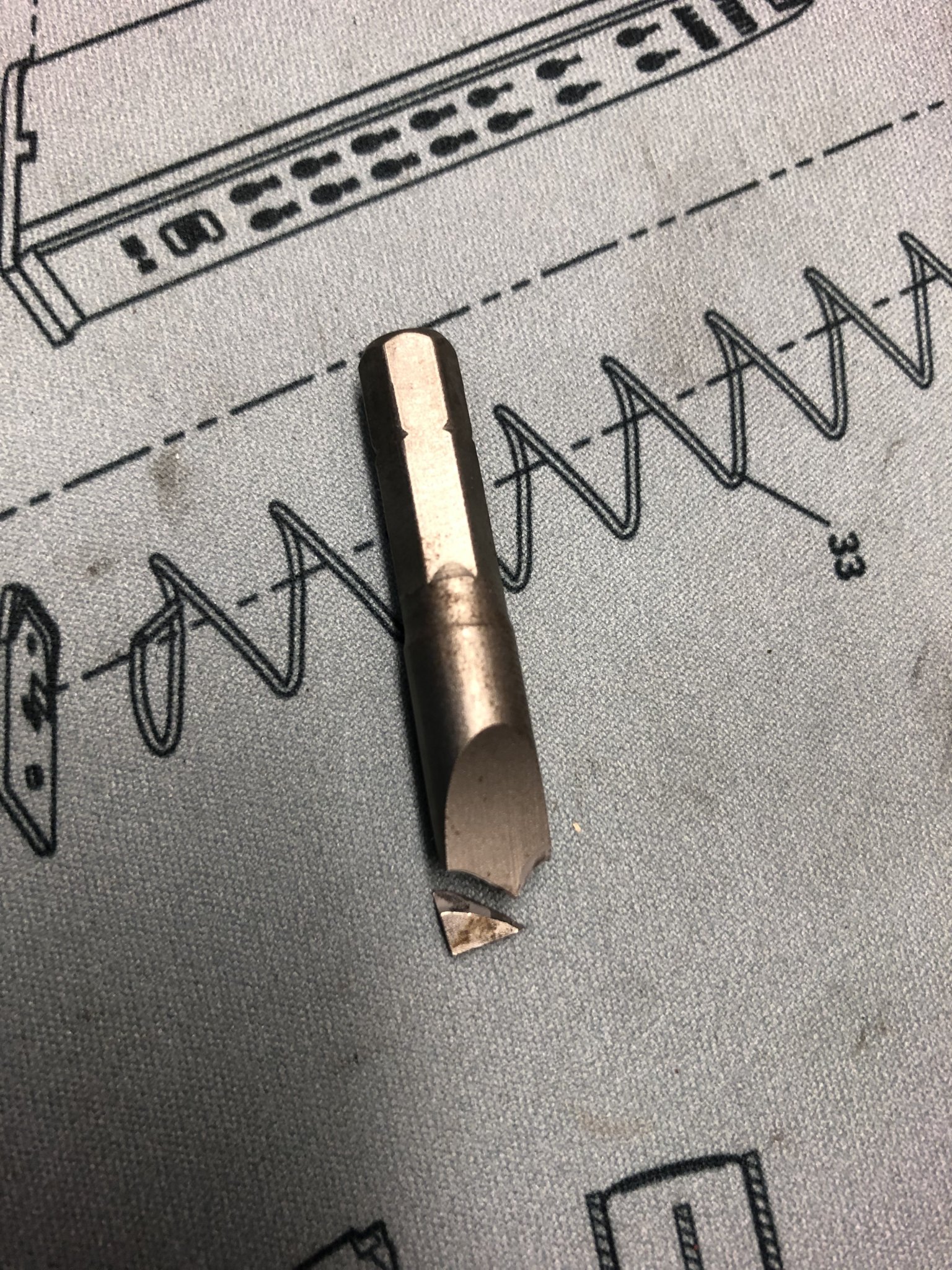

Tonight I tried to pull the barreled action out of the .270G but the rear of the action refuses to separate from the stock. I gave it a cursory “good enough” cleaning for now and figured I’d mess with it more later.
Then I tried to pull the action on the .240G. The rear action screw came out just fine, but the forward screw was a tough cookie. I messed with it for 10 minutes, worrying I was going to strip the head. I decided to pool a little CLP on the bolt head and let it soak about 10 minutes, grabbed my Wheeler Fat Wrench to have something more substantial to grip, and tried to get it broke loose. I set it to 60 in/lb so that I wouldn’t go too ham-fisted, and the result…
Obviously, I have my concerns about going any further…
Glassbedding was a common practice in those days but a release agent was usually applied to all metal parts that contacted the bedding so they could be taken apart. Some of that bedding could have gotten on the threads of that screw. Gently applying some heat to that screw head may let it release. I have used a soldering iron on some with some success but have a very small torch that I have had better luck with, however, you have to be very careful doing that so you don't damage the finish and that screw is long so it takes a while to warm it up down to the threads. That is the shorter of the 2 screws I think and there is some metal around it so the tiny flame of that torch would probably be your best bet, directing the flame toward the rear.
Take a crisp piece of paper or new crisp dollar bill and put it around the barrel just ahead of the front of the stock and see if you can slide it down between the barrel and the stock. If it won't go look along the juncture of the barrel and the stock to see if you can see any traces of the bedding there.
On the 270, with the screws out, will the front of the barrel lift up far enough that you can see under it to see if there is bedding there?
Reactions: Average guy
All good advice that Foul Mike is giving you, OP.
One thing you can try is tapping on the screwdriver while you turn it... And putting penetrating oil (PB Blaster or simiar) on the screw and threads (just a drop... don't soak the stock) for a couple of days can't hurt.
Back to your question... it was common to glass bed. But all the gun parts would be coated with release agent and there is no way a screw got fiberglassed in. Because if it got stuck, they'd have had to whittle the stock off. Can't dismantle that gun to finish if the screw is stuck. So maybe someone went all "Red Loctite" with it at some point... but it's not epoxy or resin bedding compound.

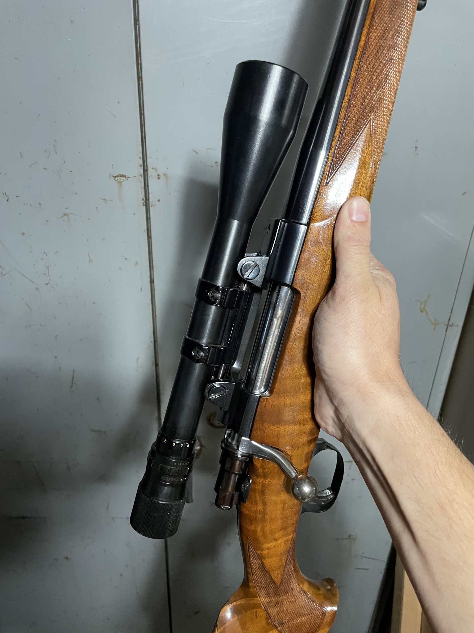

Well over the past year I’ve bid on a few optics and mounts for these rifles on eBay, but kept jumping ship based on prices. Not that they’re super expensive, but an unknown quality optic with unknown clarity level was not worth $100+ to me. This week my search was finally fruitful. I snagged a BalVar8 2.5-8x optic in what turned out to be very good shape + B&L mount for just $69 shipped. Optic and mount are both in excellent shape with only a few small nicks, and the glass just needed a simple cleaning to remove some dust. After cleaning, I’m very impressed with the optical quality for how old the scope is.
