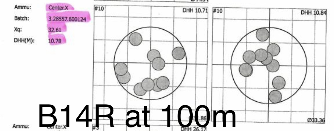

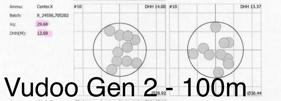

Pound for pound, you cannot go wrong with the Bergara. My daughter shoots a B14R with the carbon barrel. I had it lot tested at Lapua last week, and the results were solid. Attached are the best 100 metered groups from both the Bergara, and my Gen 2 Vudoo.
One other thing - the Bergara stock has been flawless on feeding and reliability. My Vudoo is way pickier. If I were to do it again, I would saved a couple of grand, and bought myself a steel Bergara. Both of these rifles have Triggertech Diamond 2 stage triggers, FWIW.
