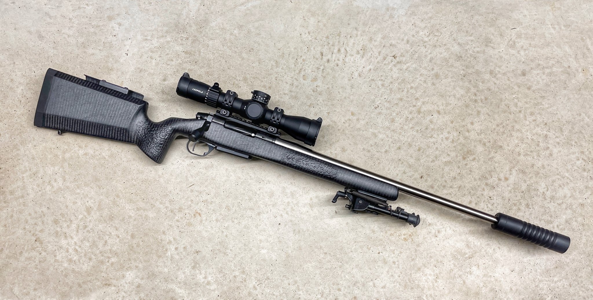

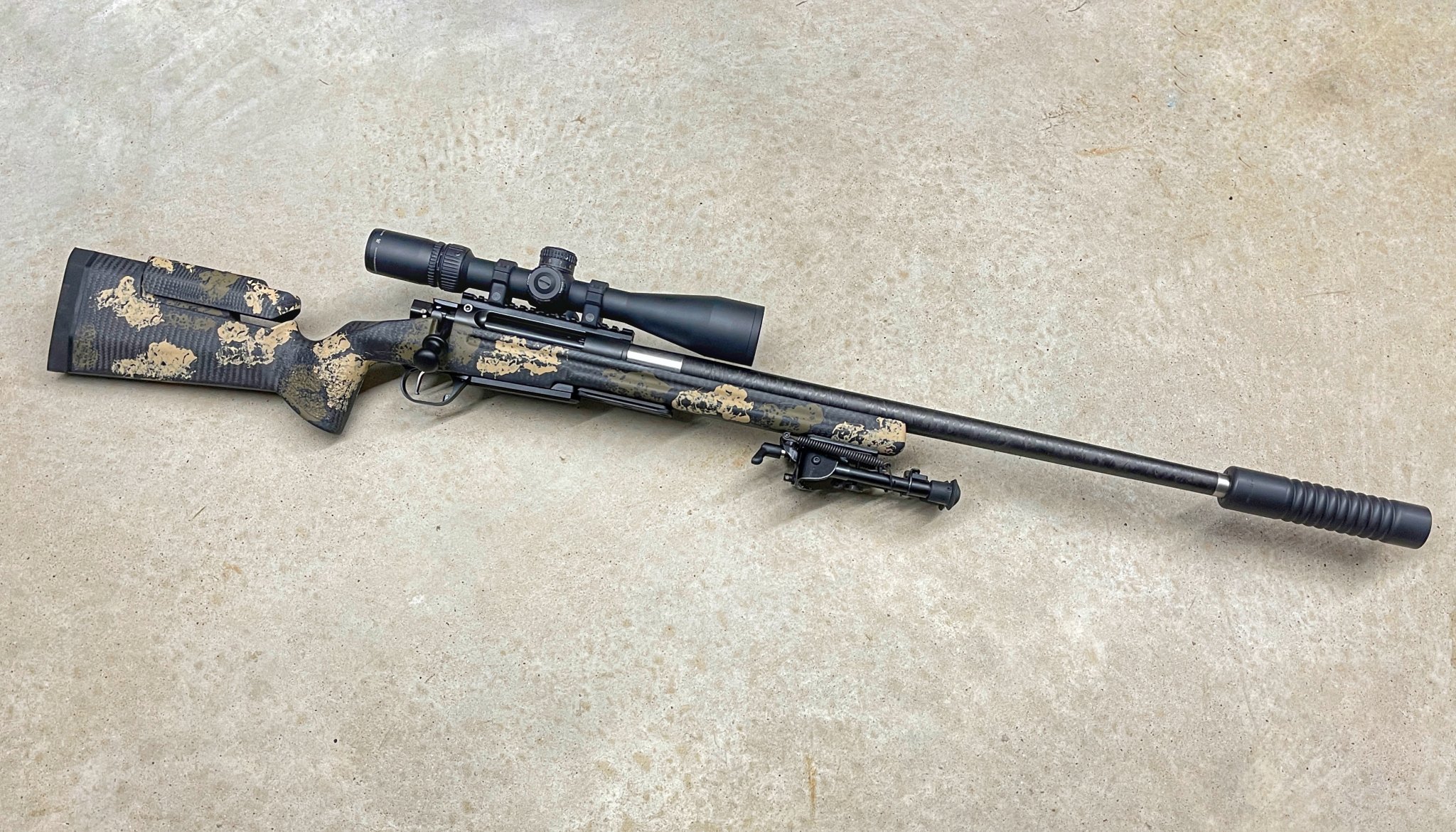

I’ve been wanting a light weight magnum for a while and I have a hunt coming up so I figured why not put together a new rifle. This is the first real “hunting trip” I’ve had time to go on in over 10 years so I said screw it and built a second rifle.
Huge thanks to Crown Ridge Barrel works for knocking out the barrels fast as hell and Jon Beanland for helping out by getting these two bedded in 24hrs.
300PRC
ARC Archimedes
Bartlein 24” 1:9 M40 CF
Manners LRH
Hawkins Hunter DBM
TT diamond 2 stage
Razor AMG
AB raptor 10
6PRC
Big Horn Origin SA
Bartlein 22” 1:8
Manners EH1
Hawkins Hunter DBM
TT diamond 2 stage
Leupold MK5 3.6-18
AB raptor 8

Fit and finish is great, the mag on the 300 is a little difficult to release, but it’s a hunting gun so I wanted something where I didn’t dump a bag on accident.
Holy hell! Did you say 6PRC? What are you planning on hunting with that one?
They are both beautiful rifles by the way.
This one is going to be shooting the 108 elite hunters and It’ll be used for Axis on this hunt. The 300 is just to see how far we can shoot a pig.

The 300 weighs in at 11.6lbs and I didn’t get a chance to weigh the 6PRC.
Got to shoot them today and the 300 shot factory 225 ELDM under 3/4 MOA at 2800fps and I threw a quick load together for the 6 and it shot right at 3/4 MOA at 3100 with 108 Elite hunters.
