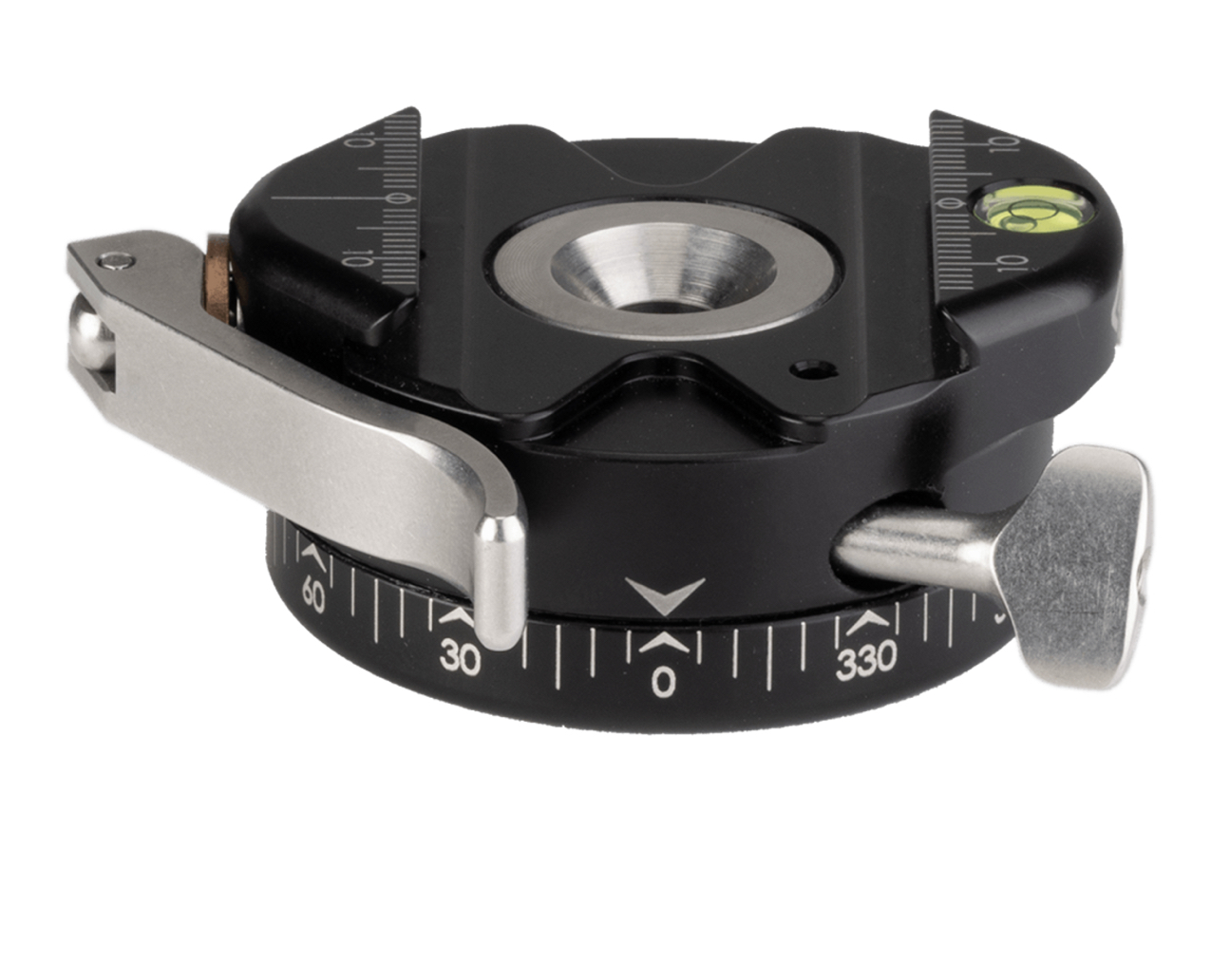

A lot of my customers add one of our PC-LR-40 with a TH-40-Dvtl for quick release off and on.
Primary customers that go this route are hunters and comp shooters that want to add an independent panning assembly to the Anvil. I’ll be using it this year hunting probably. Will probably live on my binos if it fits in the chest harness. Yet to test it with the intended harness.

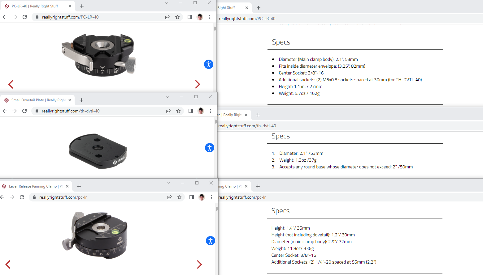

What is the difference between the PC-LR-40 https://rrssoar.com/pc-lr-40/ and the PC-LR https://rrssoar.com/pc-lr/ for using on optics? The PC-40 appears to already have an ARCA rail machined into it.
The PC-LR-40 is the same clamp in principle, just differs in size.
It is slightly shorter when you take the dovetail on the PC-LR out of the equation, it’s also smaller in diameter about .8”, which dropped the weight slightly.
Unless I am missing something you would still have to add a dovetail to use the PC-LR-40 where the PC-LR already has it built in. I don't see the advantage of a PC-LR-40 plus the TH-40-Dvtl vs just using the PC-LR.
