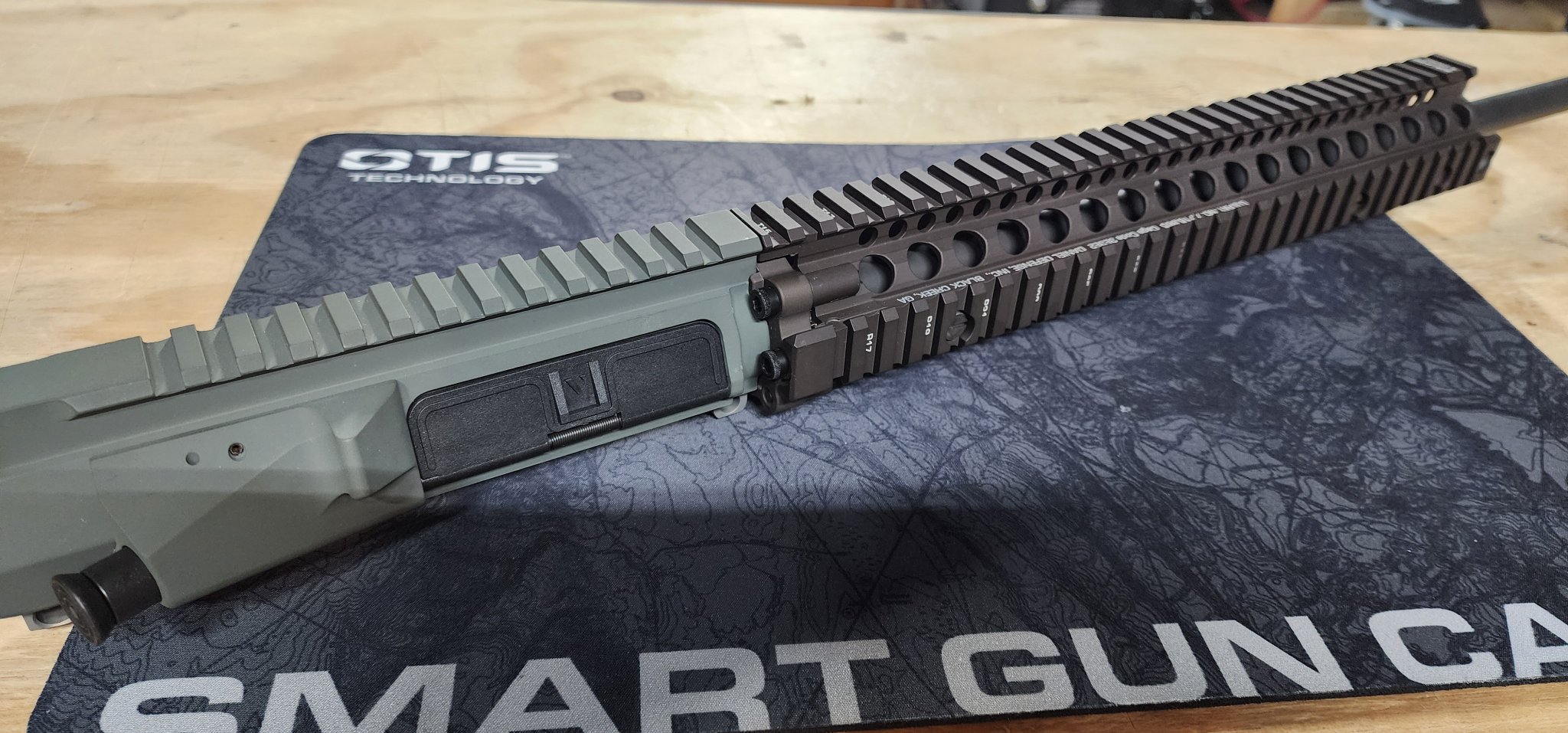

What is the ultimate gas block for durability, longevity etc. Will not be running suppressed on this rifle anytime soon but possibly in the future. I know these parts below will be a determining factor as well:
  • 223 wlyde Criterion core 18" with rifle length gas system. .625
  • LMT Enhanced BCG
  • I believe I've read the A5 buffer system would be ideal (not sure specifics on buffer weight yet.)
You input would be appreciated so I get it right the first time. I've read for days on end; on most mentioning superlative adj gas block or SLR,
I wanted thoughts on non adjustable as well, I was wondering if anyone had any experience on the PRI flip up front sight with .625 crossbolt. Or if that's silly.
I know the EBCG will come into play so I was interested in your expertise.
Thanks ahead of time

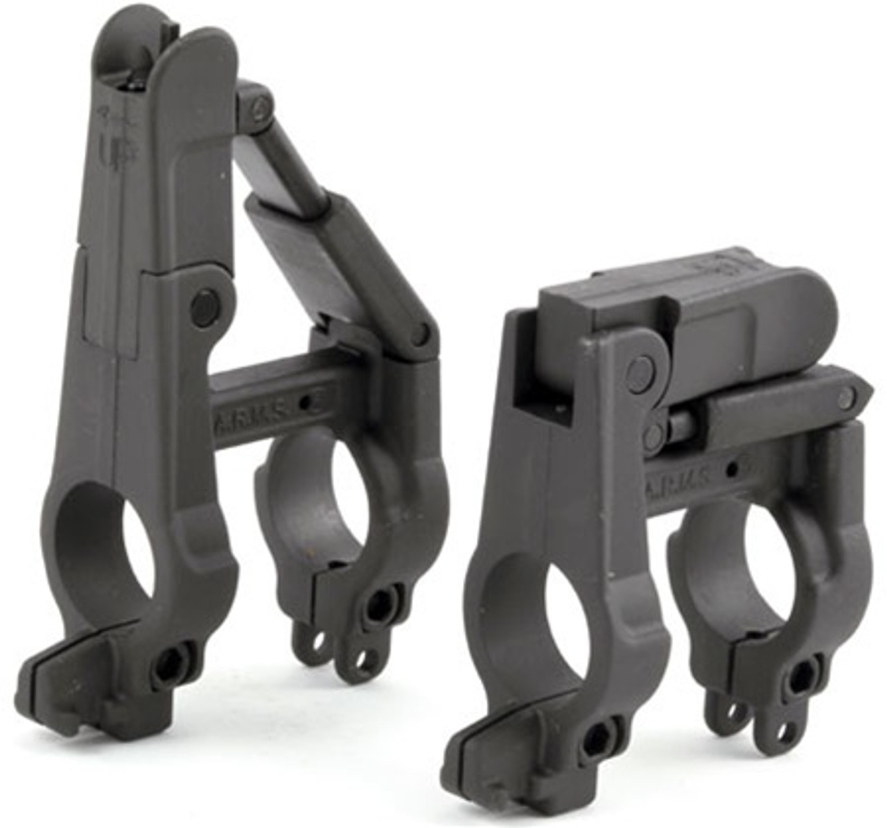

I may try out this A.R.M.S #41 flip up gas block from a guy I'm negotiating until I decide which AGB I would go with if I decide to run suppressed. Anyone have any/heard any experience with A.R.M.S?
Let's just hope its the .625 he says and not a .75 haha

Huh... I didn't realize those A.R.M.S flip up even came in .625 diameter. Learned something new today.
The one I saw needs to be pinned... "Pinned (must be installed by gunsmith)"

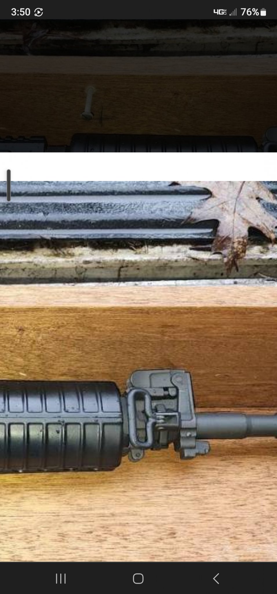

Yeah that's the one #41 B-L-P. I found a guy who has one but he said he "thinks" it's a .625.
I looked up his specific stag arms 16" 1/9 twist Chrome-Moly Vanadium barrel and all I've found is .75
I'd have to buy his barrel and gas block together, he won't split it and he's wanting $460 for the pair.

That would be an expensive mistake for me to make if it's not .625 journal.
So the guy spent big money getting a barrel machined but has no idea of the specs? Sounds real bright.
Pic looks like .75 FWIW. Don't buy it till he sends a pic of calipers on it just ahead of the block at least. If he can't do that, hard pass.

The folding FSB shown in the post I quoted has been pinned. Even if it is the right diameter, removing it to reuse on another barrel would be very difficult, if that is your intention.

His is .75, had him measure it; so that's a no go. I have a machine shop handy. Prob get a fixed or adjustable to play with until an ARMS #41 pinn-able graces my presence.

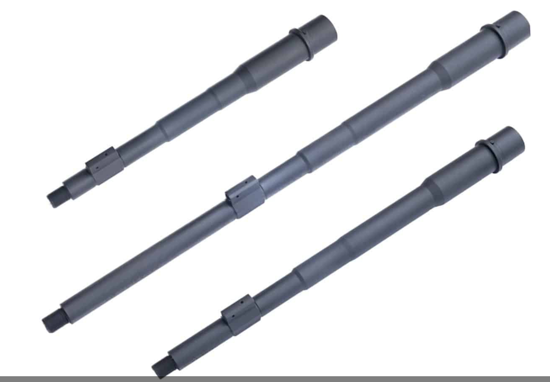

This is the “Ultimate” gas block for your build. It’s built specifically for the Criterion CORE series barrels. With 18”/rifle gas and the correct suppressor, you shouldn’t need an adjustable gas block.

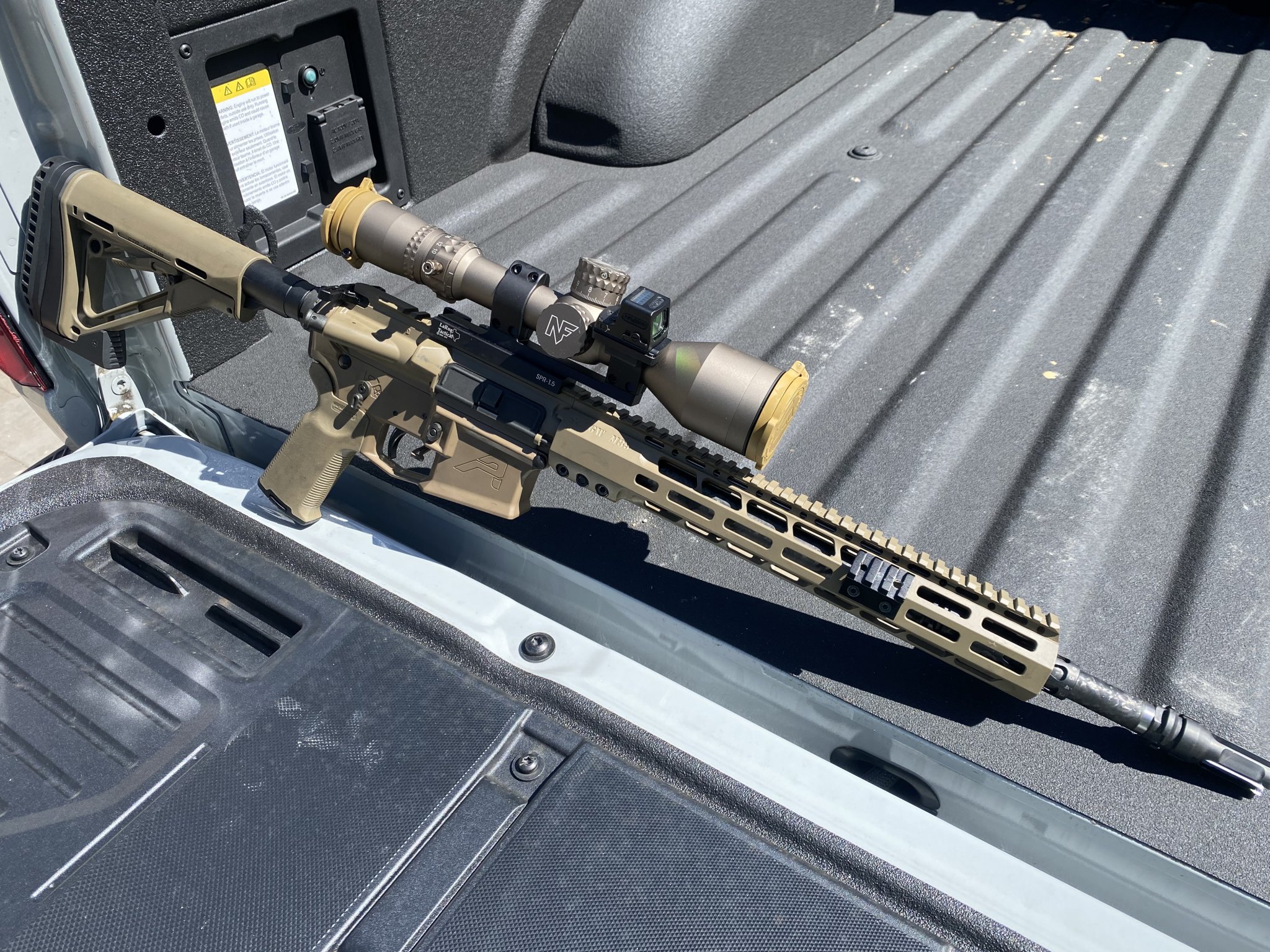

I have an 18” CORE that I can shoot suppressed and unsurpressed with minimal change in ejection patten with a MWI fixed gas block.
FYI, the CORE profile makes for a handy rifle, but it does have a noticeable POI shift with adding a suppressor. I ultimately ended up taking mine off because I hated the handling of it for positional shooting.
Yeah I was checking out this gas block after I heard criterion mention this in a video about ripcord

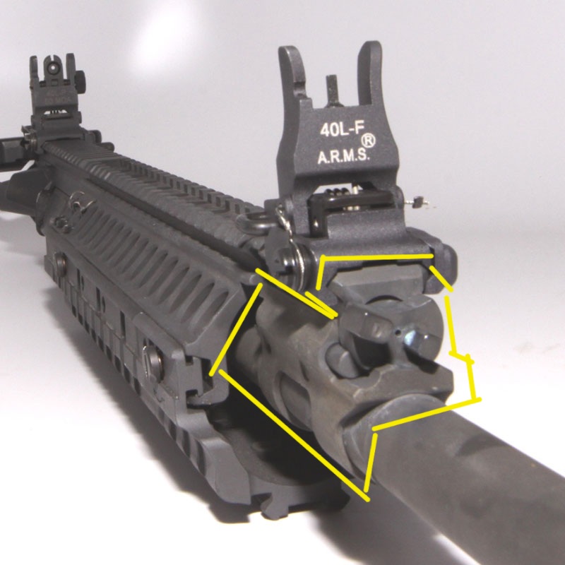

I noticed this today looking at a.r.m.s.front sights; I assume this is a railed gas block with a switch on it?
