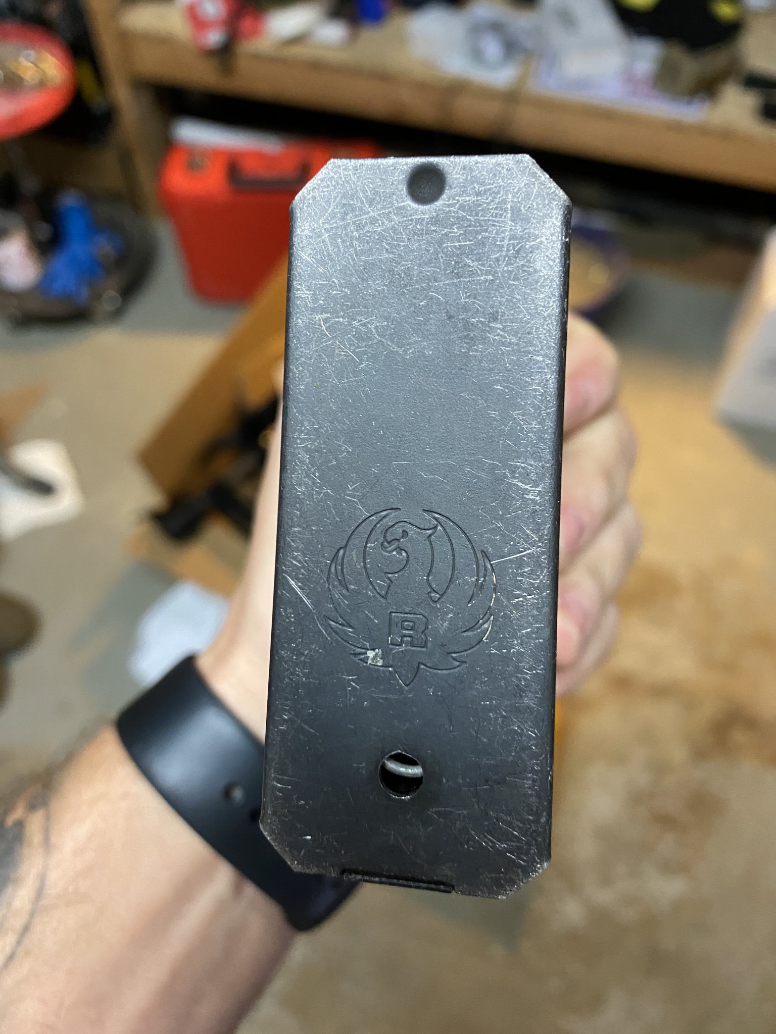

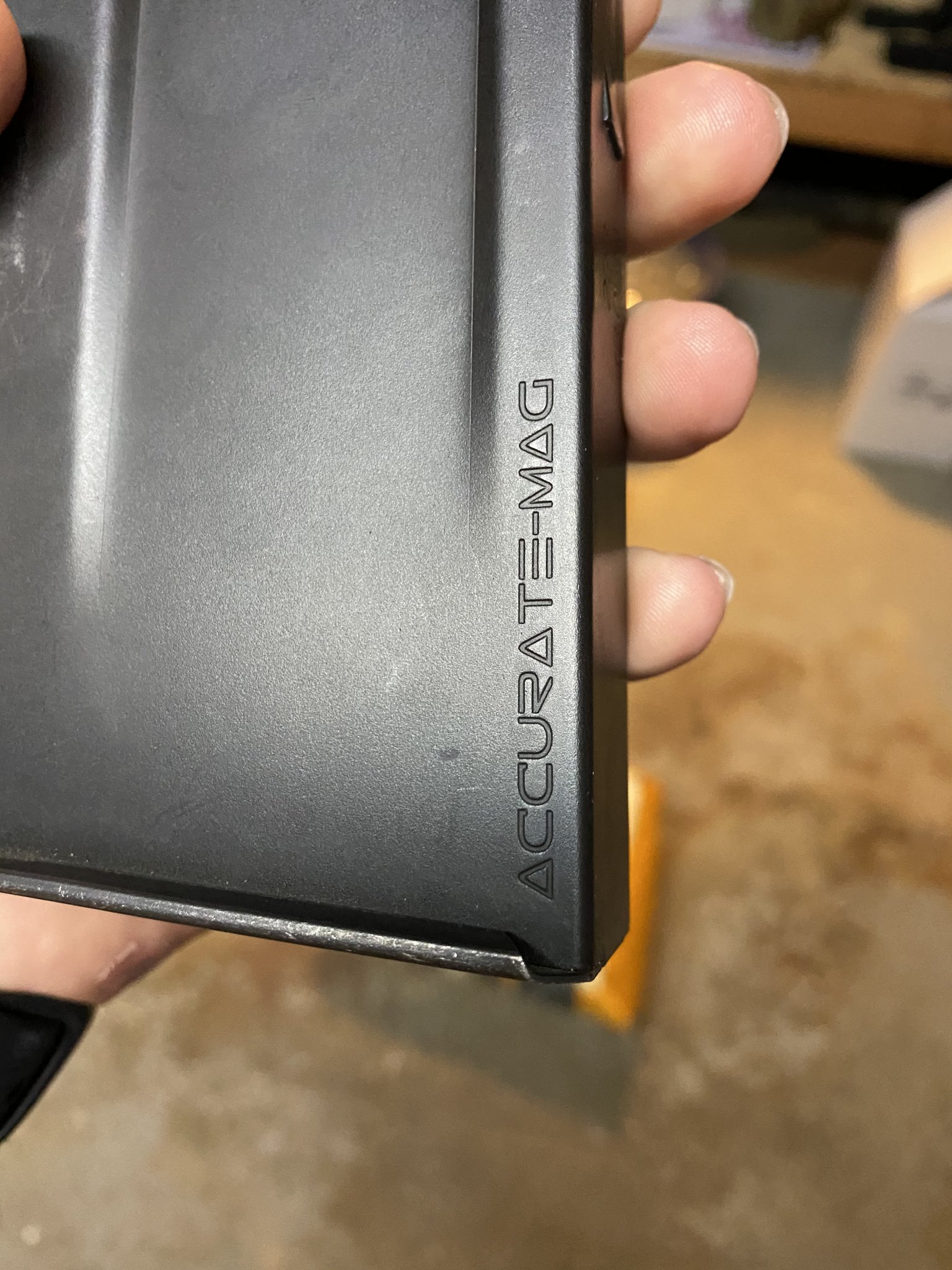

I have a deadline in 223
the magazine you need is this one
the feed lips are extended forward and this corrects the feeding issues.
I have those mags exactly actually. They aren’t anything special. Just rebranded Accurate Mags.
The Ruger scout mags are different than the regular Accurate 223 magazines.

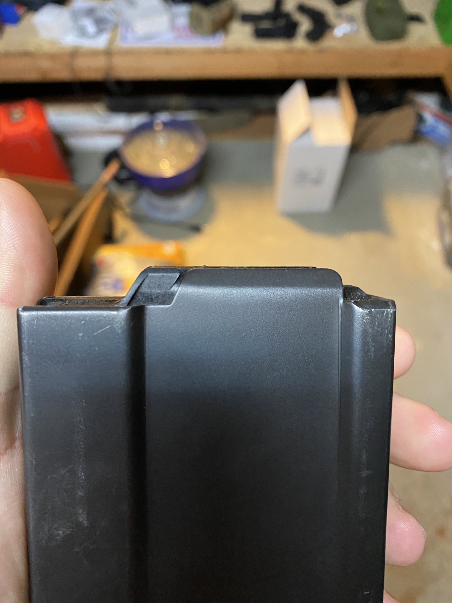

Can you post a pic of the feed lips from the side?
You should give Derek at ultimatum a call, he turned me onto those magazines and they work fine in my gun.
@Stag556 I know the issue you speak of, as its happened with only MDT polymer 223 mags. I've been running the Ruger/Accurate 223 steel mag since the beginning in my Manners Mini-chassis. I had to trim the mag catch, just like for AW mags, but haven't had the same 2nd round catching on the bolt body as with the MDT polymer.
I've also heard that the Ruger scout mags are identical to the Accurate 223, just with a Ruger-branded baseplate.
I’ve spoken with them extensively, but neither one of us could find a solution unfortunately.

thank you, Ill start with this, now my spring looks like a banana!
It used to be used for the MDT side match at NRL matches, but the damn thing was so rough they switched it out for a defiance, which was marginally better imo.
60° bolts are heavier than 90° for sure, but AW mags are Superior anyway.

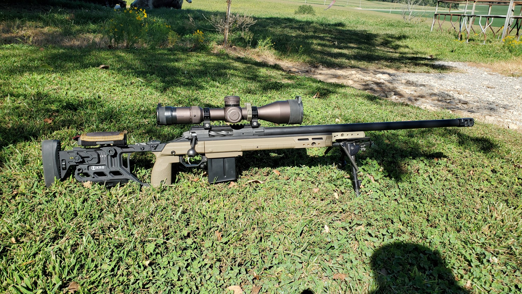

I love my GA Tempest and Terminus Zeus and both are in MDT ACCs with glass bedding.

My Tempest has only had 6 Creed barrels until now. It is now at the gunsmith for a 6 Dasher barrel.
The Terminus Zeus has about 100 rounds through it and I'm still forming 22BR brass, so I couldn't give you an honest opinion between the two yet.
The Terminus has a heavier bolt lift, but I wonder if it's because of the BnA Tacsport sear height. The Tempest has a Jewell in it.
I don't really have anything truly terrible to say about either at all. Both seem great and fulfill my 3 Lug, AW feeding requirements lol

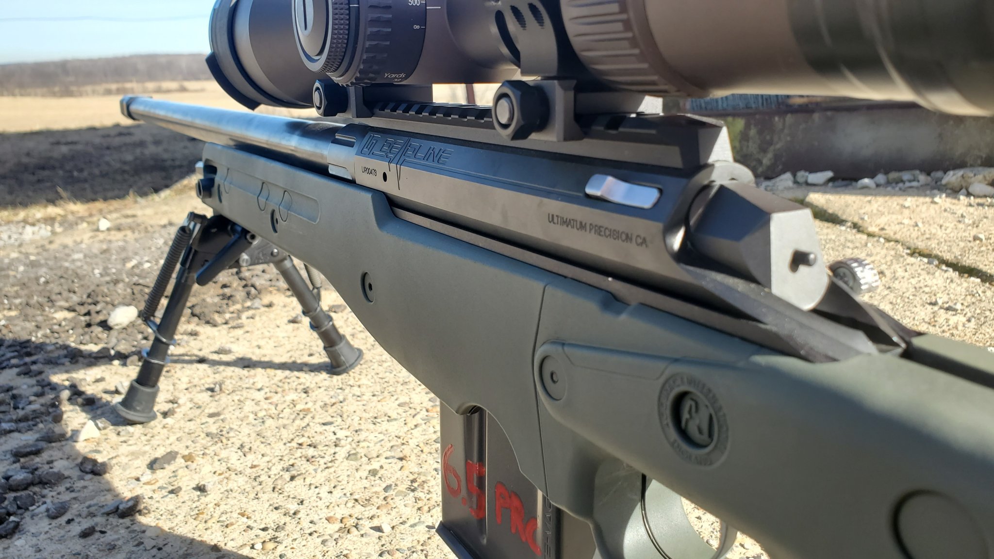

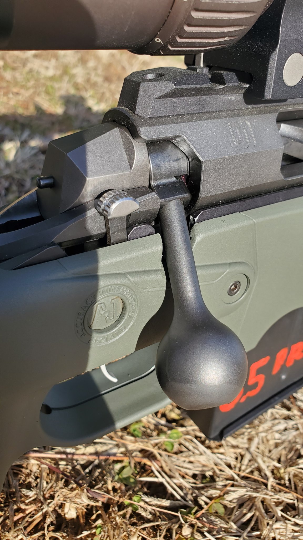

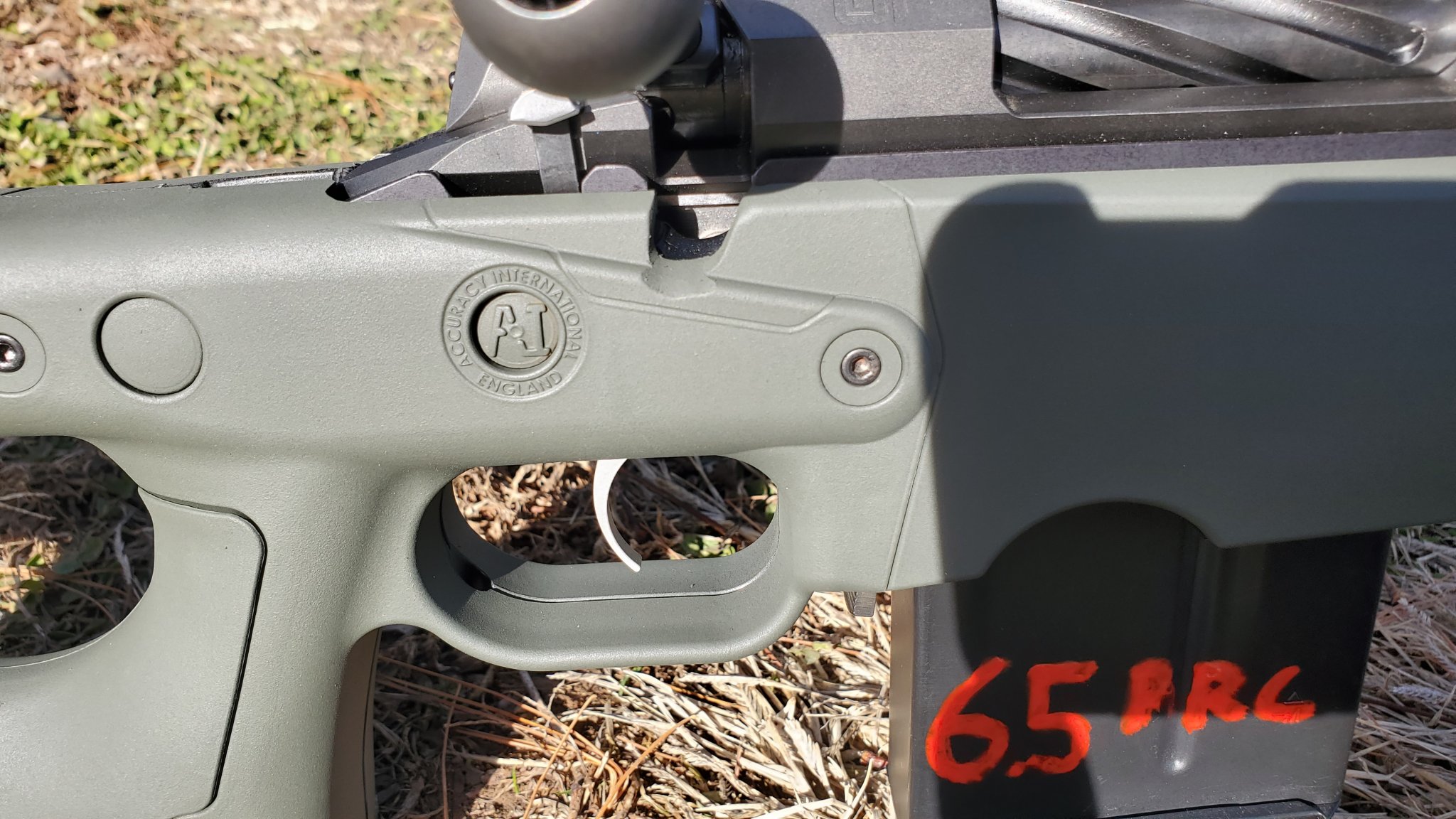

I can chime in as well. I've run the Tempest, Axiom, and now Ultimatum Deadlines in at least 1 season of PRS. All are great actions, but have their own quirks.
I believe i had an early GAP Tempest. No issues with feeding/extraction. I did have the cocking piece de-cock a few times, and shut me down on stages. I sold it shortly after.
Moved on to the Axiom. Loved the roller cocking piece and DLC coating....super smooth. I realized that I had too many random AI mag issues, so AW mags has become a 100% requirement for me now. This was well before the Vector was released.
I've had 2 early SN Deadlines, and have only had minimum issues...nothing that stopped me from completing a stage. Bolt stop has been updated, and lighter FP springs installed....which are all standard parts on new actions. Once broken in, I don't recall either action above having significantly lighter bolt lifts.
3 lugs are just heavier...if you are looking for benchrest-light bolt lift, you wont find it in the 3 lug life.
