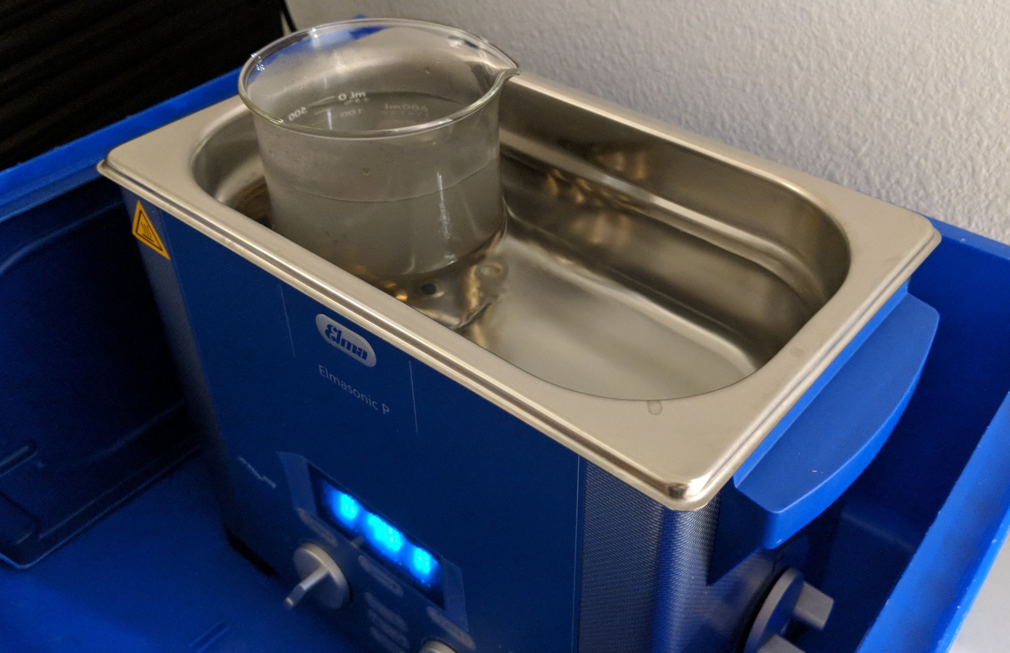

I usually clean small batches of brass inside a beaker placed inside the tank. This will keep my tank clean. The Distilled water/Dawn solution gets reused a few times before i replace.

I'm using a small 3/4 gallon commercial Elmasonic P30H.

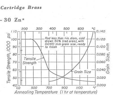

So long as you don’t get it over 450 degrees no material change is going to happen. Now if you have the oven set for 200 but have them set right on the burner where it’s gets much hotter then you can have issues.
Yes exactly. Good chart.
