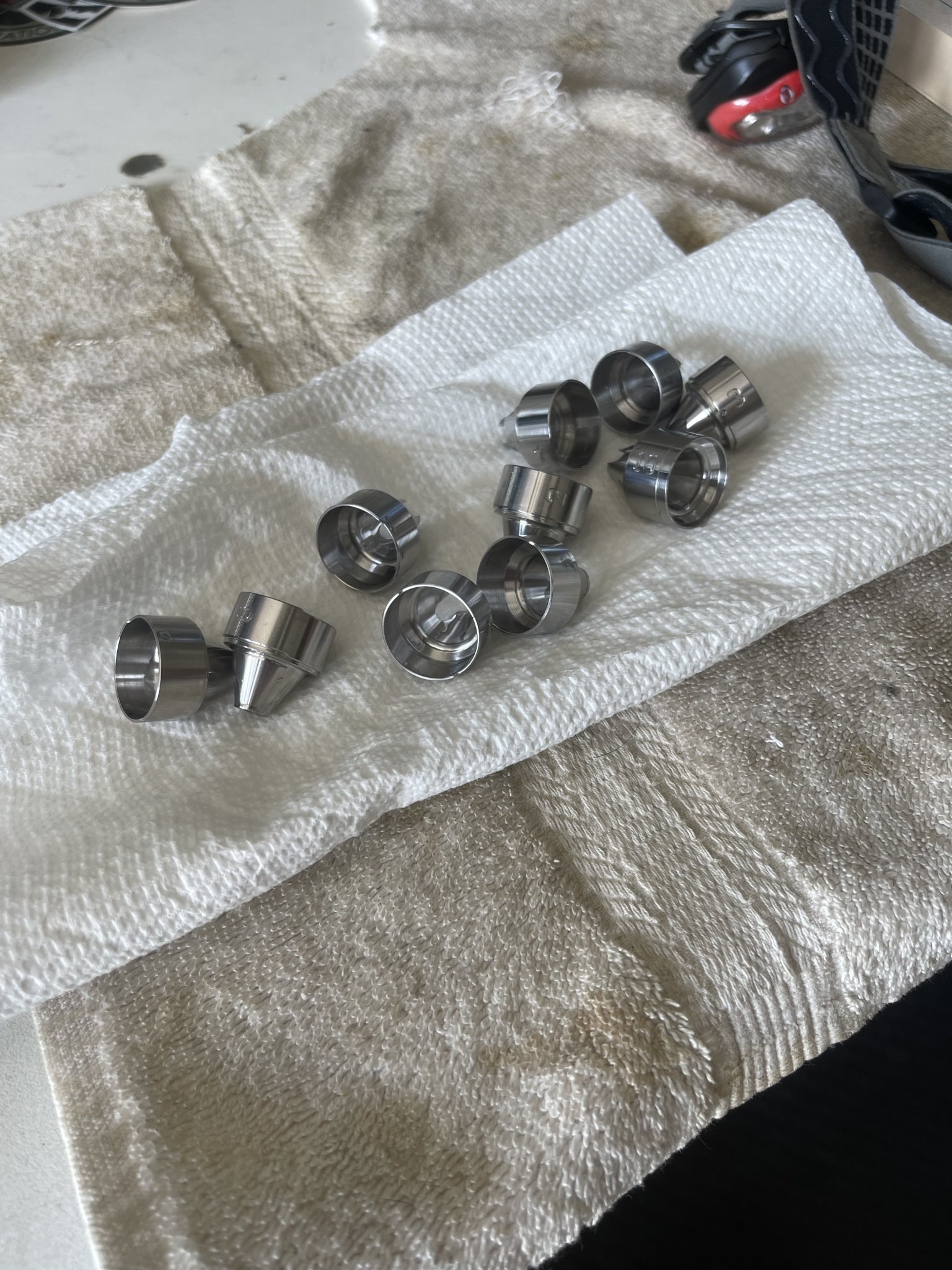

    I just soaked these in some 30% vinegar for 1 1/2 hours. Wiped out with Q-Tips and soapy water.
    Clean enough

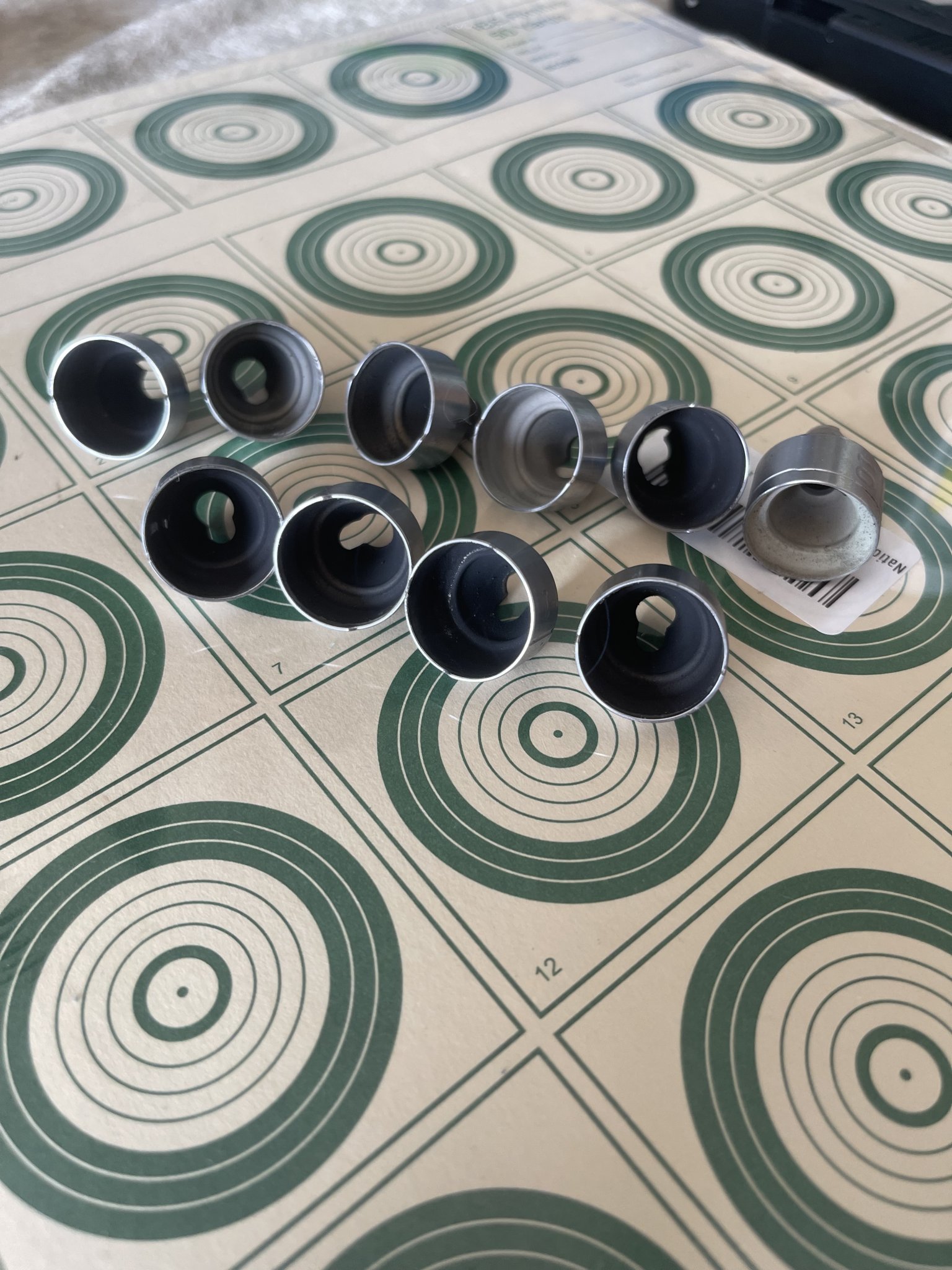

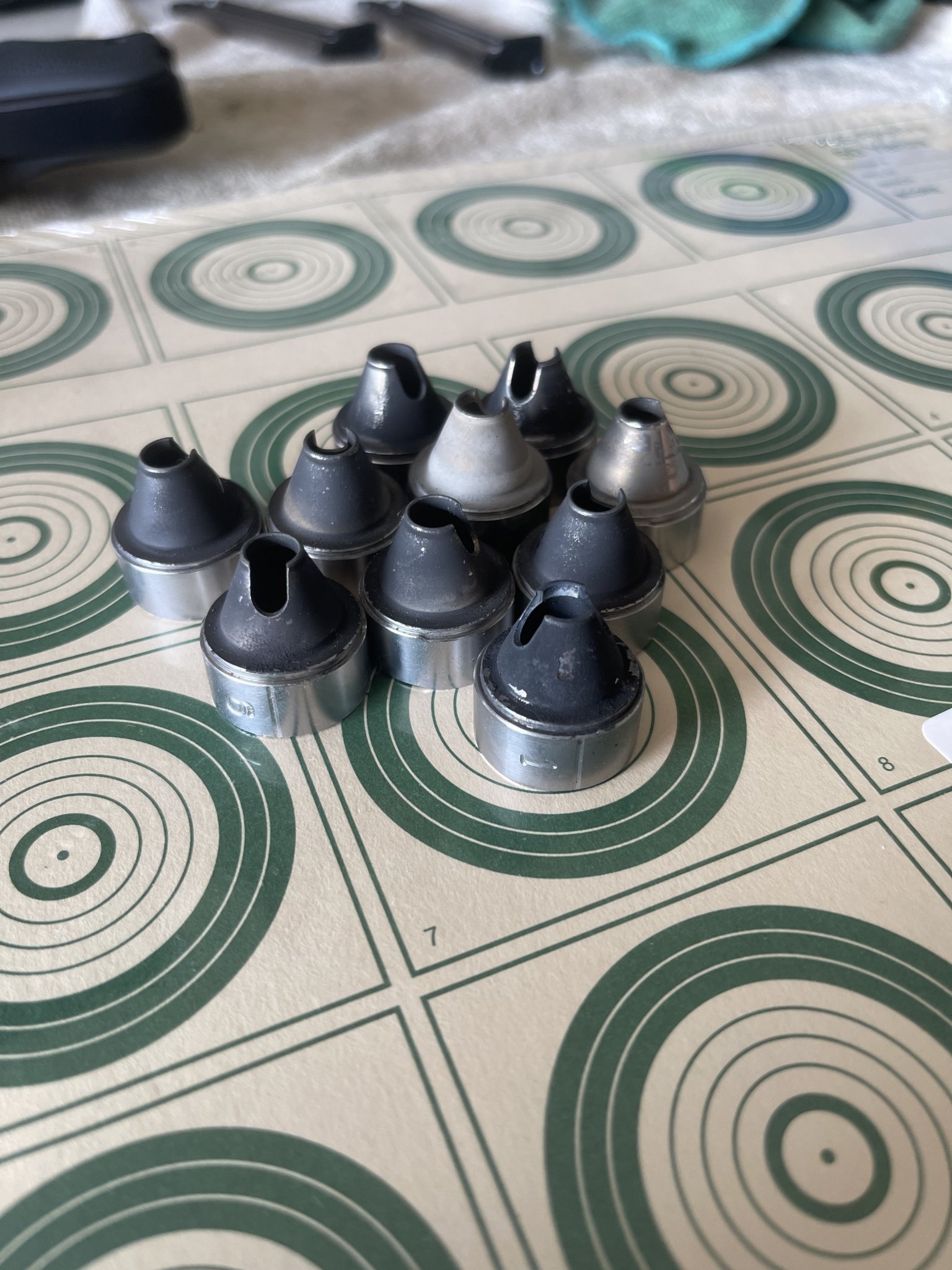

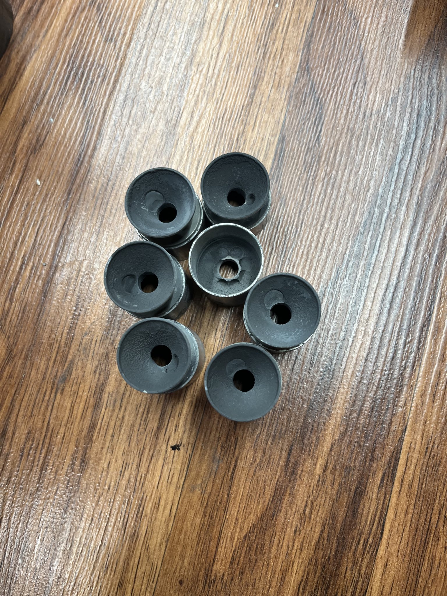

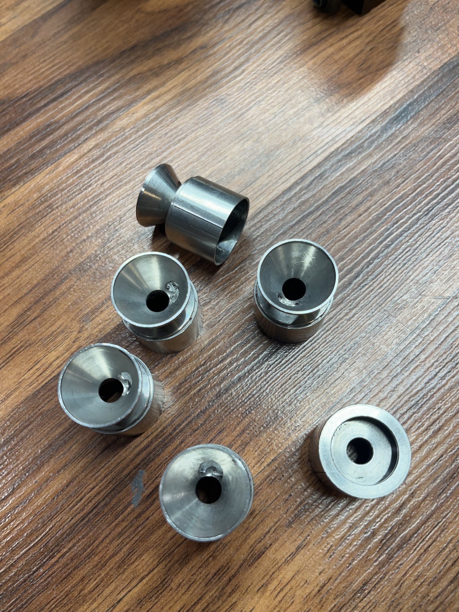

    I realize this is an older post but I thought somebody searching for similar information might find this information useful. I went way to many rounds through my DA mask and ended up with stuck baffles. I was under the impression that you could go 1500-2000 rounds on a new can before cleaning. Baffles were completely hard carbon coated. After soaking for several days in Kroil the baffles still could not be pushed out of the tube by hand. Bought the Banish baffle removal tool from Silencer Central and that made easy work for safe removal of all the stuck baffles. Once out of the tube the stacks were so carboned up I could not break them apart by hand. After more research I saw where the inside baffles (not exterior tube, front cap, or end cap) could be placed in CLR while submerged in an ultrasonic cleaner to remove carbon. I had one of the small HF ultra sonic cleaners, placed the stack of baffles in a zip/loc bag, used the heated water setting and ran them for 8 minutes. Pulled them out and all but two baffles came apart but the amazing thing is that the exterior and most of the interiors were spotless. I repeated this a couple times and all the carbon was gone except the two stuck baffles. After those came apart I ran them two more times to get the insides clean. A total of 32 minutes and my baffles are like new with zero scrubbing or scrapping. I submerged the cleaned baffles in 91% isopropyl alcohol to guarantee all the CLR was removed. Now I will put a little dielectric grease on them before reassembly. I won't run 2000 rounds through it before cleaning my mask, but I could now that I have the tools. Your mileage may vary and be careful with CLR it is a corrosive chemical that will eat aluminum and carbon steel. This procedure is for the stainless steel or titanium baffles only. There are YouTube videos and discussions on this if you search long enough.
