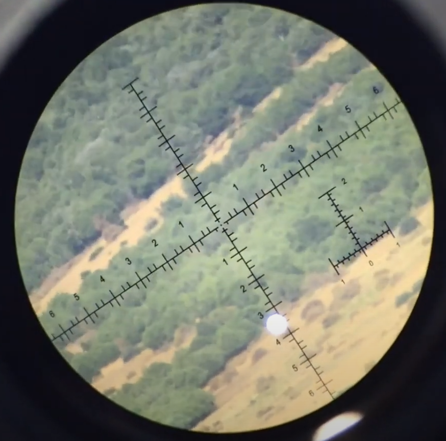

    Stupid marksmanship question / newbie scope question. When people talk about field of view that means how much surrounding environment a scope sees at a certain magnification? Is that correct?
    So for my mil based scope, if the lines go out to 6.5 mils @ 30x on each side, then I'm seeing 13mils of view @ 30x. So if every mil is 3.6" at 100 yards, then I'm equivalently seeing
    3.6" * 13 = 46.8" = 3.9 feet @ 30x @ 100 yards.
    So basically every scope I get behind, just dial to the mag and count the mils and that'll compare the FoV @ a certain magnification.
    For eye box testing, it seems kind of subjective when I have 3-4 scopes just sitting on a rail and I'm just bobbing my head around them. Is there a more scientific way of testing it?
    Thanks!

    Watching a video of NX8, I saw that @ 32x, the visible mils was 13.
    They posted 32x: 4.6 ft/1.5 m, but based on what I measured, it should only be 3.9 ft. So it looks like significantly over reporting. 3.9 ft @ 32x is still pretty darn nice.
