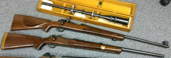

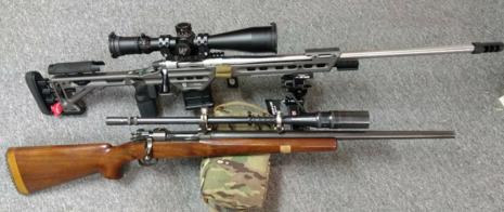

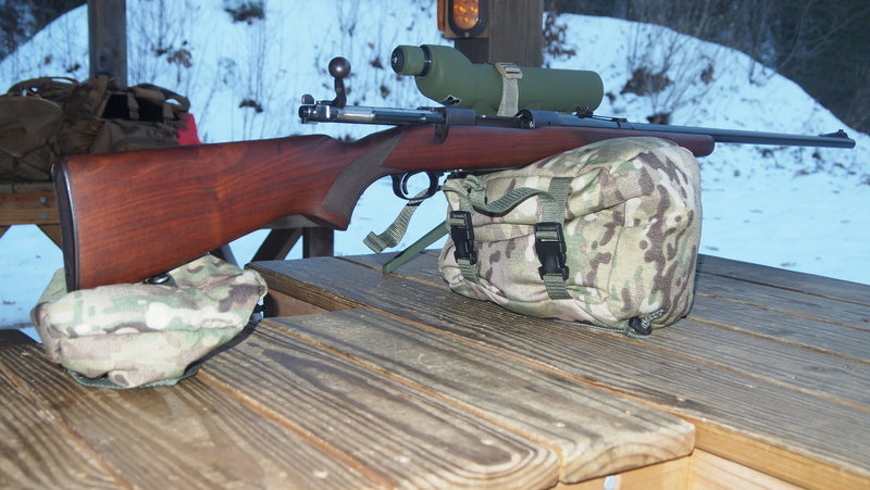

What caliber is your rifle. Looks center fire.
My .22 Unertl
My 30-06 Unertl
My other 30-06 in need of a Unertl

Ok, interesting. I may do that. I did acquire another 1903, not sure which model, but it is unaltered, but for the stock: same sights as the one in your top photo, no scope mounts. I would like to convert one back to an original stock.
It's the top one in this picture.
Neither is in mil configuration.
The bottom receiver has been drilled up front for the scope block but the rear ring appears to maintain the dovetail for the original A3 peep sight, Barrel and stock appear non GI.
Unsure if top is A# or 03 but it has been drilled for sights, barrel and stock, non GI.
It would take a lot of effort to bring them back to GI Im sorry to say. They look like nice match rifles of their era as is. They would lose value bringing back to "restored" GI - yet cost you a good dime.

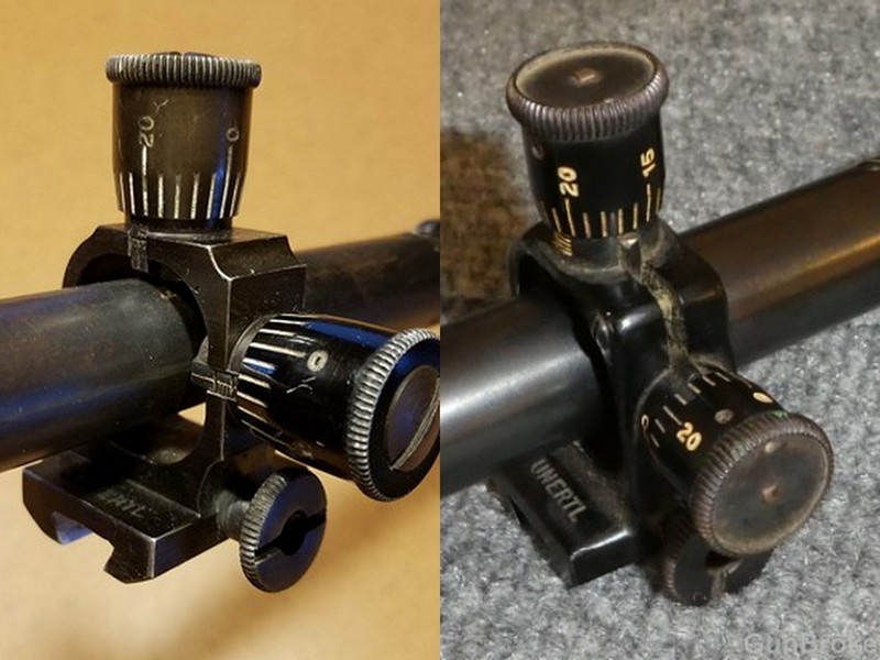

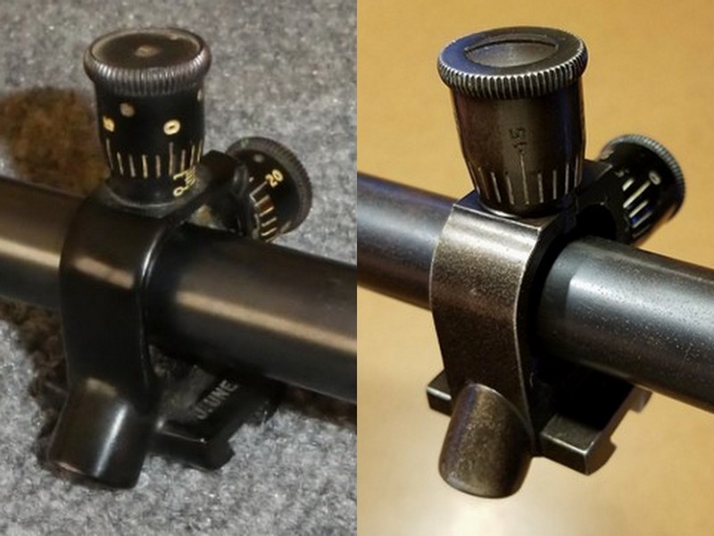

That's a nice 1-1/4 inch combination target just what Im looking for but of the less expensive civilian variety.
That rear mount does not appear to be the one that belongs on the scope originally.
Yeah total wrong rear mount and the crosshairs have been changed. But otherwise it looks good. It's a little high too. You can usually find one with a Can for about 5k.
2 center pics are real, with the incorrect on the outside.
