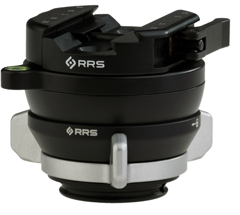

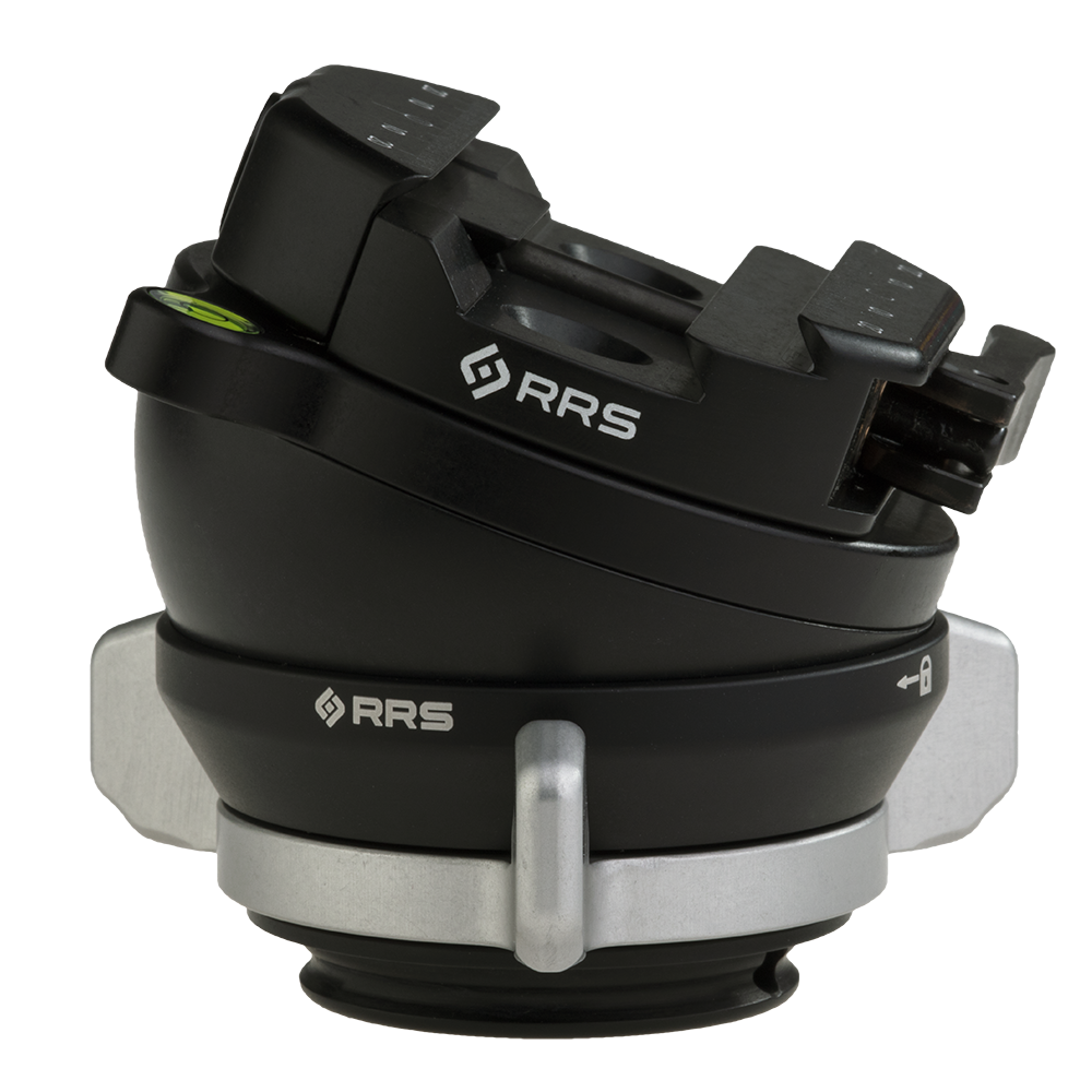

Just to give you guys a heads up, since it is commonly asked about and multiple threads made. We upgraded one of our leveling bases with a new design and clamp.
TA-2U-SC SOAR Universal Leveling Base
Increased the ability to shoot more angles.
Increased the lock up.
Changed the mechanism to lock and unlock so it works easier with rifles.
The clamp on top works with both Mil STD 1913 Picatinny and the RRS 1.5" Dovetail.

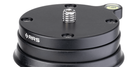

Clamp is removable to use the platform on top with the industry standard 3/8" tripod stud for direct thread attachment of other gear.
Hopefully this fits a solution for some of you. If you have any questions go ahead and shoot.

Looks pretty awesome!
So for someone in the market for a dedicated shooting and spotting tripod kit, would you recommend this over the Anvil 30? I’m in the Midwest, so there’s very little likelihood I’ll be doing any high angle shooting where I would “need” the full range of motion of the Anvil 30.
Also, will you be offering this head as a full tripod package?
Thanks!
We don't really offer any packages since all of our products are plug and play. The only reason the Anvil is in the packages, is becuase the apex will not work with any other ballhead out there.
We have had leveling bases for a long time and I only use the Anvil when I think i am going to have an opportunity to shoot. It just fits my style. I think the leveling base suits some people and not others. So I can't give you a definitive answer for which one to go with. Anvil is stronger, has a side lever instead of underneath for main function, and has more angle capabilities. The leveling base will probably feel more smoother with optics on top since it is not made to withstand so much torque that you can put into the Anvil.

How much more angle does this have compared to the ta3
TA3 = 15 degrees
TA-2U =20
Anvil 30 = a lot. I don’t know I can’t find the number on their site for some reason

So here’s my question… Where is the manual for this ball head online?
I just got one and it turns out you have to assemble it, but it doesn’t tell you how to remove the stud that’s installed in the top of the ball head.
What’s really odd is that it comes with the dovetail mount in the box, not assembled onto the ball head…
(In other word not even remotely ready to use out of the box.)
Two pieces… not like this…
Looks like this…
(though there are a few more holes on the plate… and the stud in the center does not come out. It looks like you have to disassemble this thing somehow…. But no instructions online and no instructions in the box..)
…and yes, all the other SOAR items have documentation here….
I may seem like I’m being a jack ass, but when you spend 400 and some odd dollars for an RRS ball head, you expect it to be ready to go when you get it.
Does anyone know the secret to getting the stud removed? I just received mine and even heating it too hot to hold, it will not budge.
24hr update… After soaking in Kroil overnight and heating till was HOT with a glove - I was able to get the Red Loctite to release. Leaving this so that others might benefit.
