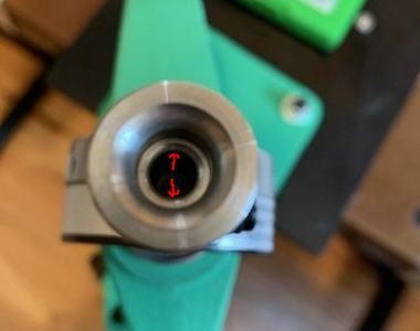

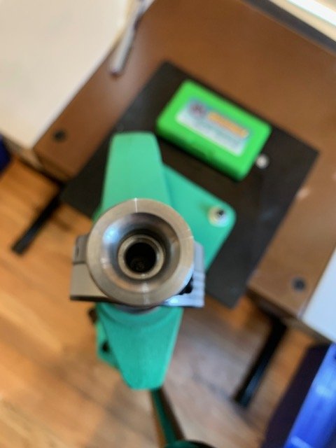

    Got a picture of the stems internal? If it a big radius or a bunch of little steps or what?
    Here's the best photo I could get of the base ...
    Sorry ... not sure I understand the question. Just push in the bullet, the tip touches a plunger and it starts moving, and stops when the shoulder seats. Is that what you're asking?
    Basically, so it references its length off the tip is what youre saying?
    Looks like it would be going off of that coned surface
    In which case I still dont see how it would be refencing every bullet for every caliber at the base of the ogive. Measuring off of the tip or mid curve wont provide the measurement at the point where the bullet actually touches the barrel, thats my only concern really. Any way you could spin a couple different caliper bullets against the seating stem to show on the bullet where its touching?

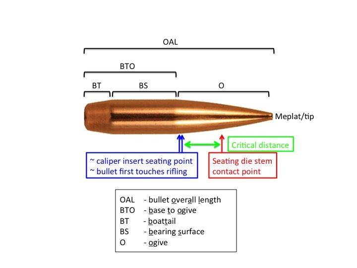

    I know the bob green comparator measures bullets from the base of the ogive to up on the mid curve which allows you to sort the bullets themselves into like lots based on geometry.

    I think the idea is that as long as you're consistently hitting the same spot on the ogive ... and measure from there when logging distance to the Lands ... it should give a very consistent result. You still use the modified case and OAL gauge like always. But you do your measuring with this gadget, instead of with calipers. It worked perfectly for me on multiple calibers. The video helps explain it better than I can.
