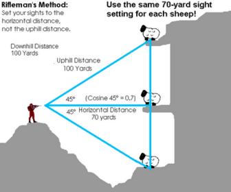

I'll attach a picture I found online that will help explain. The picture shows an actual distance of 100 yds instead of my example with 1000 yds. As you can see, the bullet will be covering a 100, (1000 in my example), yd distance in which wind can effect it.

I respectfully have to disagree with you. I thought the picture would help show that for an angled shot, the bullet is actually traveling 100 yds, (1000 in my example). That's the distance, (time of flight), the bullet will cover. That's the time over which the bullet can be effected by the wind.
As far as bullet drop due to gravity, we need to use cos(angle) times the true distance to see how far the drop will be. This is the horizontal component of the distance.

You want to isolate the cosine element from the trig equations and dial that in. In a nutshell. Uphill and downhill shots include the sine and cosine elements and line of sight is along the hypotenuse, which is longer than the sine or cosine alone and is the square root of the sum of the sine and cosine elements each squared. You need to measure the line of sight to the target, then isolate the cosine element and use that distance to dial in.
The sine component only considers distance in the vertical whereas cosine considers only distance in the horizontal. Since we can eliminate the vertical component as all it does is affect the drop (which will be the same regardless given a particular round) we need only concern ourselves with the cosine element, or the distance to the target assuming there is no elevation.
The cosine element is shorter than line of sight and due to the sine element being a constant, we can make our adjustments using only the cosine measurement. In essence, a shot adjusted using the hypotenuse will be adjusted too long whereas a shot adjusted using only the cosine element will yield a shot spot on.

Uphill/downhill ballistics explained:
exterior ballistics
Interesting. I always wondered why the drop would change for the same slant range, as drop is time of flight and gravity (constant).
That link explains the that drop does NOT change, but the relationship between the line of sight and the trajectory DOES change.

height = strait line distance in ft * sin (angle)
correction factor = 1 + 1.3 x (10 to the negative fifth power) X height
Corrected B.C. = un-corrected B.C. X correction factor

I didn't see anyone else mention that air resistance has more of an affect on a bullet than gravity. The air resistance gets thinner as you shoot up, and thicker as you shoot down. So if gravity is slowing down the bullet while the air is getting thinner, it's not so different from the bullet not fighting gravity while getting into thicker air. Some other things to consider: wind gradient, and your physical/equipment ability to shoot high angles.
For example, consider a 700yd (shooter to target distance) 45 degree shot. This is some pretty serious incline. I've yet to shoot over 25 degrees. Some sort of crazy mountain shooting. I'm going to use my .260 data. 140 amax @ 2740fps.
Shooting up hill:
Distance to target- 700yd (LRF the target)
Angle up 45 degrees
Elevation difference from you to the target- 495 yd (1485 ft)
Gravity effect on the bullet- 495 yd
So at 700yd, what is the difference in your dope for 1500ft? For me, about .1 mil. If I was going to go at it, knowing that there was a 1485 ft difference in elevation between me and my target, I would take the data from the halfway point (my elevation + 743ft). The net effect of air resistance change is less than .1 mil. Almost a wash IMO, unless you're doing ELR stuff.
Also, if I use simply the flat-shooting range of 495yd, I need to use 2.7 mils to get there. However, if I shoot 45 degrees [MENTION=100785]700[/MENTION]yd (495yd gravity pull), I need 3.0 mils.
Why? Because gravity is only pulling for 495 yd, but the bullet is still pushing through 700yd of air, and has a 700yd-long flight time.
Now compare to down hill, -45 degrees @ 700yd. Gravity still pulling 495yd, this time partially "helping" the bullet along.
495 flat-line remains 2.7 mils, but 700yd @ -45degrees is 2.9 mils. Again, the 1500ft change in altitude (air density) is going to affect it less than .1 mils.
So 2.9 and change up and 2.9 and change down (air density helps shooting up hill, hurts downhill, gravity hurts uphill, helps downhill).
Playing with some numbers on JBM, it would appear that this rule of thumb works fairly well (in my limited number playing). When shooting at an angle, take the flat-line dope for the gravity-span of your up/down angle shot, then multiply your DOPE by 110%.
Maybe make a chart starting at 20 degrees and do every 10 degrees to 60 for a coefficient to multiply your LRF-range (hypotenuse) by to get gravity-range (base or adjacent), then take your flat line dope and multiply drop/correction in Mil/MOA by 1.1. That will get you within .1 mil.
This is assuming you want to do it electronics-free. Otherwise just plug the shit into a ballistic calculator.
Yeah I tried to push the limits of what anyone can realistically expect. I'm sure someone out there has done more "extreme" in both angle and range, but I've shot quite a bit in mountainous areas and like I said only ever approached 30 degrees, though I would love to get some more experience at higher angles.
Anyway my main point was that the change in air density and the effect of gravity nearly cancel each other out, to the extent that it's negligible to the shooter. I agree with previous posts that your environmental effects (updrafts, boils, wind gradient, eddies etc.) will probably have more effect on your POI than will the correlation between air density change and gravity's pull.
edit to add: And that's just one example with MY data. Take a couple hours, do some trig (A^2 + B^2= C^2, and SOH CAH TOA), Get on JBM and play with temps and pressure, and range and angle, up and down hill, compare it to the flat-line distance of gravity etc. etc. It doesn't take too long to notice patterns that can be helpful to generating your own "rule of thumb" that you can go out in the field and test.
