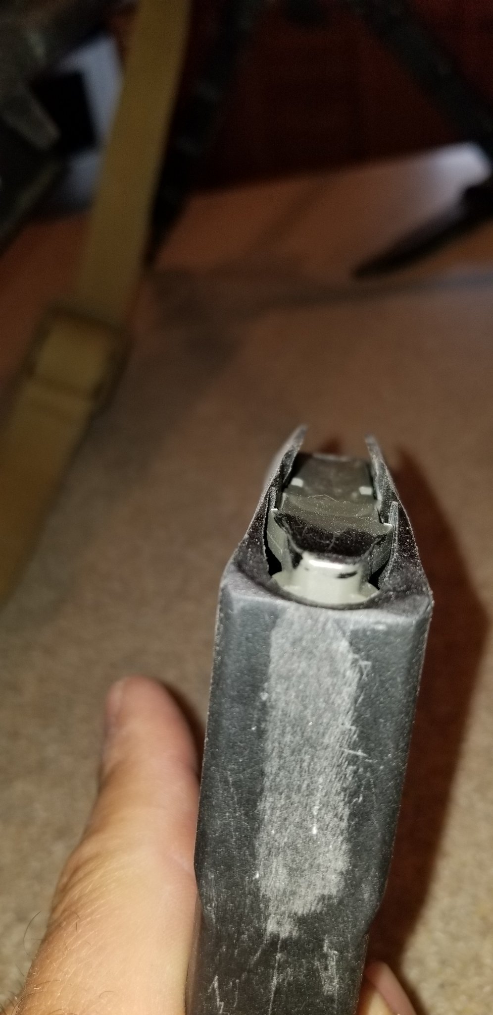

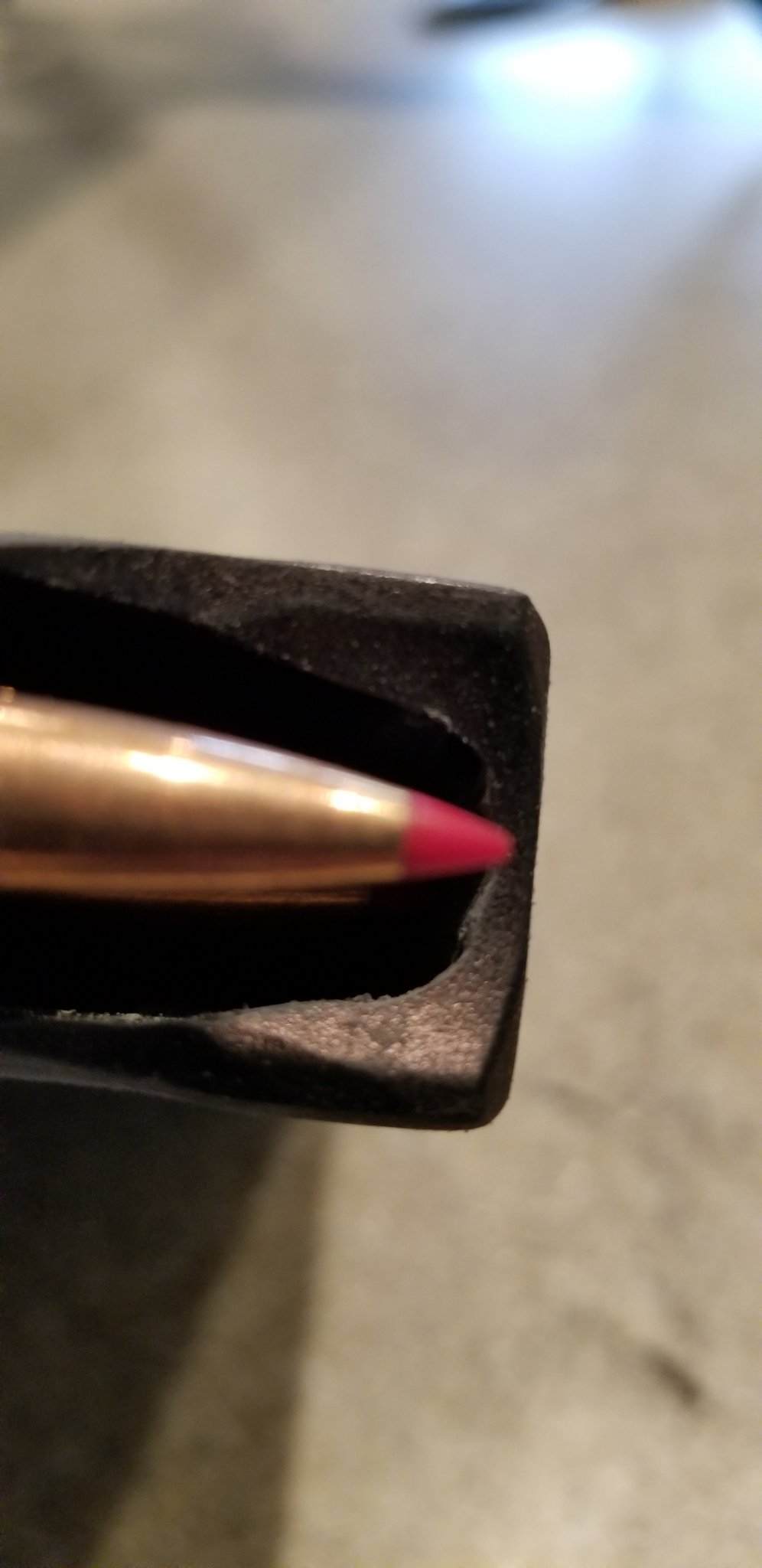

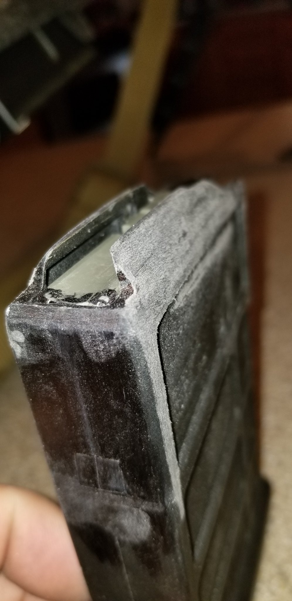

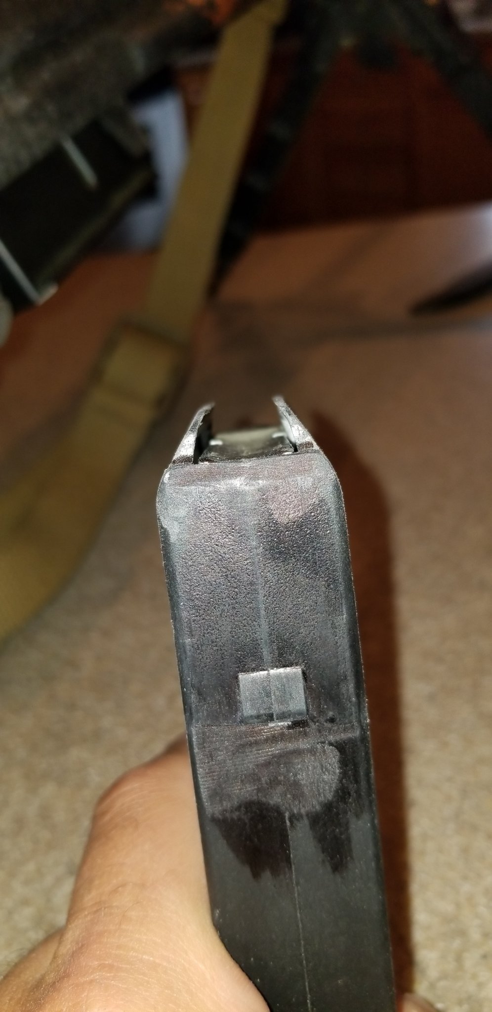

Purchased the magpul aics mag. When I tried to insert it in the stock, no go. Not even close. I ended up taking alot of material off the sides of feed lips. Magpul has a rib that needs to be taken off. Also opened up mag well so I can run same length as the metal aics mag and ended up going a bit past that. To be honest, the magpul mag is much smoother when cycling rounds. I dont need to use near the force I did with metal mag. Overall, 30 min of sanding and fitting was well worth saving over 50$ and it performs better. A plus....it top loads. Not the best vids but you get the idea. Thanks for all the help guys.

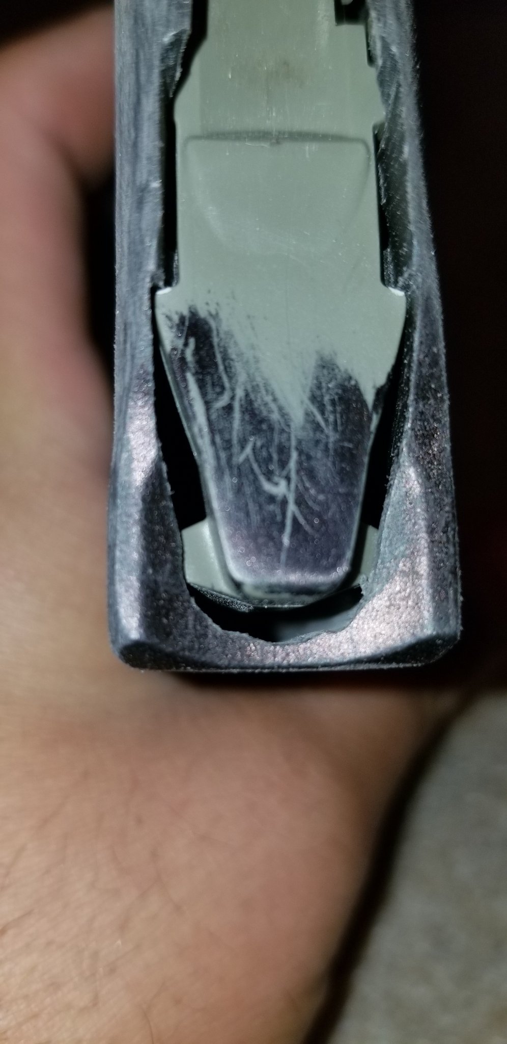

Have any pics of the modification? Thanks!
Reactions: wpierce
Just got to clean it up a bit and thats about it.
