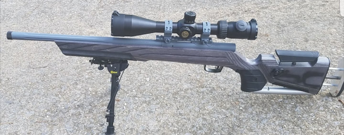

I am considering upgrading this gun to either a Boyds AT-One or Pro Varmint (old Tacticool) stock w/ adjustable cheekpiece, or even the new MDT LSS option for .22 rifles.
However, before I spend the money on this rifle, I was kind of wondering if I was really just going to be polishing a turd and should instead just spring for a CZ 457 and just build from there. I can likely pick up a 457 Pro Varmint for ~$100 more (probably less) than an MDT LSS and it may be a better base to start with and grow from?

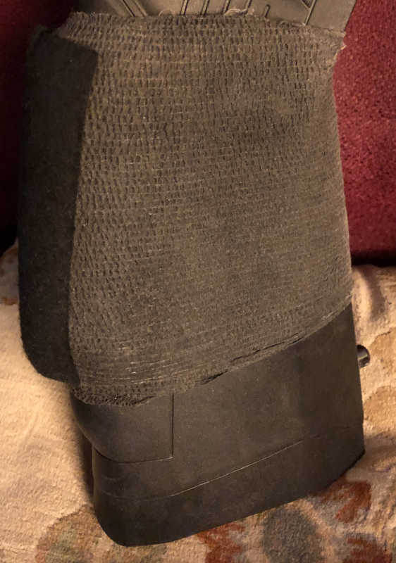

If you want to correct the height of the stock inexpensively to see if that it your issue, you can build a cheek rest using a few strips of camp pad, some Vet tape (like veterinarian use to wrap horses legs), and if you want to get a little fancy, a strip of adhesive backed felt. The felt is nice because when it gets dirty or frayed you can just pull it off and easily replace it. I have the same setup on a couple of Savage FV-SR rifles and one of my 10/22s. Besides being cheap to build, requiring no permanent modification of the stock, they are also comfortable to boot.
Or just go buy one of the bolt-on check risers like:
Even if you buy another rifle, you should fix the cheek weld on the FV-SR.

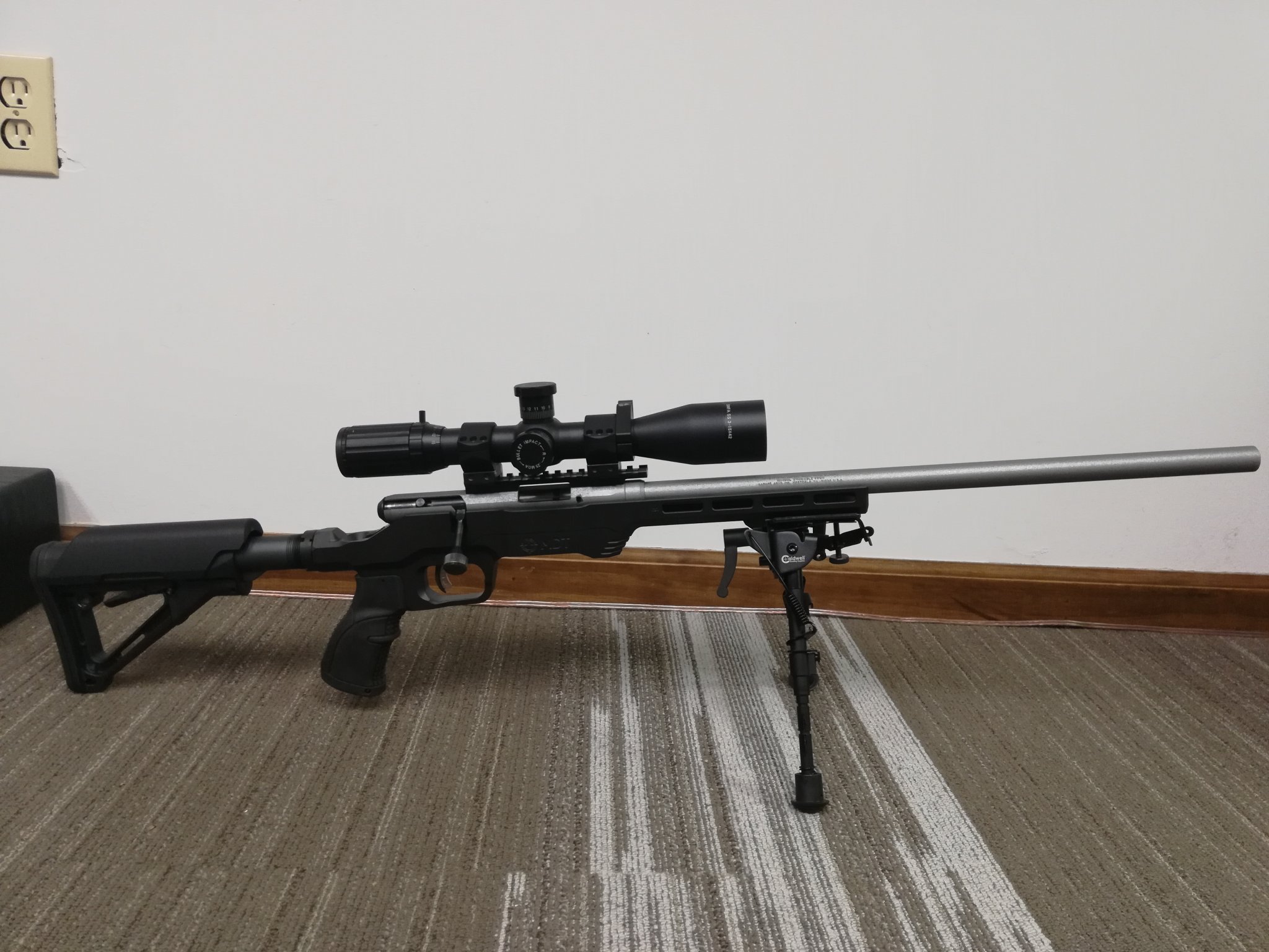

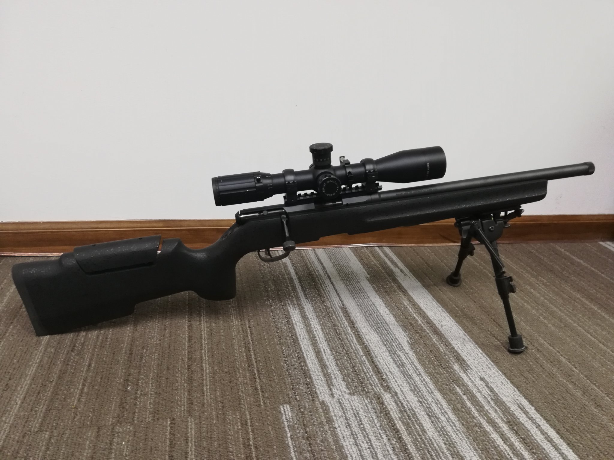

I have a Tacticool on a Savage .17HMR and a AT-One on a CZ 455, also in Hummer. My preference is the AT, easier to carry in the field, adjustable LOP and cheekrest.
Both are good stocks, both rifles are very accurate, I just find myself reaching for the 455/AT more often.
Reactions: claytonm
See, I thought about buying one of the cheek risers to try out, but maybe I'll try wrapping grabbing some foam and wrapping the stock, good idea.

Hmm, good question. I prefer the AT stock and CZ magazines. The Savage is the same model as yours, only in Hummer and at the range will out shoot the CZ by a small margin. Sloppy answer, range time Savage, field time CZ.
I've been in your boat and rather than sell the Savage just upgrade to something a little more refined and keep the Savage as is. One can never own enough rimfires.

You are in a very similar situation to me this past year. I had a Savage FV-SR that I bought and immediately dropped in a Boyd’s tacticool stock. I didn’t even try to use the factory stock. It was absolute junk. The rifle in the Boyd’s stock shot amazing. The accuracy was pretty remarkable considering what it cost.
This year I started shooting 22 PRS style matches. I started the year out with my MKii and every match I had reliability issues. 99% of the issues were magazine related. I tried doing the fixes for the magazines online. The rifle would function fine while practicing and it would take a dump in the middle of the next match. Ultimately I just got frustrated and sold it to a friend with the stipulation that he needed new magazines. My replacement rifle was a Tikka T1x in a KRG Bravo. It made all the difference in my scores at matches. All the malfunctions were killing my scores. I also didn’t have confidence in the rifle.
In addition to the Tikka I just bought a CZ 457 as well just because I wanted one ? it is the Pro Varmint model. The two rifles are just about equal in accuracy. I plan on eventually putting the CZ in a chassis which should make the two rifle about identical.
If your Savage functions well and you are just using it for target shooting you are probably fine just putting it in a new stock. My Savage was accurate from day one but as I said I never shot it in the factory stock. If yours is lacking in accuracy now I don’t know if a new stock or chassis will make a significant difference. Maybe someone who has transferred it from stock configuration to a after market stock can comment on the difference it made. If it were me, I would set the Savage aside as a back up rifle and buy myself a CZ or Tikka though.

Do you guys know how much does the Pro Varmint stock weight? I cannot find it on Boyd's website.

The Boyd's pro-varmint is a heavy stock. It's large enough to accept most centerfire actions and I think Boyd's just uses the one basic pattern for any rifle they offer it for. I don't remember the exact weight of the stock as it came from Boyd's,. I do remember that assembled with a 6x24x40 scope the FV-SR weighed over 8 1/2 pounds. Pretty heavy for a short barreled 22 rimfire. After giving the stock a serious shave and haircut to remove the excess wood I have it down to slightly over 7 pounds with a Bushnell AR scope on it.
