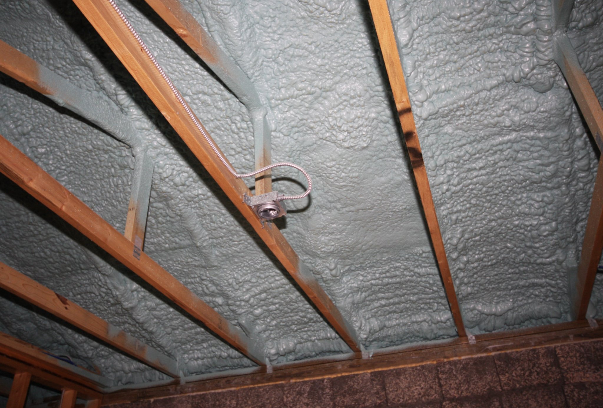

Here’s the issue with spray foam and having an unvented attic. Especially in humid areas. The home will self destruct in the absence of electricity (unvented attics REQUIRE air conditioning underneath constantly). Many homes in Florida that either went without power due to hurricane or foreclosure filled up with black mold. Most had to be stripped to the framing to repair. A vented attic is self-drying without power so for our off-grid ready home an unvented attic would have been a horrible choice.
Conventional insulation systems use the heat of the sun to pull air up through your gable vents and out your ridge or off-ridge roof vents. Batt insulation allows moisture to pass through and evaporate. We went with a metal roof and that alone dropped our attic temp almost 30° during the summer vs asphalt shingles.
Spray foam has it’s place but it has importance drawbacks that most do not understand. Homes in Florida developed mold within just a few weeks in the absence of power.

I have never seen foam installed over the ceiling, only to the underside of the roof deck.
Airflow does not need to be maintained in an unvented attic (this is the term for most foam applications). The attic is sealed, and yes it does cost less to cool the home, about 10-25% less depending on the other insulated surfaces and windows (cmu is usually the lowest r rating, ICF the highest). Usually count on about 75% of whatever they tell you the savings will be. I have had the advantage of seeing identical homes side by side, one foamed and one conventionally insulated. The foam house actually cost about the same to cool, but was running a smaller tonnage system that ran more frequently. Another interesting observation was the foam house had a light silver shingle and the batt had black. These were model homes and not lived in so an ideal comparison. You have to remember as well, with an unvented attic you are actually cooling and heating the attic as well as the living space.
The issue I raised earlier, is retrofitting an older home is problematic because spraying foam in your attic is part of the system and you need to ensure you address everything else. While batt can be used in the walls the vapor barrier needs to be sufficient, and in older homes this is rarely the case.
