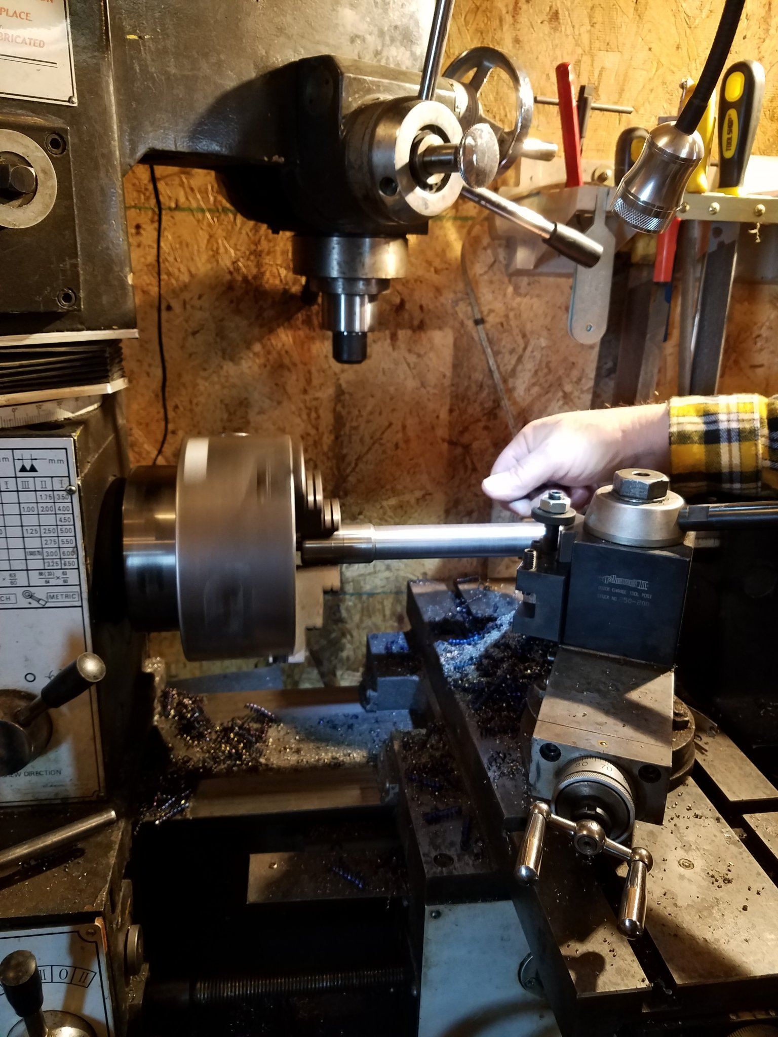

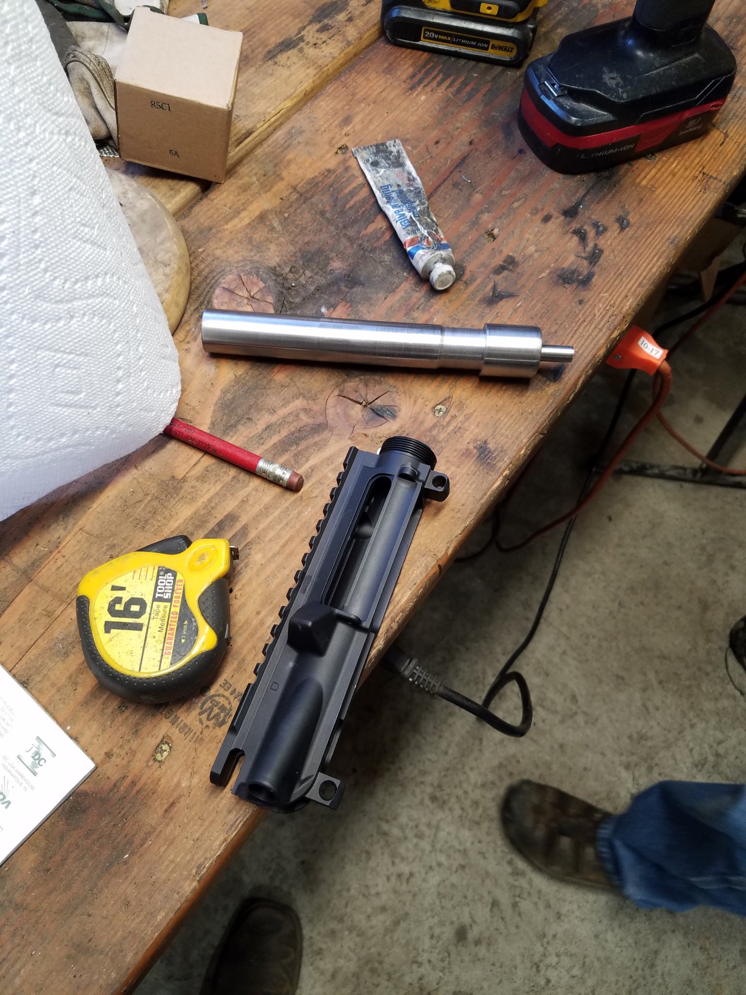

Well, Saturday I got to hang out with grandpa and he spun up a mandril for lapping the reciever face. Ended up using some valve lapping compound (not sure if thats socially accepted here) but its what we had on hand. Went alot smoother than I thought!

But as far as lapping from of receiver......back tracking to the bolt.......if there is ANY "play" in the bolt as it slides into extension.....I fail to see how lapping does anything at all
Unless the rationale is it lines up bolt more with extension in a "straight line"..........
That is exactly why.
If one side of the receiver is .002 further forward than the other side the one side of the bolt lugs will be .002 off the extension lugs for a while.
It's all about angles, eliminating them that is. If the front of the receiver is crooked and a loose fit, the barrel extension will sit in the receiver at a slight angle. The bolt can move around radially, but can't make up for an angle except a very tiny amount. If the barrel extension is crooked by just a few thousandths at the receiver face, the back of the bolt carrier would have to move many times that much to allow the bolt to sit at an angle, and it can't. The mass of the carrier also prevents that from happening even if it had enough clearance.
