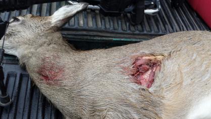

Let me start off with it was still a one shot one kill, no the doe did not run off and dropped in place. However, I am upset because of bullet performance. This is the second "bad" kill I have had using these 150 grain silver tips in .308, factory loads. I am generally a Barns guy but I thought I would give these a try and they group better than the barns factory. 80yard shot deer was presenting a walking 3/4 away target and shot placement was key and intended to shoot through the ribs through heart/lungs and out right side of front neck. However on impact the round disintegrated and never penetrated the ribs, left leg was separated through the muscle group and no bone fragments, the kill was due to a small wound channel that severed the main artery and esophagus and out the front left of the neck. Exit wound size looked like the size of a .22 or .223. Entrance wound looks like and exit wound. There is however a small line to where the pill did scrape the hide before entrance. Am I the only one having this issue with silver tips, I hear nothing but good things from other people.

I had a similar experience a few years ago using 300wsm 150 silvertips. I had a slight quartering to shot on a Mule Deer at about 200 yards. Shot went in the chest right shoulder area. Penetration was good and the bullet did its job but it blew up inside with bullet fragments everywhere. There was only one small pencil sized exit hole from a bullet fragment. Deer fell immediately due to the blown up shoulder so I don't look at it as a bullet failure. I just think these bullets are less than ideal for a shoulder/bone impact.
First, I'm glad to hear you recovered the deer without issue.
Second, I'm not sure from reading the description if you have a bullet issue or (I cringe to say it) a hunter issue.
The shot was known to be a shallow angle into a shoulder/rib area from very short range. The 150's from a 308 are probably approaching 2900fps and at 80yd they're still screaming along.
The silvertips aren't a great bullet, but they're really not terrible either. They aren't, however, meant for impact speeds so high and on hard items in the animal.
It looks like you placed the shot where you needed to, however the bullet/caliber choice for the hunter taking that shot was wrong and that's not a slam on the bullet. They are nothing new, their performance and behavior is easy to find out about. The good part here is the deer is in your freezer and you know now that the bullet is not reliable at short distance into a stack of ribs, you should probably use a monolithic bullet of some type instead if you're going to be shooting deer in that type of situation regularly.
I've taken the same shot with the same bullet from a 30-30 and the bullet worked fine, however the MV was around 2320fps and impact velocity was probably around 2150 or so. I suspect your impact velocity was 600+fps faster and that's why the bullet came apart so violently.

Do not get me wrong, I know the bullet and its limitations, I understand that it is ballistic tipped and its inherent characteristics. I am upset that the bullet did not make it to the ribs. That it began and ended its "rapid expansion" and "disintegration" at "impact". The ribs and meat immediately surrounding the ribs was undamaged/ touched. The separation happened on impact with the skin not the bone, no bone damage on either shoulder or ribs, no penetration, I wish I would have taken picks of the deer during cleaning and wound channel explorations. Next time I will, however, it will not be with this bullet as this was the last time it goes on a hunt. The last failure was to a trotting and broadside shot to a yote at 200 yrds. That was a bone impact, that I understand, and yet it still killed the coyote however it was painful for her. I just think I will stay with the Gameking and Barns copper.
I'll echo what bohem and bmxer have said. its all about the conditions of each shot. There are plenty of expensive hunting bullets that would have done the same thing possibly. There are plenty of options, and as long as you keep hitting em right, you'll do fine.
