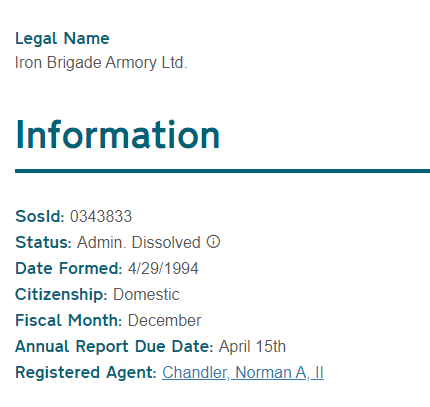

How do you have a rifle being built by IBA? Didn't they closed years ago?
Sincerely,
Theis
Hi,
Sincerely,
Theis
Yes, IBA did stop operations. This is a rifle started many years sgo when they were still operating. Lt. Col Norm Chandler is a personal friend and found enough resources to finish this rifle. I have two other IBA rifles, a Chandler Rifle in 7X61 Sharpe&Hart and a tricked out M1A with heavy McMillian stock and full heavy Gene Barnett barrel.

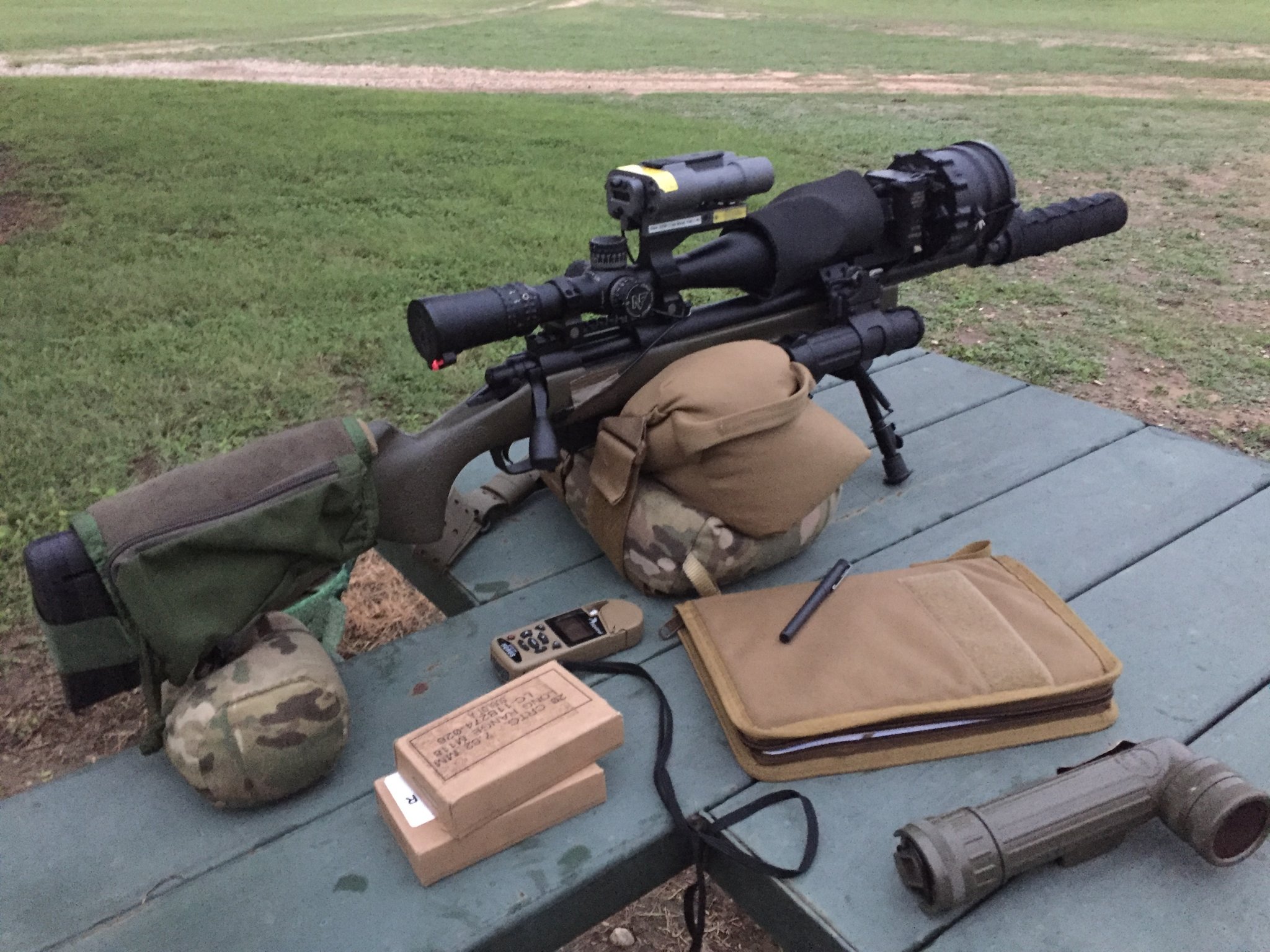

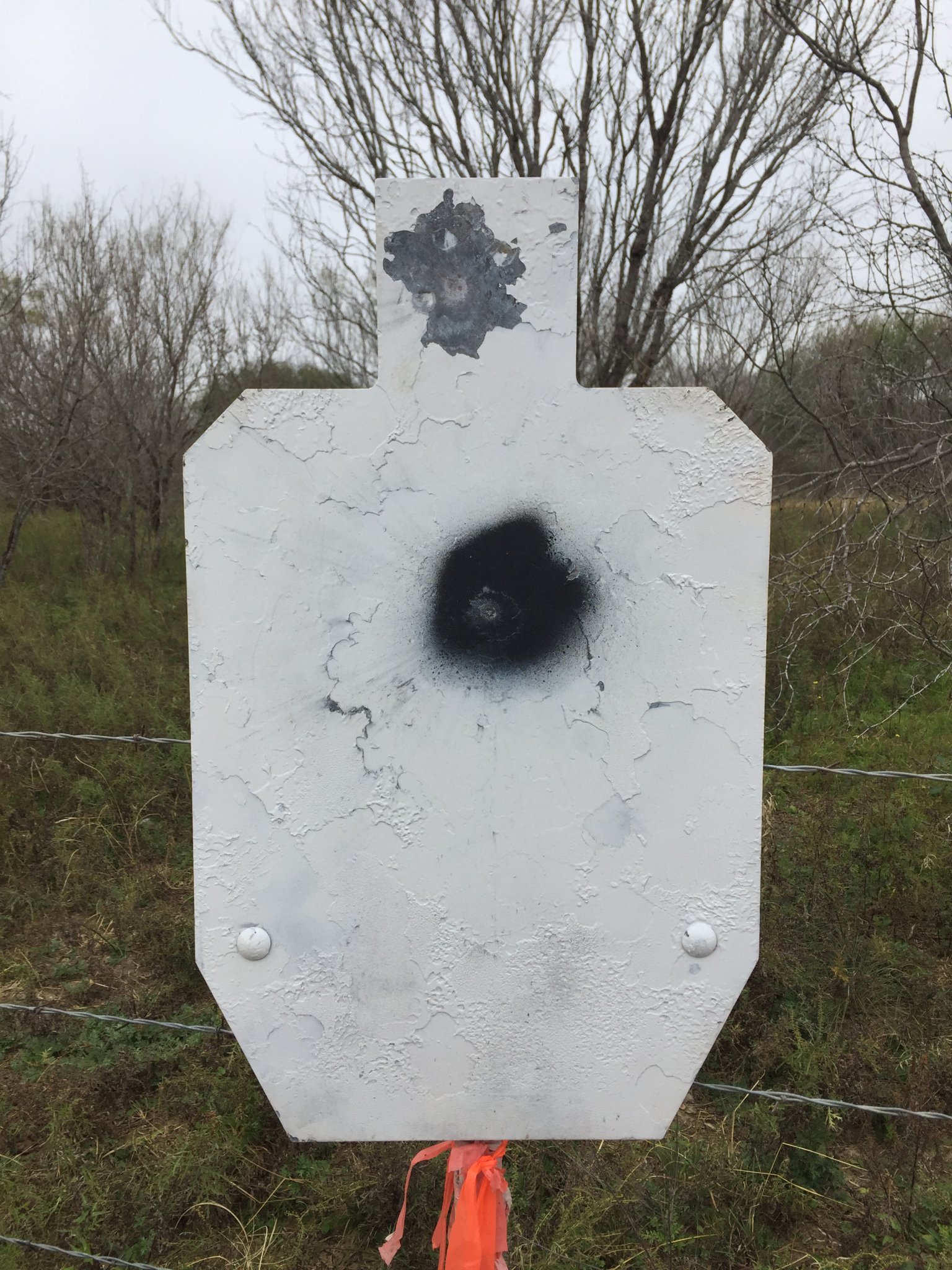

I have one of the XM-3 Program Prototypes and run a PVS-27 with no issues. I‘ve attached a “morning after” pic with 27 mounted along with a SICo Radius and SPIR. I realize the shroud prohibits you from seeing exactly how the NOD and Day Optic interface, but, as I recall, horizontal centerline alignment was “dead on” and verticle Centerline alignment was within .25“ running NightForce 1.000” or 1.125“ tall Ultralights (I need to check) instead of the spec .885”’s. We can nail down the exact ring height if you are interested in pursuing, but I had no issues making head and heart shots at 698 yds at night. Ping Me if we need to dig deeper...
Regards
JHC

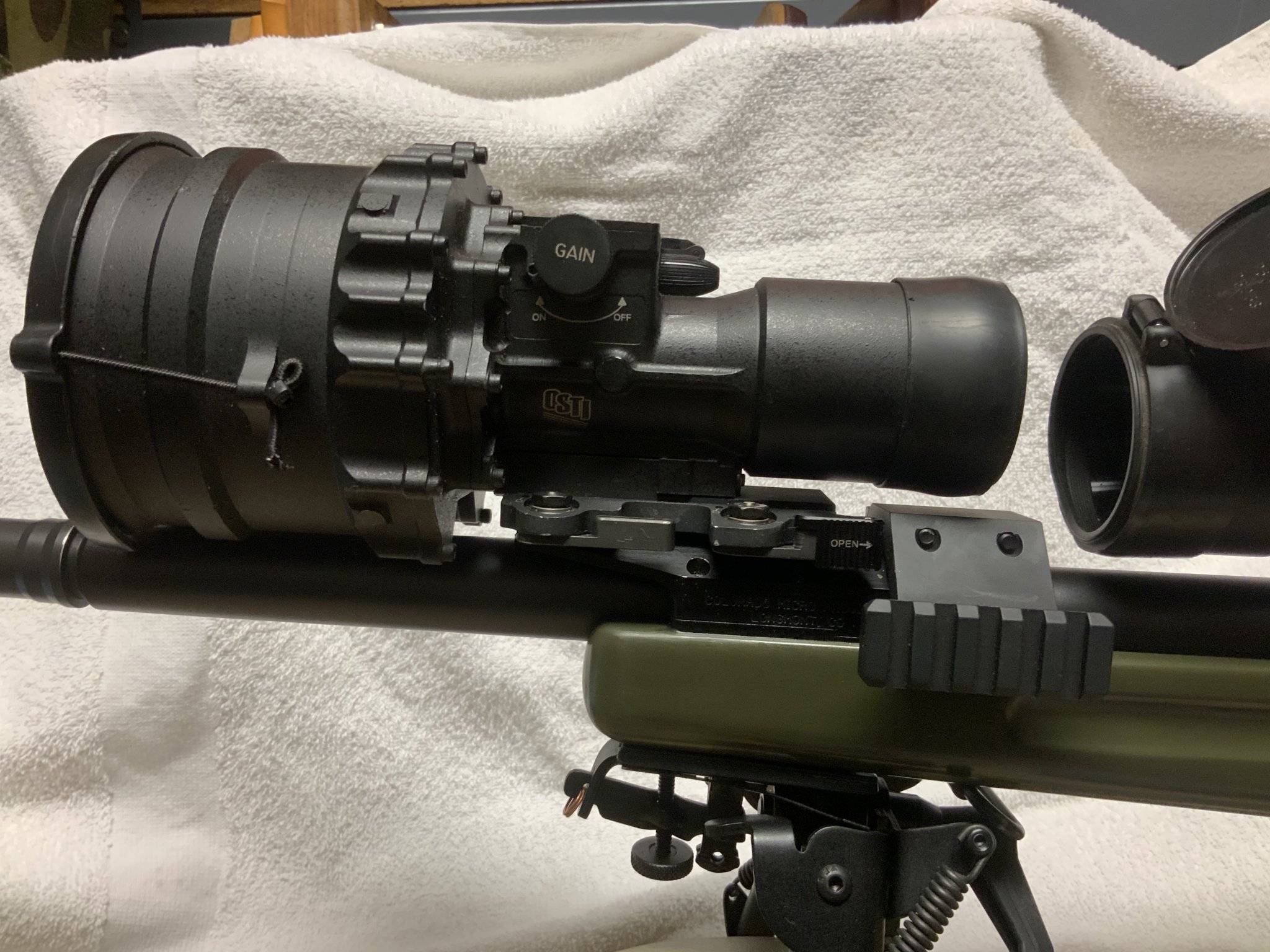

Ok... a little follow up.
Nik H: The height of the RAP pic rail above the centerline of the scope is ~ 1.8”
Mike: I confirmed that I used 1.000” high Ultralights (A101). The vertical offset between the center lines of the Scope and the PVS -27 is ~ .5“. see attached pic for detail on the NOD - Day Optic interface.
