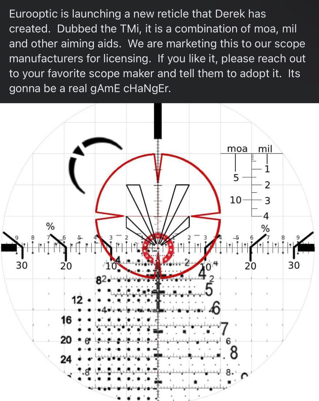

Etc
Awesome idea. Might as well at this point - I started MOA cuz 'merica but no denying the base 10 thing mils are just simpler to me once you get the hang of how to convert the 2.
Why would you ever need to convert between the two? Your friends don't all shoot mils?

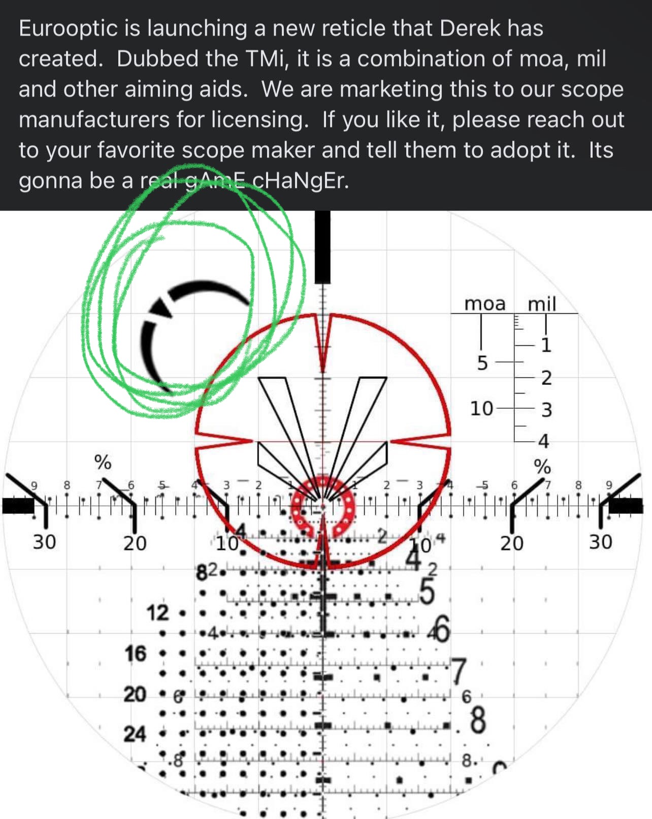

I believe that indicates the current location of the Death Star. Once it comes around the other side of that center circle it's clear to shoot.
Ahh that makes sense. I should have read the effing manual.
Thats half of it. Other half is a double zero reticle - to be clear, I still believe a precise 100yd aim point is useful. Its just a way to integrate more info with less clutter than the moon phase indicator TMi above lol. And you have to make it different enough to avoid HVRT et al and their 'coveted' gravity/atmosphere patents; cuz they love racking up billable hours.
