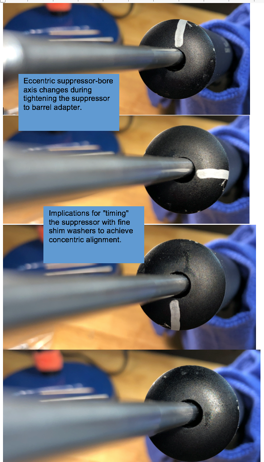

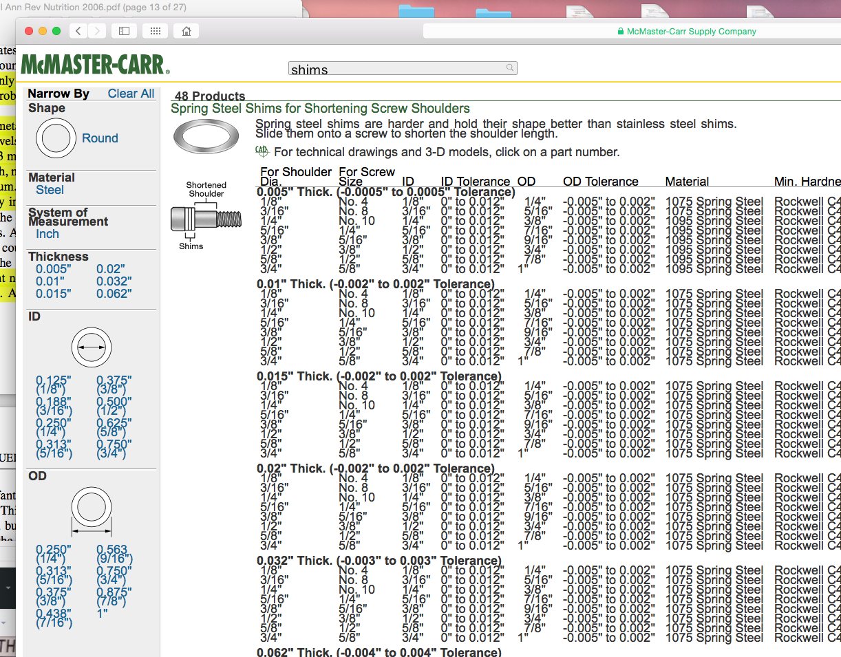

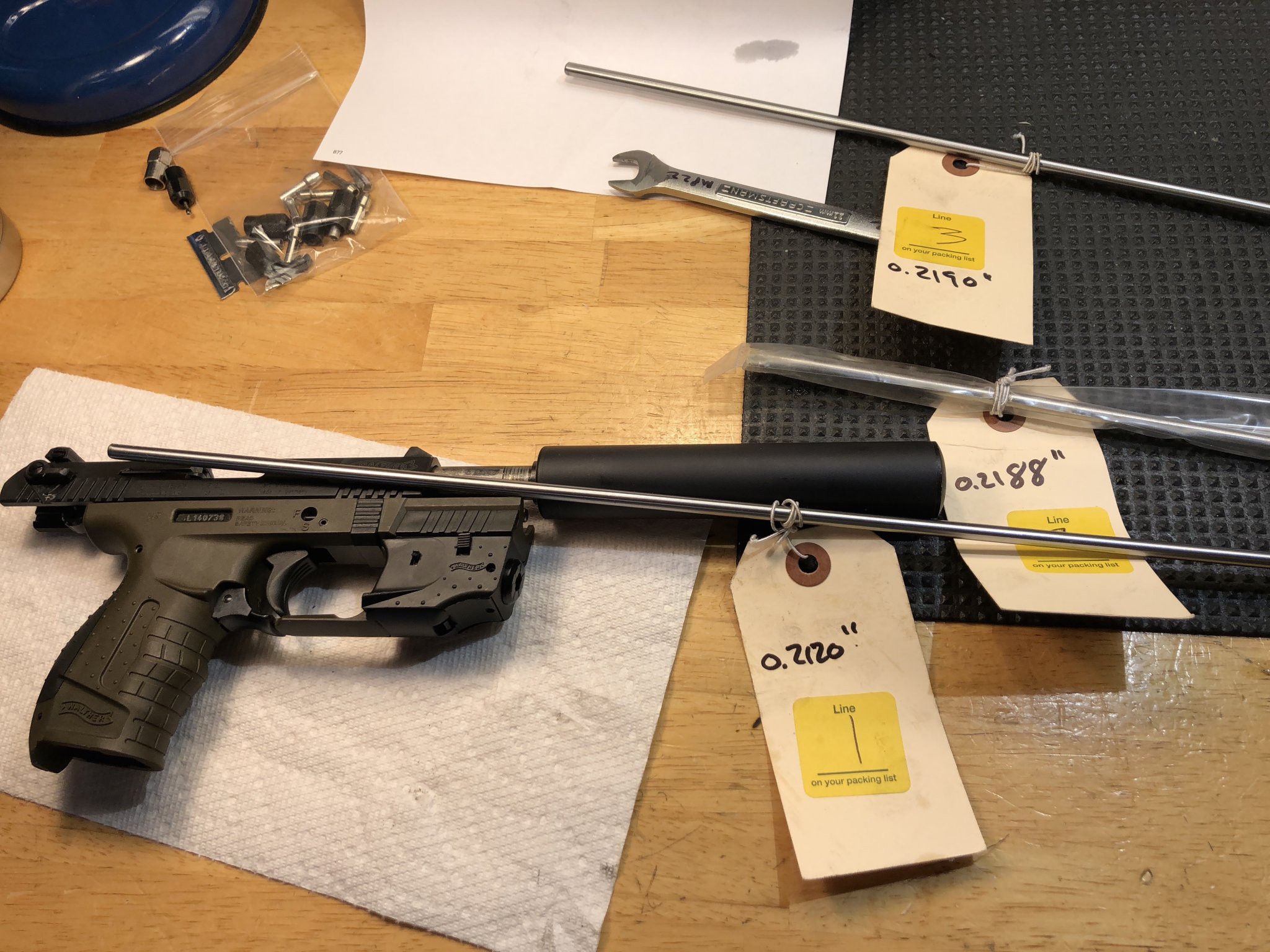

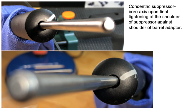

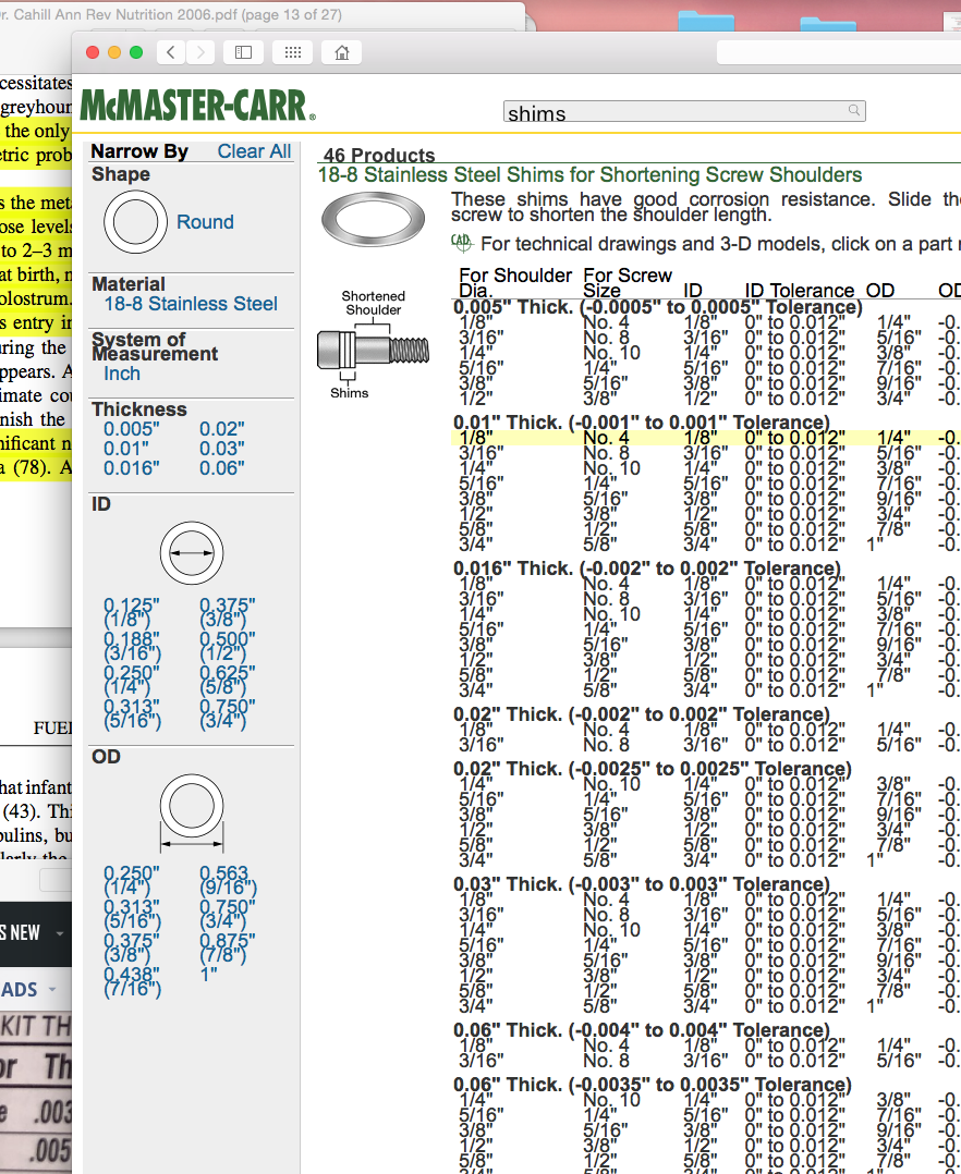

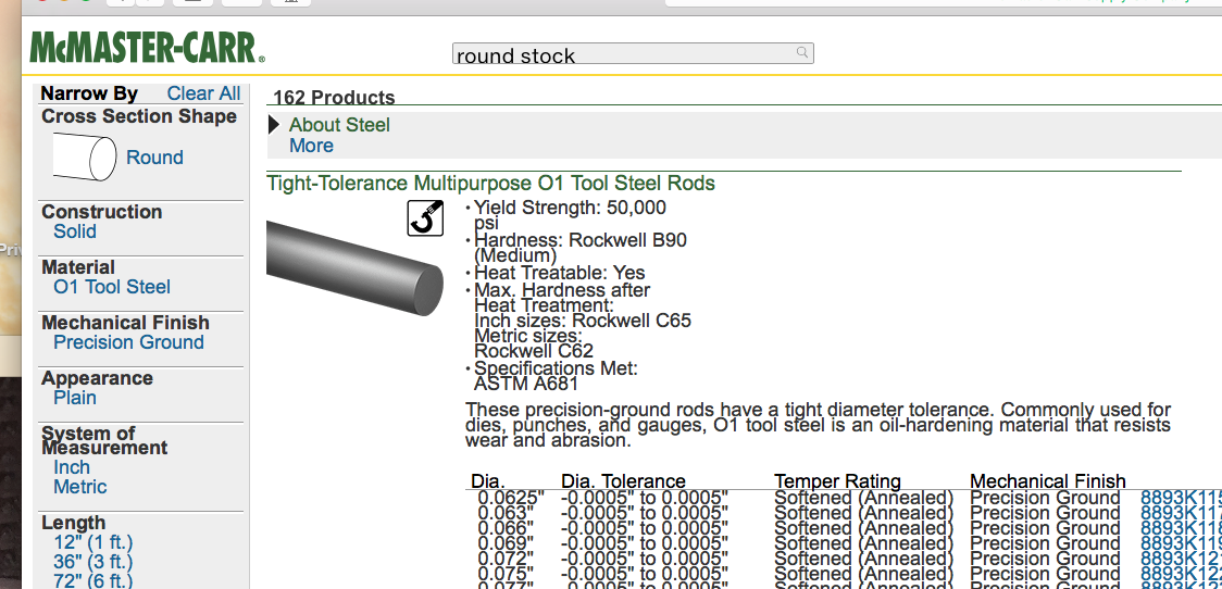

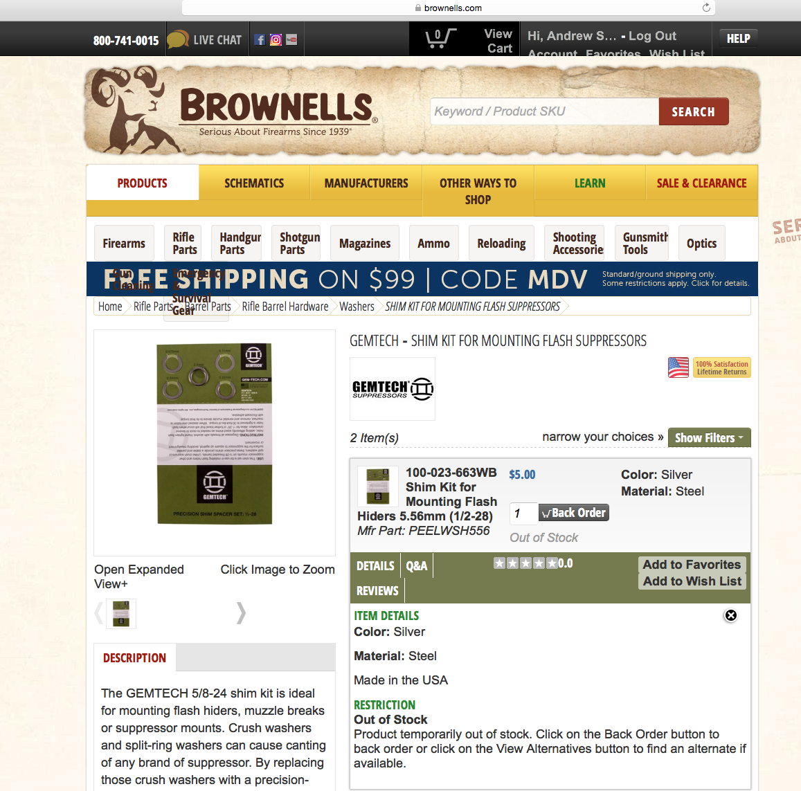

FYI- you can fabricate an alignment rod very inexpensively by using the proper sized Tight Tolerance Multi-Purpose O1 Steel Rods available at McMaster-Carr, only $5 or less for 3 feet of rod! I have the Geissele''s but I didn't know about this type of round stock availability. I was looking for a .22 caliber alignment rod on line and couldn't find one so I used the 0.2120", cut to length, chamfer the ends and use with light lubrication. Getting to my point, I was amazed how out of alignment the bore-suppressor axis could be during the final rotation of the suppressor mounting, every 90 deg off would / could have been a potential baffle strike without the use of the rod as guidance. Also you may need to use thin mounting shims to "time" the alignment perfectly. It also makes the point that a slight loosening of the suppressor during use can degrade accuracy or result in baffle strikes.
