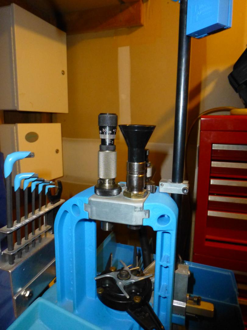

Dillon makes an adapter that replaces the powder measure and fits the inner drop tube. A different powder measure or a funnel fits right in the top.
