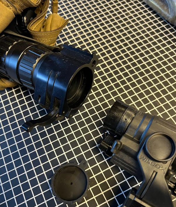

    Has anyone used a PVS-14 with a Spotter 60? I know there are dedicated adapters for the Leupold Mk4, and I’ve got a Monoloc SSAHD adapter tucked away somewhere for attaching a phone that might help, but I’m curious if there are newer/better adapters out there?
    I’ve got a high spec PVS-14 and I just want to see if it’ll work for night spotting (with a Kiji) before going the clip-on route.
    @WillHugh and I regularly use a Badger SNAP with a high spec L3 PVS13 behind a Mk4 spotter. I am not sure if it would work with the spotter 60, but if the eye piece on that spotter is built similarly, it may be worth trying with the Badger SNAP. If the eye piece objective is smaller, a little bit of electrical tape would likely solve the issue.

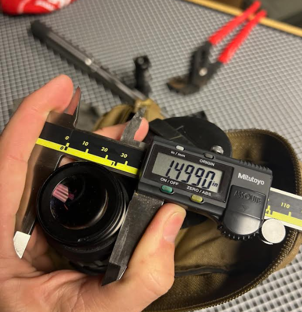

    Nice. I’d be curious if you or someone else could measure the OD of the Mk4 ocular before I throw $160 into the wind.
    It looks like the OD on the Spotter 60 is just shy of 1.5"
