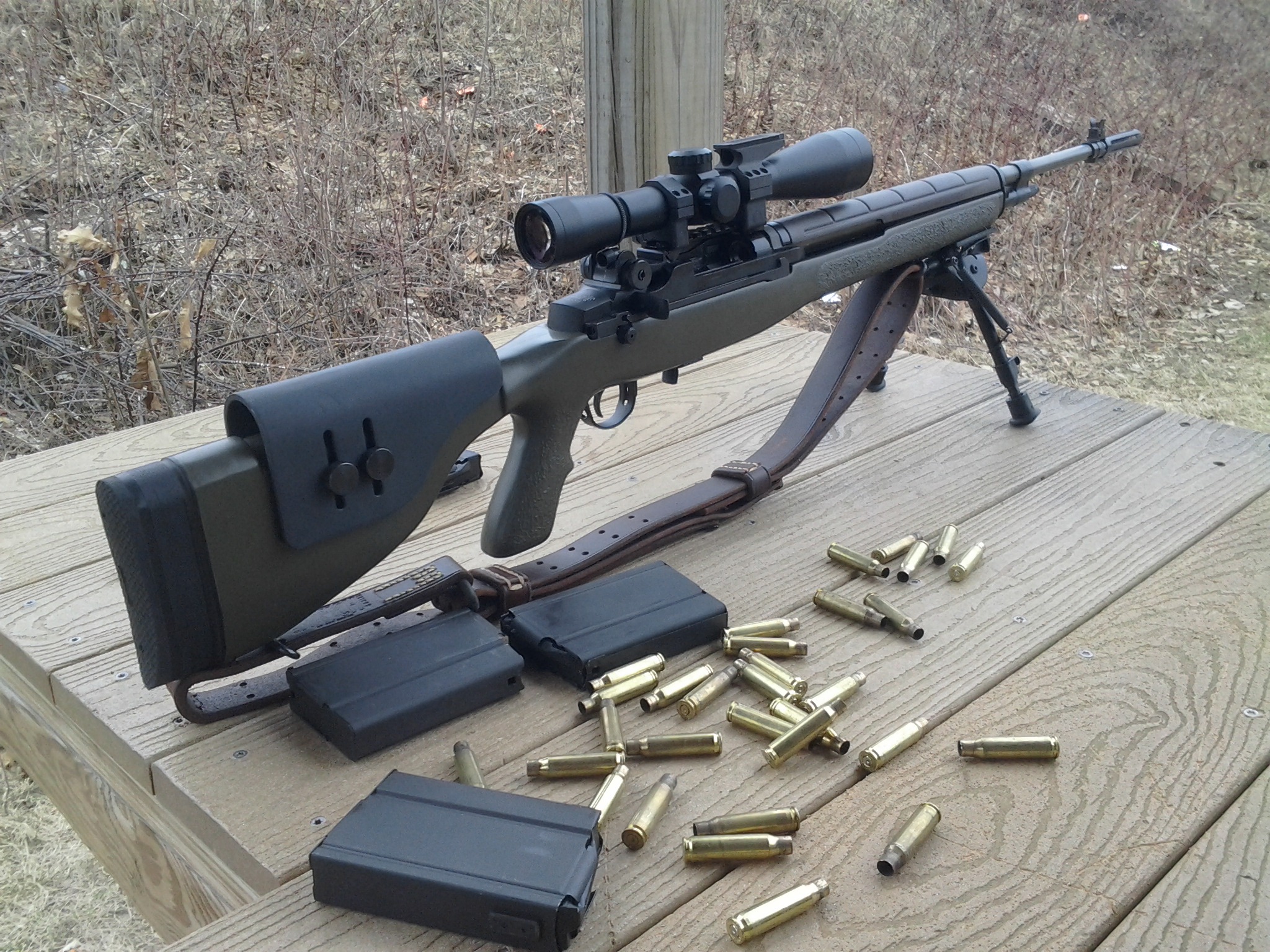

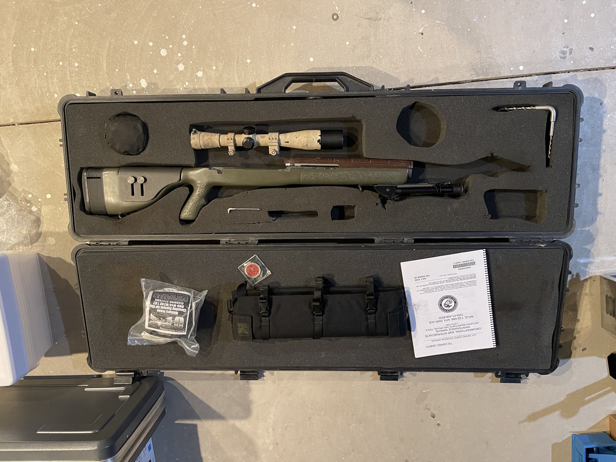

    A few people have asked me what I'm building next, so I decided to give you guys a peek at my next build. I have an absolutely beautiful USMC green DMR kit with original sniper paint on the stock, scope and rings! The USMC GG&G scope mount is the issued one that's not normally seen on these rifles (if you look at photo in my previous post, it's the mount on the middle). This version of the mount lacks the USMC marking at the bottom, but we still have evidence that it was used on these green DMR rifles. The 3rd I have, the one that has USMC on it, is currently with a friend. He's borrowing it for a project, which will hopefully be completed soon!
    The barrel is a 2012 dated Krieger that is from a group of overrun military barrels. More than likely these barrels were from a USMC order that was canceled in 2012 or shortly after. During this time the Corps was replacing the DMR and M39 EMR with KAC M110's. My unit had both the DMR and EMR on our deployment in 2010 and I didn't see an M110 until 2012. The barrel manufacturer and profile is correct, but the date should be earlier. I might have to remove the current stamps and remark the barrel with older information, since these green rifle were first made in 1999. If anyone here has an original USMC DMR barrel that you're willing to sell or trade, please let me know, I'd love to have it for this historical build!
    I still need to find a Springfield 5 line receiver and the other USGI parts. @forceman said that he wants to build this rifle to perfection, so I can't argue with that! I'll send him these parts when I track down the receiver, bolt and a few other items. This is going to be an awesome build! Even though there's a few DMR clones out there, this is going to be one of the only, if not the only, clone built from original USMC sniper painted takeoff parts. Hopefully you guys will like this build as well!

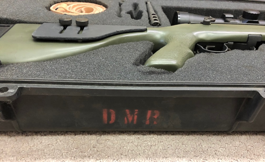

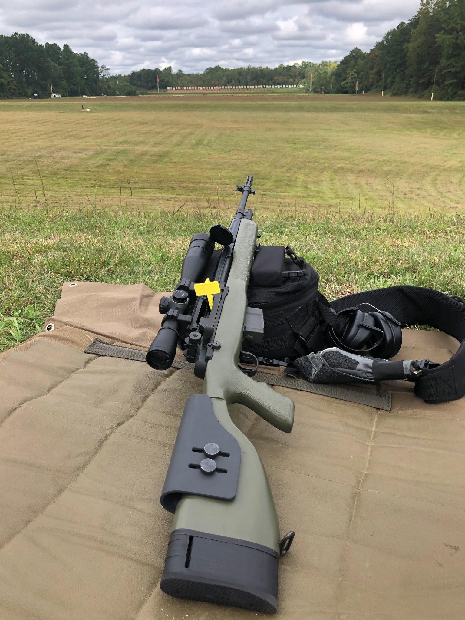

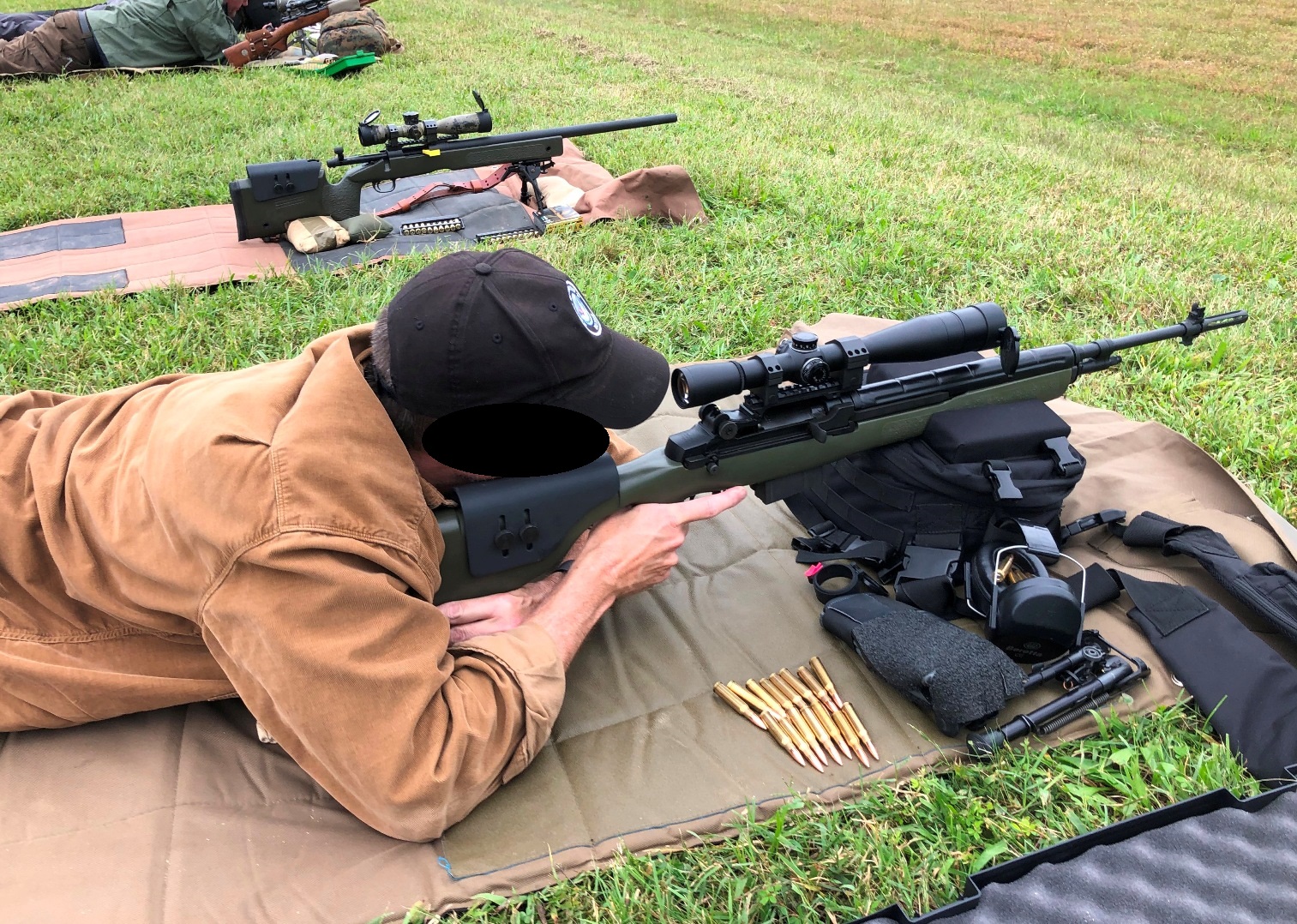

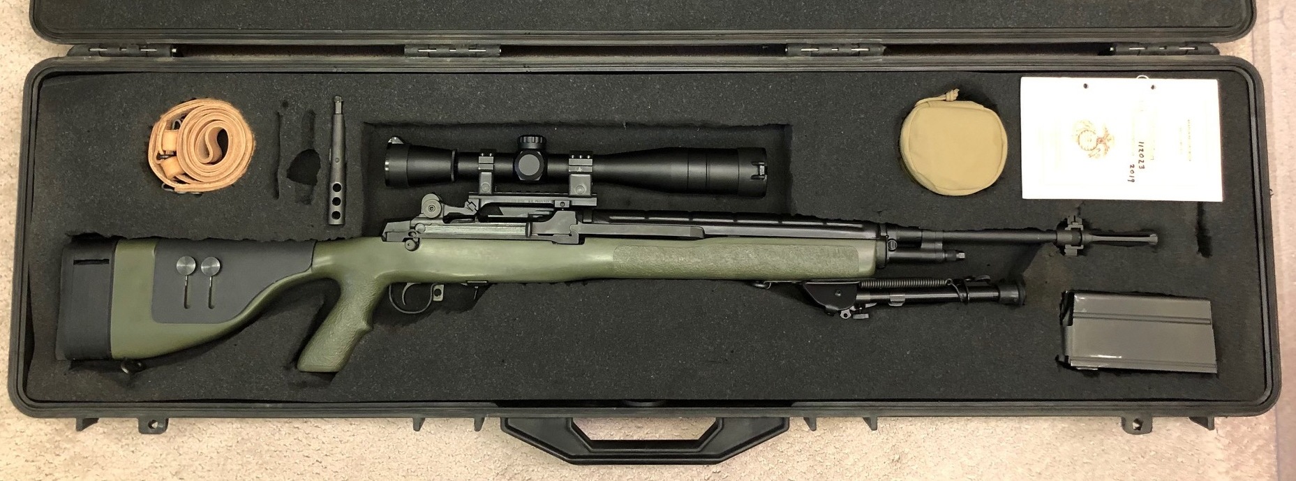

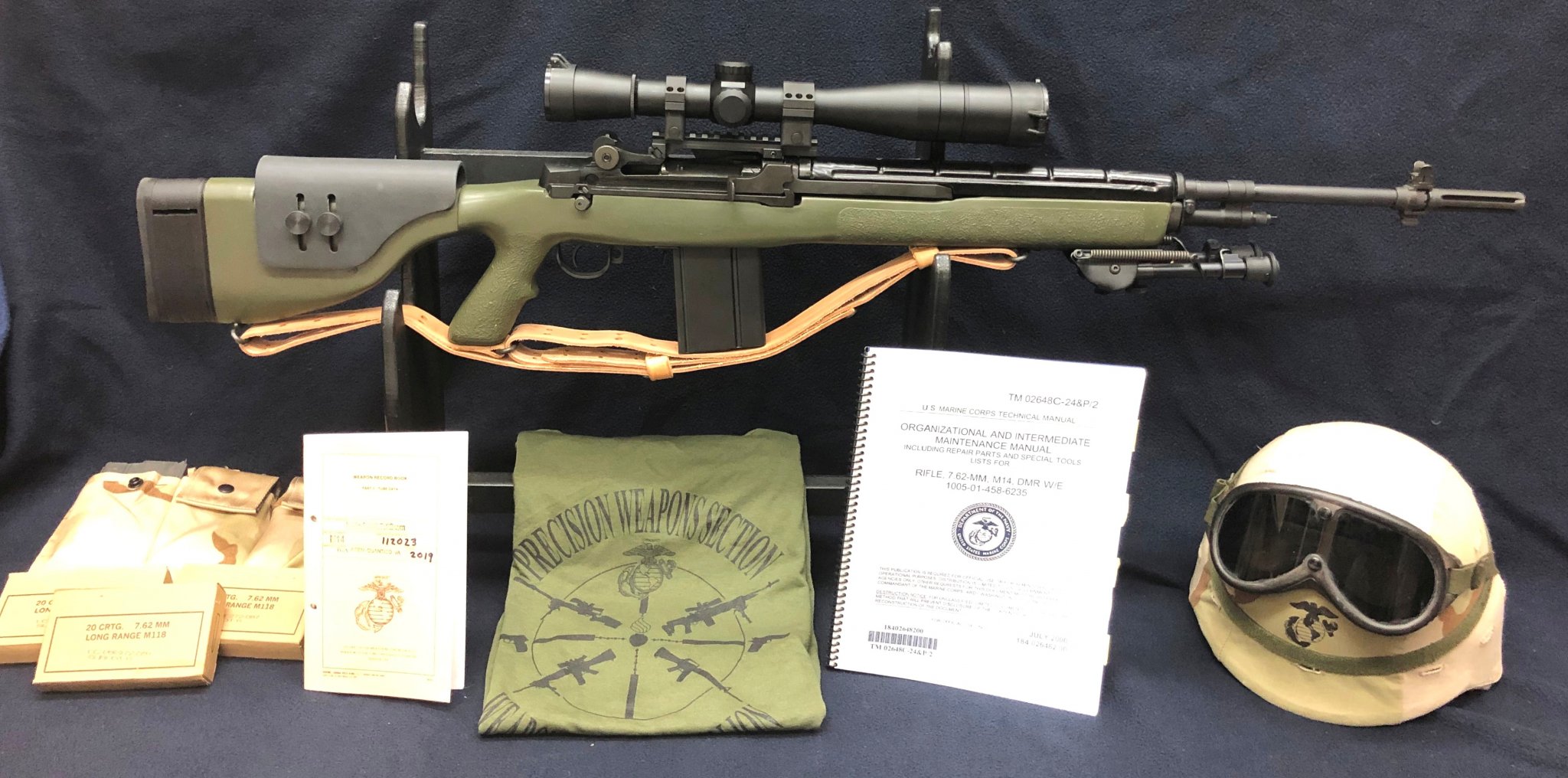

    Since this thread has a few more DMR replicas on it, I'll include some pics of mine (built in 2019). My DMR M14 replica is not as interesting as the black-stocked prototype version on this thread, but I kind-of like it... (It was built as a post-2004 version with the SEI mount and Badger Ordnance rings). I have used it at a Quantico Shooting Club vintage match at 300 and 600 yards, and it shots good enough for me. (It's portly at 17 lbs 5 ozs w/ an empty mag.)

    I hope I did the Instagram links correctly in the previous 2 posts. If I messed them up I'll probably need some assistance from someone here that knows how to link that stuff to this thread.
    This thread is motivation to dust the old girl off and put some rounds down range!
    My clone isn't up to your levels, but I love it...
    DW
    Beautiful rifle, thanks for sharing! Have you done a thread on this build? I'd love to see the details on it! I'm actually doing a green USMC DMR with all original takeoff parts sometime soon! Photos are up in post #13
    It's a Springfield Armory Super Match lugged action, unitized gas system in USMC spec DMR stock. A.R.M.S. M14 scope mount, Leupold Mk IV 10x mildot with Badger Ordnance rings and Simrad cap. It is bedded with dyed OD Green Marine-Tex bedding compound, built by Bill Corley.
    DW
