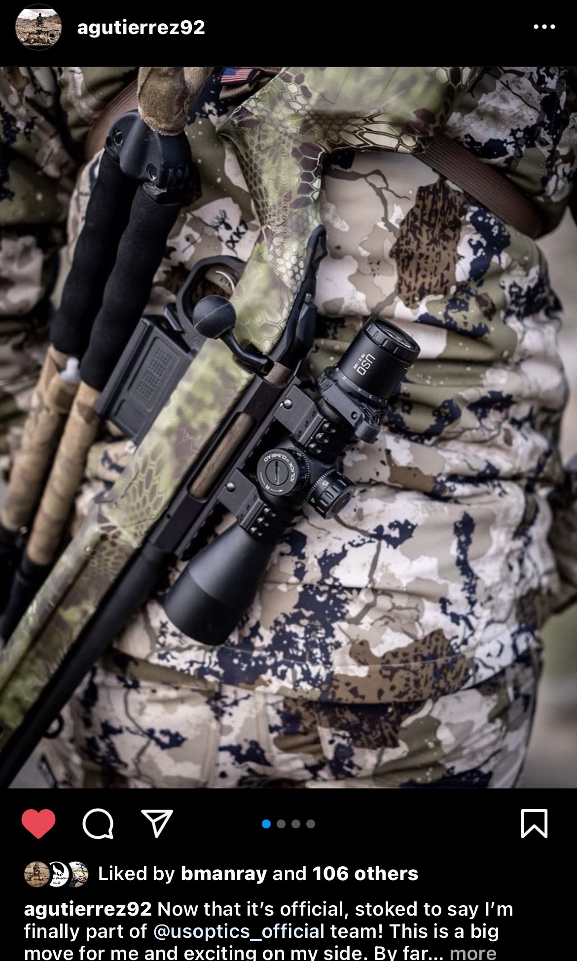

I’ve used one for the last year on one of my coyote rifles. My hunt partner is one of USO’s prostaff and he’s got three TS12s. Between those 4 we’ve had zero issues with them through a TON of predator hunting here in AZ. At that price point they’re really hard to beat and we’ve put a lot of fur on the ground with them. I do recommend picking up a throw lever from MK Machine. There’s not a lot of purchase on the zoom ring.
Pic below for you to see how it sits on his Ruger:

2-3" of eye relief. I think they used the riser to slide it back far enough.

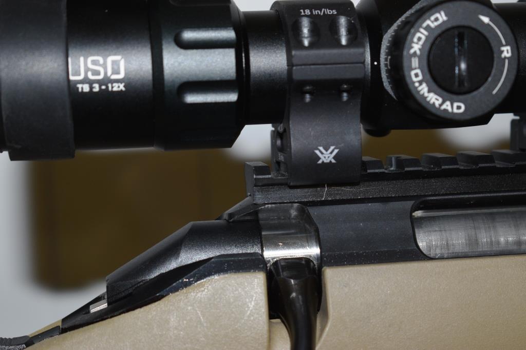

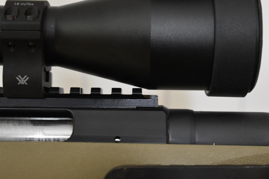

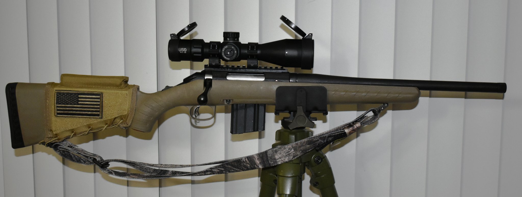

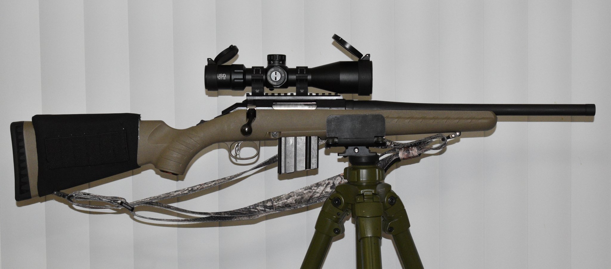

It's on there. I tried a DNZ mount that didn't work due to the zoom ring contacting the mount tab. Ended up turning the base around and the scalloped rear was put in the front allowing me enough room to get it slid back far enough to be comfortable. There is about .080" clearance between the bell and the base... The rings are Vortex Pro mediums.

The angle isn't perfect to show the gap, but it is there. and measures out right around .080"

The front of the base now resides in the back. I might radius the edges a bit, but it works.
This didn't work due to the zoom ring contacting the ear of the base that sticks out to grab the farthest back hole in the receiver.
