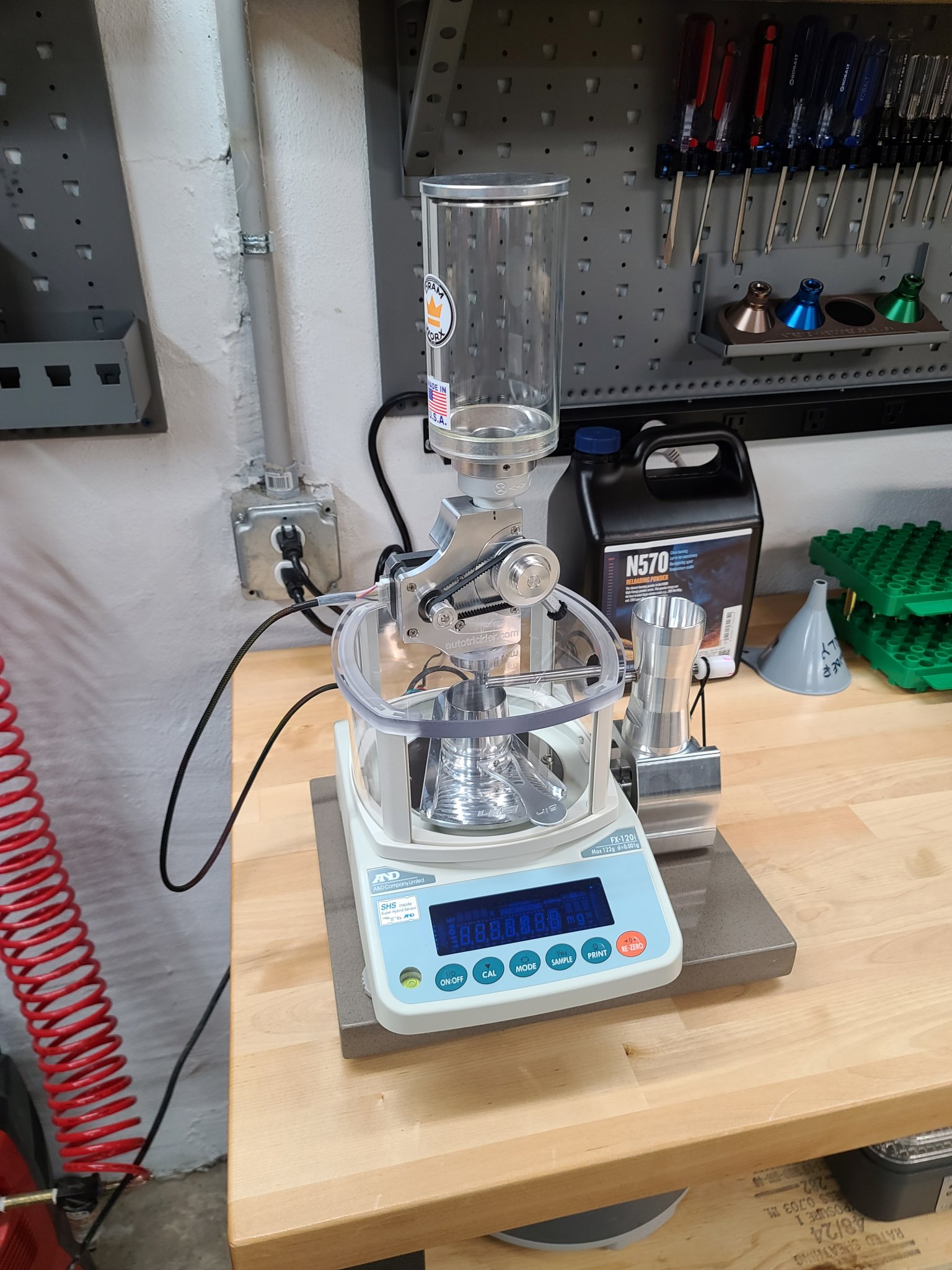

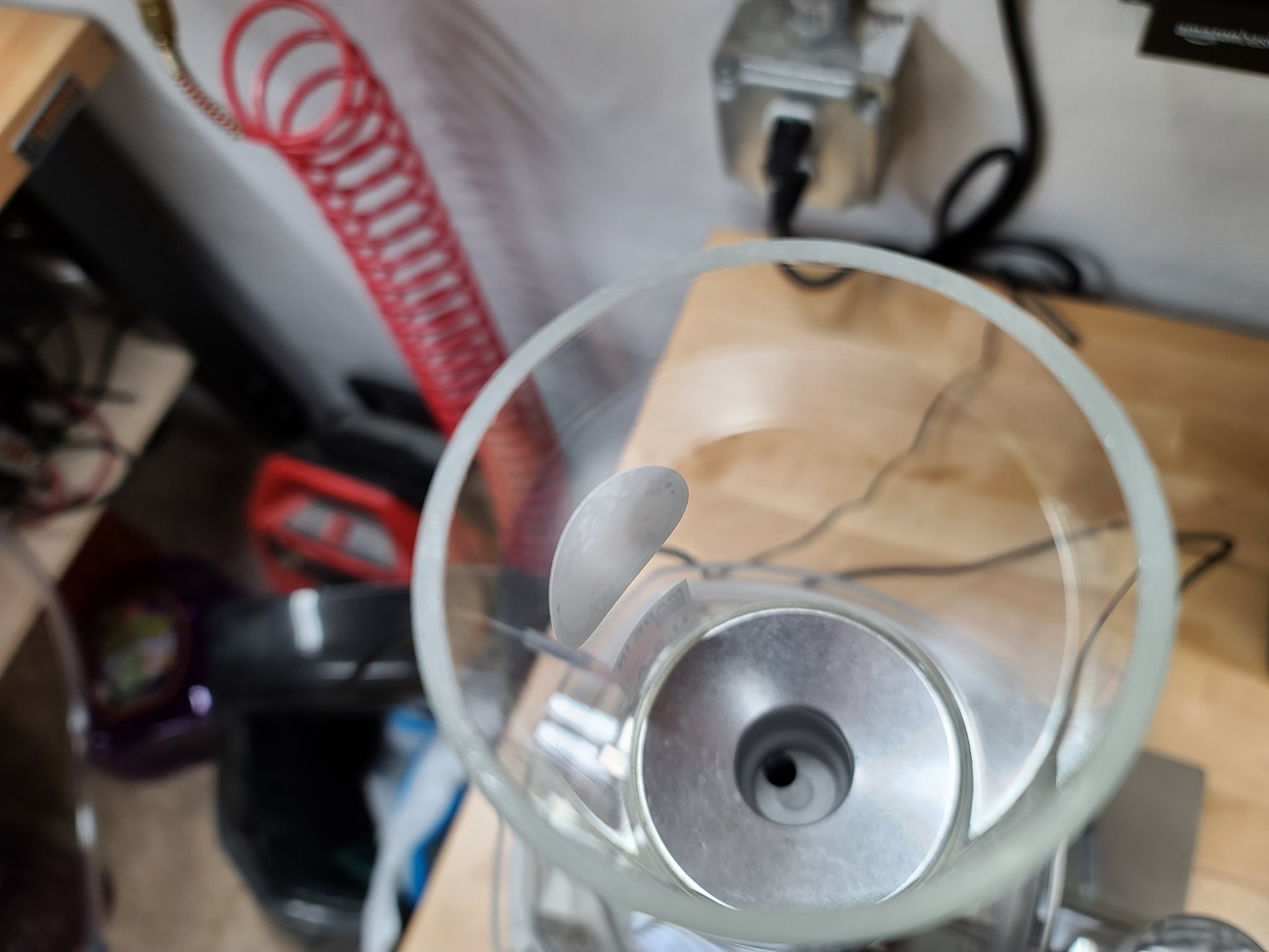

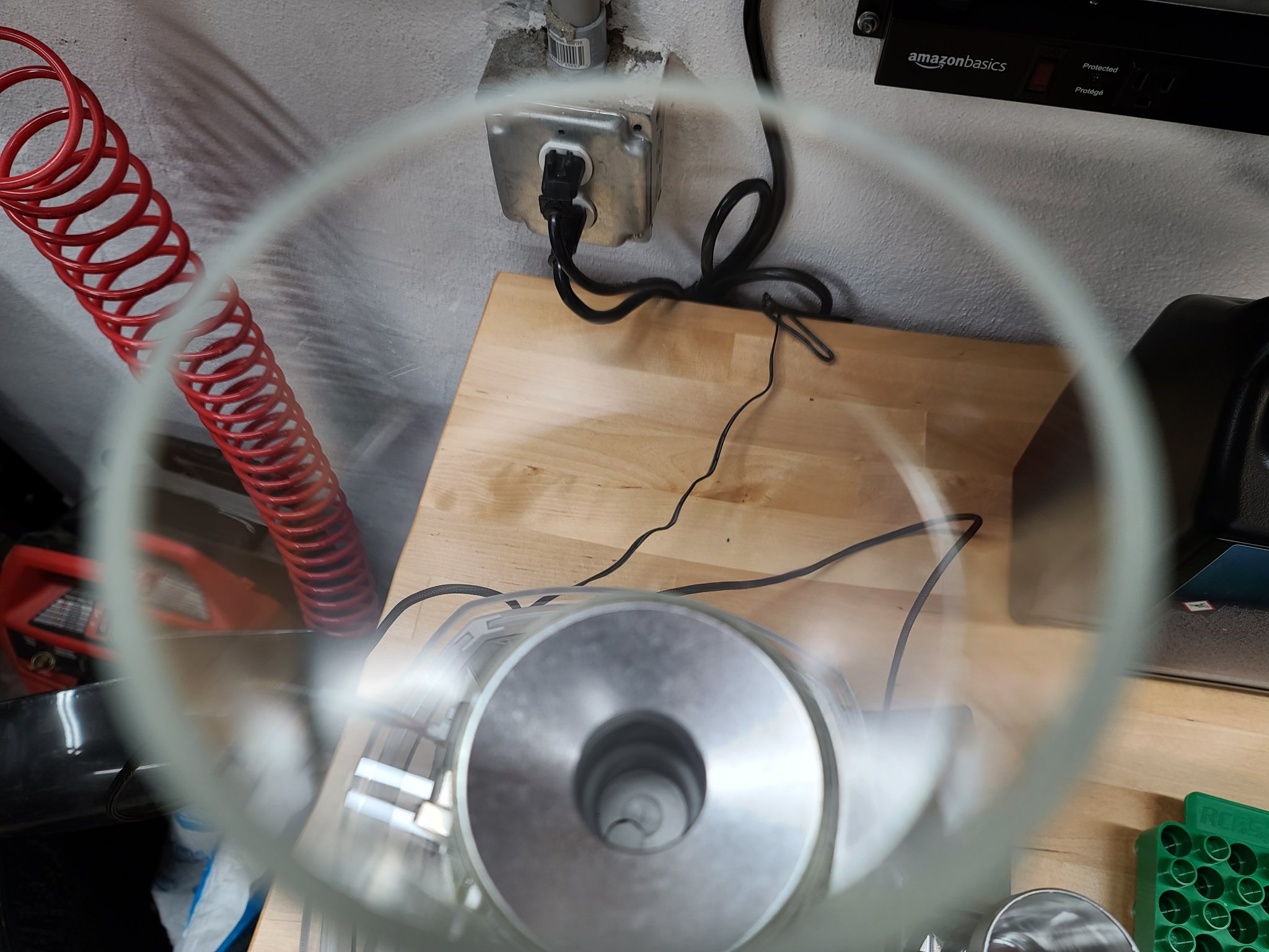

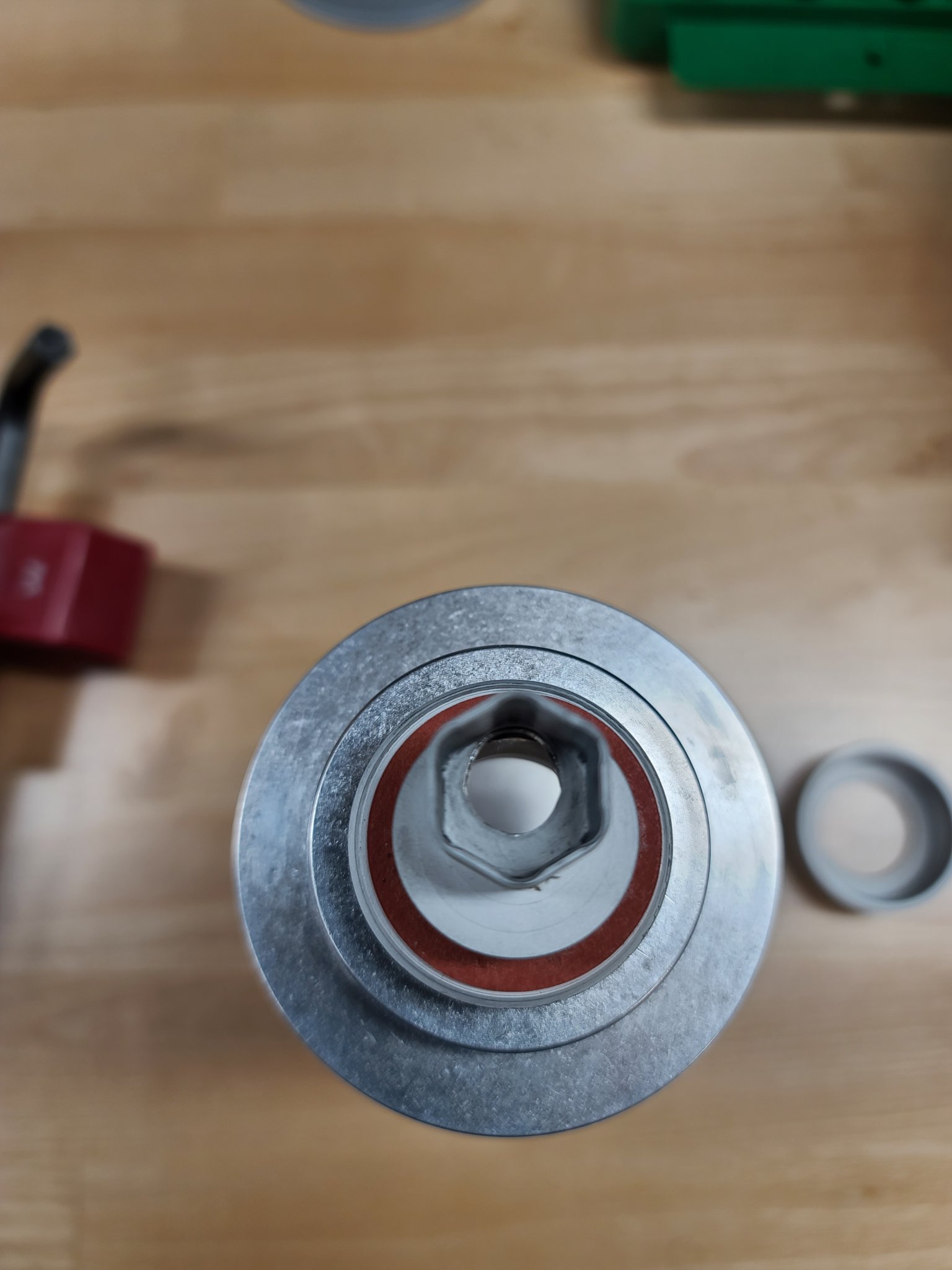

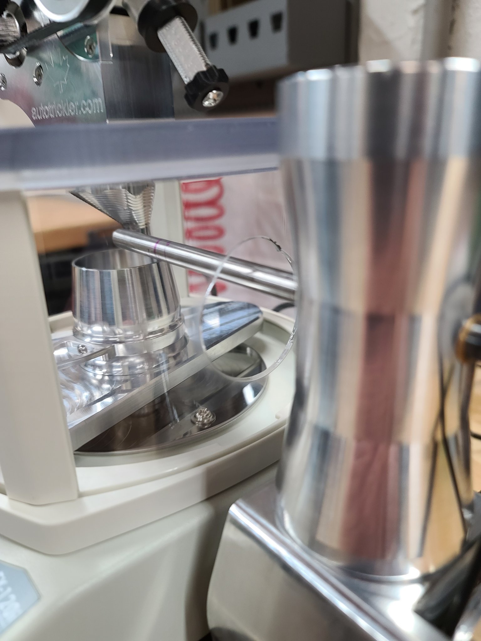

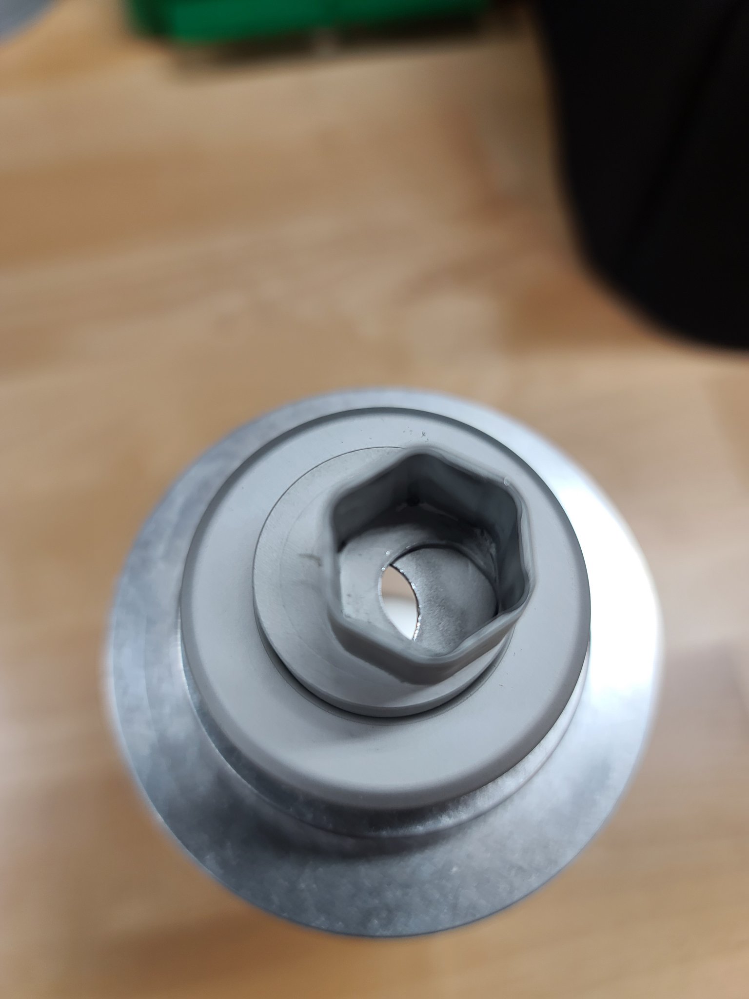

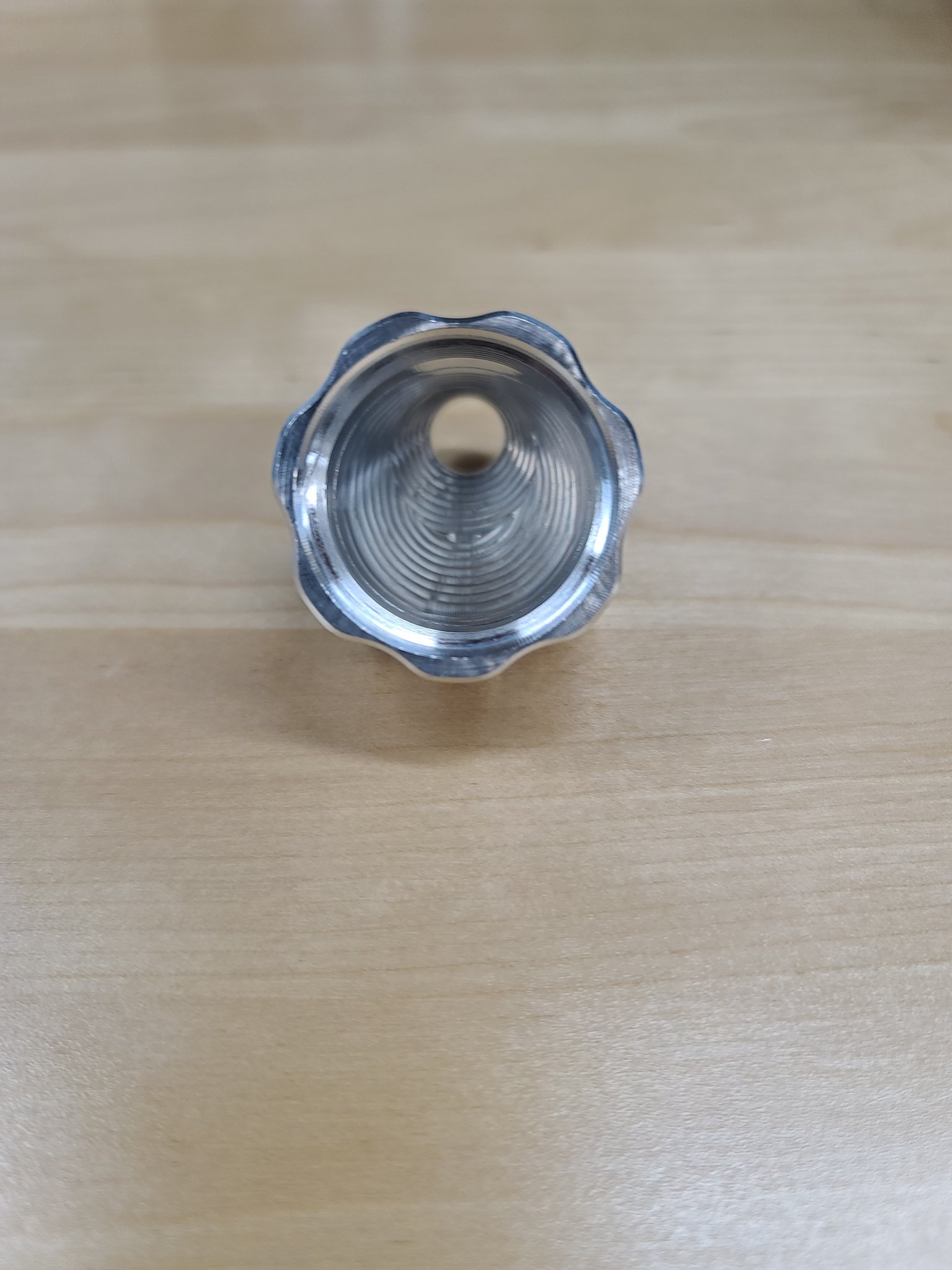

Thanks for the information guys! I was able to break out the Dremel and do a few modifications. Things are working much better now that I've enlarged the valve hole and funnel hole.
Here you go guys! One of the pics shows the side panel where the trickler straw comes into the powder cup. I had to Dremel out a little bit so the straw wouldn't touch the top of the windscreen hole. I've been advised by Area 419 that they've corrected this issue. The rest are pretty much self explanatory. And while the valve, when closed, doesn't completely seal off the hopper it hasn't been a problem with the large kernels that VH N550 has. Since these mods it's been running like a champ! I've suggested to Area 419 that they may want to consider making another valve that can accomodate these larger powders. Haven't heard back yet.
