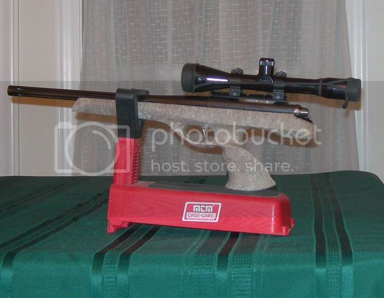

Our custom XP-100 in .221 Fireball has a 1-7 twist. The little gun shoots 80 grain Bergers at 2000FPS and stabilizes them perfectly. I have tried 90 grain SMK’s. The stabilization seemed a bit loose. (Slight key-holing at 100 yards) but five rounds hit the full sized ram at 200meters. Go figure.
Still, 1-7 seems to work well. What is a stretch is trying to push 80 to 90 grain bullets through a 1-7 twist barrel with the charge available in the Fireball case. Still, shot several perfect scores including docking down 65 pound steel ram silhouettes at the prescribed 200 meters.

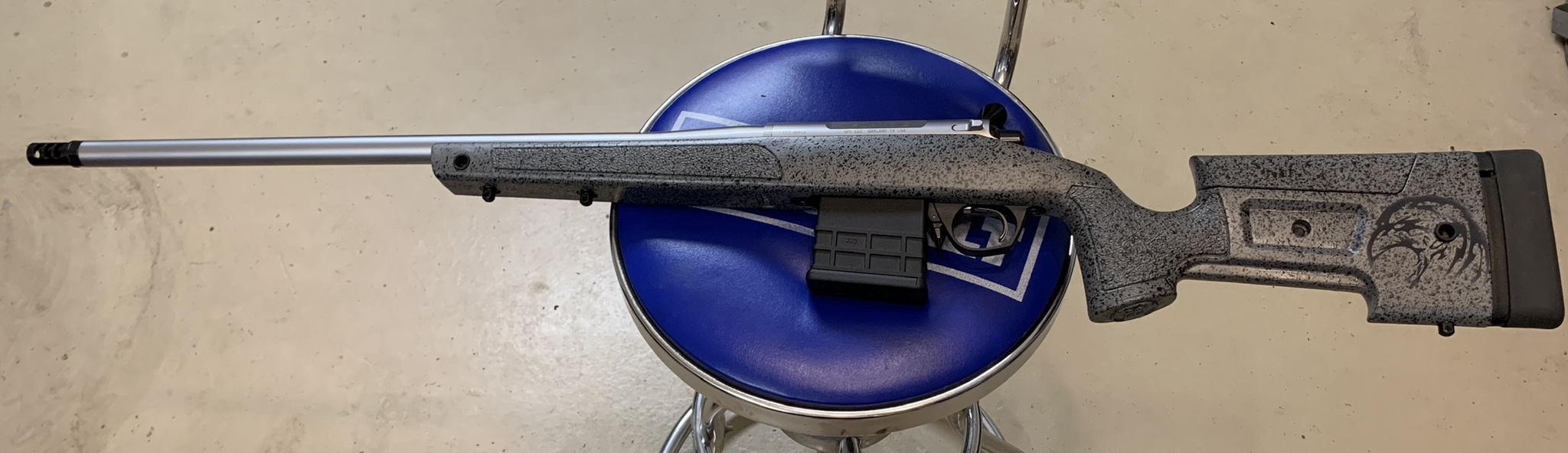

I have a 224 Valkyrie bolt gun on Stiller Action, Bartlein 1:7 twist, Bergara HMR Pro stock. Shoots great factory or hand loads. Im only running 88-90 grain bullets. Shot 95 Berger and had no issues. My daughter warms up at 500 yards and stretches to 750 yards (longest local).
I bought a custom reamer after hearing all the early potential reamer issues. This one seems to do well.
