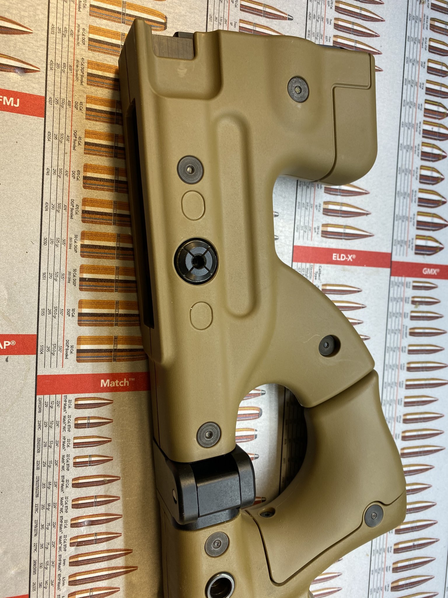

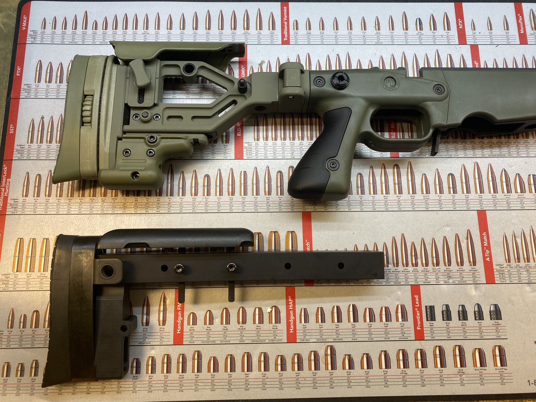

I did some trading and ended up with a sage green AX butt conversion for an AI AT rifle. My original plan was to graft it to a pre 14 AX chassis. I decided to convert a fixed AT AICS instead.
After removing all the skins and putting the chassis in a vice, I removed the two countersunk screws from tail section just behind the main body and heated it with a heat gun. The tail section came off after about 15 minutes of heating and wiggling it off the main body.
I cleaned all the remaining epoxy off the chassis I installed the AX butt to the chassis. Straight bolt on/epoxy with no modifications:
I added some green skins and checked the hinge lock up.
And added the barreled action and checked function.

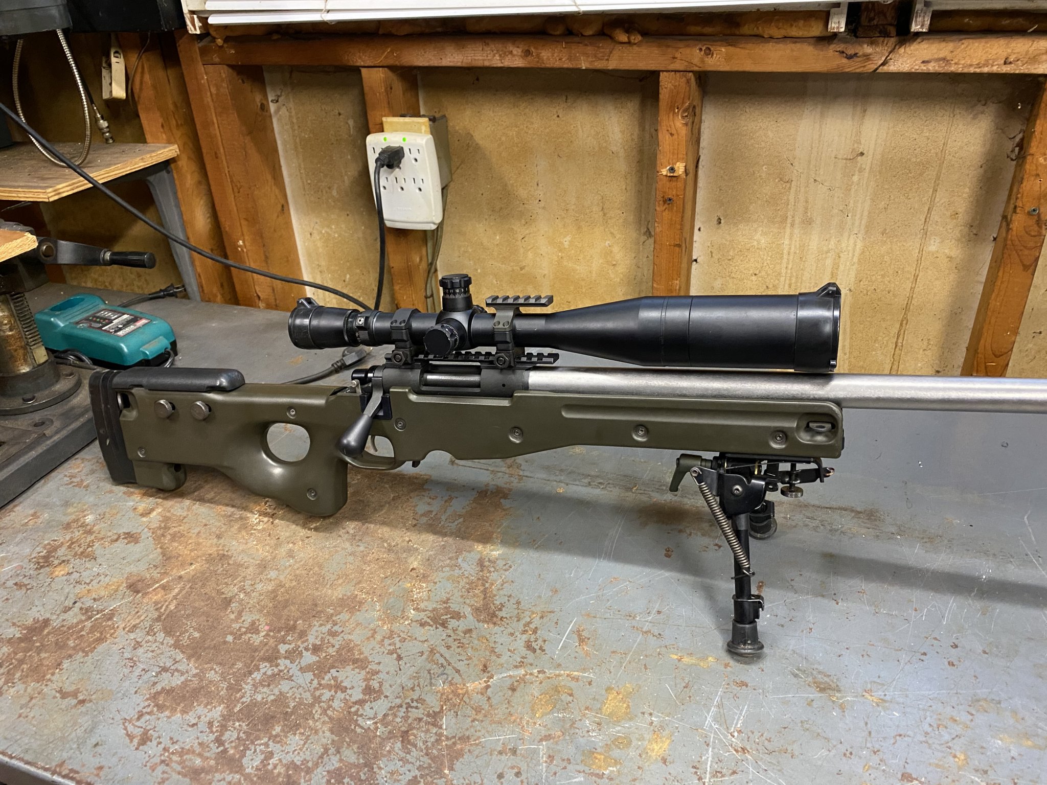

I’ve had this .308 since 2003. It’s on it’s third barrel and scope. And now it’s second chassis. I bang steel with this thing at least twice a month at my local 1K yard range. I’ll get out there Sunday and do some final adjustments.

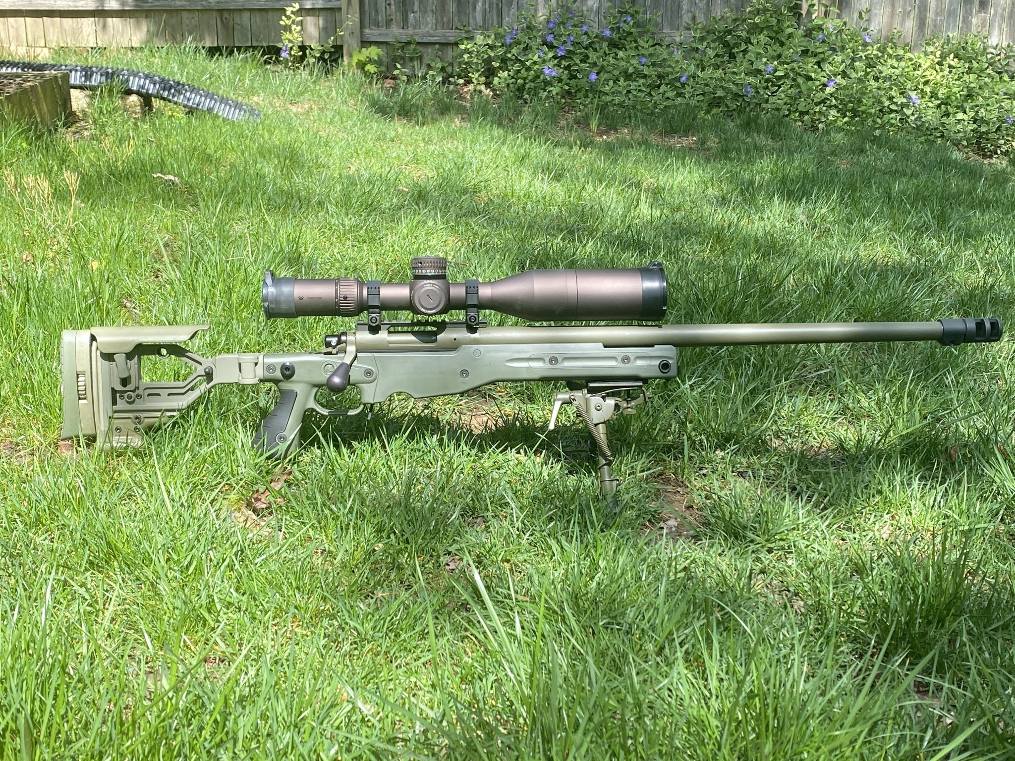

Ive had an AICS AX before and have been running an AICS AT for a few years on my Mark 13 mod 5 (ish) build.
View attachment 7604152View attachment 7604153

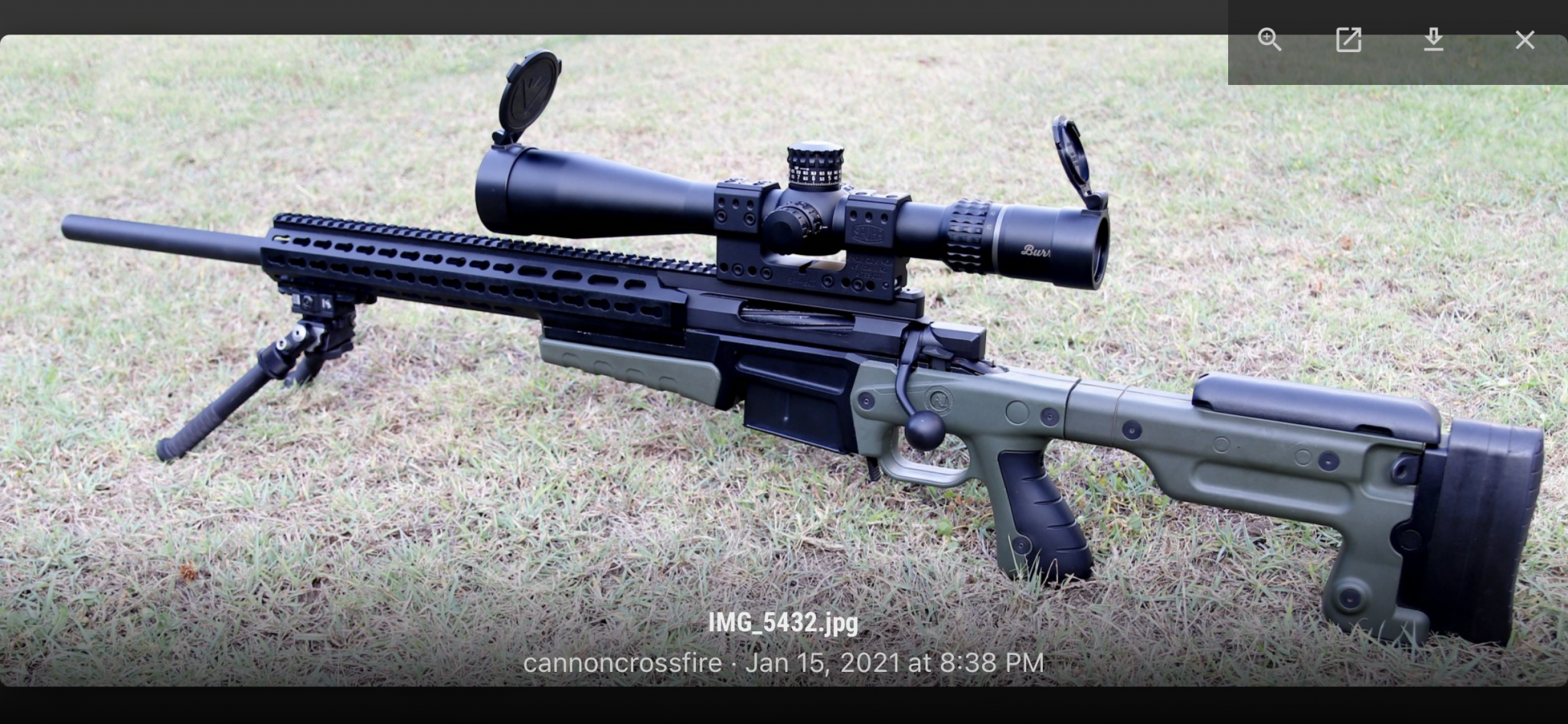

Very nice work! Until just now, I had no idea it existed and had never seen an AX with a fixed butt like yours, let alone one with a mutant LH Tikka action in it. Too cool.

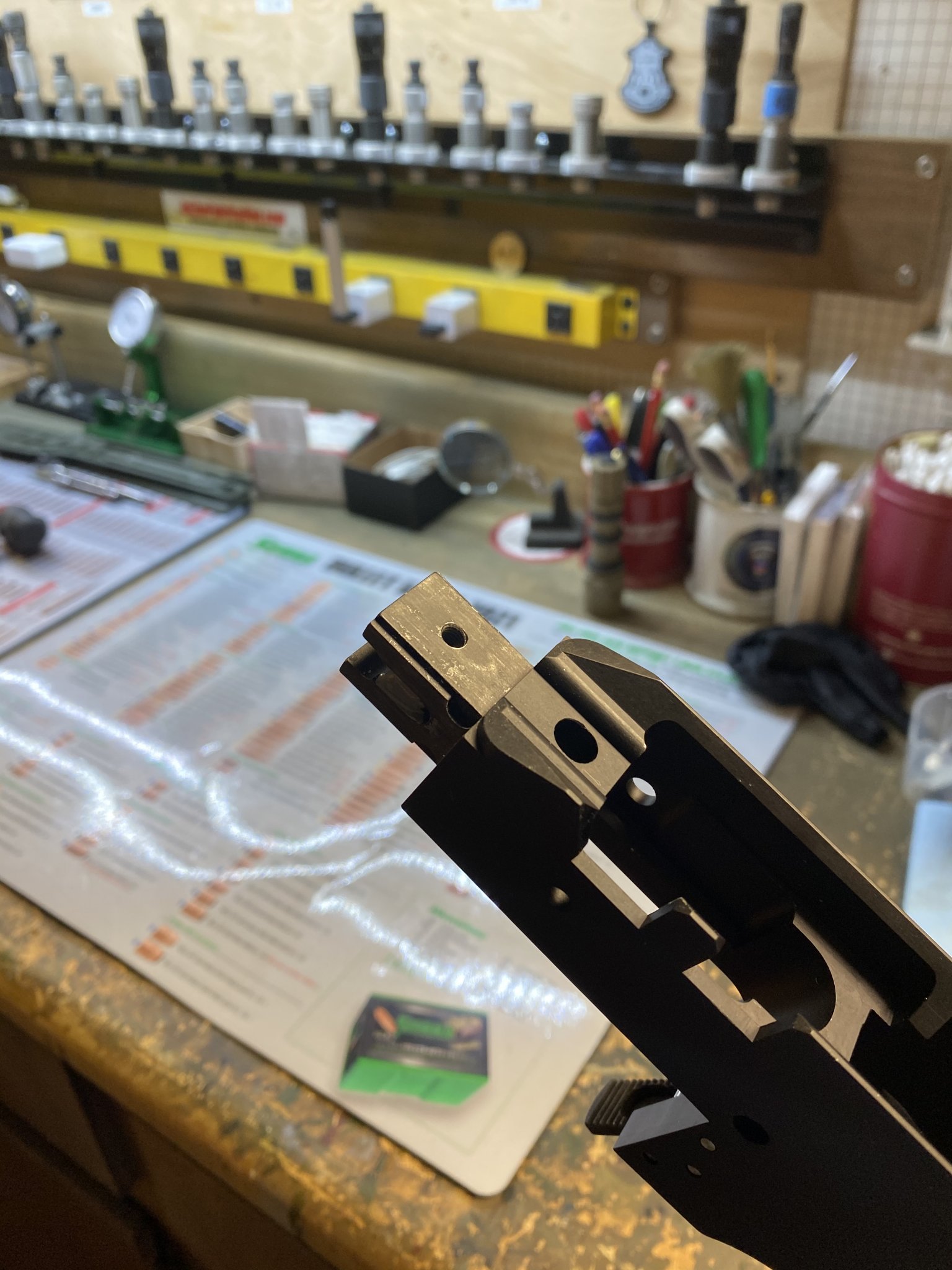

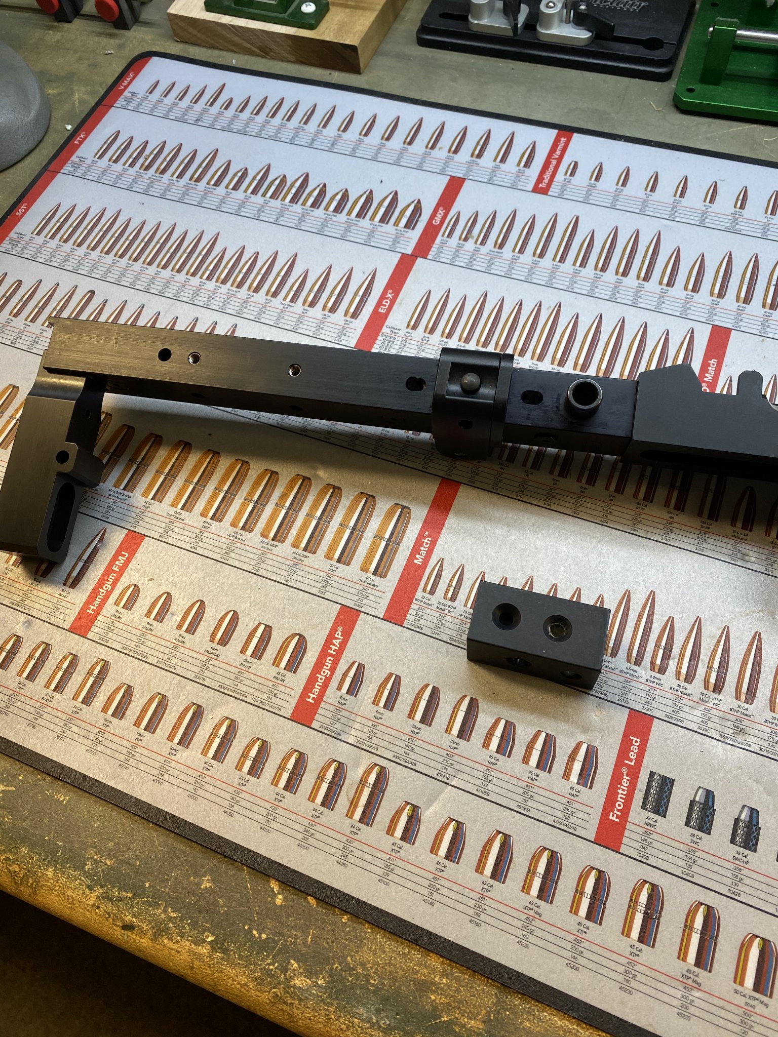

If your fixed AX chassis is like every other fixed AT chassis I’ve seen, I’ll bet your butt skeleton is attached to the main body by two counter sunk screws and epoxy.

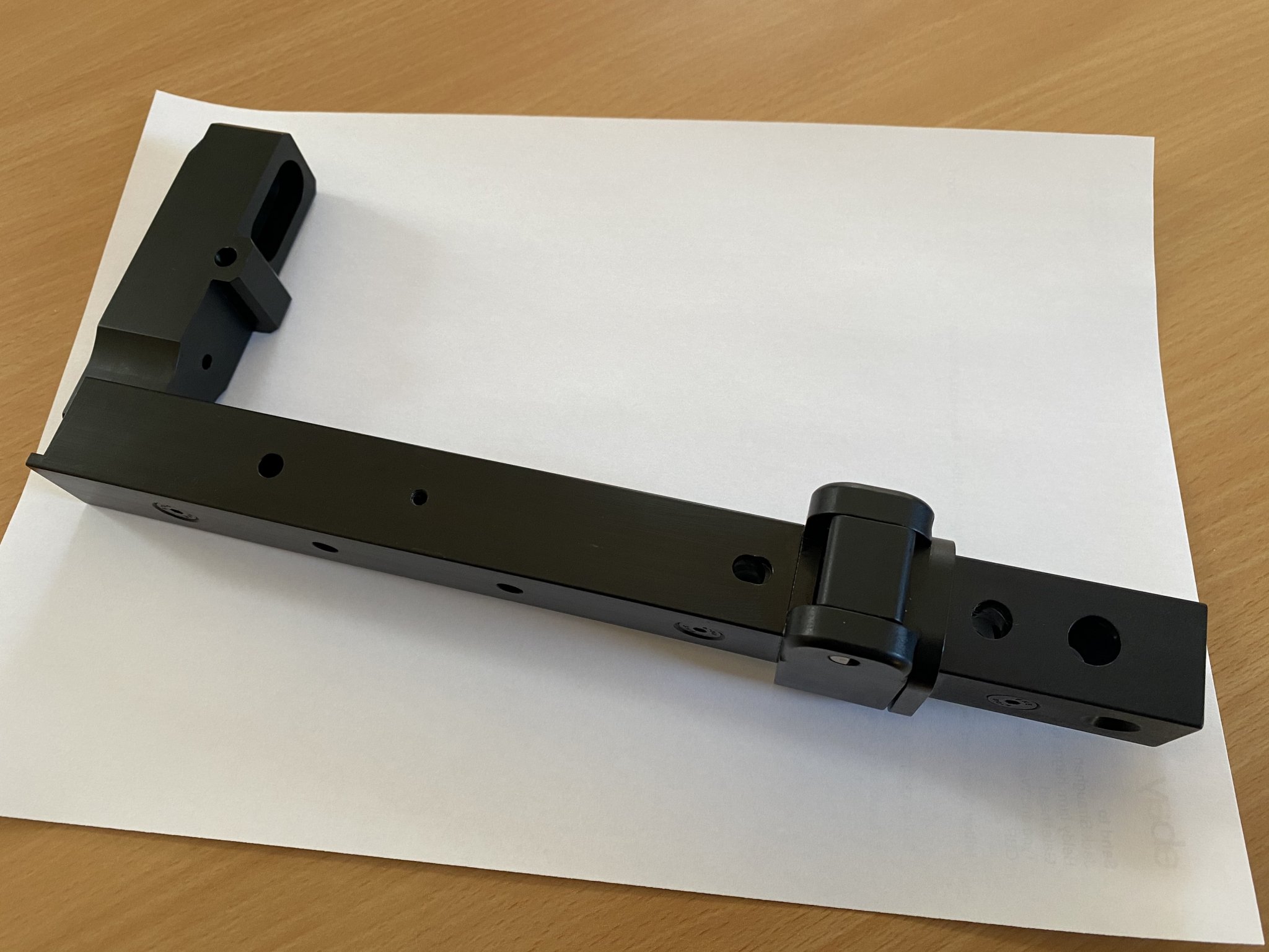

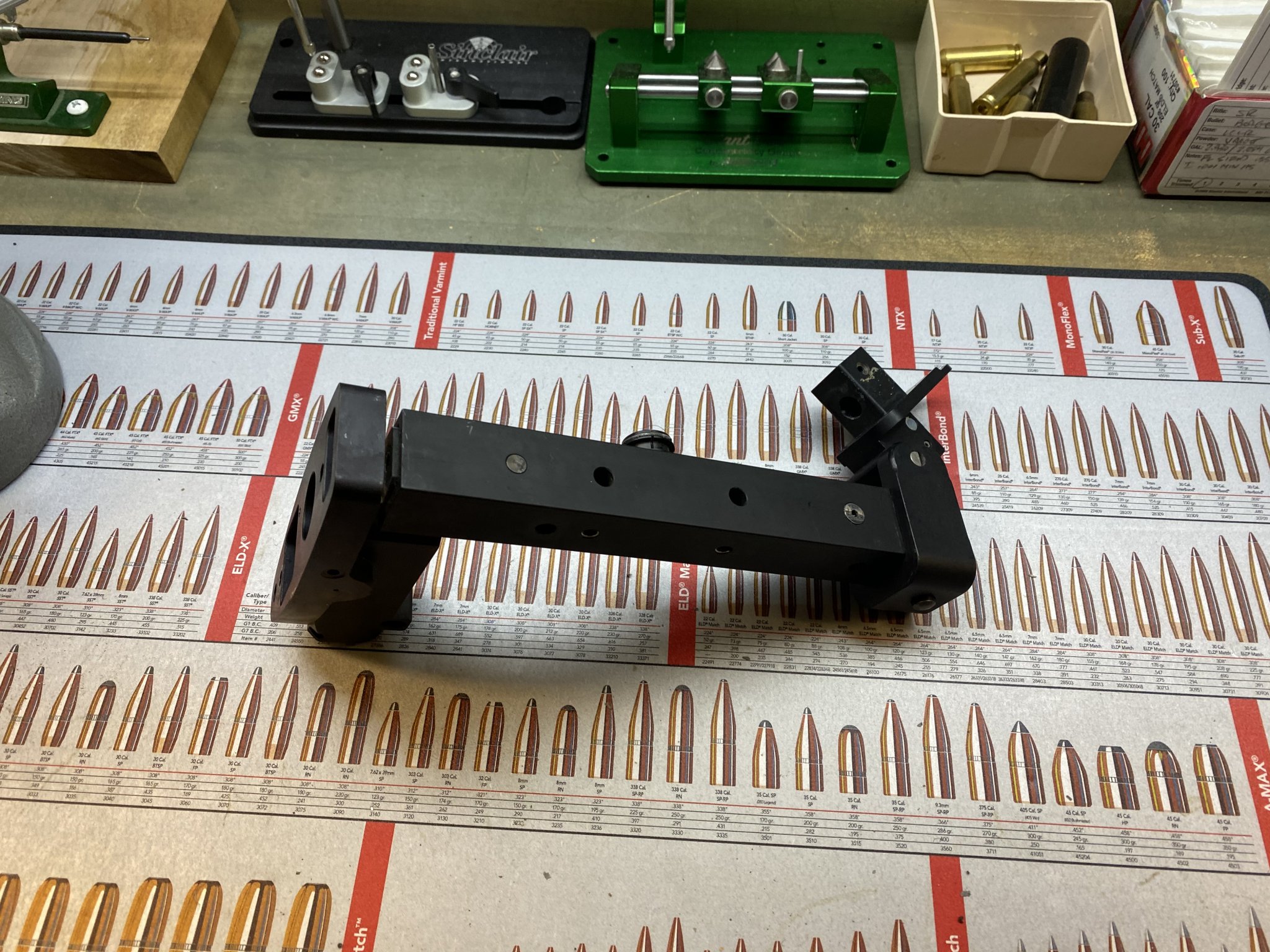

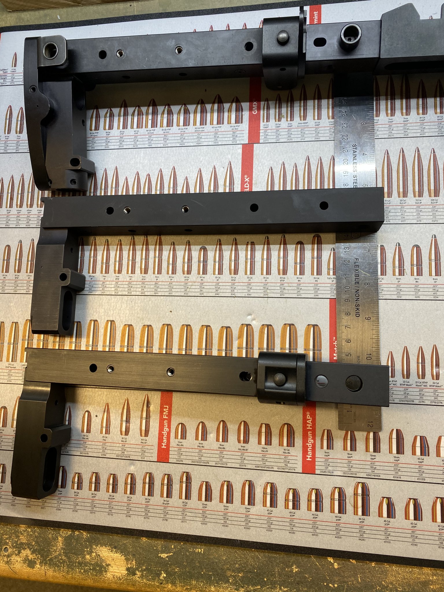

The AX I’ll be working on has a folding butt. The butt skeleton looks like this:
Pull your rear skins off. I just know you’ve got a 2.5mm allen bit someplace...

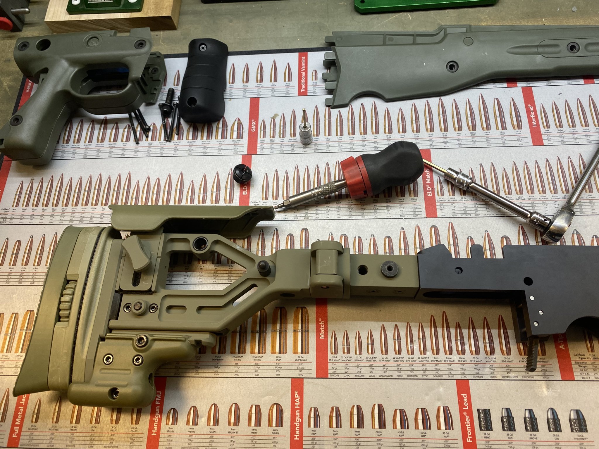

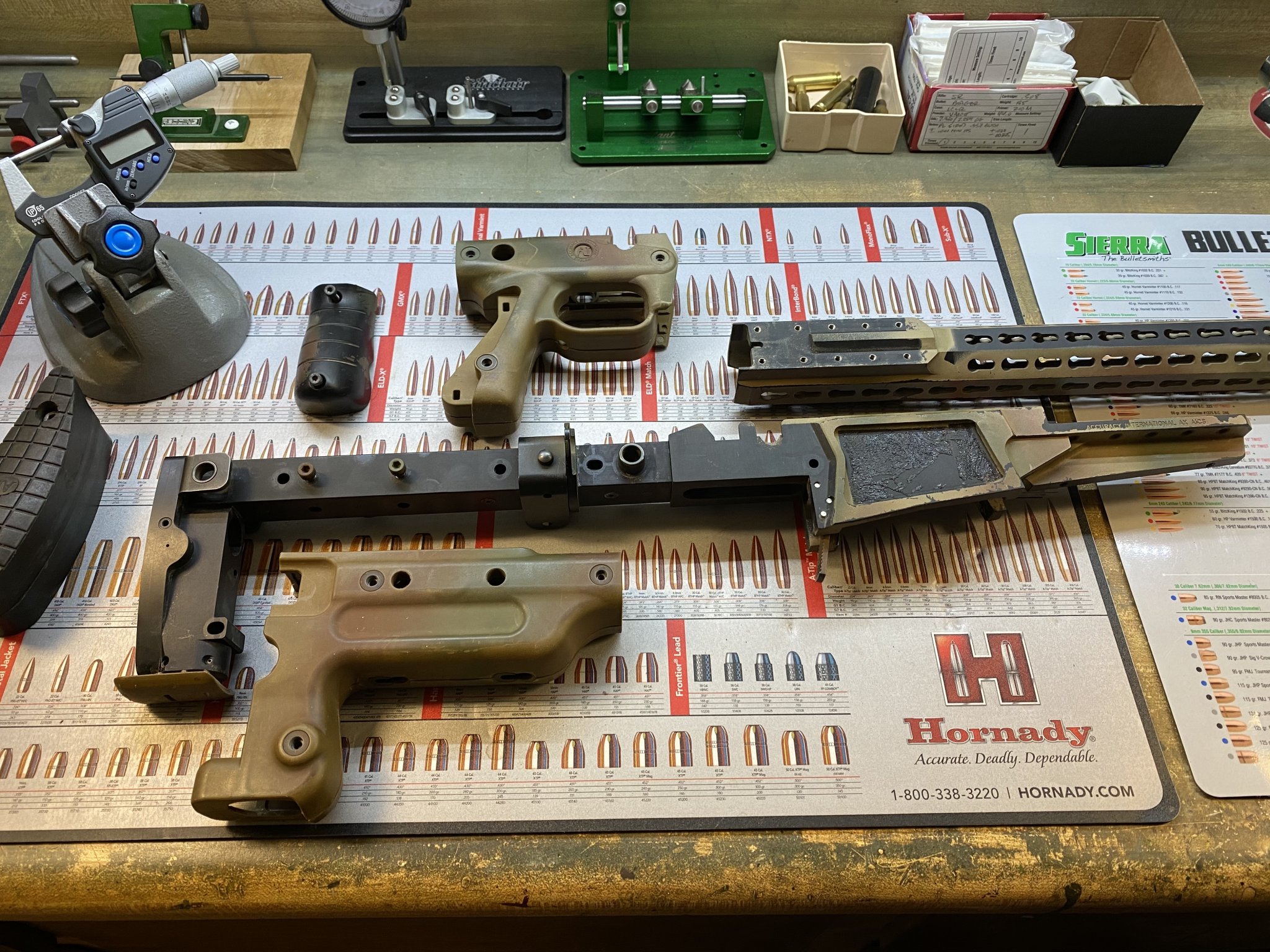

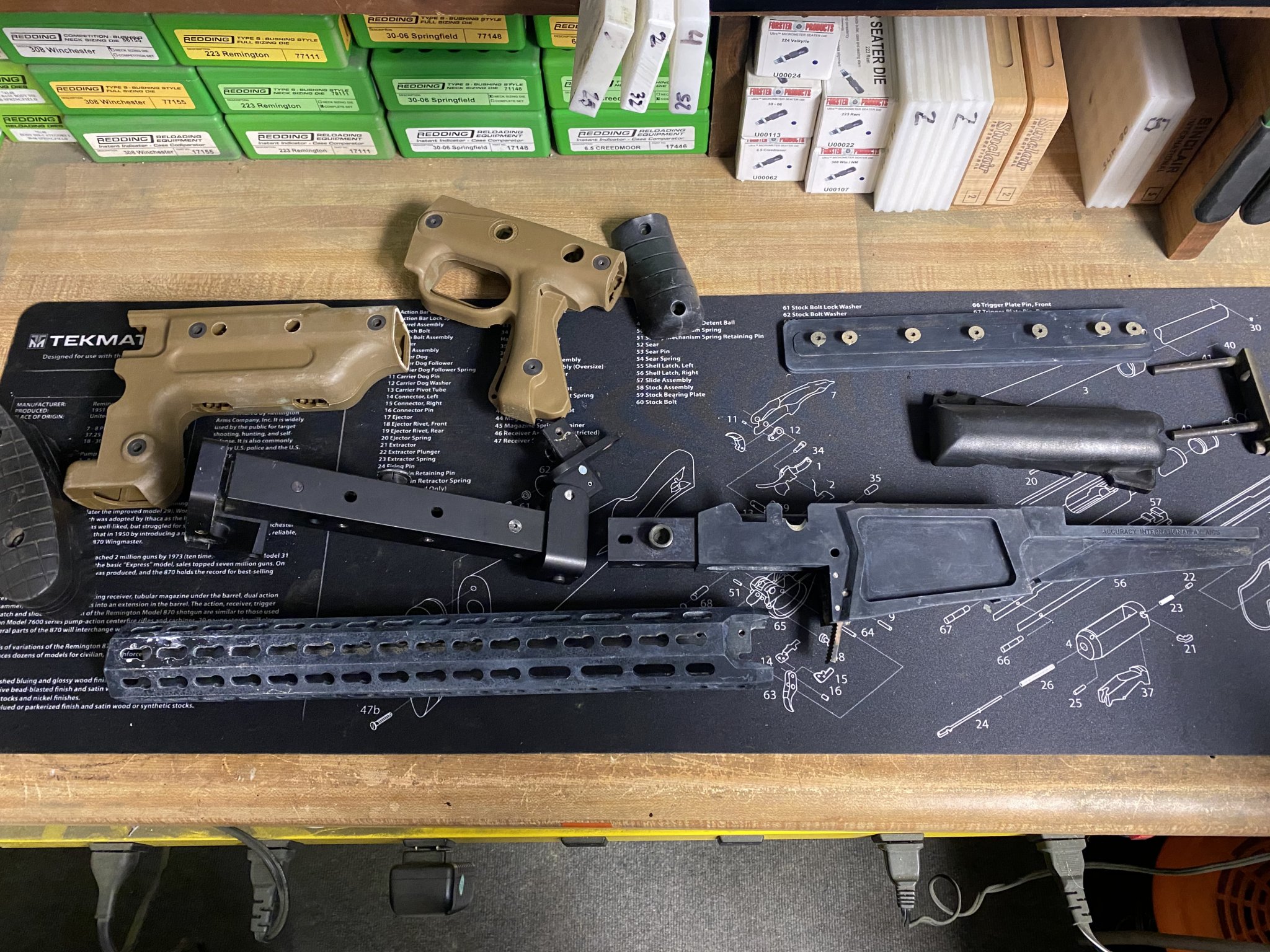

So I bought this really beat up pre 2014 AX AICS from an 0321.
It had been rattle canned a bunch, so I disassembled it and spent about an hour with a fingernail brush and a can of Easy-Off oven cleaner:
The fore end tube had seen better days so I ended up painting it with Alumahyde and hanging it and baking it in the cab of my truck for about six hours on an 85F day to harden the paint.

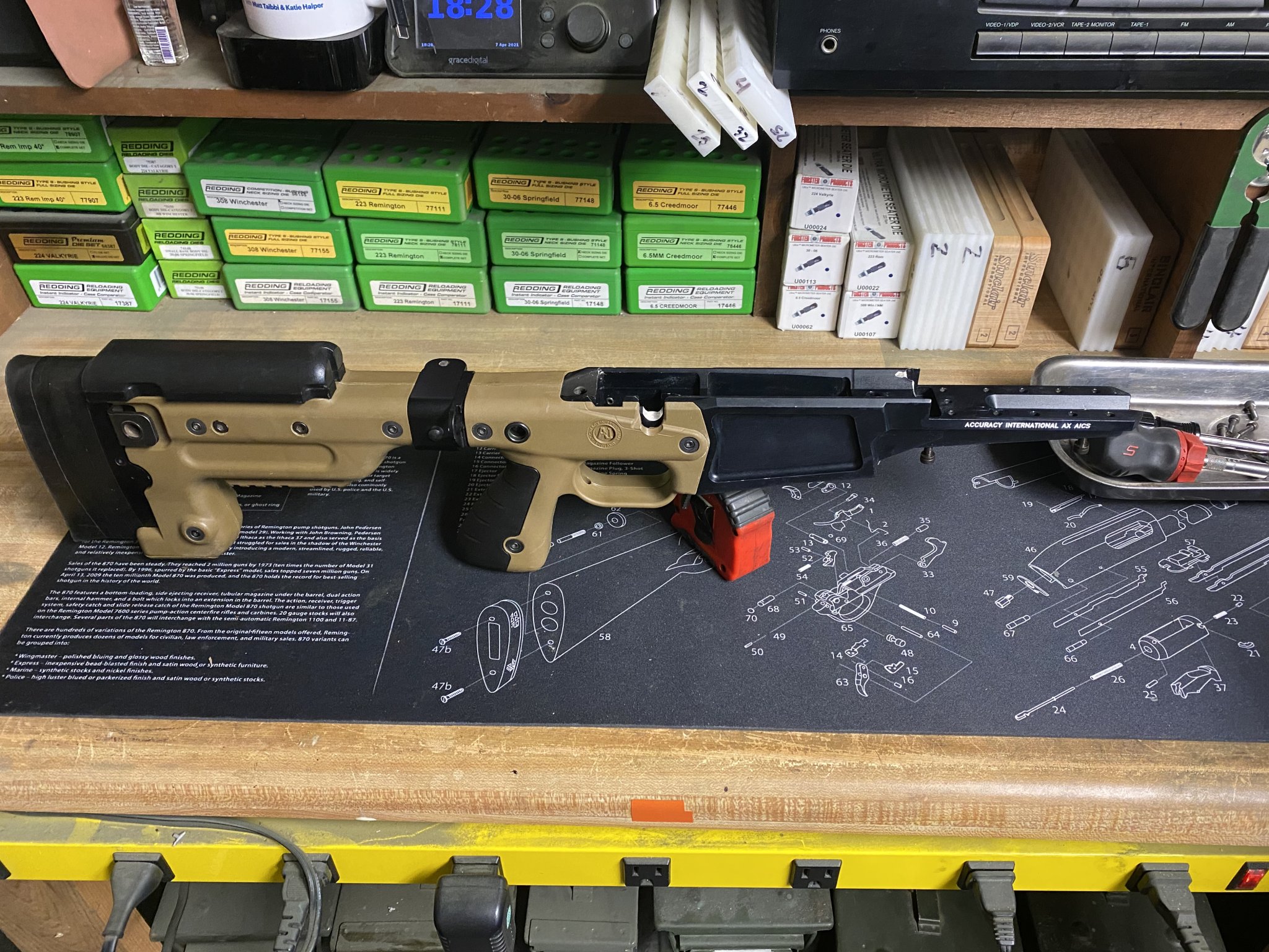

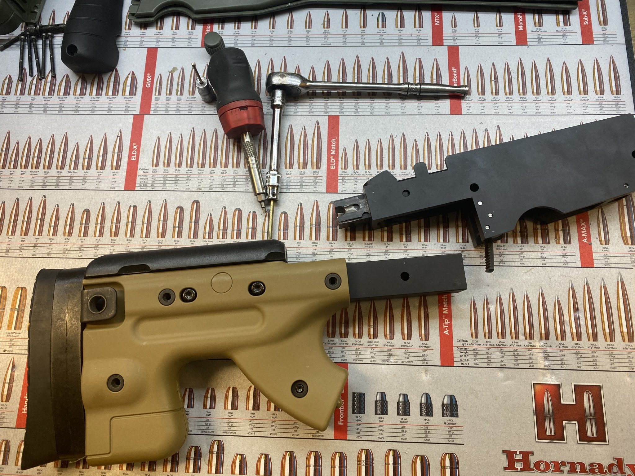

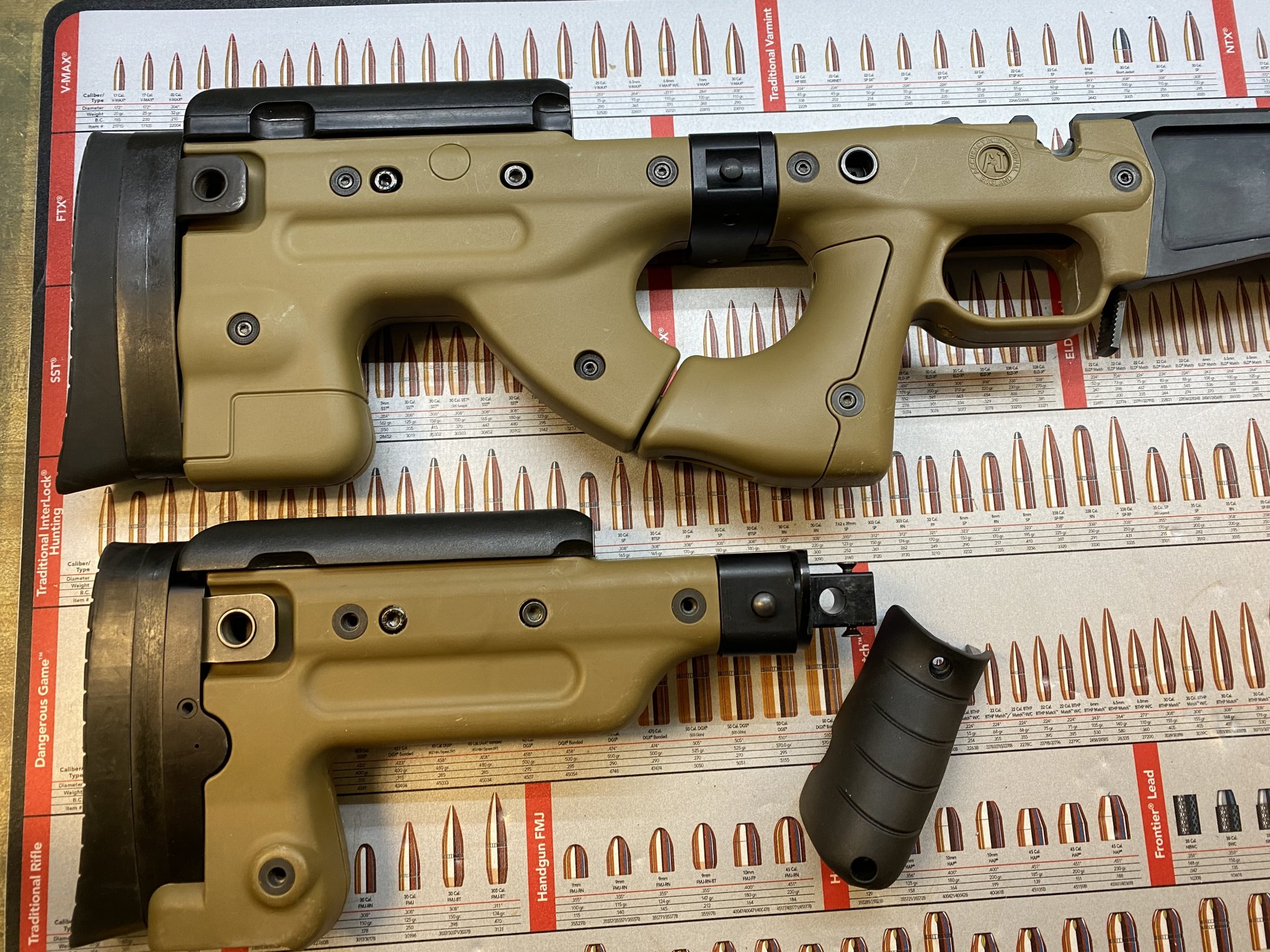

I had some FDE AT AICS thumb hole skins and got an AT AICS folding skeleton to convert this AX to a thumb hole butt stock.
Top: pre 14 AX AICS folding butt
Middle: AT AICS fixed butt
Bottom AT AICS folding butt

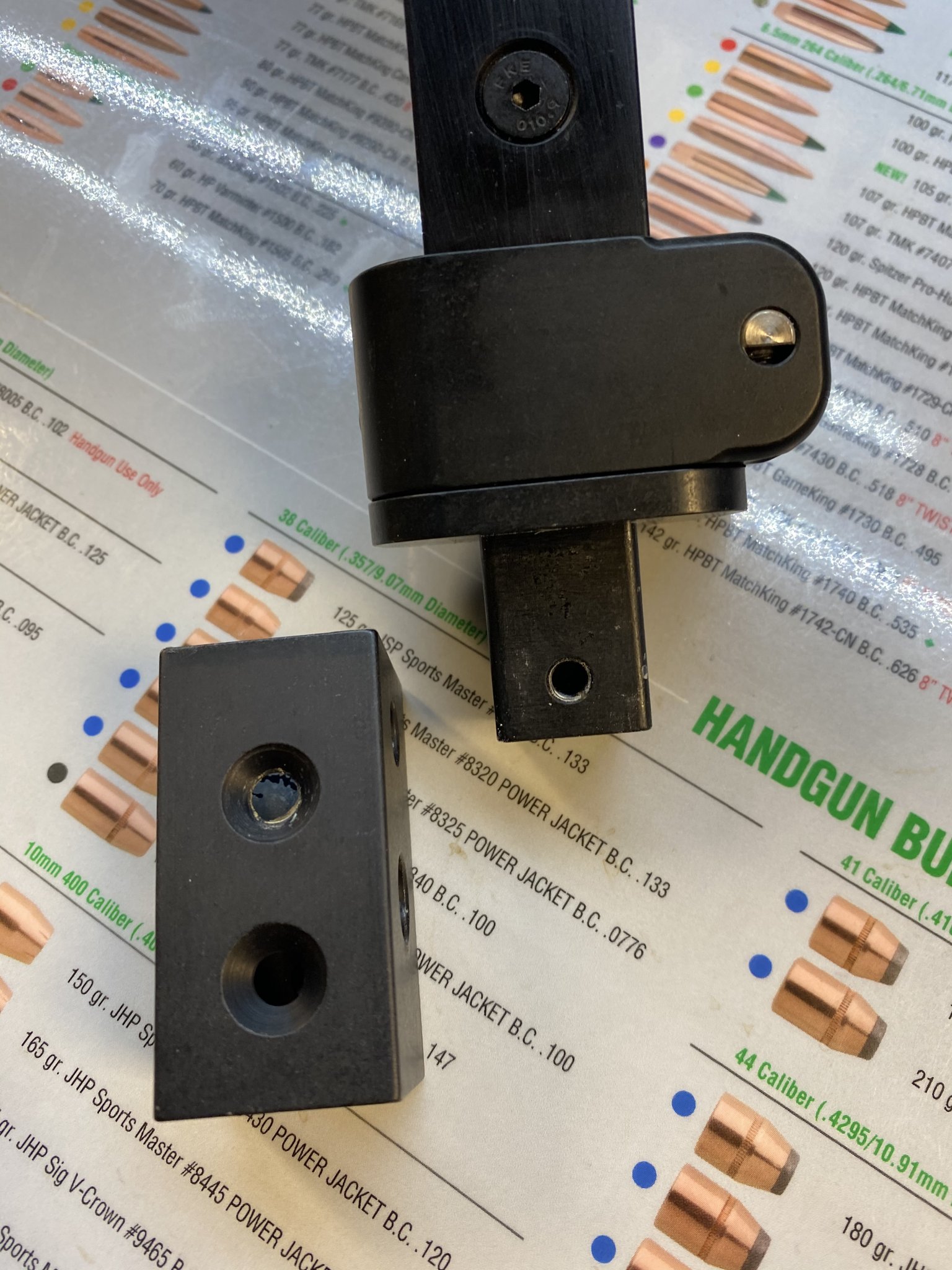

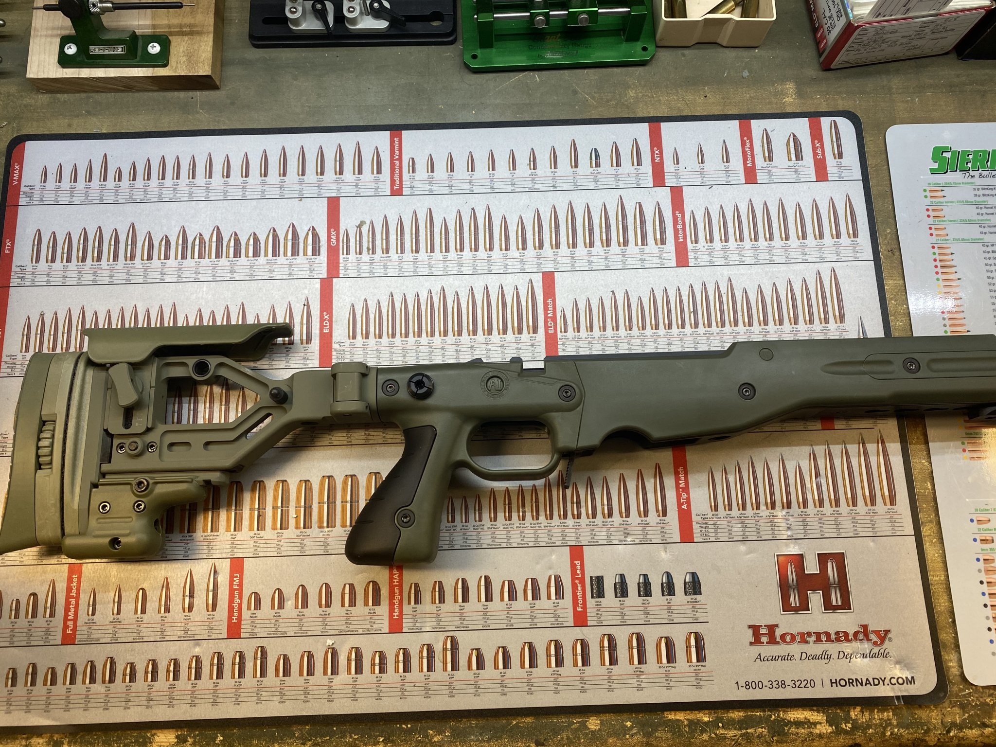

I used a heat gun to break the epoxy to remove the AT AICS folding butt extension in front of the hinge.
And bolted the AT folder to the main body of the AX AICS and screwed it together.

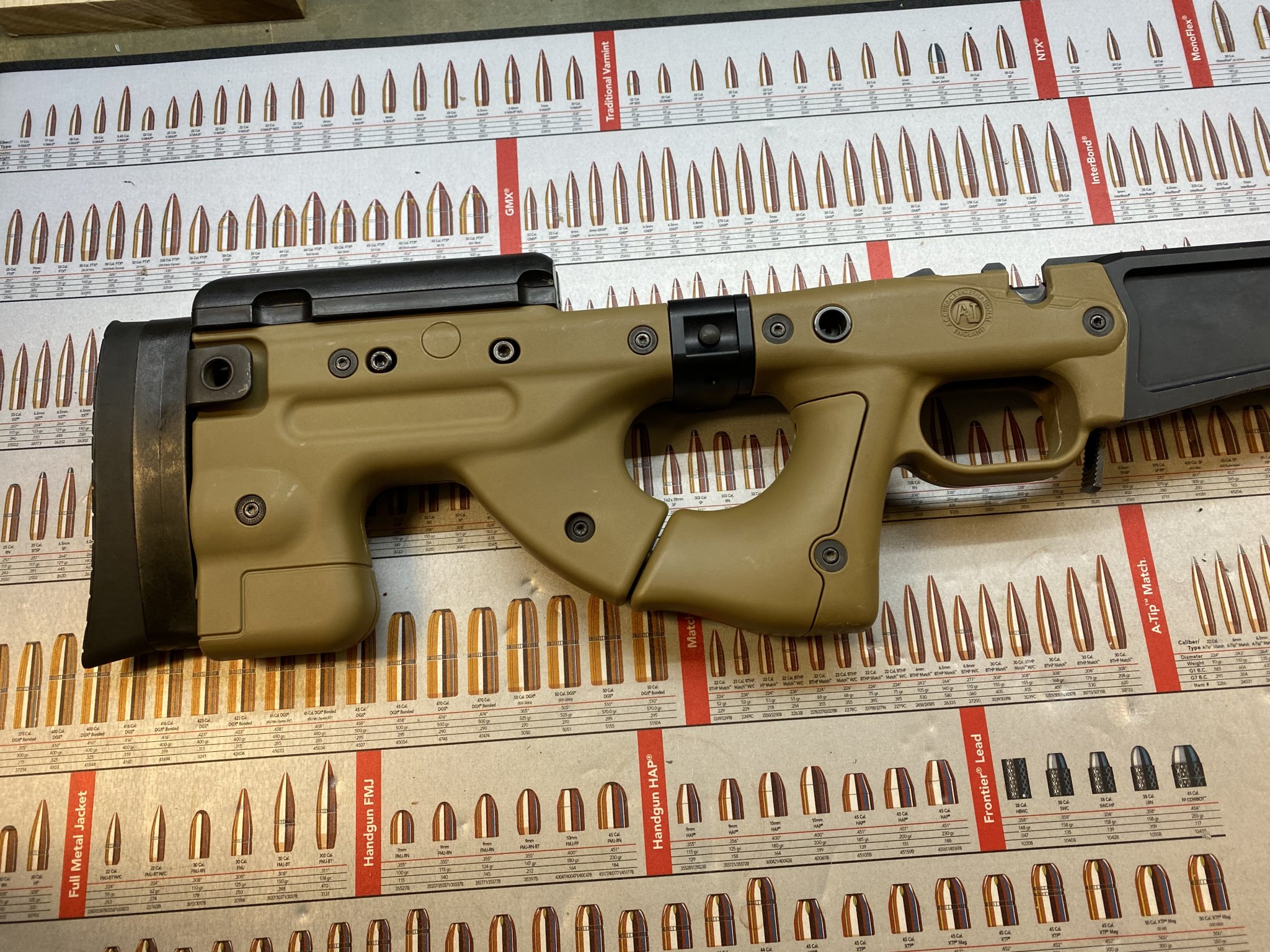

Added the pistol grip skins and thumb hole skins with the female lock mechanism from the AX butt.
Installed the cheek piece and butt pad from the AX butt. Added fore end tube and cap.
I’ll probably put my 223 AI action in this later. It’s currently in an AICS 1.5.
