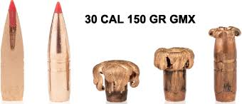

"Expansion" usually means anything beyond the original diameter of the bullet. It may expand reliably beyond 1460 fps, but that expansion may be inconsequential. Here is a GMX example to show what I mean. There is a huge difference between the expanded bullet on the left which is fully expanded and the bullet on the right that is expanded, but pitifully so. It will reliably do that at lower velocities, but is that really accomplishing the intended goal?

What your failing to take into consideration is that all 3 bullets in your illustration ARE "fully expanded"...for the given IMPACT VELOCITY which you conveniently omitted.
Look at page 42 in the Hornady 10th edition load manual, you know, the one you likely lifted the above images from, and you'll see that the "fully expanded" bullet on the left is representative of an impact velocity of 3400 fps.
The "pitifully" expanded bullet on the right(which exceeds your above definition of expansion BTW) is representative of an impact velocity of 2000 fps and is in all probability the lowest impact velocity in which this particular bullet will give reliable and consistent expansion on game animals.
So, given a low end impact of 1460 fps, a 125, 150 or 165gr BT launched from a .300 BLK at 2000- 2100fps would still give reliable expansion out to around 300 yds or a tad farther.
Even a 180gr, assuming it could be started out at 1800fps, would still expand out to around 200 yds.

I didn't omit anything I didn't intend to say. However, I am not going to apologize for a lack of expansion due to reduced velocity. Yeah, the bullets may be fully expanded for their relative impact velocities, but pitiful and or pathetic amounts of expansion don't help with creating tissue damage.
