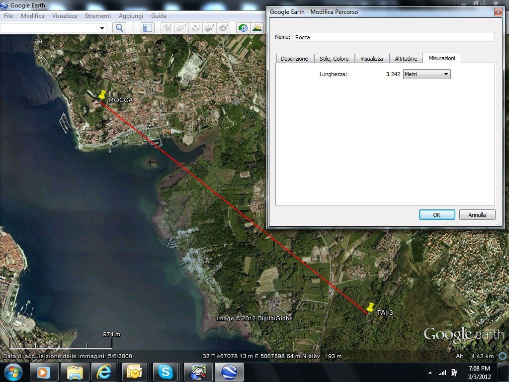

One thing... the terrapin is able to laser without any problem till 3500/4000 m ( 4000 m by hands no tripod )
I've a PLRF 10 C, I laser with no problem to 2400/2500...some times further, the terrapin has about 1000 m more capability.
here I try to laser at sunset, PLRF unable to read Terrapin reads every time without any issue.
I prefer PLRF 10C because you connect it to a Nomad and FFS...as Cory said.
