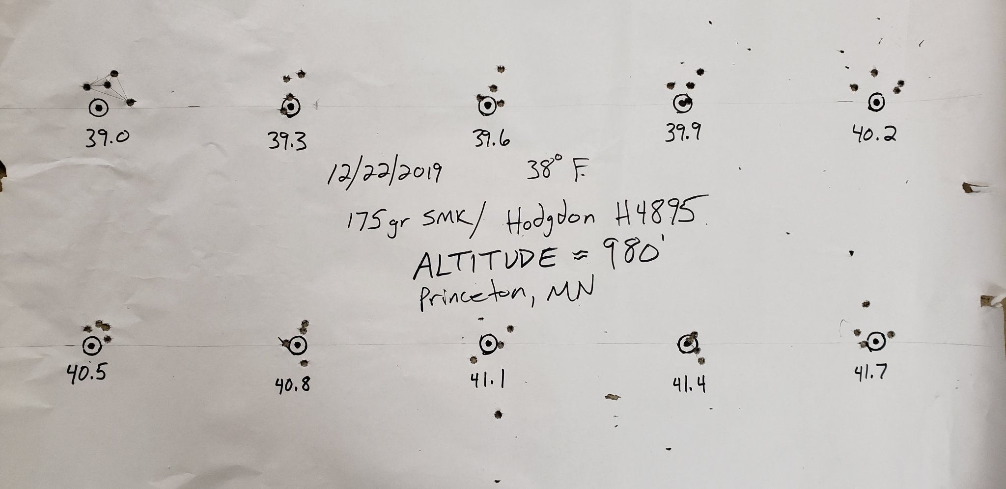

I went ahead and loaded up a bunch of 175's, from 39.0 gr to 41.7 gr. in 0.3 gr increments. My intent is to try to find my optimal charge weight (OCW) range. Hodgdon lists 40.8 gr is max charge for H4895. I will definitely be looking for pressure signs as my top load is about 1 gr over that. However, I went up to the max listed for the 168s and had ZERO pressure signs at all.
This will be my third ladder ever and I think I have a much better handle on how I need to proceed. Seated my rounds head to ogive 2.235 to be more inline with the M118LR which my rifle likes. I have a proper target sheet set up. However this will be my first time shooting off a bipod (atlas CAL) so that throws an unknown in.

I appreciate the replies guy. Can I get some post range trip analysis? Was having issues getting the chrono working but when it did register as I recall the lower velocities were low 2400's. The top loads were approaching 2600 fps.
It this was your groups...
I don't get it. 41.1 even without the low flier is all over the place. Maybe I just don't fully understand yet. Can you explain the thinking?
My purpose was to try to find an Optimal Charge Weight (OCW) range that will be resilient to my lack of process control. That being said Im looking at 39.6 and 39.9 as they are near identical groups with near identical central POI. Thinking I can work in that area and try to tighten the groups with seating depth and practice. I am not that good so much of that spread is almost certainly my utter lack of skill and experience.
I am all ears and will take any advice I can get.
It's not necessarily any one group per se, when you find a accuracy node, the point of impact will shift as you enter the node area, then shift again once you're out of it. Notice on your OCW, all impacts were above the point of aim until you got to 40.8, they shifted down until you exceeded 41.4. I'd be willing to bet that impact shift coincided with a velocity of 2550-2575 FPS or so.
When you combine the point of impact shift with the velocity data, you'll should notice a velocity flat spot and SD's get low for the groups in the impact shift.
Does that kind of make sense?
@Skookum and a few others can probably articulate this better than I. He is quite the man when it comes to this subject
Reactions: Ravenworks
I understands what you are saying. Not sure it makes sense about an accuracy node. 41.1 doesn't look like an accuracy node to me. Also, not sure I want to be pushing 175 gr SMK's at 2600 fps as a norm. Im almost never going to shoot past 400-500 yards.
However, I still need to try IMI 4064 and Varget. Hodgdon H4895 is the only powder I have loaded so far.
I may even start using lighter bullets like 150 gr.
