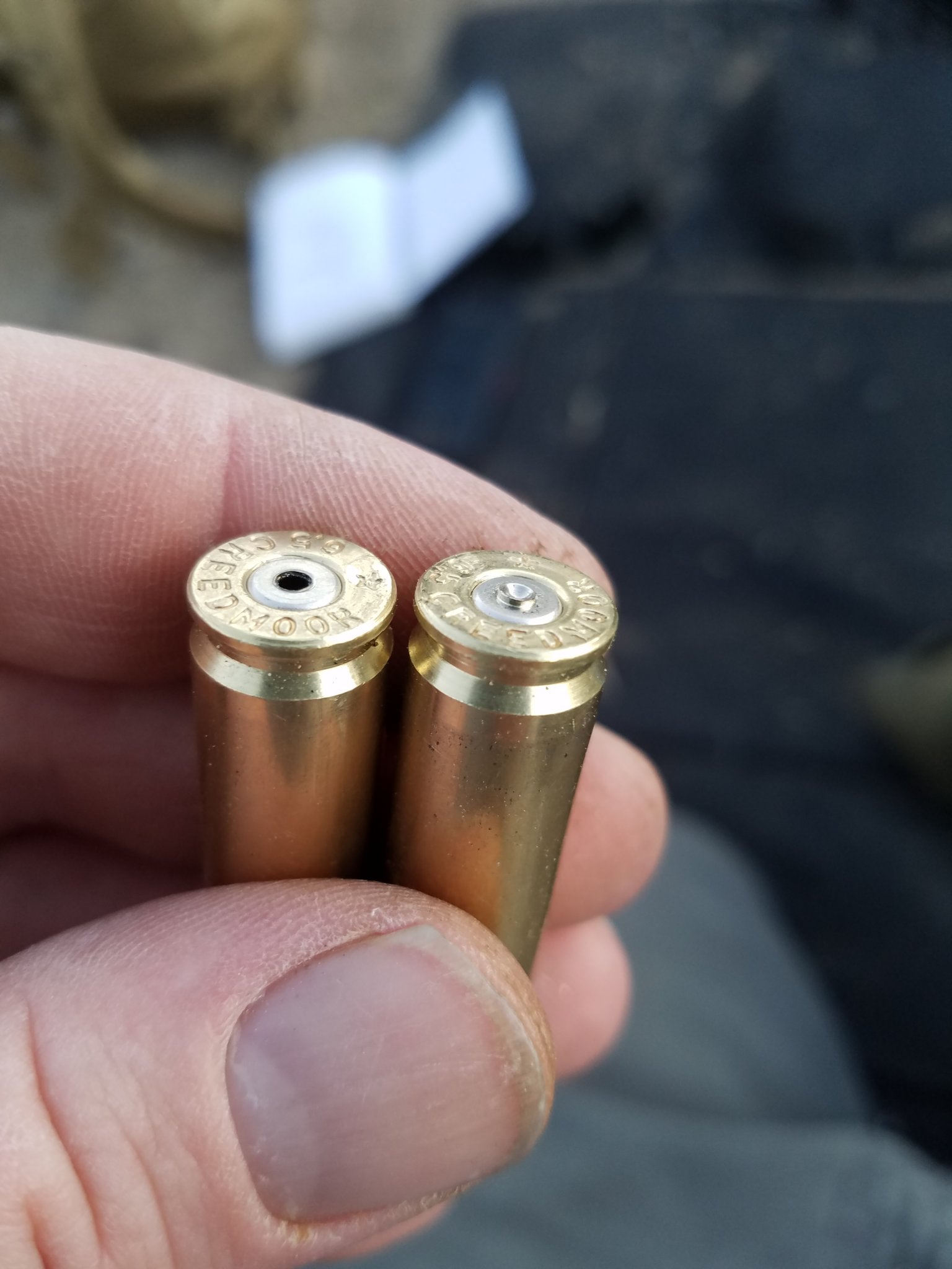

Hey! I've been reloading for almost a year now. 6.5CM and .223. I've tried loading with H4350 in the past with nothing special and eventually went with Superformance. I've finally upgraded my rifle to a Bergara BMP and began development again. I loaded up a few different powders and a couple bullets. One load was 42.5 g H4350 with 140g ELD-M. 5 rounds I got an average of 2817 fps, ES 6, SD 2. Load Development done! I then loaded a batch of 50 with some other Hornady brass - average now 2801 at a warmer temp. Not a huge deal, But then I loaded another batch with Starline brass and ended up way over pressure pushing 2875fps. I pulled a bullet and weighed the powder and it was right in line with what it should be. Has anyone seen such a huge swing in velocity from switching brass? Since I've picked up a couple hundred pieces of Hornady brass to keep all my loads consistent. I've never seen a wild swing like that loading Superformance. Does anyone know H4350 to be sensitive like that? 20180626_201541.jpg20180623_193436.jpg

That's why I've standardized to one lot of brass. I just thought that was a pretty substantial change. I predict that the fired brass will probably be a little slower than the new brass because of the increase in capacity. Actually, I fired a few load yesterday and I was getting pressure signs on the primer but no ejector marks. Using CCI200s. I'm wondering if maybe Magnum primers might help that or if I'm just not going to get the velocity I want out of H4350
