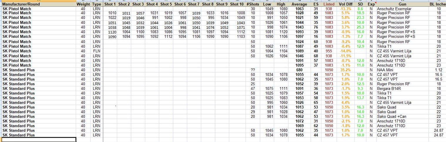

I will be picking up some of these flavors of ammo soon, was wondering how velocity compares to SK standard plus out of rifle length barrels?
yes I know a chronograph out of my specific barrel would tell the tale but don’t have one. If anyone can give me some numbers it would be appreciated
the data tables only show pistol barrel ballistics
Supposedly pistol match is from the same family as Std + and Rifle match. Which run about 1050 in my rifles.
Likewise for PMS. It's part of the Biathlon Sport and Long Range Match family. Biathlon runs about 1080 in my rifles.
But, I've never used either PM or PMS, so no first hand experience.
Maybe this'll give you some ideas:
